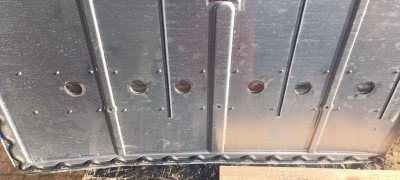

Small update on battery cooling. The fan proved not very effective so now I added air scoops. They can be closed off to prevent debris and water getting in on everyday driving and opened on longer trips with rapid charging. Test is pending.

Got a chance to test my cooling scoops yesterday on a 350 km trip. Outside temp was 7°C so quite favorable. I drove 250 km then charged from 25 to 65% with 200A. Battery heated up to 44.5°C. I opened the scoops and after 50 km the battery had cooled down to 37°C. Then it started raining so I closed the scoops again. Now on the remaining 50 km the battery did not cool down at all!
So it looks they work rather well. Next test is a trip to 400 km away Dresden in June, so less delta T.
