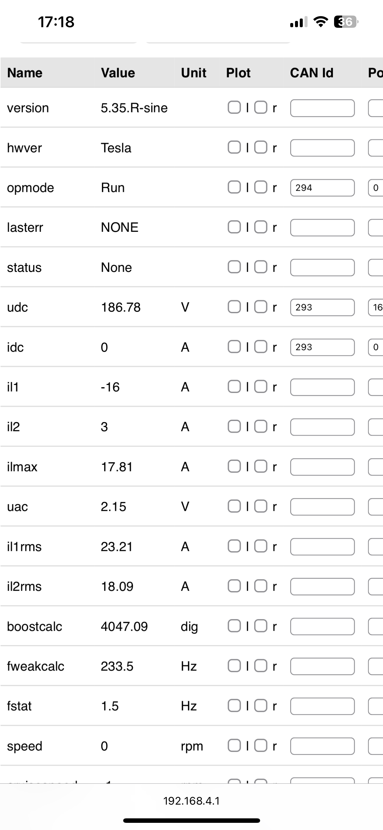

Here’s the reading with HV:
Here’s the reading without HV:

Re: Tesla LDU and incorrect UDC reading problem
ah, that's with Mangelsdorf config then?
So the Vsense is still connected to the logic board then. Like said this could point to a moisture problem.
You could mitigate for now by setting udcgain in a way that the reading is kindof sane. Set udcofs=0 again. Set udclim to 1000V to prevent the inverter faulting out should the reading return to normal.

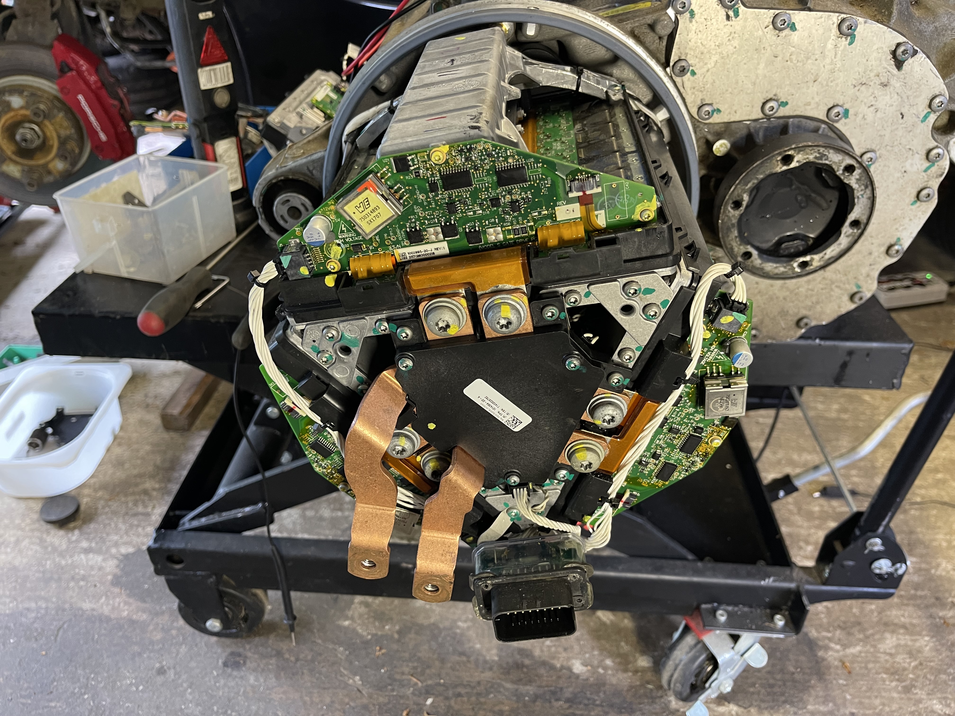

The car became more and more horrible to drive this week so I pulled the motor out. Whilst the inverter was completely dry, looks like I have some remnants of a previous leak from (3 years ago).

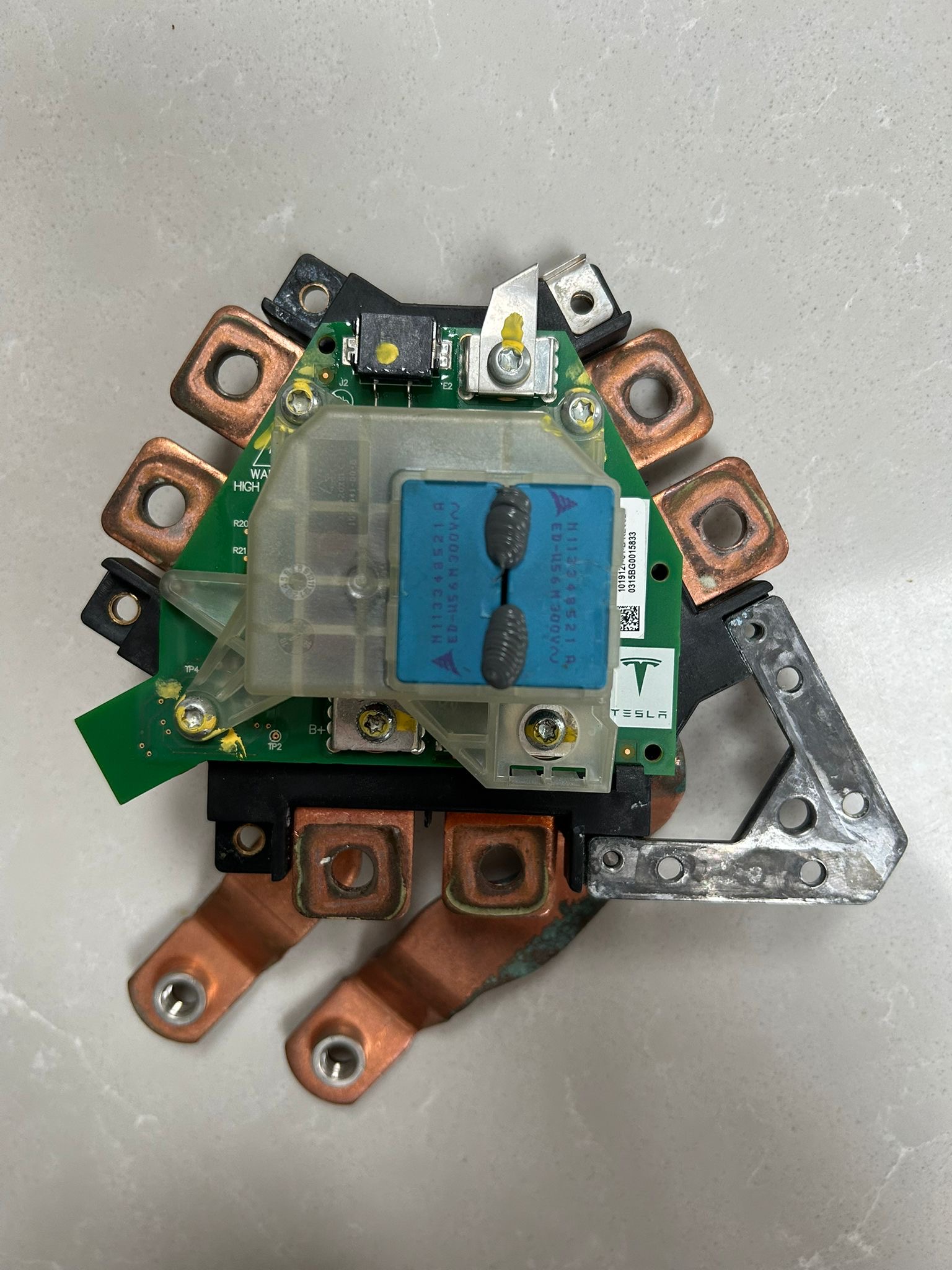

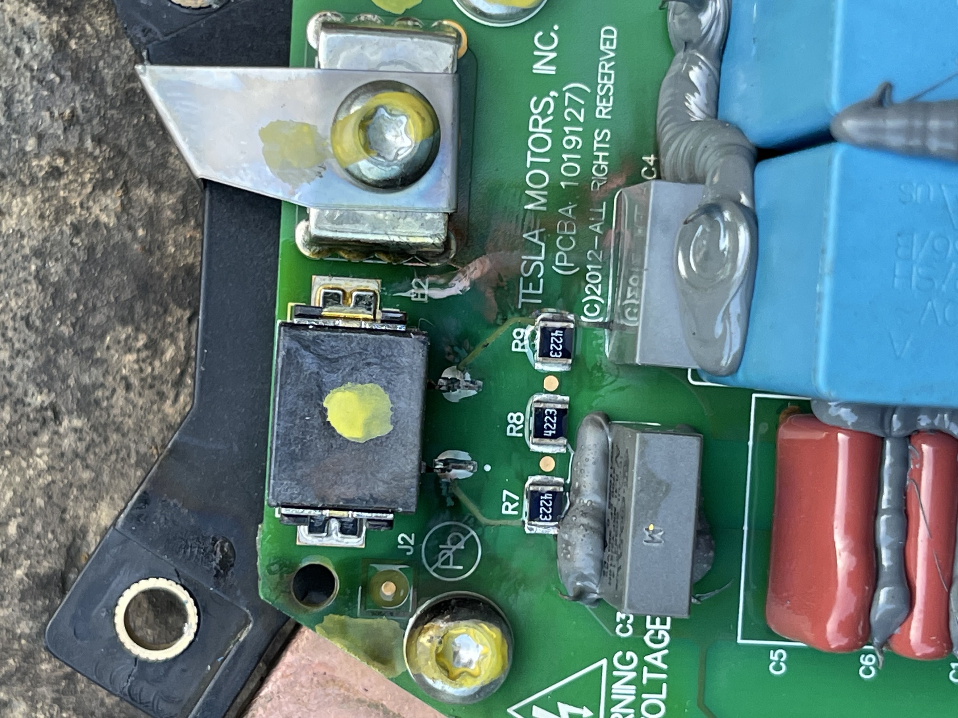

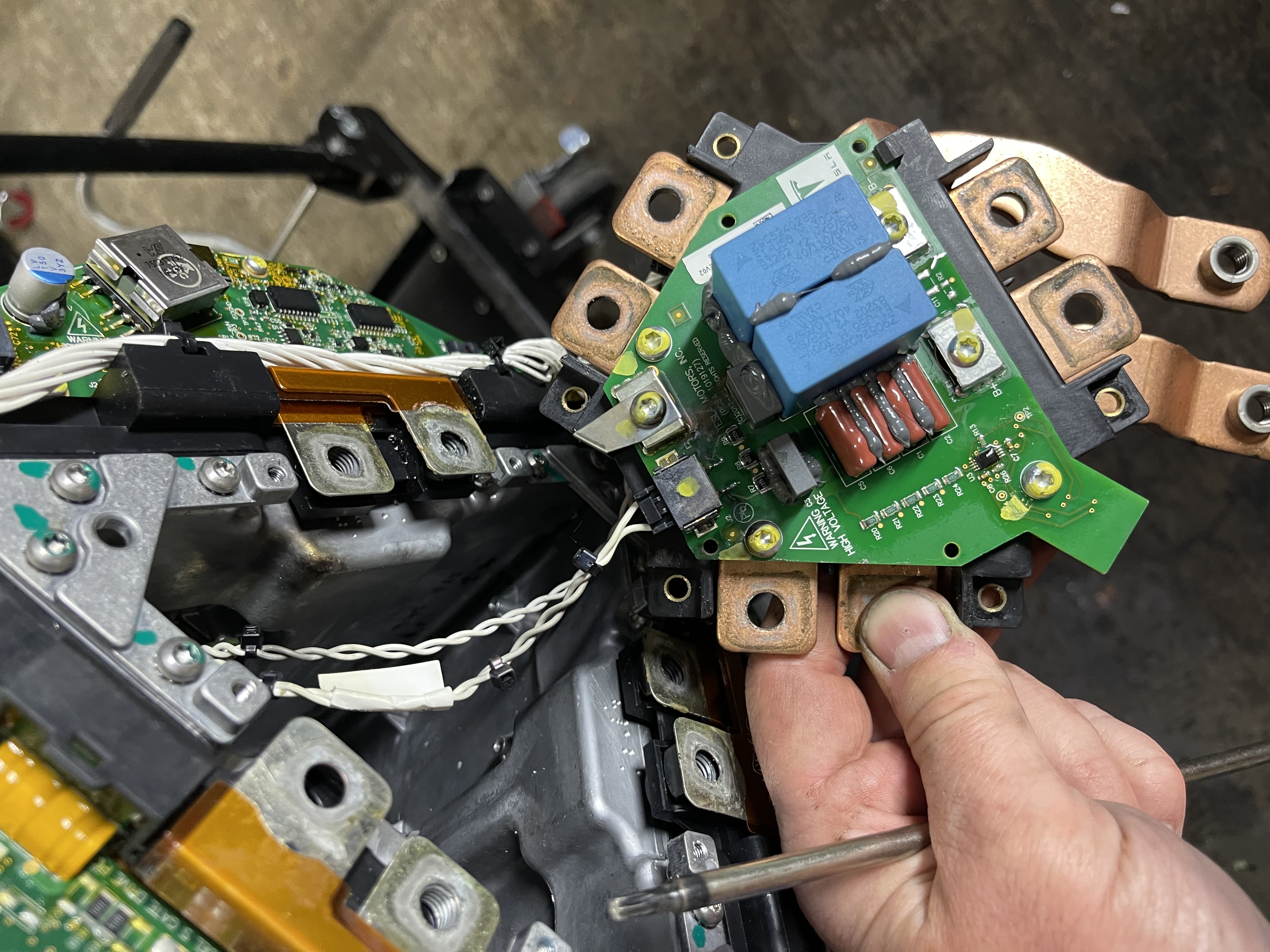

To conclude this thread, I found the issue to be on the Tesla PCB that attaches to the main busbars. I think it manages the capacitors for the voltage sense aspect.
Having inspected this, I found that the board had burned out:
I managed to source a replacement from Ukraine part number 6009072-00-A for just £70. Interestingly Tesla seem to have updated the design and placed a plastic housing over the blue components. Anyway, I fitted it and put everything back in the car and it’s working perfectly again.
