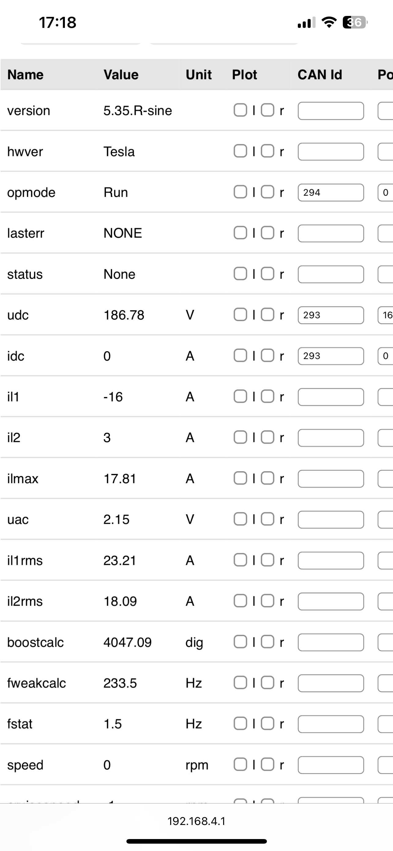

Whilst driving a few days ago, my large drive unit massively derated all of a sudden despite a full battery.
Upon power cycling and checking the spot values, the main contactor would not close because the last error was UDC below UDCSW. It was showing <200vdc. Got the car home and ran a few checks including reloading the sine firmware, but the issue remains. I also checked that I was getting 390vdc on the Tesla busbars, but still UDC reported at <200vdc (speradically, sometimes 160 another nearer 200).
Any educated guesses whether this could be a voltage sense issue on the open inverter logic board, or alternatively, could the issue point towards an inverter problem?
The car still drives, although all the firmware calculations are seemingly thrown off by the voltage discrepancy.

Does the voltage drop (close) to 0 when not allowing HV into the inverter?
186V sounds suspiciously like the floating value when Vsense is not connected to the OI board

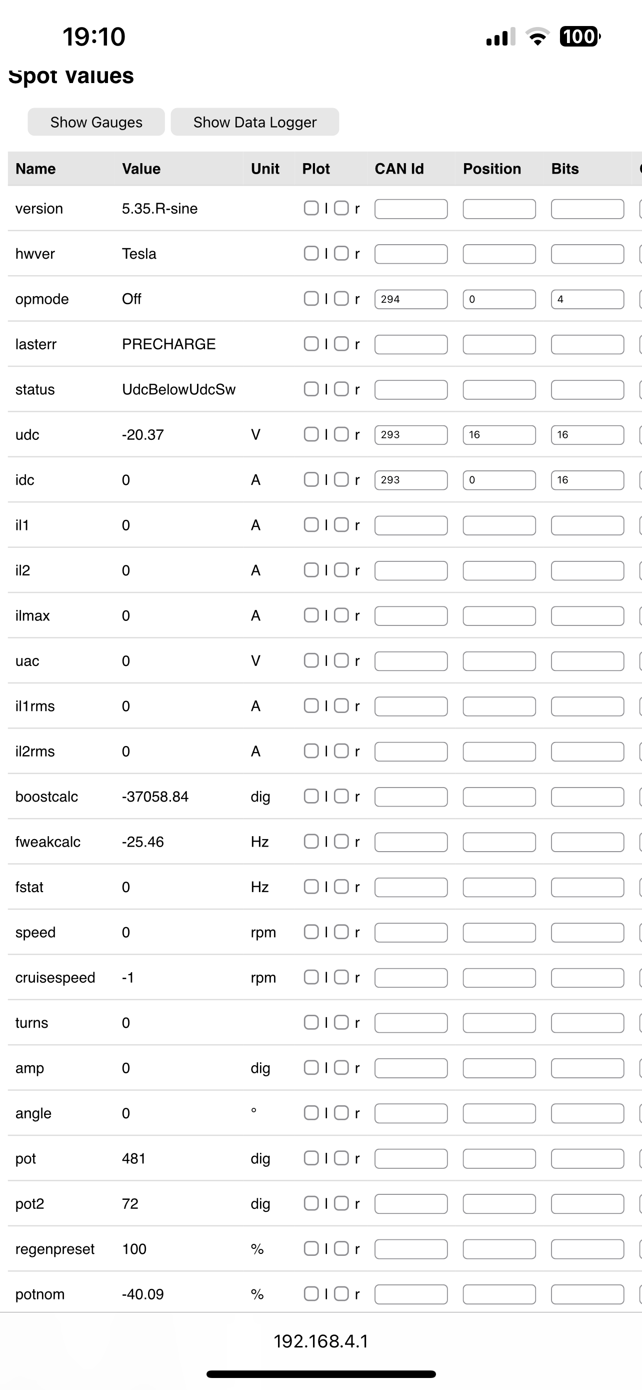

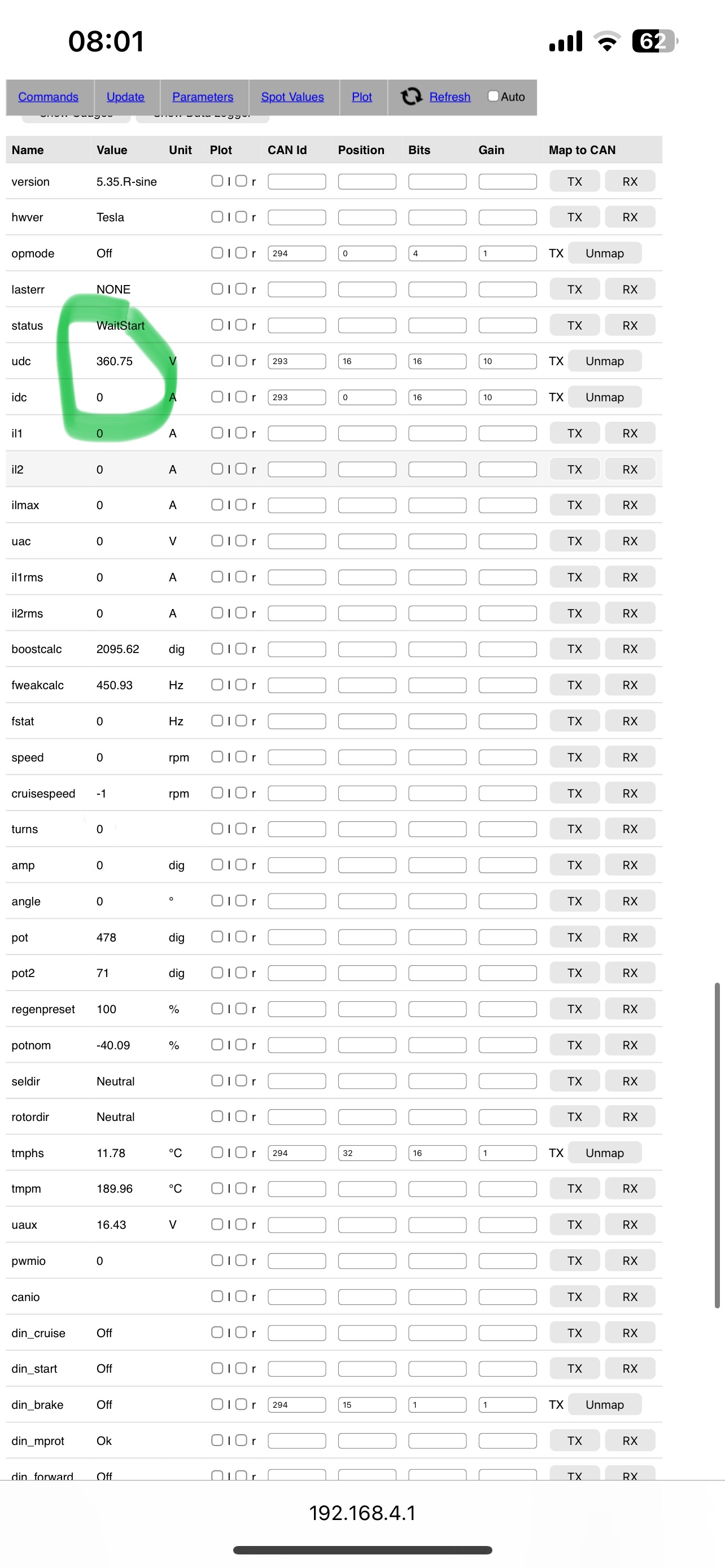

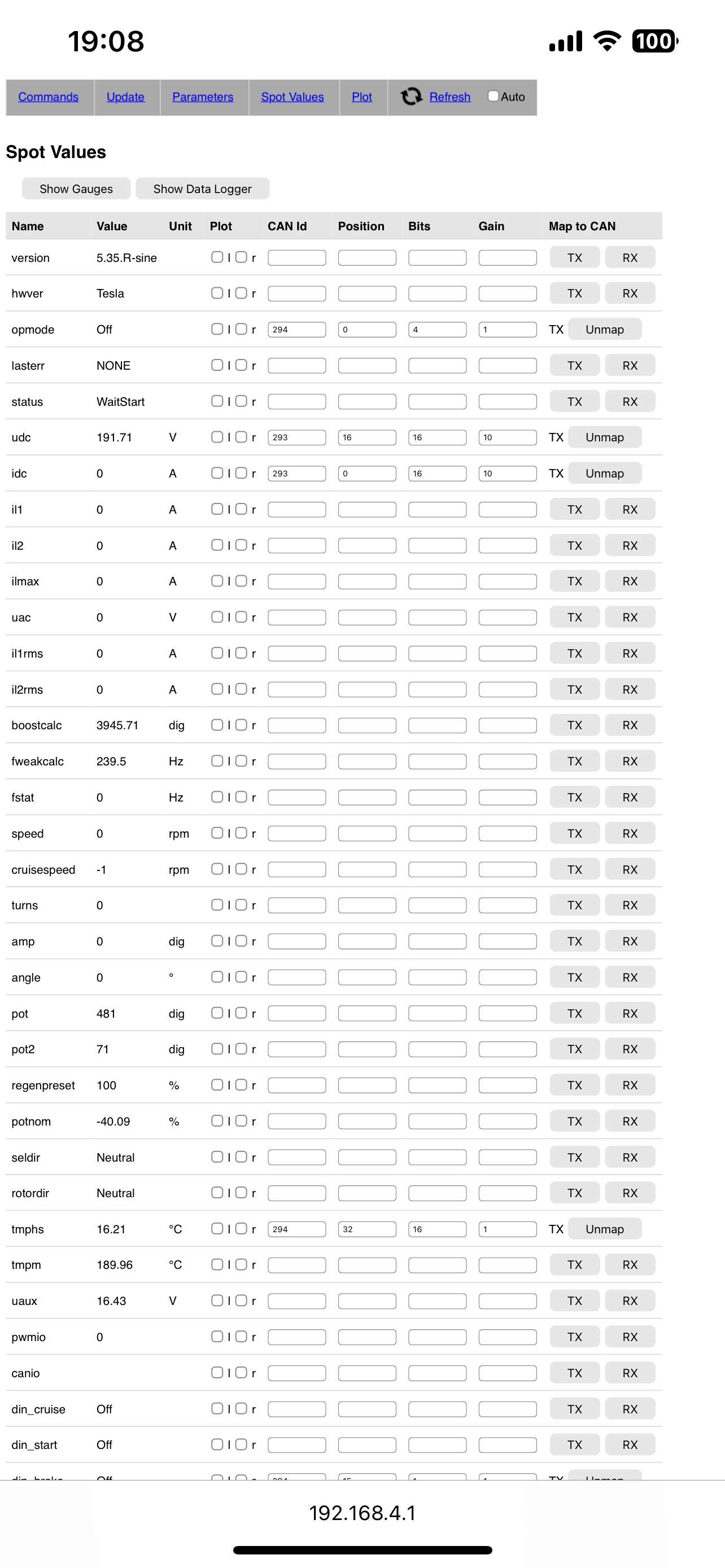

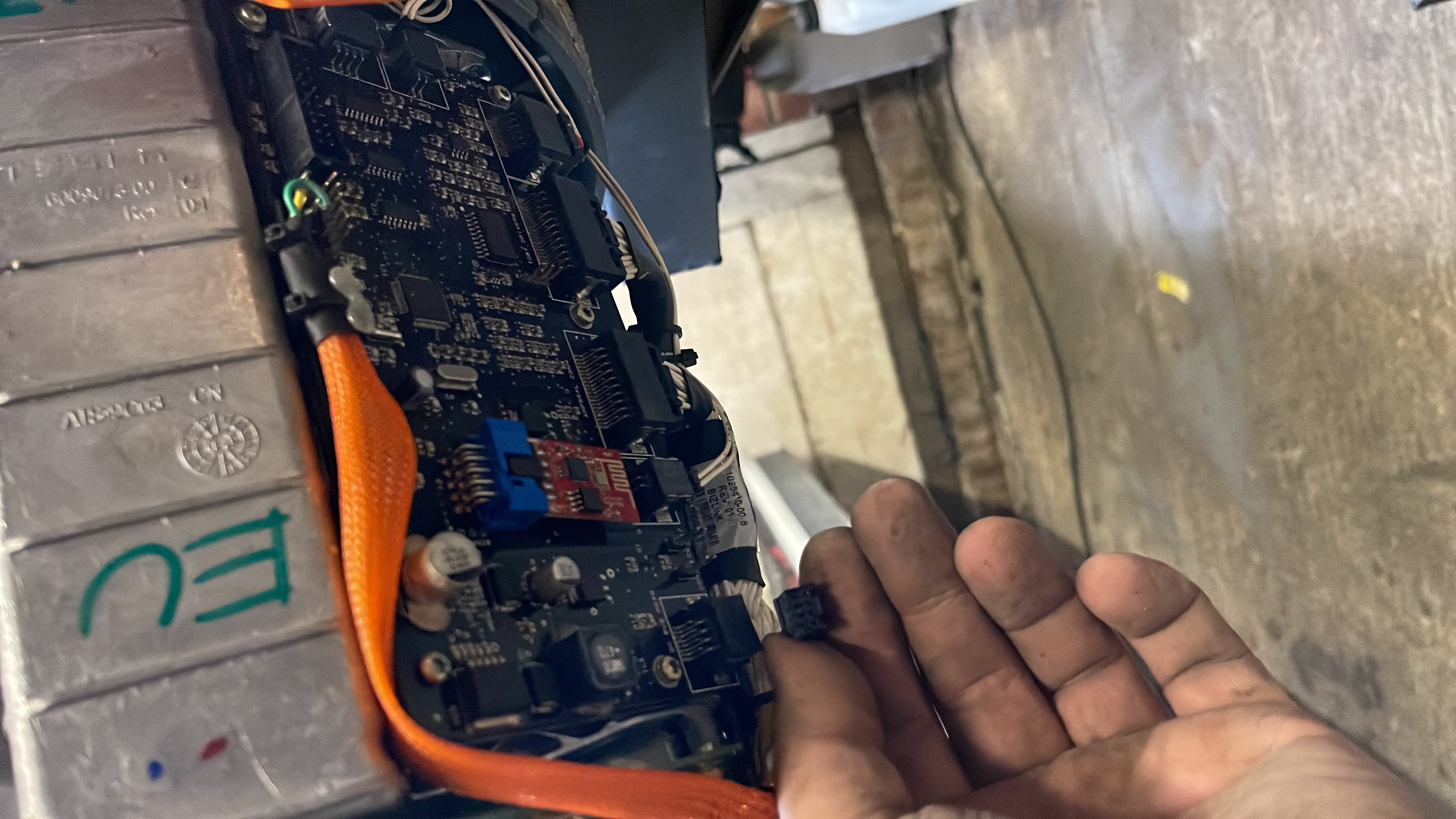

Here’s the reading with HV:
Here’s the reading without HV:
Been thanked: 1918 times
Re: Tesla LDU and incorrect UDC reading problem
ah, that's with Mangelsdorf config then?
So the Vsense is still connected to the logic board then. Like said this could point to a moisture problem.
You could mitigate for now by setting udcgain in a way that the reading is kindof sane. Set udcofs=0 again. Set udclim to 1000V to prevent the inverter faulting out should the reading return to normal.

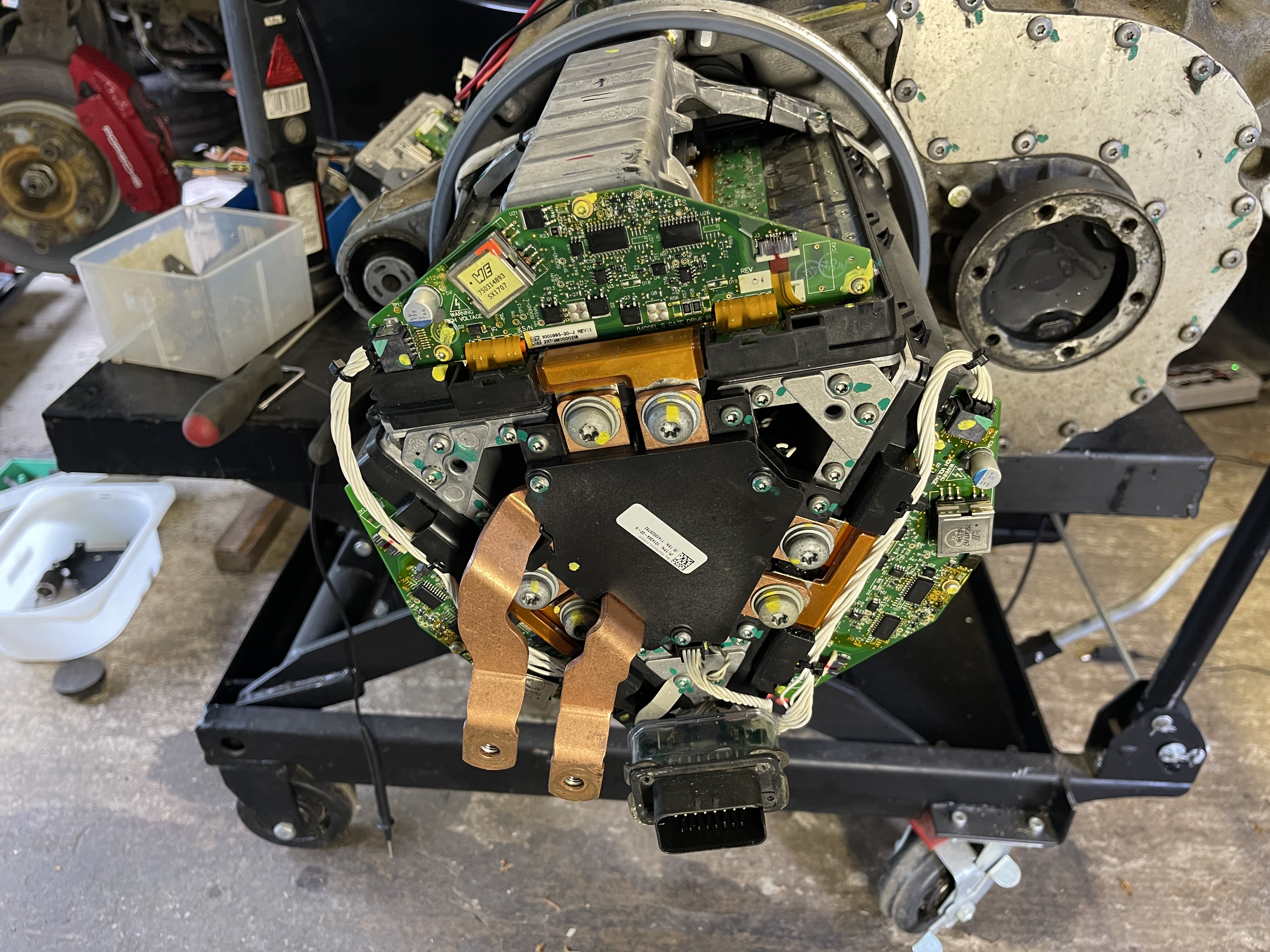

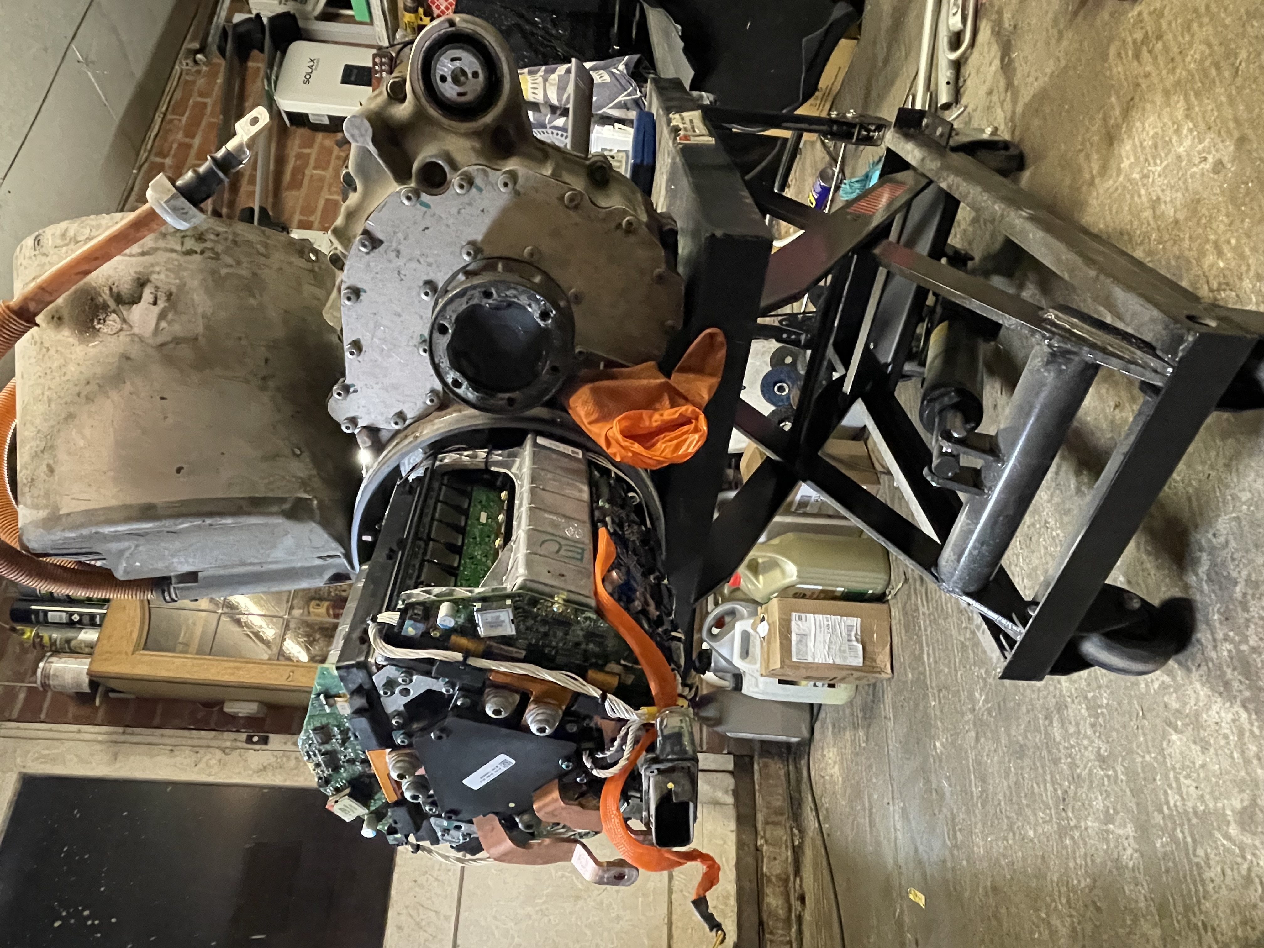

The car became more and more horrible to drive this week so I pulled the motor out. Whilst the inverter was completely dry, looks like I have some remnants of a previous leak from (3 years ago).

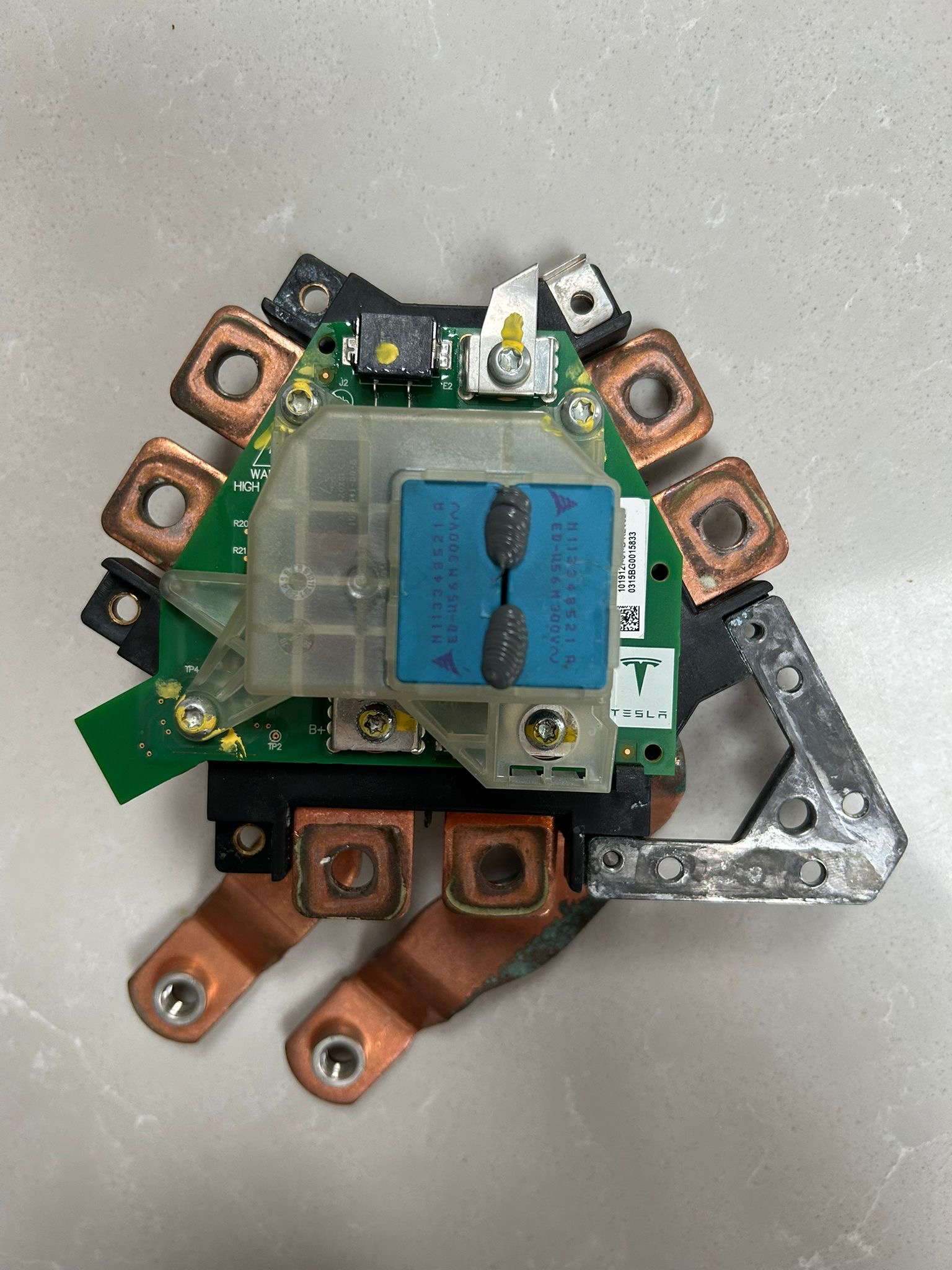

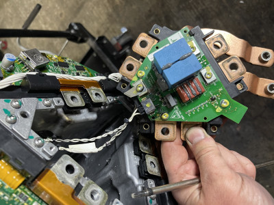

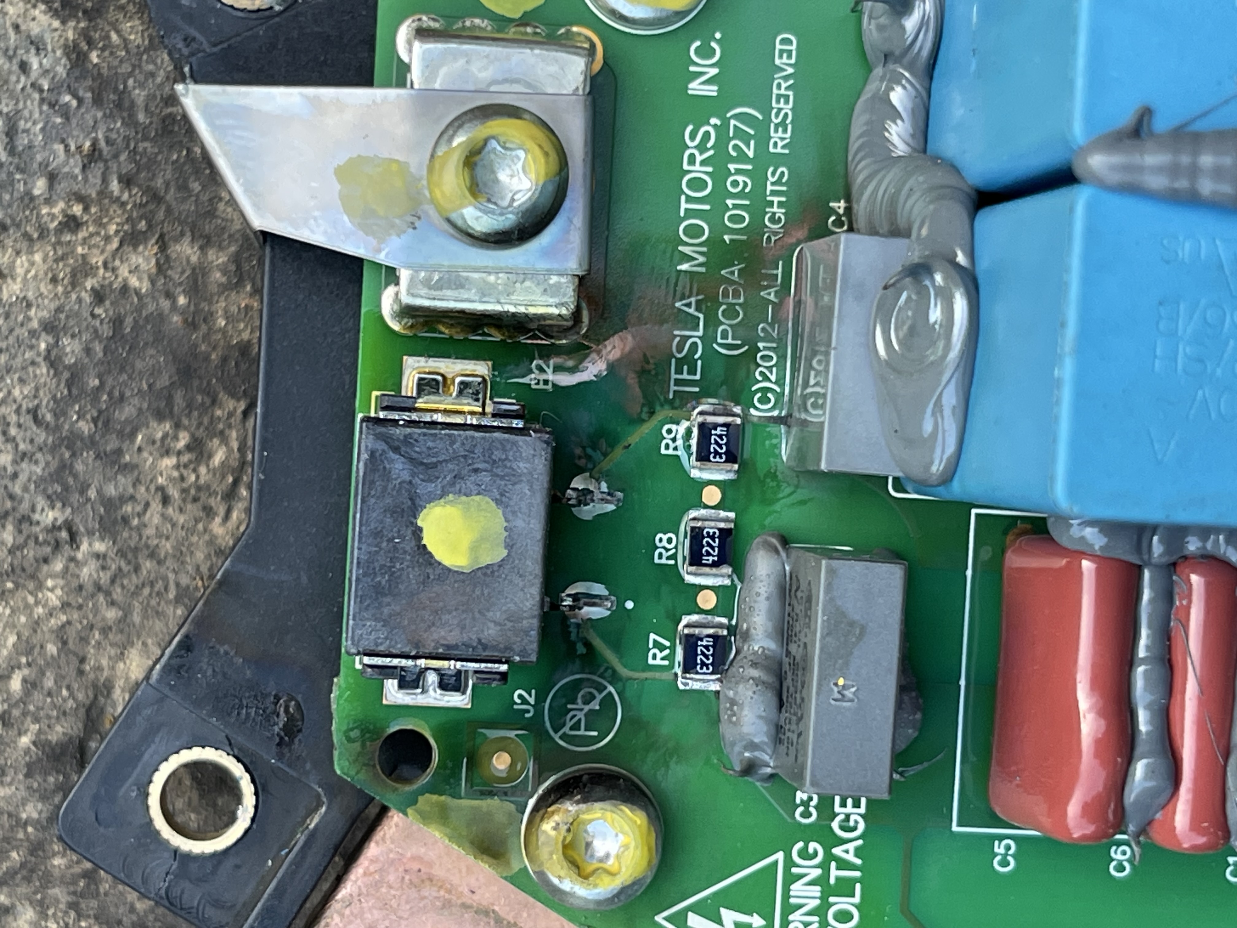

To conclude this thread, I found the issue to be on the Tesla PCB that attaches to the main busbars. I think it manages the capacitors for the voltage sense aspect.
Having inspected this, I found that the board had burned out:
I managed to source a replacement from Ukraine part number 6009072-00-A for just £70. Interestingly Tesla seem to have updated the design and placed a plastic housing over the blue components. Anyway, I fitted it and put everything back in the car and it’s working perfectly again.

Boxster EV wrote: Thu Jun 26, 2025 4:12 pm Interestingly Tesla seem to have updated the design and placed a plastic housing over the blue components.
This is one part I have seen very clear revisions on across the 3 LDUs I've taken apart now. On one of them, the board was remote - attached on top of a gate driver, with just two wires feeding off the back of the bus bars.
