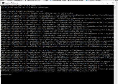

I still haven't managed to get this tool to work. What am I doing wrong? I have installed python. When I enter 'Python' in the comandline something happens. When I enter 'pip' I get a help text. When I type 'pip install openinverter_can_tool' something seems to be installed. And now? If I enter 'oic' it is unknown.

If the "oic" command isn't available that sounds like where it is installed to is not on the path. To help out it would be useful to know the platform you are using and the output of the install command. It would also be helpful to know the CAN adapter you would like to use with it.
muehlpower
Posts: 690
Has thanked: 14 times
Been thanked: 141 times
Re: Tool to manage openinverter via CAN
Post by muehlpower »
I don't know where it was installed, how to find it, nor how to specify or change a path. I am using Windows 10 and python 3.13.3

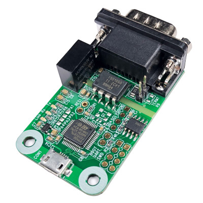

this is the adapter I have and want to use
https://www.inno-maker.com/product/usb-can/

Had a very frustrating day trying to get this to work on Windows 11 (10 should be the same). The TLDR version is that it doesn't at the moment. For the time being I'd recommend using a Linux virtual machine and pass-through the USB CAN adapter to the VM. VirtualBox is your best bet on Windows 10 though I believe WSL can do this on Windows 11. You could also use a raspberry pi or any other Linux box.
What follows is how to set up openinverter_can_tool on Windows with an Innomaker USB2CAN or any other CAN adapter using the Geschwister Schneider protocol.

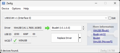

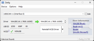

Once this is done you need to install the USB driver for the USB2CAN adapter. To do this you need to download a utility called Zadig. This program assigns a device driver to a specific USB device. When you run the utility pick the "Options | List All Devices" option. Then you pick the "USB2CAN v1 (Interface 0)" in the drop-down:
Change the spin-control next to the green arrow to read "libusbK (v3.1.0.0)" and press the Replace Driver option:
