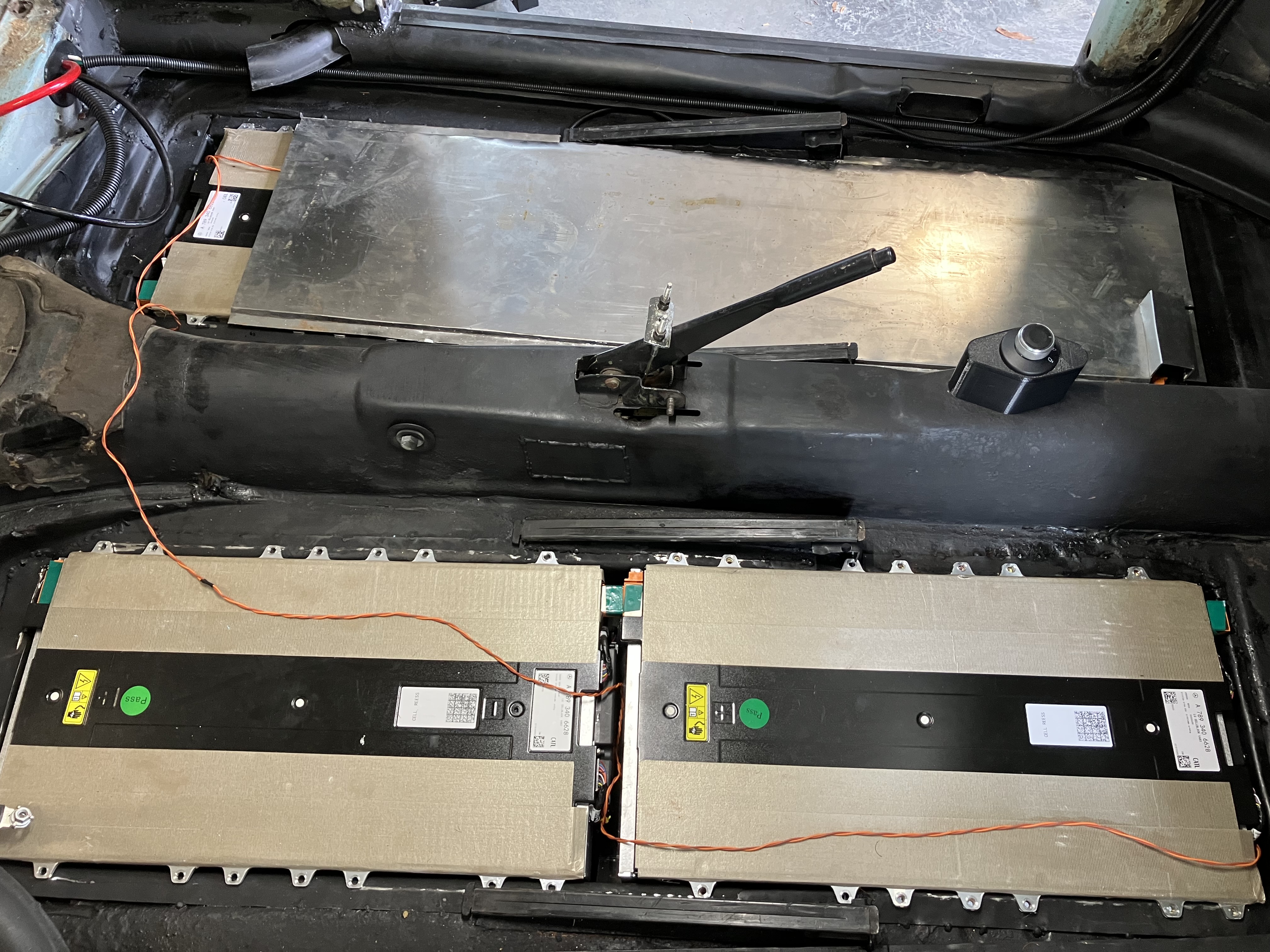

It’s getting there, though. Refitted the seats in to make sure they clear the batteries:

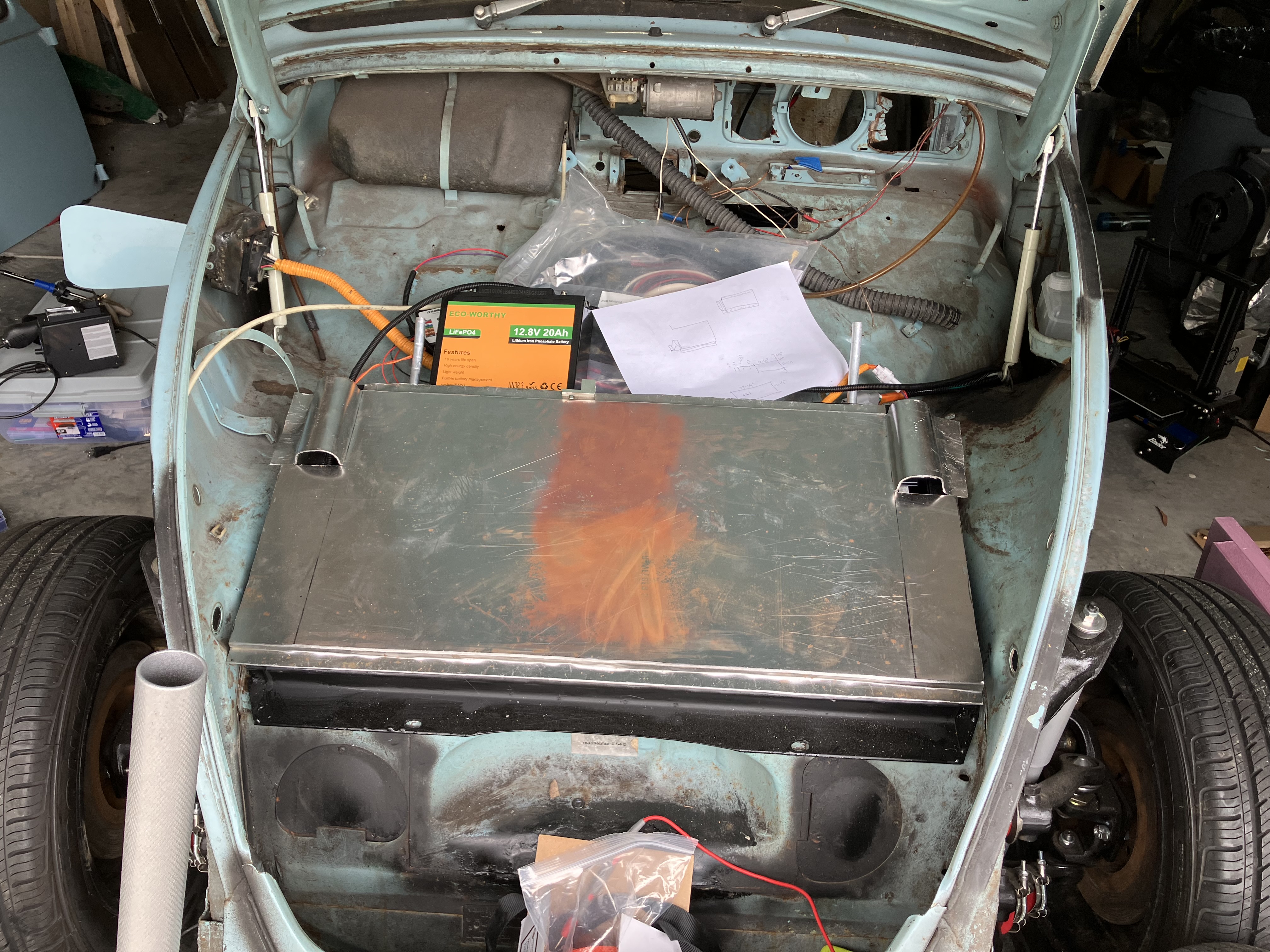

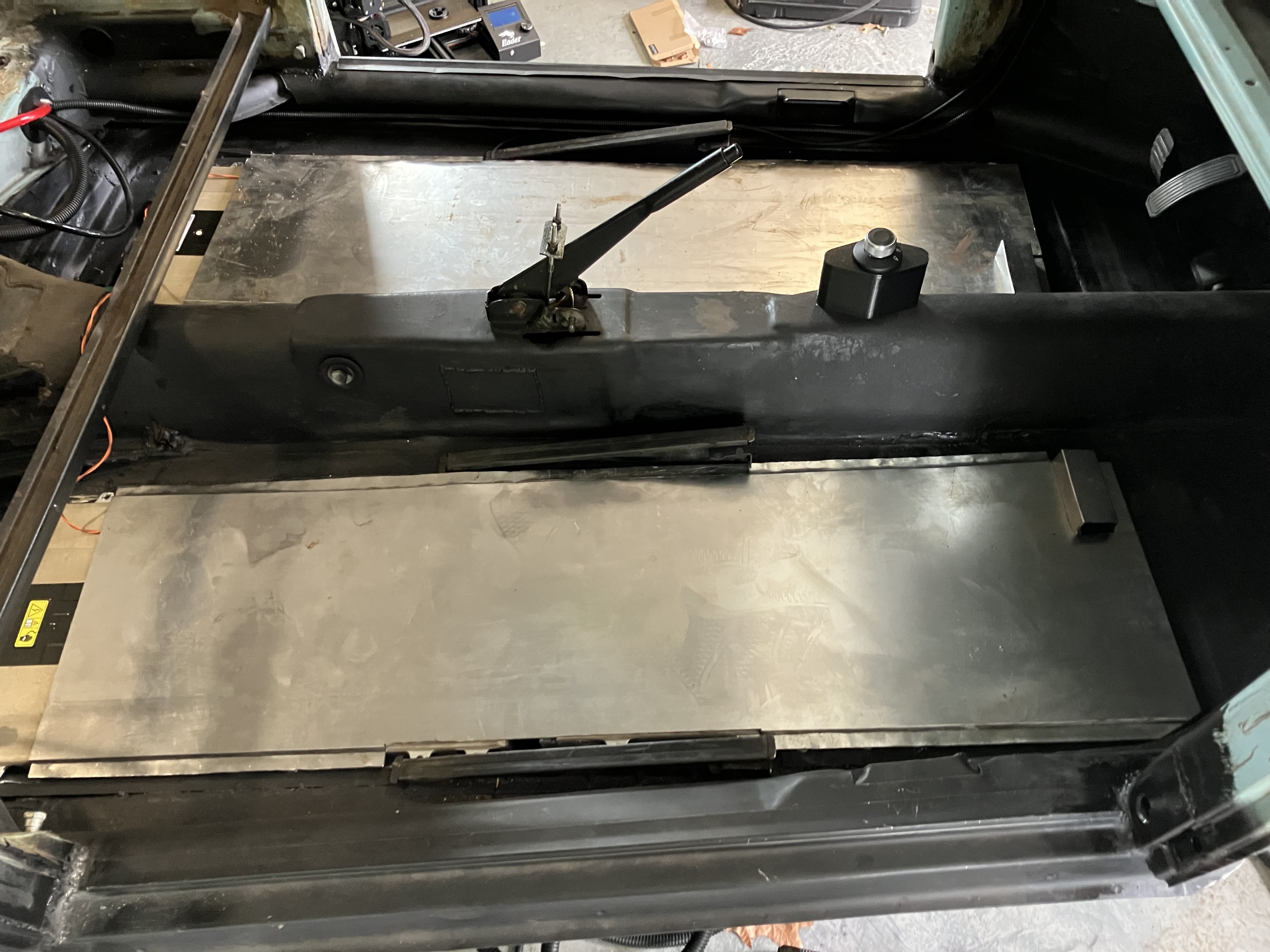

And building the battery covers out of 16-ga to protect them and to prevent touching or kicking of the HV wires:
Feel safer with 16-gauge steel covering the batteries and HV wires!

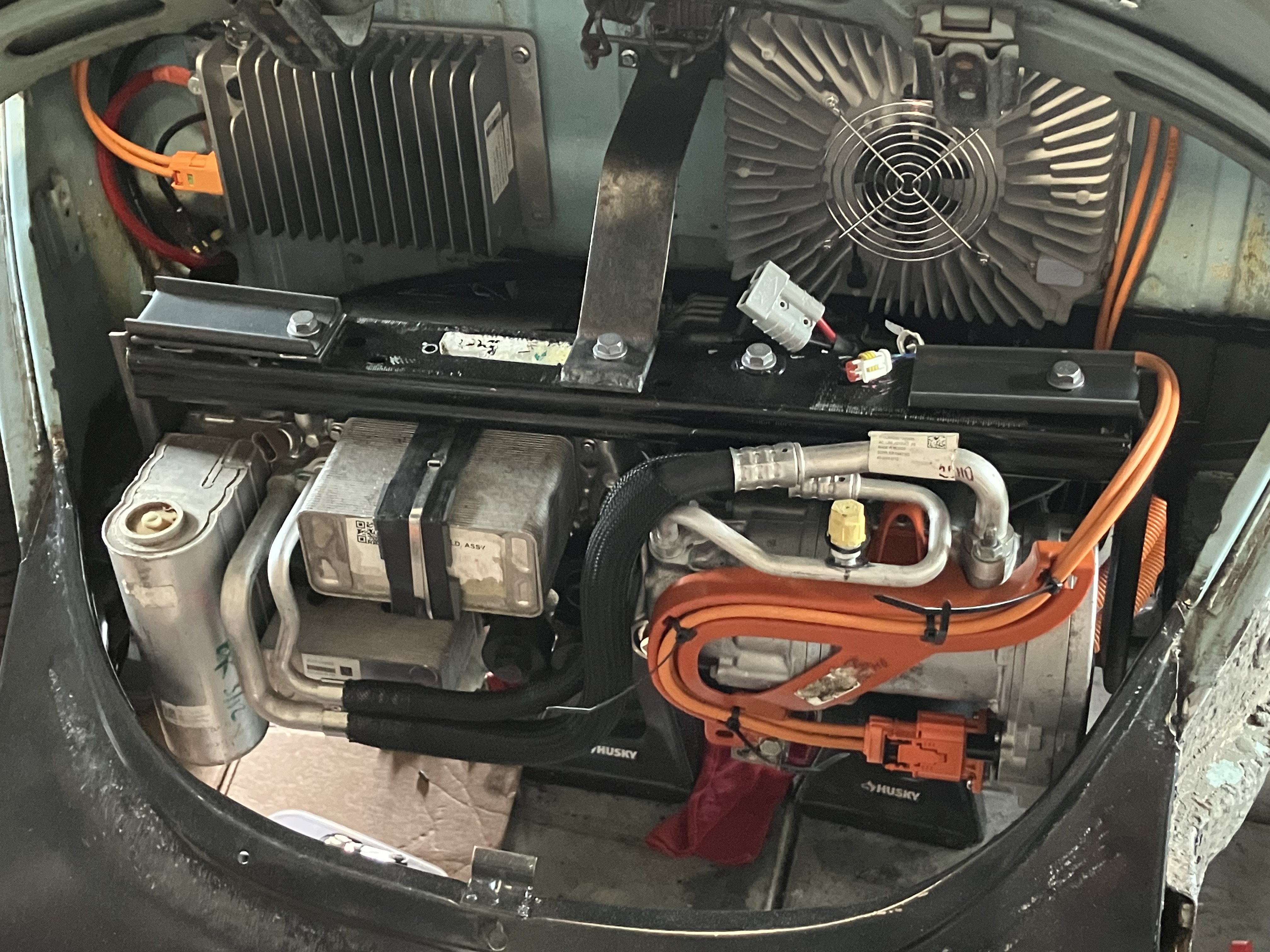

And continuing the heat pump installation:

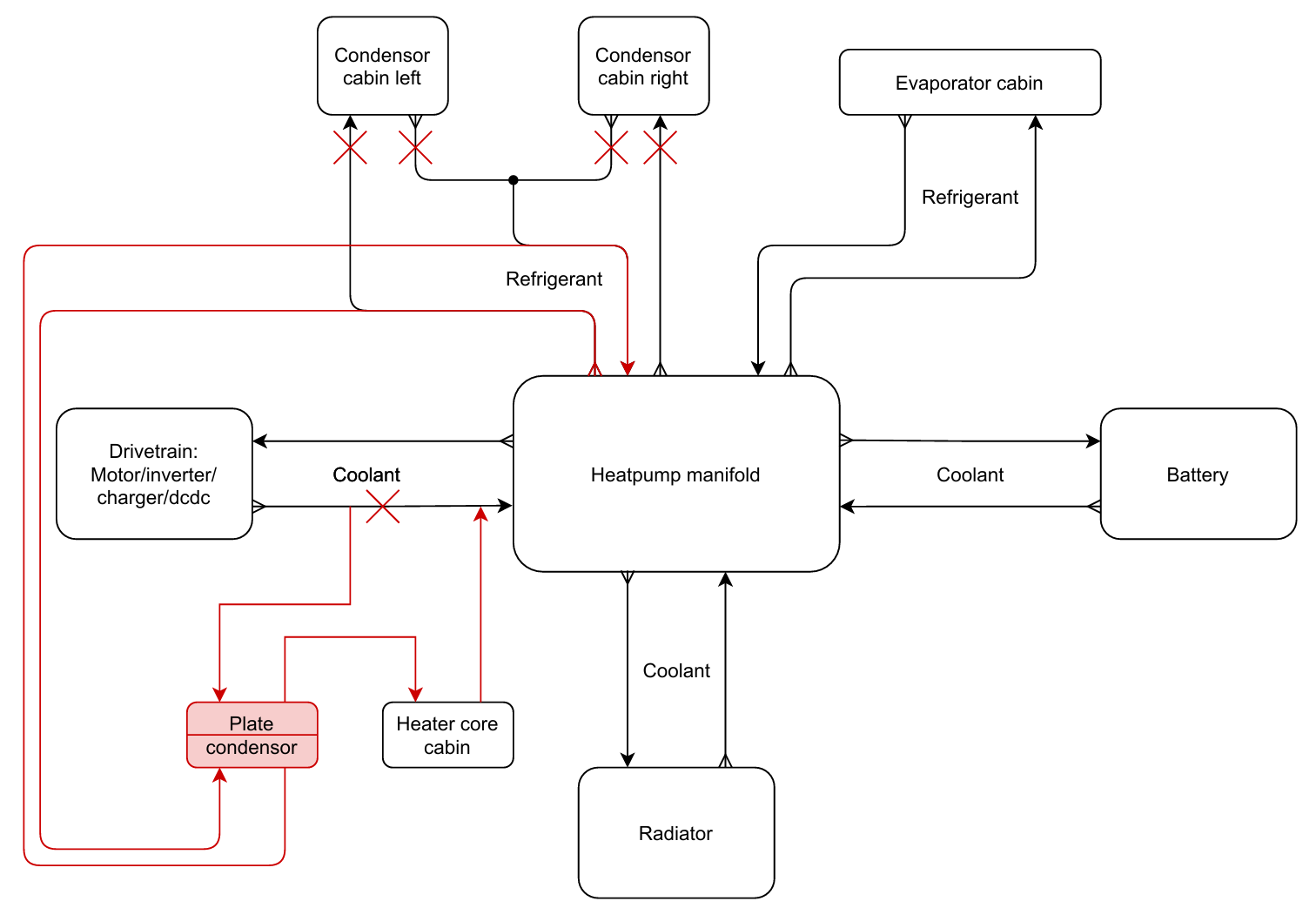

For my car I've left in the original coolant heater core and decided to use a plate heat condensor like this one with 60 plates:
https://nl.aliexpress.com/item/10050028 ... pt=glo2nld
It handles the pressure and refrigerant and is readily available. This makes it a lot easier for retrofitting into other vehicles.
As for the controller, I've worked out most of the control logic and software, but I still have to do a lot of testing. However I'm also busy with getting the car running plus many other things, so it's not going super fast.
