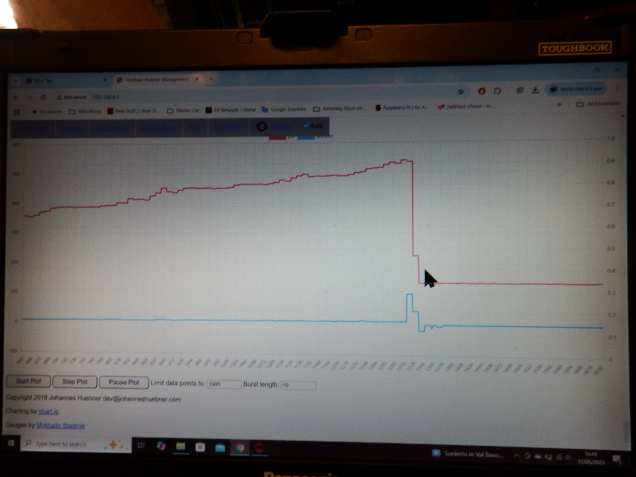

I was about to start a new thread titled Uncontrolled throttle with Zombie on Leaf inverter but saw this one.
Initial testing using version 2.20 seemed OK with throttle control but lacks power in reverse which is already known and I assume will be sorted on the next update.
Since doing other testing with a test version 2.31TH I find that when increasing speed over around 10mph, the drive goes to full power spinning the wheels! Scary on my short drive!!!
I have loaded the latest gold update version 2.22a but no difference
Have attached CAN logs with the Ignition on in neutral and full accelerator pedal and another CAN log with the car in FWD selected and throttle gently pressed past 10mph until the revs are uncontrolled. Parameter list also attached.
I have checked the accelerator pot volts and they are smooth from minimum to maximum without any jumps.
Any assistance would be appreciated on this as it has already snapped the torque bracket on the drive unit which is now beefed up.

Re: zombieverter irratic torque demand in VCM CAN message
Please generate logs of Potnom
To start
"throtramprpm": 1000 set this back to 20000rpm. This disables throttle ramping.
The rest looks pretty standard if you say the throttle values look normal when plotting.

Not sure how to save a plot and its easier to take a pic of the plot.
Pot volts is Red and Potnom is Blue. Due to the immediate increase in rpm, the vertical drop on the red trace is me taking my foot off the pedal.
You can see the spike on the Potnom trace.
Is this after making the change as requested?

Post by Rustybkts »
No, just made the change and it seems OK now. That is scary though.
What is that parameter used for.
I am testing with the wheels in the air so it's not a proper test until I can go on the road.

Rustybkts wrote: Sat May 17, 2025 4:04 pm What is that parameter used for.
tom91 wrote: Sat May 17, 2025 3:39 pm "throtramprpm": 1000 set this back to 20000rpm. This disables throttle ramping.
And can wreak havoc in the various places where the throttle can be ramped. Will likely move to remove this in a future release.

Have now removed the throtramprpm as this is not really something being used in the VCU
