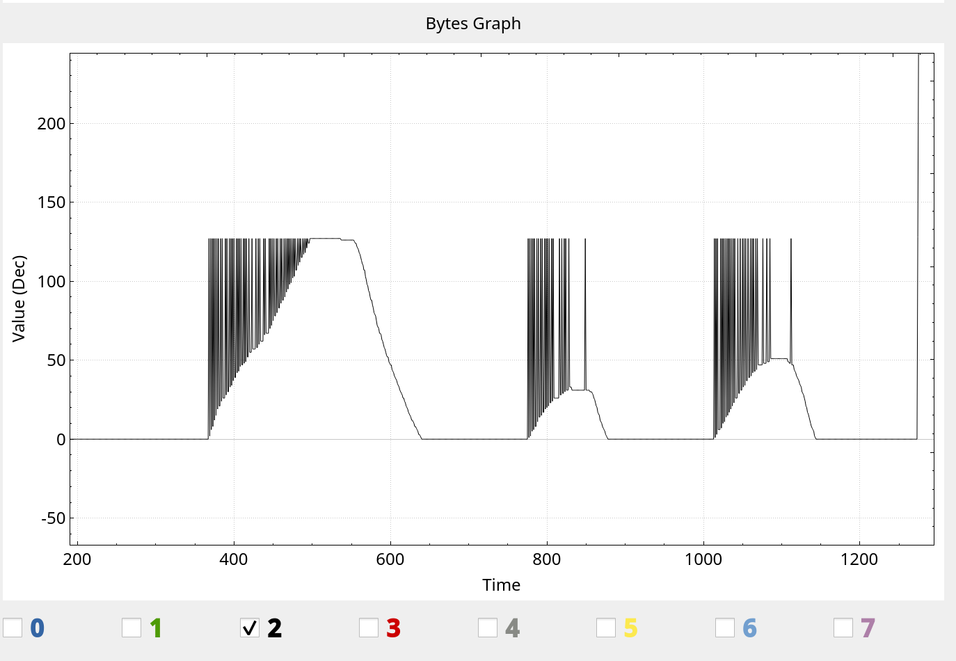

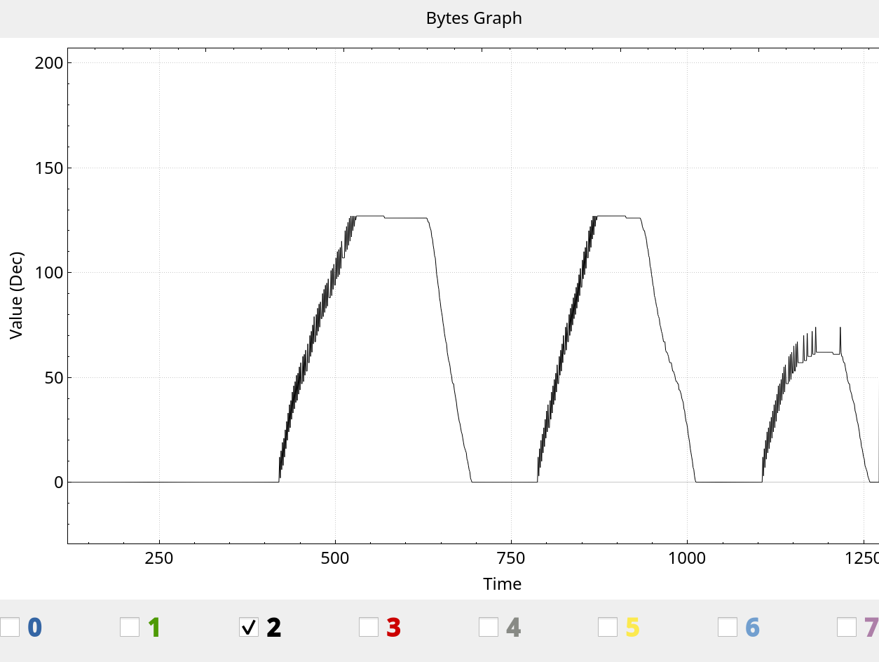

Started scanning the CAN log traces from those runs and noticed this 'weird' series of torque demands sent by the VCM (zombieverter), when I apply the throttle. It looks weird to me. Maybe this is normal? Dont know, I am just new to all this. But I don't see that pattern with the original Leaf OEM VCU.
Do I have some misconfigured that contributes to this behavior? What am i missing in the zombie setup?
I did multiple runs and see this everytime after start, when I apply the throttle.
The first initial torque request by the VCM is 511Nm (isn't that max torque or more?).
The second 5Nm seems to be the value from the throttle, and the third is again 511Nm followed by another 5Nm
The irratic 511Nm seems to be sent all the way until max throttle is reached.
Here my param.json and a savvycan trace.
