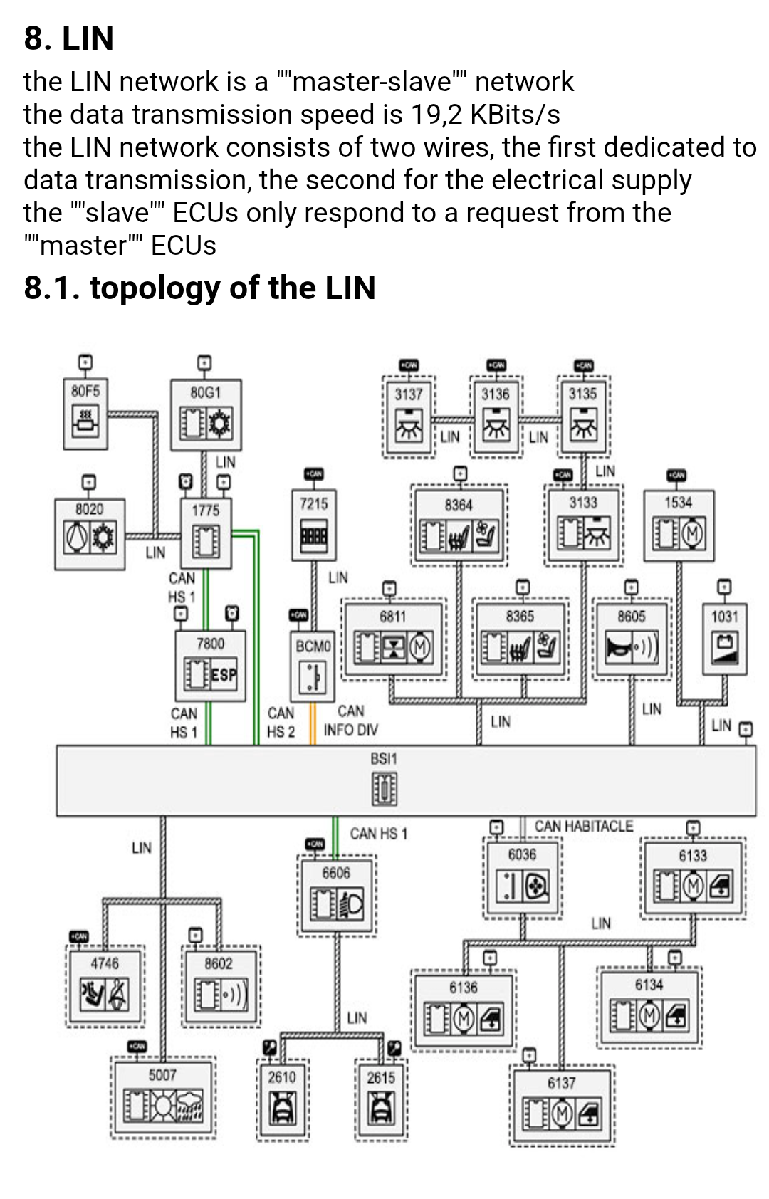

I have some Lin logs from my missus's e2008
From the heater and I believe a/c Lin bus this runs a 5kw eberspacher heater.
I started the log full hot I believe then full cold then full hot again. I did verify the heater hose were getting warm.
https://github.com/Gn1c3/Lin-E2008-Heater-a-c/tree/main

Cool! You wouldn’t happen to have come accross a pinout of these, would you? I have tried and failed to find one in the past…

What is the other component on the same network? AC compressor or a pump?

Can you please get some logs of it running steady just heating.
Then a log of going from HVAC on to off.
- Posts: 2962
- Has thanked: 329 times
- Been thanked: 847 times
Re: Lin heater logs from e2008
Small issue to gum up the works, it has a heatpump setup so using the AC compressor to heat the cabin. We will need to figure out how to force it to do ptc heating.

There wasn't a pid in diagnostic data for heater.
There wasn't a diagnostic activation for the heater.
How about if I unplug the compressor.
Was that 'heat pump yes' from my data?

Yeah if I unplug the compressor and the coolant still gets hot then it has to be the heater.
- Posts: 2962
That is the quickest test. Also good to easily identify the LIN ids for the AC compressorGeneralScanner wrote: ↑Tue May 20, 2025 4:03 pm Yeah if I unplug the compressor and the coolant still gets hot then it has to be the heater.

Got it working it tries drawing current and pulls down my HV power supply. Now its time to do testing on a real setup (I do not have one).
Lin bus info below
https://github.com/Tom-evnut/Lin-E2008-Heater-a-c
Lin bus info below
