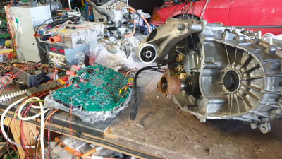

Just a model 3 inverter with an OI board running a model 3 motor.... nothing interesting:)

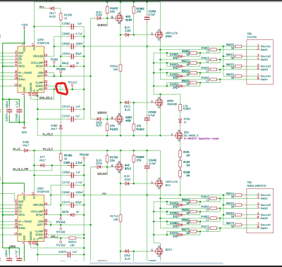

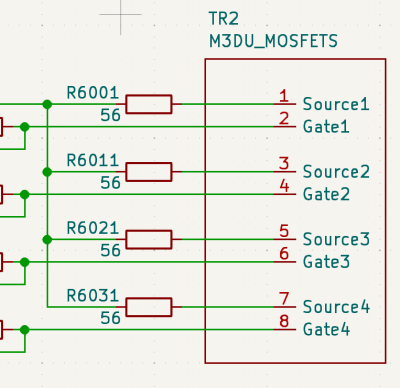

For those interested current V2 board schematic. Not finalised yet but has corrections from V1 and now all component values and types populated. Basically the current board minus the bodges:)

Given the sorts of issues with the high-side SENSE pins being not connected properly to ISOGND we saw the other week it would look like:

Thanks Dave. I'll get this in the board. Should have the V50 ready for tests this week. So far I once accidently (and once on purpose) shorted two phases with a screwdriver during low voltage bench tests. Trips off the inverter and restarts no problem.
- Posts: 3831
- Has thanked: 75 times
- Been thanked: 696 times
V50 is in the barn at last. Will setup for a closed loop spin in the next few days.
