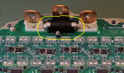

Do you have any thoughts about the sort of pyrofuse, placed in the newer rear inverters? Would you transfer it to your design or remove it? I mean, it simply goes away by removing the pcb
Only attached with two screws in the frame of the hall sensor.
Seems its not only placed in plaid, but also in Model 3 long range and standard range from 2022. My rear inverter is a 3D5 from 2022 and has it.
I'm in a little research at the moment. There is an additional circuit on the right side of the pcb. Connection of the squib is wired in parallel to the two bigger 499R resistors.
