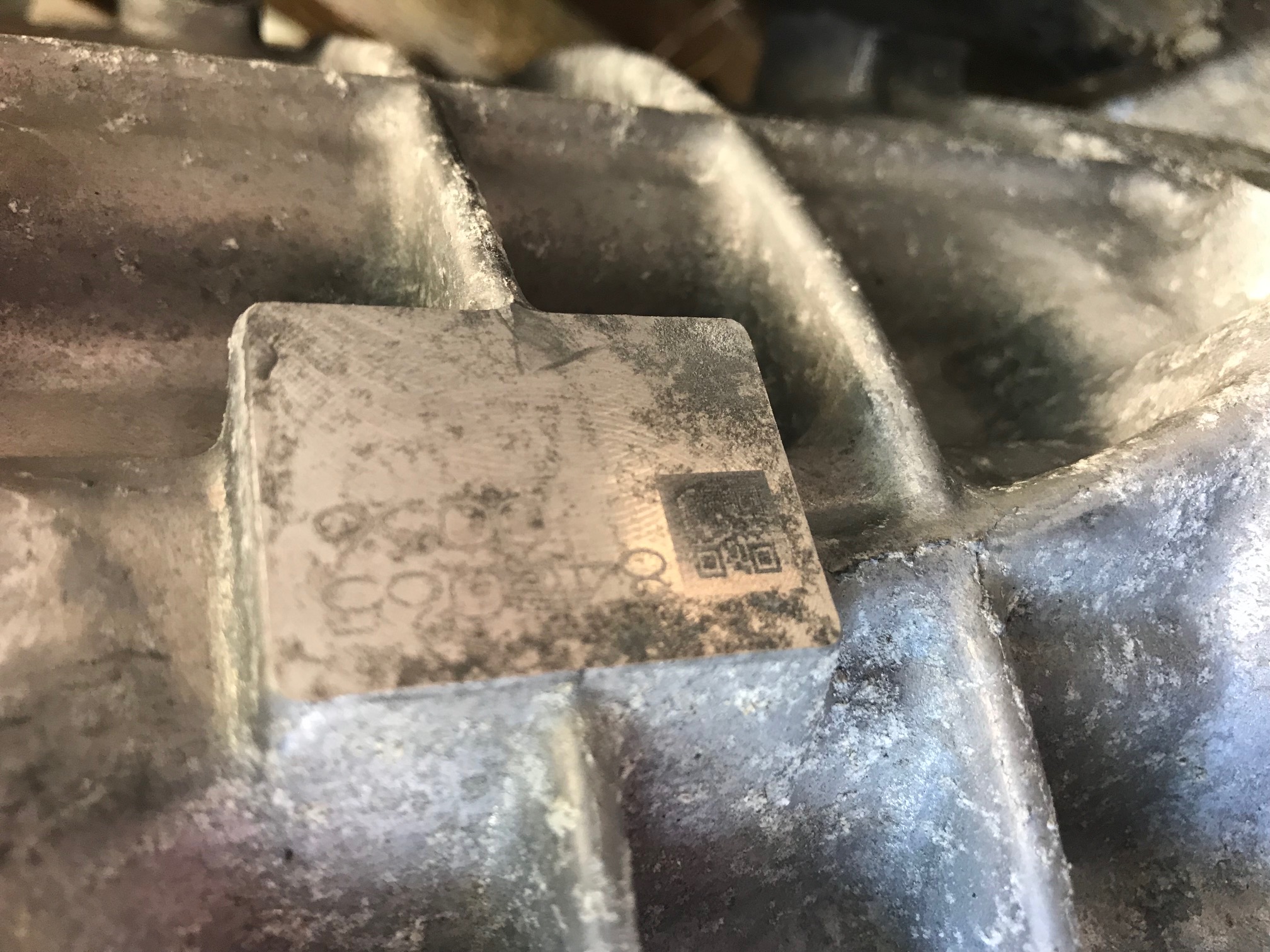

do you have a photo of them, i will check mine this evening.
D@F
Posts: 77
Joined: Mon Dec 24, 2018 1:12 pm
Has thanked: 6 times
Re: Nissan Leaf Resolver offsets
Post by D@F »
Is it that?
Posts: 6768
Has thanked: 383 times
Been thanked: 1588 times
Yes, so 8100650056 it seems?

81 or 84 i have to confirm tomorow morning
D@F
Posts: 77
Post by D@F »
I Check it and is 84.

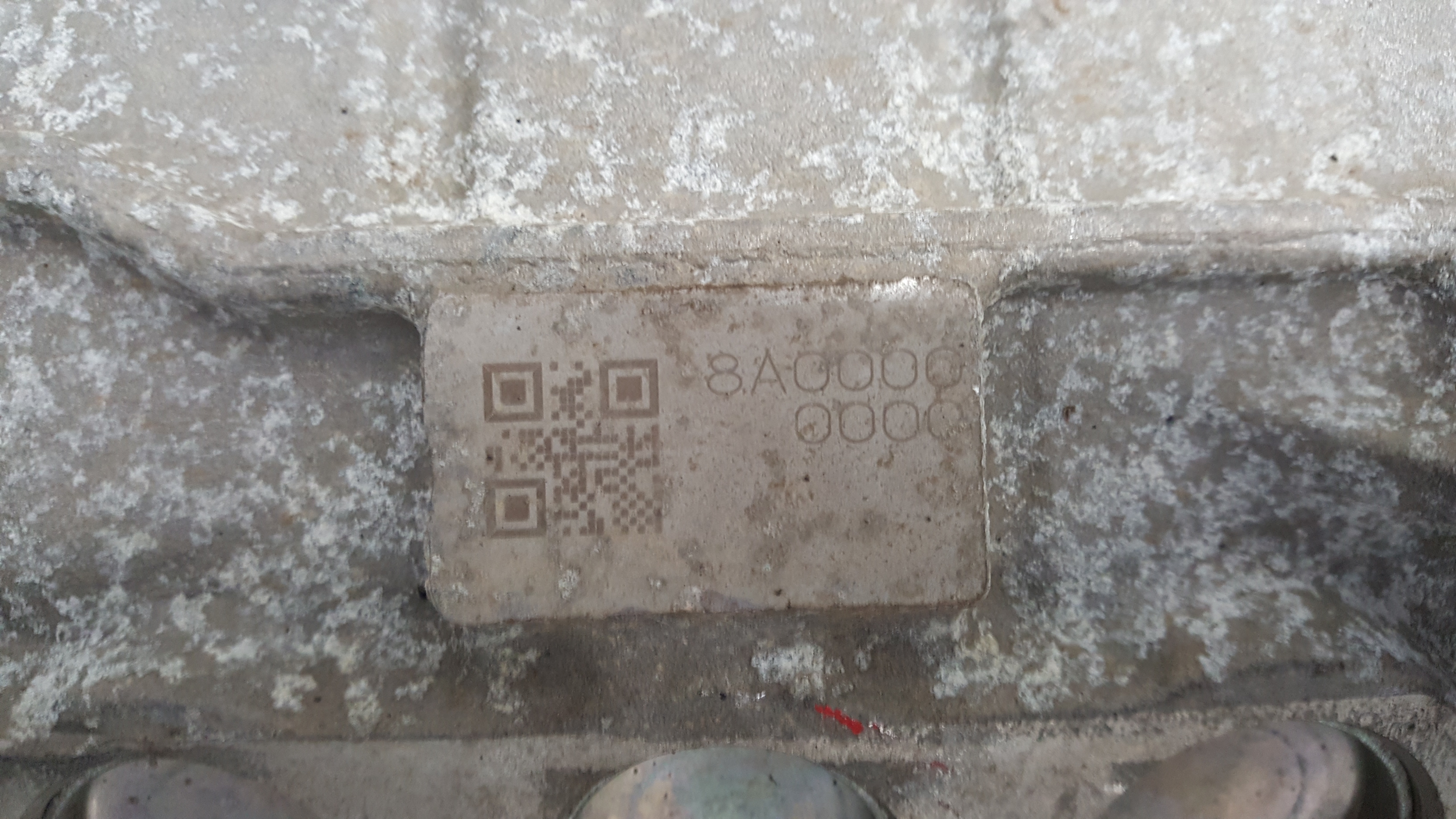

Here is mine. Gen 1 leaf.

I have a motor Gen1 EM61 with offset code
8E00000000
