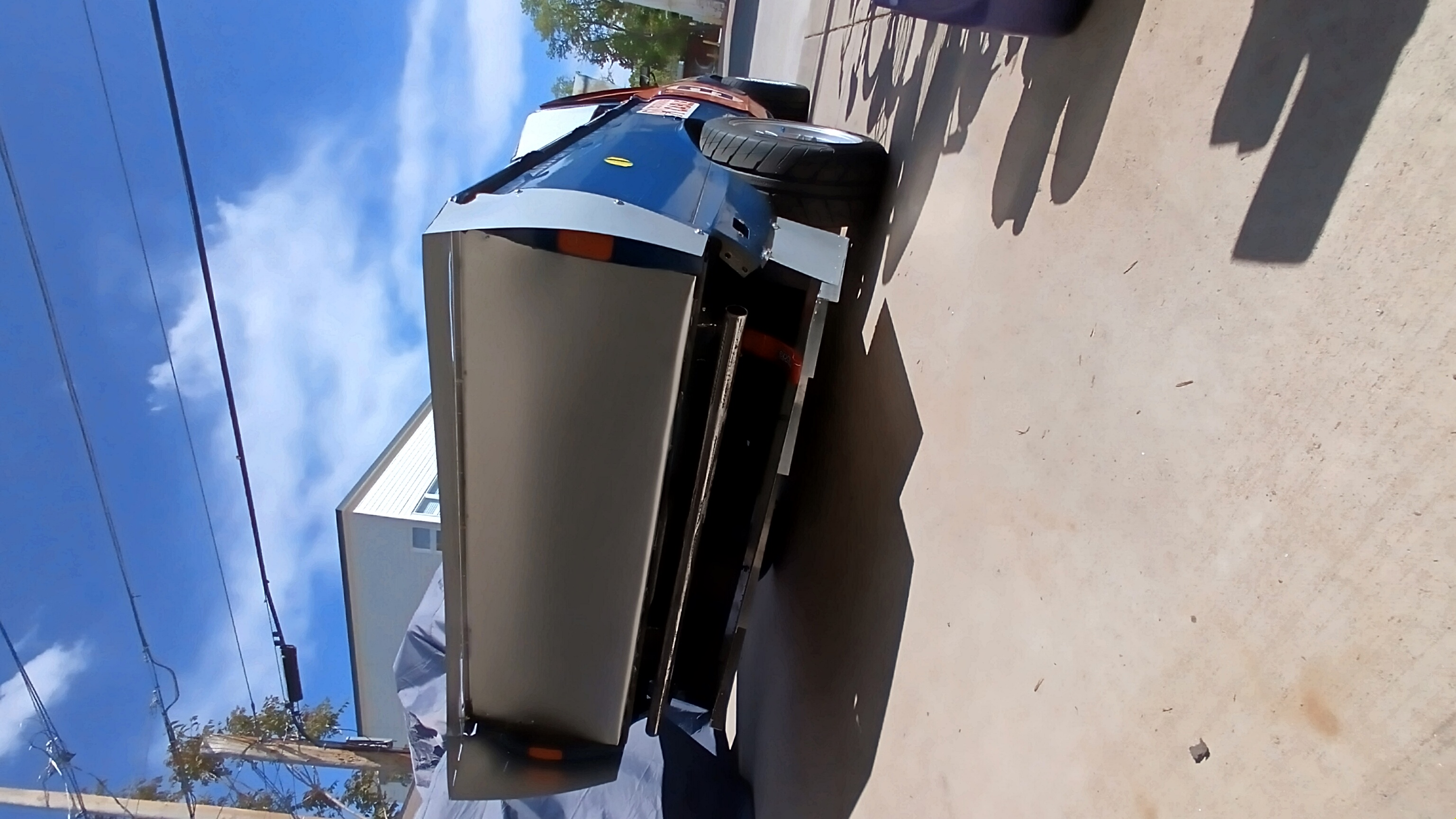

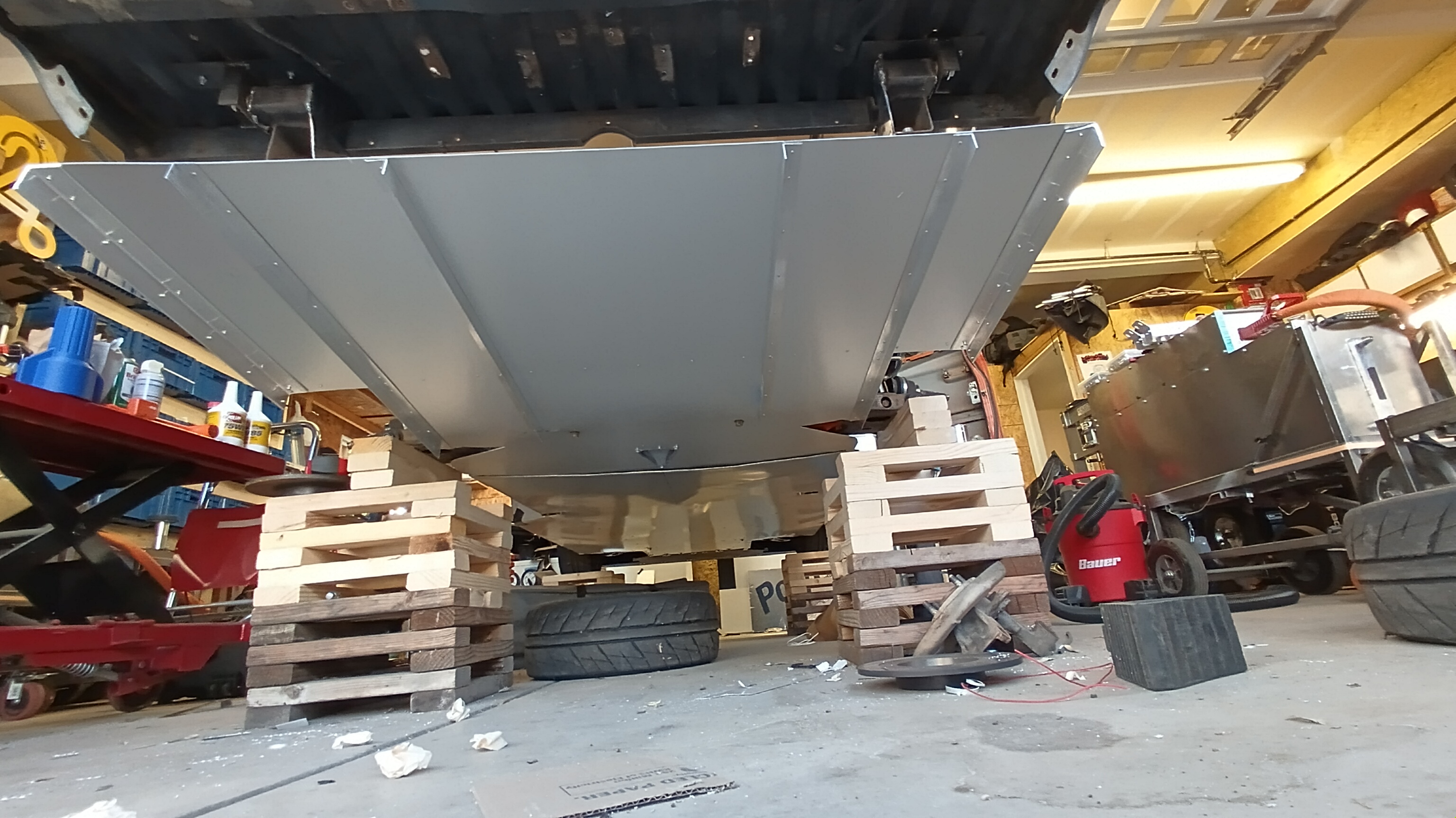

We ended up setting the new EV distance record at 1094.5 miles! Really stoked for that. We also finished 7th in class which is amazing for us considering we effectively have only 60hp when we're trying to drive efficiently.
We made a ton of aero mods to the car from the front splitter, flat bottom undertray, rear diffuser and tonneau cover and they all seemed to have worked in lowering our aerodynamic drag but we will have to look at the data to know for sure. I don't mind bragging but by "we" I mean I basically designed and built all that stuff singlehandedly based on my extensive YouTube watching experience
bonus points for nothing falling off!
