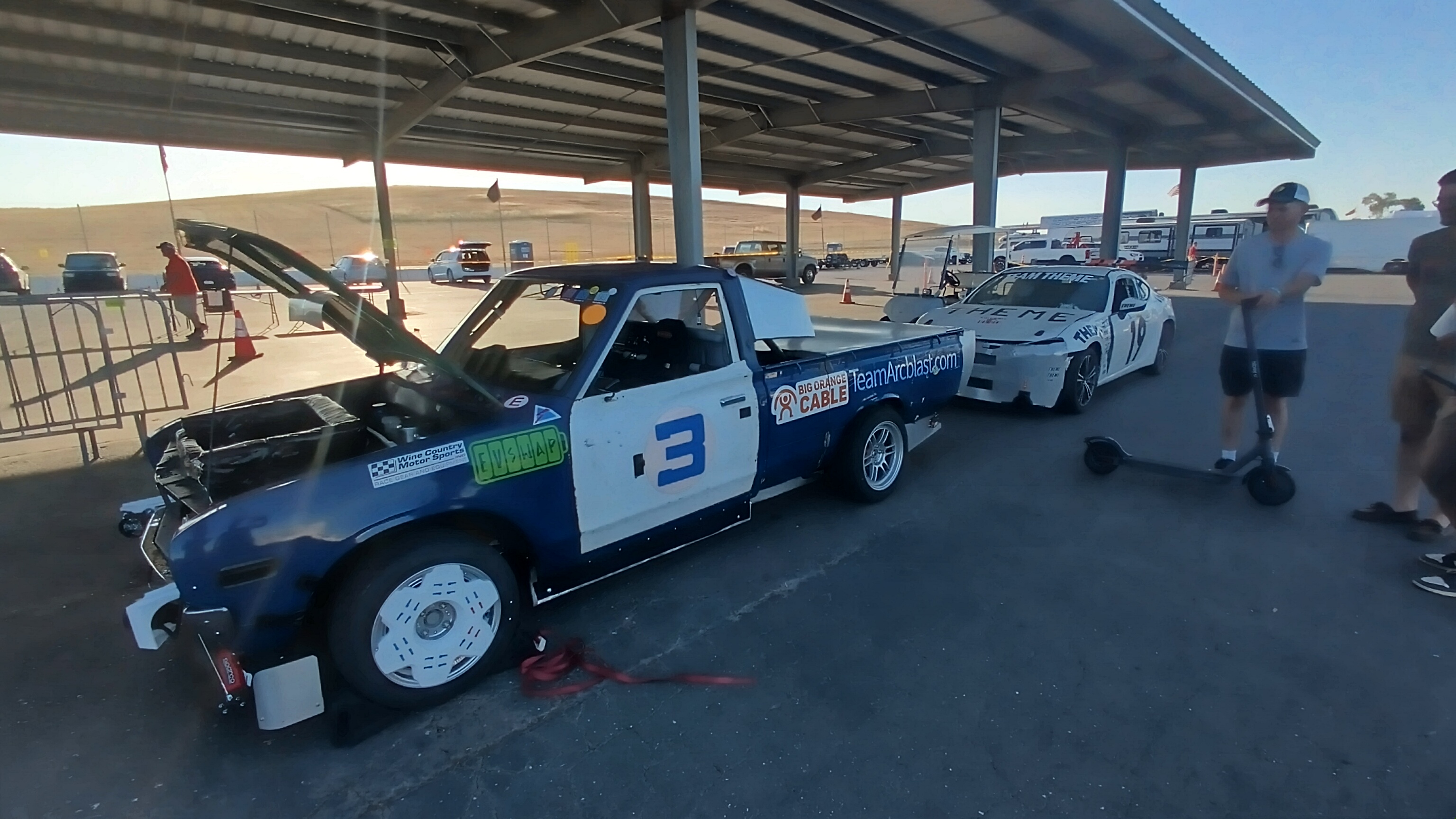

Follow along with Team Arcblast for the next 25 hours and 1 minute of racing with our EV converted Datsun pickup at Thunderhill Raceway.
Link here:
https://www.youtube.com/live/vM-0qRTxKP ... 4q7Z4GvWFH
The racecar is powered by custom batteries that we swap out during pit stops. Hyper9 watercooled electric motor, Orion BMS and Jaguar I-Pace battery modules with approximately 32kwh which lasts about an hour at race speed.

We're in place 45 overall, 8th in class! So far the battery chargers have been keeping up even with throwing the breakers multiple times per hour. Been running 10 hours straight so far going into the night shift.

We just passed 1041 miles! Still holding onto 7th in class, 38 overall. Hour and fifteen minutes left in the race. We are on track to finish. About an hour ago we lost one battery due to the contractor welding closed so we're down to 2 batteries but should still make it to the checkered.

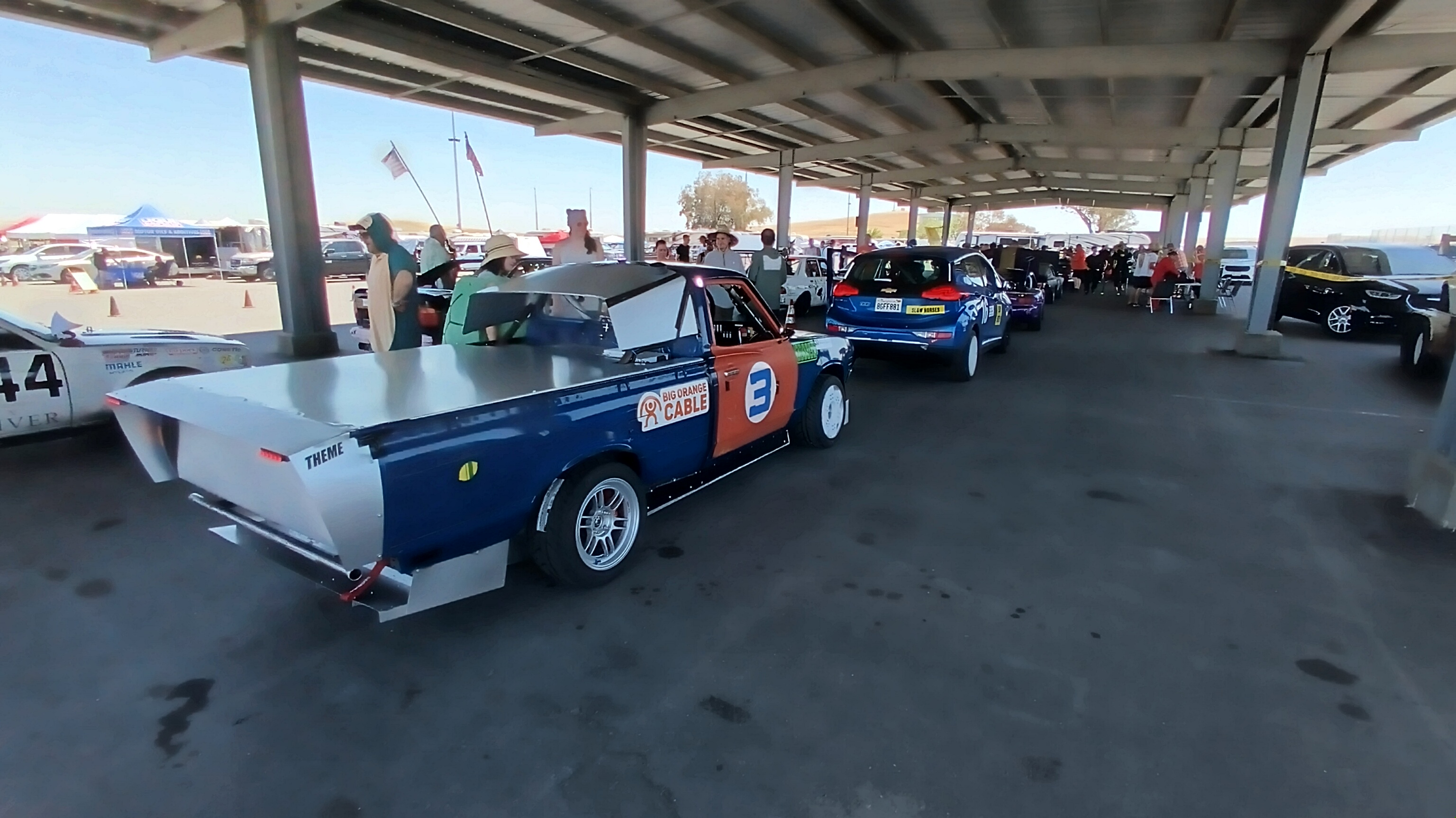

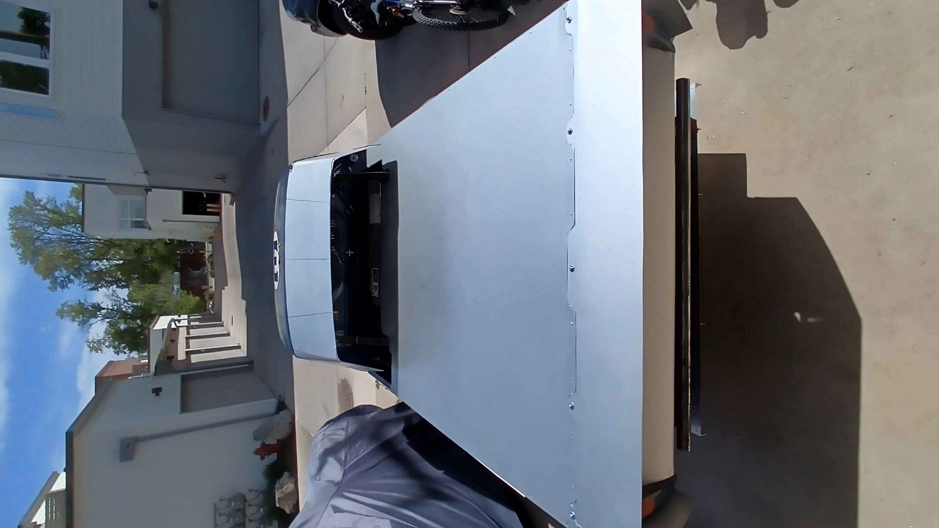

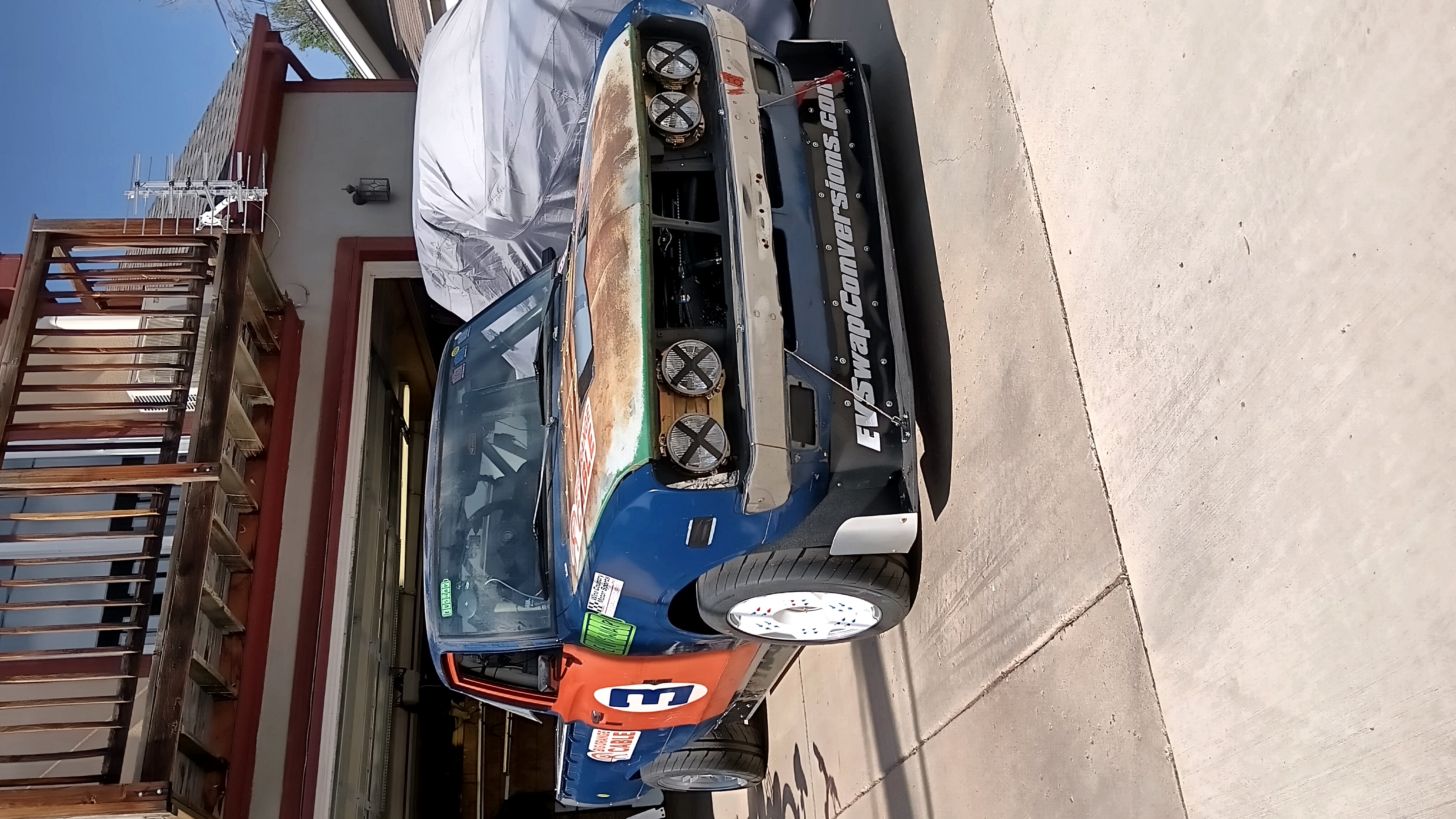

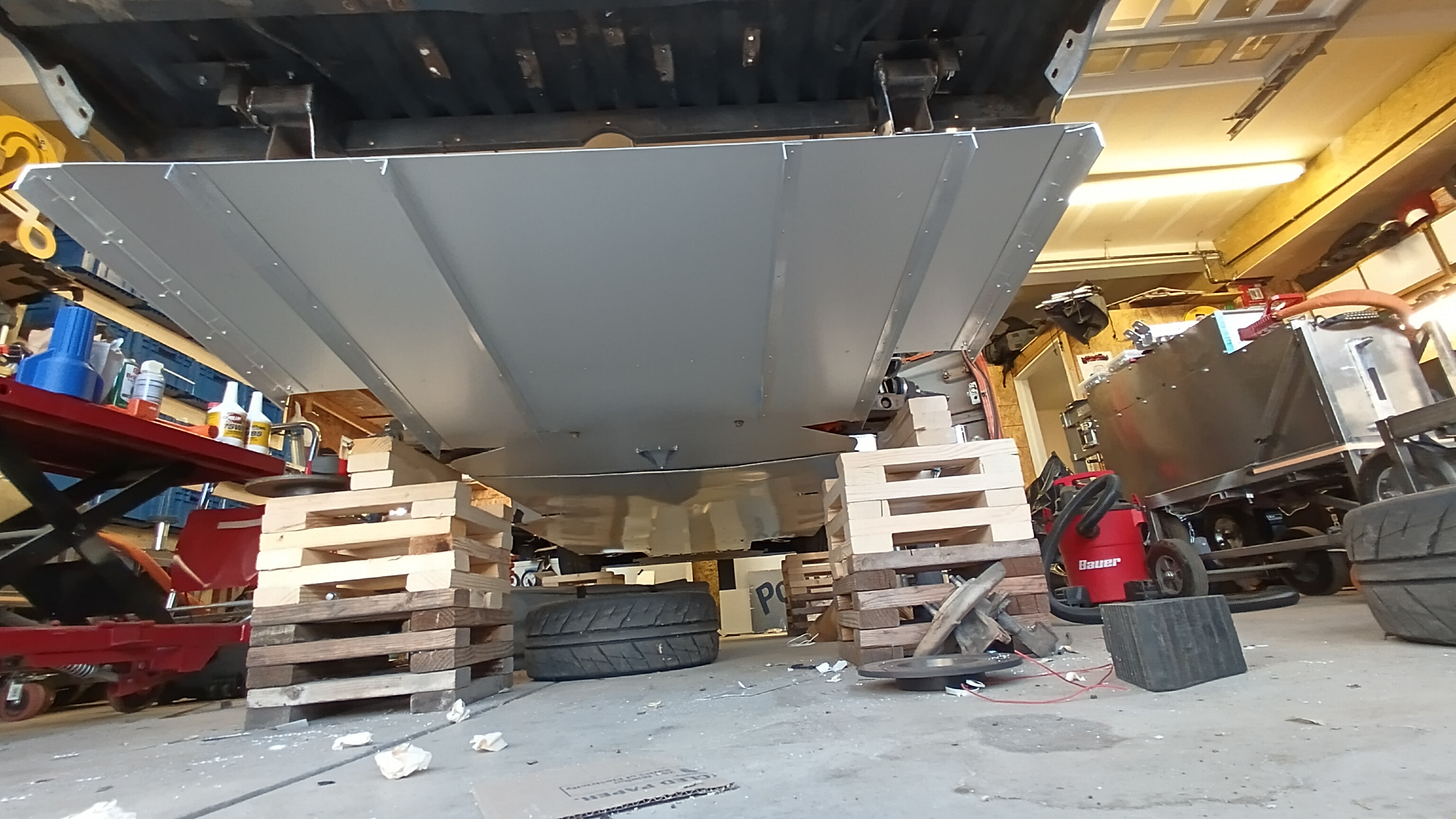

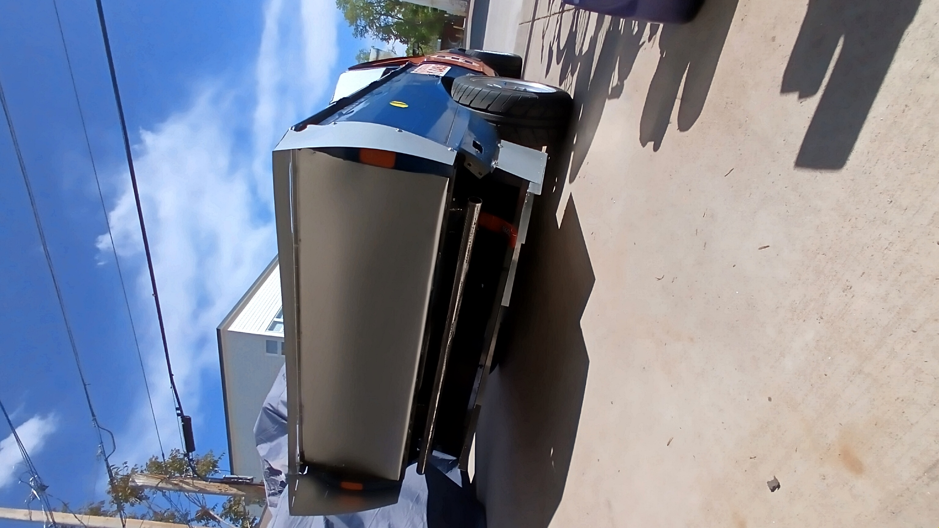

We ended up setting the new EV distance record at 1094.5 miles! Really stoked for that. We also finished 7th in class which is amazing for us considering we effectively have only 60hp when we're trying to drive efficiently.
We made a ton of aero mods to the car from the front splitter, flat bottom undertray, rear diffuser and tonneau cover and they all seemed to have worked in lowering our aerodynamic drag but we will have to look at the data to know for sure. I don't mind bragging but by "we" I mean I basically designed and built all that stuff singlehandedly based on my extensive YouTube watching experience
