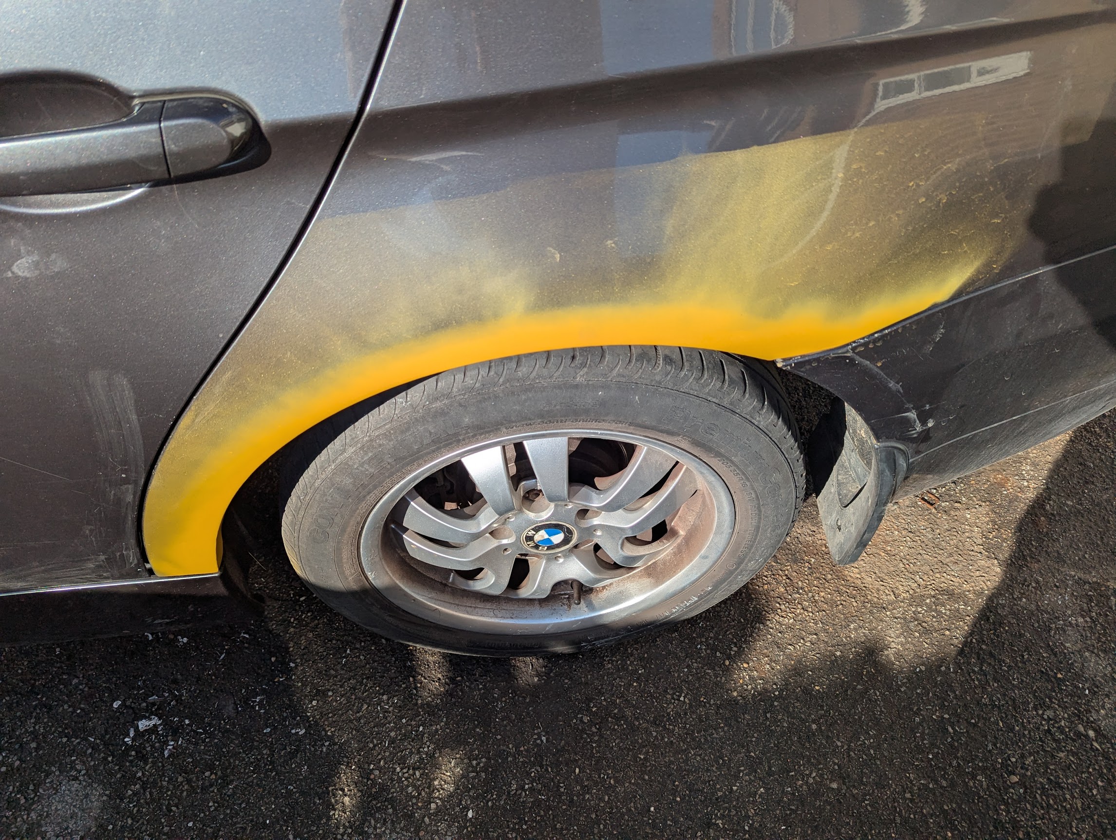

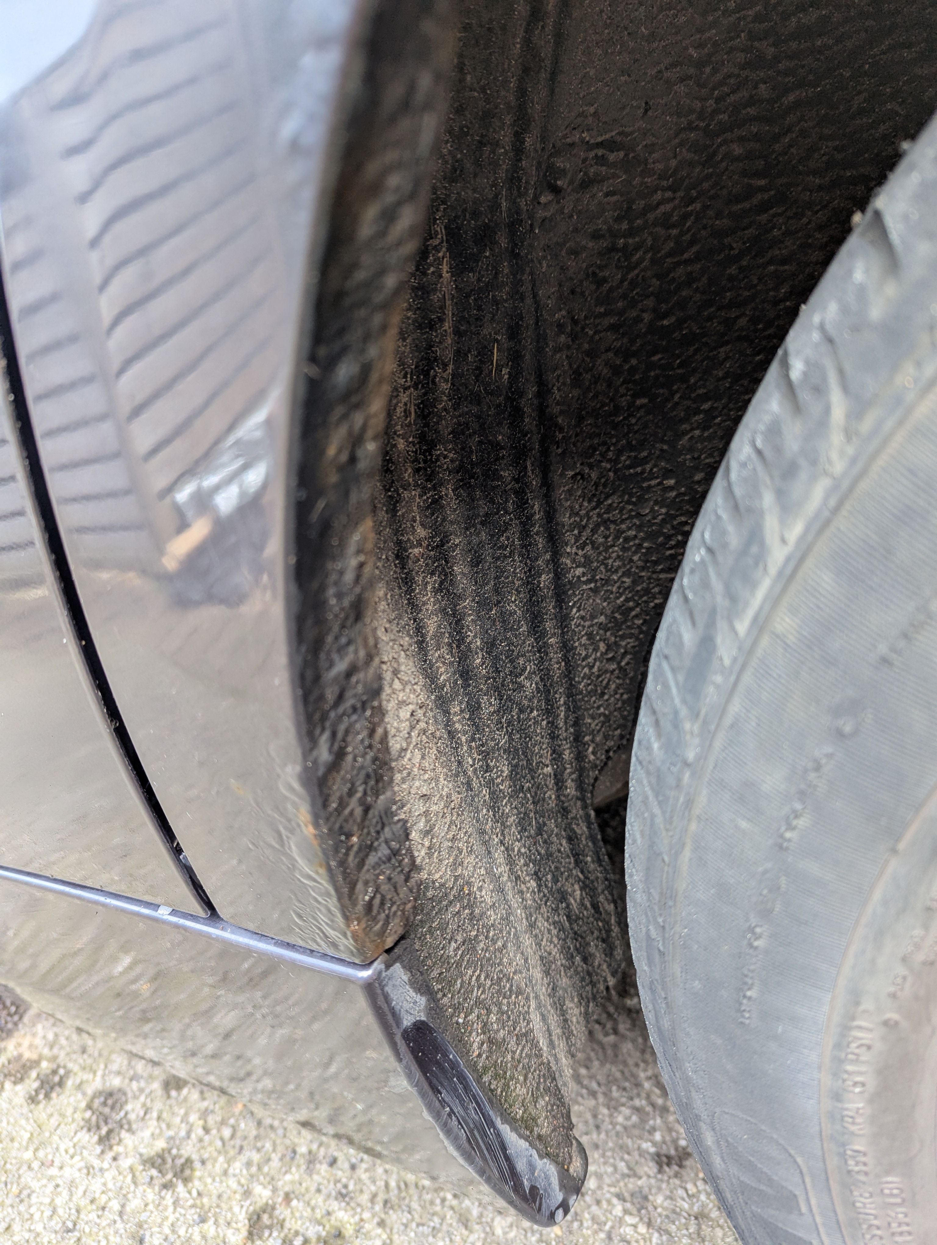

So, the first year is almost over and renewal time for the insurance, looks likes it's going to be £1000 again.
Over last few days I've been tackling the rust on one of the rear arches.
Thankfully it was just surface rust.
Not perfect, but a lot better.
