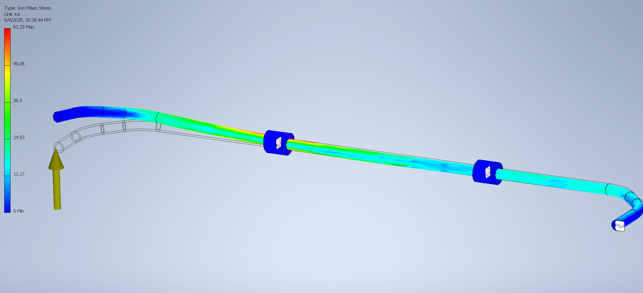

Hmm, I started modeling the bar in CAD and I'm not so sure about the result. I got a good rule of thumb that the bar should have a spring rate of about half the wheel rate, so I'm experimenting with different concepts. Found some torsion tubes that look promising but I think the biggest challenge right now is that the bushings can't be as close to the ends of the bar as I want. This causes stress concentration as the bar tries to bend up or down while it twists - see the red zone here:

Of course I also would have expected to see the same bending issue on the right hand (fixed) side, but I don't. Need to figure out what the hell. I built the simulation by adding bearing constraints where the bushings are, fixed the hole in the right hand side and added an upward force to the link on the left. Then I adjust parameters until I get about 1" of deflection for a given force applied, so I know the lbs/in rate (which changes depending on where the swaybar connects to the control arm). I think that's a valid way of doing it but it seems then that any swaybar is going to have trouble if the bushings aren't out really close to the plane of the end links. Also, this is only one inch of deflection, each side has some 4" of total travel so there would be more possible deflection in the hardest corners.
For the above bar, I moved it to the front of the frame so the arms could be longer, and shortened the arms to match a common splined torsion tube size, but IRL it would hit the shocks or the steering tie rods.

The bearing constraints look to be fixed for whatever reason. I'd focus on those. Maybe draw a concentric ring, set as polyurethane then fix the poly? Or fix the od of the poly?
The bushings look reasonably spaced but will be worse with the arms bent out.
I think you need to bend the arms out. If you match their angle to max steering angle / parallel you should be able to not worry about high link angularity and steering interference.
Edit
The 1" deflection is a common measurement method for swaybars, that's good. My performance bars look to be from .3 to 1 ratio to the springs so not a bad starting point at .5
Yes, bushings should be as far out as practical.
The swaybar resists bending by linking the 2 springs together. So your full suspension travel will be resisted by the swaybar. You don't look at it from the 4' deflection (suspension travel) possibility but the total spring resistance bar + spring) or the vehicles front end roll resistance / force. From the roll resistance you can get the roll angle. That will give you the bar travel. And with an infinitely still bar you can only ever have 2x your spring rate unless it's on bumpstops. Then those go infinite and the bar kind of is taken out of the equation.

Hm, good point, the bushings will have some give. I might be able to model that directly, have to look into it a bit more. Else I will just model up the bushings and do as you suggested. I also like the idea of the pipes that have the swaybar run through them and then bushings at each end, makes it easy to get the support further out, and yeah, as you say, bend the arms.
Also tried going back to the tubular bar but changed the bends a bit and maybe if I redo it with slightly compliant bushings, it will look better. I also thought of another way to mount my endlinks, little piece of angle welded to the back of the wishbone. Then I could even play with mounting the heims on the inside or the outside, for some extra adjustment.
edit: Ok just tried the default silicone rubber material and wow, there's 1/2" more deflection for the same force, and the highest stress is centered on the bushing. I guess the hardness of the mounts can play a pretty big role too. Never knew it would be that much!
Haha, so that might mean I need to shorten the arms a bit to get the rate back to where it needs to be. Angle bracket on the back of the wishbone might not work afterall. Oh well.

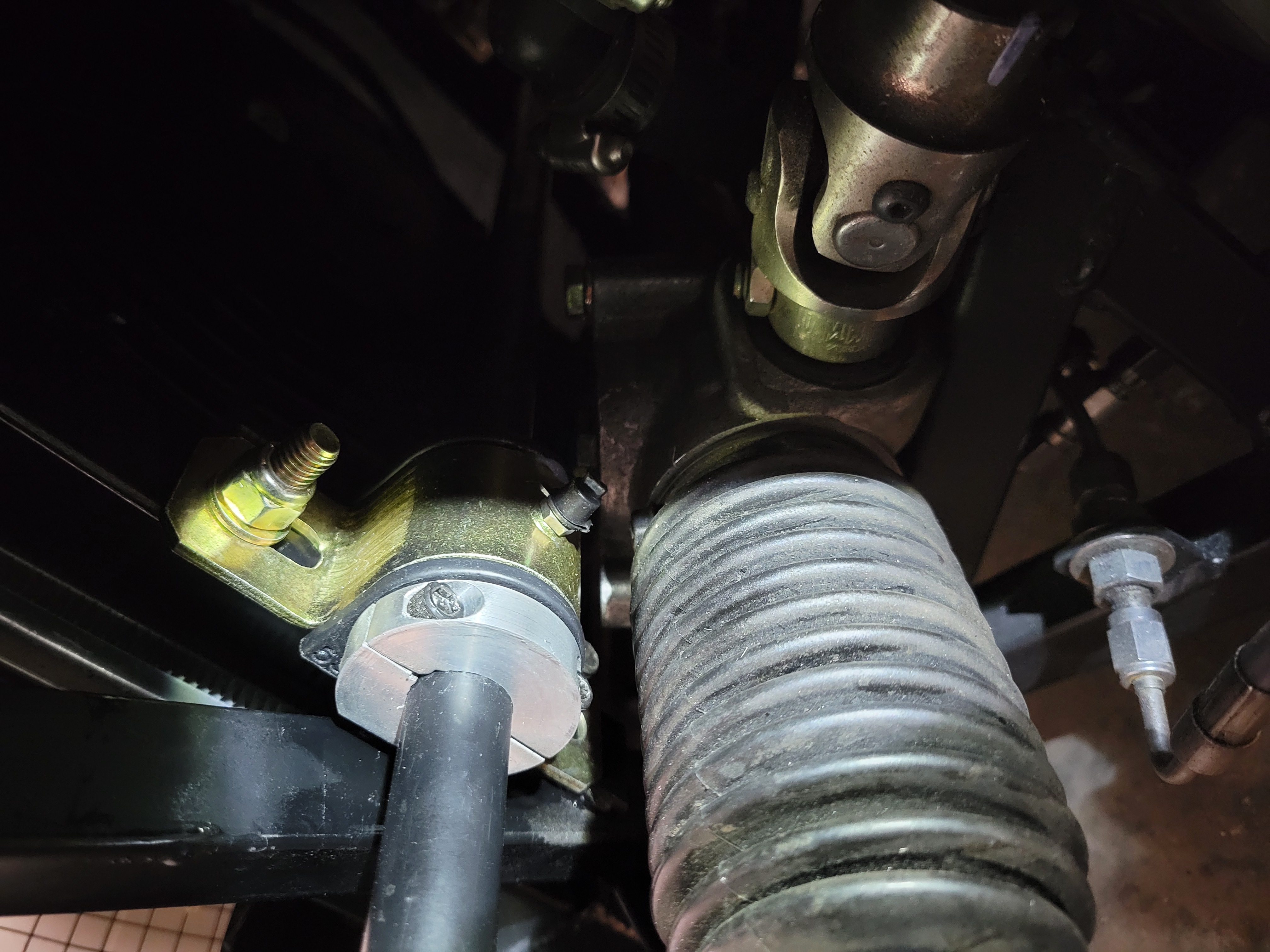

Swaybar bent up ok, despite using a ram-style pipe bender. Probably thanks to the heavy wall. Nobody in town carries chromoly in that size apparently, so I went ahead with 1026 for the time being. Due to the way the bender works I wasn't able to get an exact estimate of where to put the center of each bend, so I did one bend, measured to my reference, did the second bend, and the damn thing still came out an inch too wide. There's still a bit of clearance to the coilovers though, so hopefully it works until I can get some chromoly to make another one. Also, I spent some more time thinking about the principles involved, reading more, and it clicked a bit better now how they are supposed to work. The idea isn't to just transfer 100% of the force from one coilover to the other - the bar itself acts a bit like a spring too, and not just as it acts between the two sides. If you hit a bump straight on both ends swivel up and nothing happens, then in a turn one wheel goes up but the other doesn't, causing twisting and bending on the bar. A lot of that force goes into the car through the mounts, rather than just transfering to the other side. I had to look at the reaction forces in my simulations and try adding an opposing force to the other end of the bar before it really sank in. Also, shortening up the bar allowed me to reduce the bending moment/max stress in the bar, and I only need to worry about an inch or so of deflection now. Numbers also worked out pretty good, though I did add a hole to my bracket so I can connect the end link to the center of the wishbone if I decide to go way stiffer.
I was a little rushed with these brackets but they turned out good enough. Seems to clamp pretty tight so hopefully they last.
Bottom joint is a bit close to the bracket, but the nice thing about the swaybar size is now I have a bunch of 3/4x1/2 tube that I can use to make some small spacers. Already did that for the heims inside the upper clamp.

Yes, a swaybar is like a spring to transfer spring rate from one side's spring side to the other side's spring. A swaybar lowers the cornering weight transfer that happens on that axle which helps resist sway but lowers grip as the stiffness goes up compared to the other axle. It keeps the weight more balanced between the tires while cornering. The balancing trick is getting the axles weight transfer to balance cornering and keep the tires more in their sweet spot of downward (weight) to cornering force the tire can make while also watching tire lift off the ground. Tires make more cornering force ratio to weight at lower weights and it starts to fade as the weight goes up. Feels like a lot of circular / looping thinking for each piece of understanding these things.
The bar and bar adjuster link ends look great!
One of the bending tricks is to mark the tube every inch / cm before you bend with something that won't bleed through paint later. Mark some reference line with another color to your bender die as a starting point reference then bend. Then you can see where it bends from where you started and what length you lose / gain from bending.

Took the car for a drive to test out the new sway bar and WOW what a difference! I guess I must be somewhere in the right ballpark because it was stiff enough to be immediately noticeable but not so stiff that I felt like it's going to understeer. Of course I won't know for sure until I can get it on track.
Also made some split shaft collars to clamp on the swaybar to prevent it moving side to side. Due to my error making it wider than intended it's close to the springs but doesn't seem to interfere. I could have bought collars but I figured I had the material laying around so why not. I did have to flatten the side that faces the frame rail for a little extra clearance in case the bushings deflect a bit. It's interesting because the reaction force at the other end of the bar is not the same as the upward force being exerted by the outside wheel in a corner. I think that's the part I really had to get my head around, and I suppose if those forces were the same it would just be a rigid connection. So now I get why the material used in the bushings matters so much! I'm really glad I finally tackled this, wish I had done it years ago. Was afraid to attempt it because I didn't understand it well enough to design.

Okay, so it turns out that what happened at the end of my last trip to Helena was, the bolt on my rear toe adjustment link broke. It was still kind of holding on which is why I couldn't immediately tell exactly what happened, but upon taking it apart it was obvious. Also, because the centerline of the hub is slightly aft of the centerline of the balljoints, it has some inherent stability keeping it straight, which went away when I was reversing the car into the garage to take it apart.
Oh yeah, that's no good!
So I dusted off my designs for an extension bracket and machined them from a solid piece of steel (which took HOURS on my manual mill). The end result turned out well, it's a snug fit onto the upright with a 3/8 bolt in double shear where the toe link used to connect, and a larger 1/2" heim joint mounted further outboard. So two birds with one stone - it's a lot easier to adjust this time around. It also occurred to me that because of the suspension geometry, the a-arms don't pivot around parallel axes, so the effect is the upright has to rotate back slightly. We're talking fractions of a degree here, but the clevis I had on the inboard end of the toe link adjuster didn't allow any movement in that direction, so I'm sure that didn't help matters. All fixed now.
