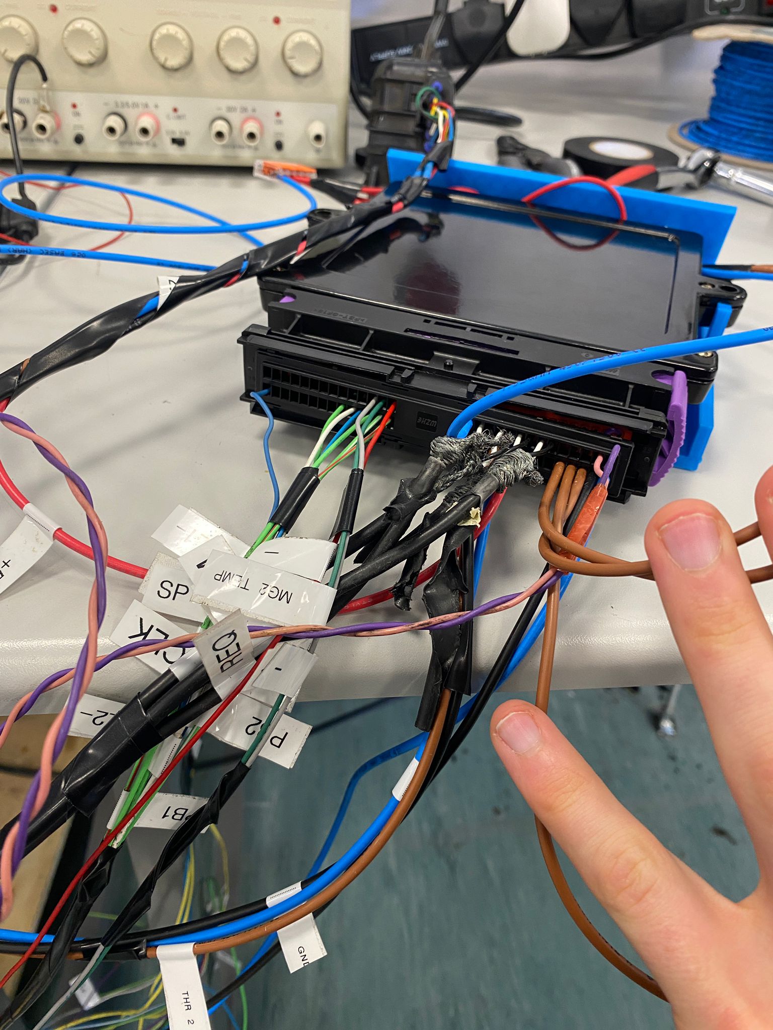

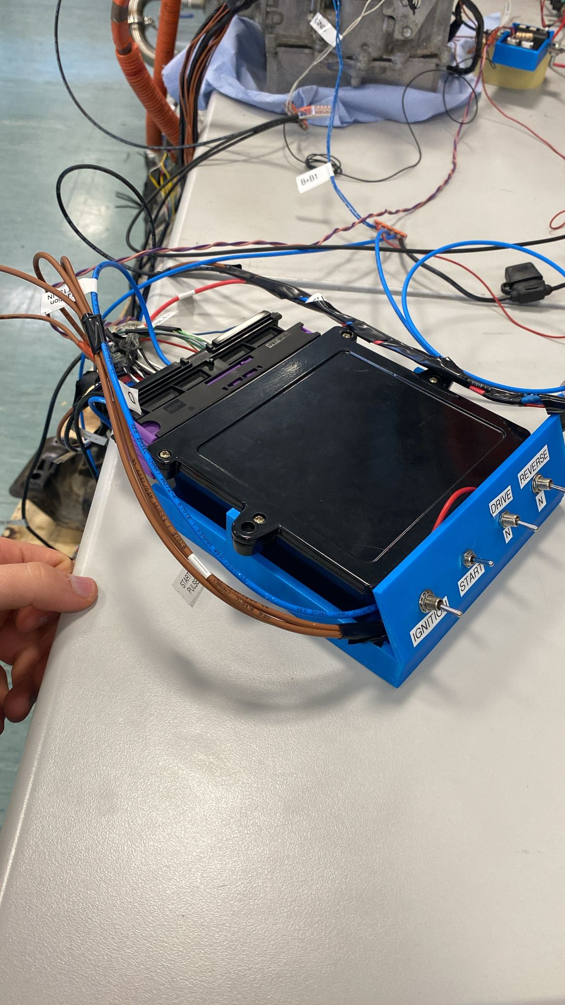

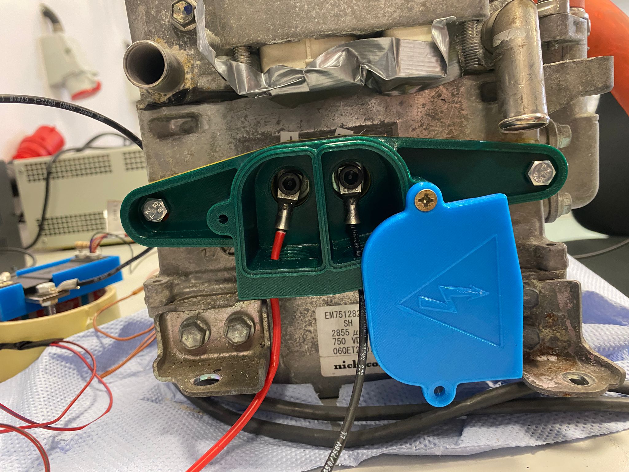

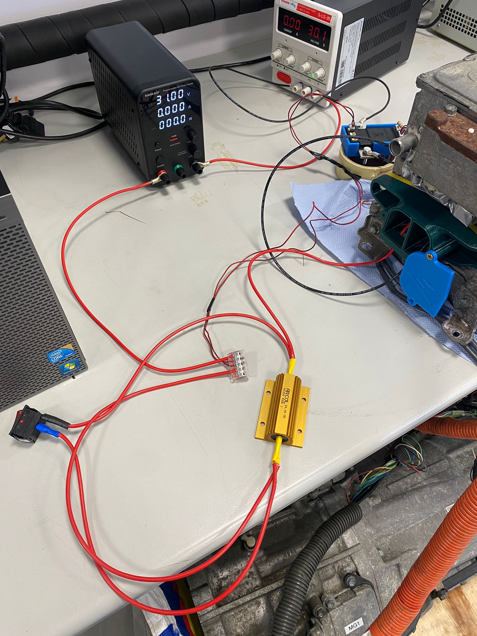

So I have grounded the inverter now properly, just giving an outline of the setup, not ideal at the moment, using two supplies to get up to 60V, but now still nothing from the inverter, and not even a current draw from the supplies. Is there a common issue where this can happen? I have attached my parameters as well for the current stage. My communication with the inverter seems to be inconsist, sometimes I will see errors for precharge and a status and other times like in the photo I have attached it is like there is no coms.
Please feel free to tear apart the photos, the lab I am working in at the moment for a professor has like no supplies and I am being told to "make use of what I have", so if there is a few connectors that are a no go please shout at me.
Thank you :)

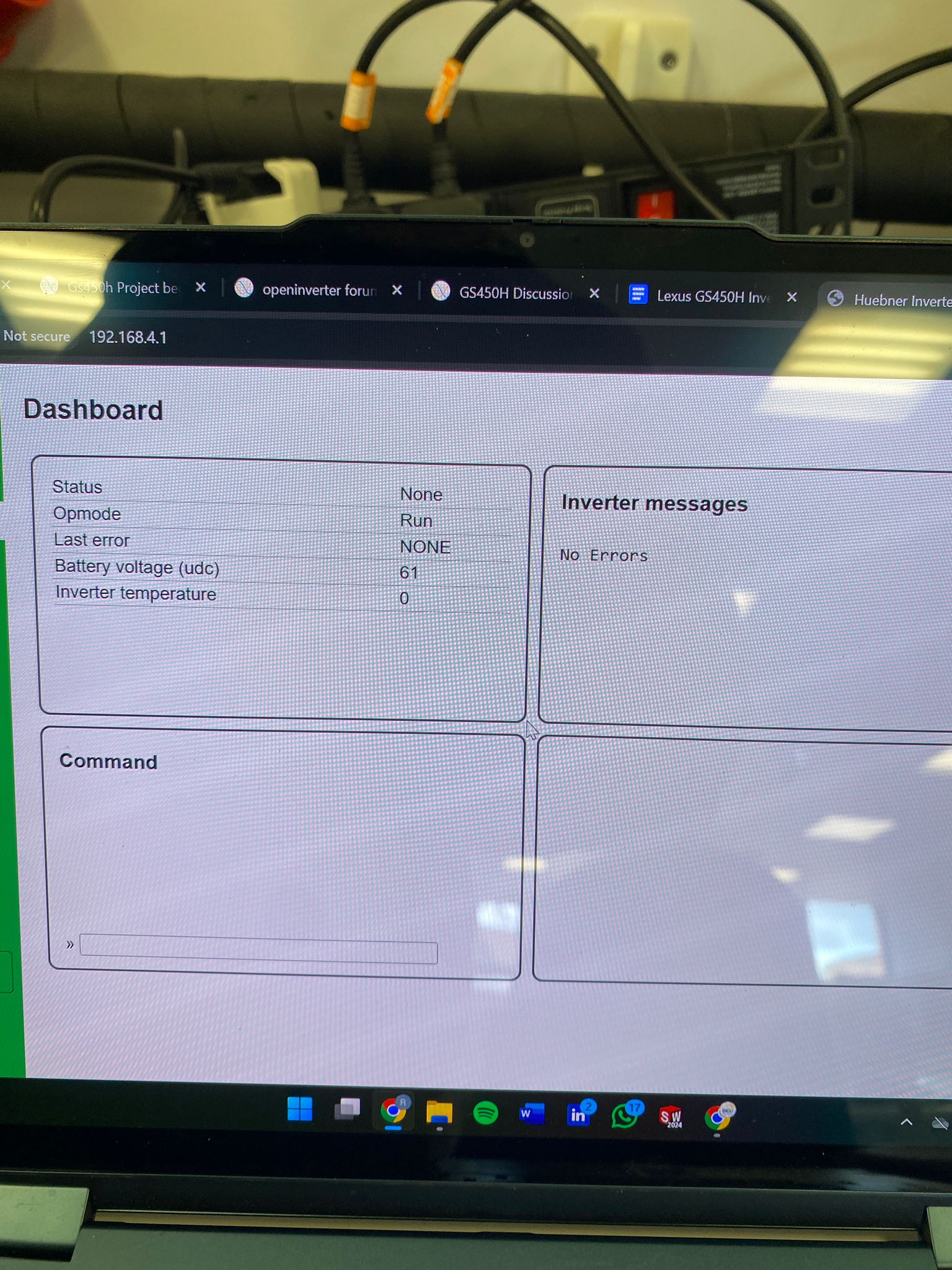

Re: Gs450h Project beginning stages
... No thats not the inverter but the Zombie Verter status.
Show you spot values.
Show all your low voltage wiring too please. Did you fully wire it as explained here: https://openinverter.org/wiki/GS450H_with_zombieverter
The wiring for UDC1 into the shunt needs to be inverter side not supply side, but for bench testing it should be fine.
For bench testing set UDCsw to 0, you are manual pre charging.
You need to get the zombieverter reliably into run mode first, this has nothing to do with the inverter comms.
Then you need to establish if you are getting information from the GS450h Inverter, spot values like INVudc and tmphs are good indicators if the comms works.

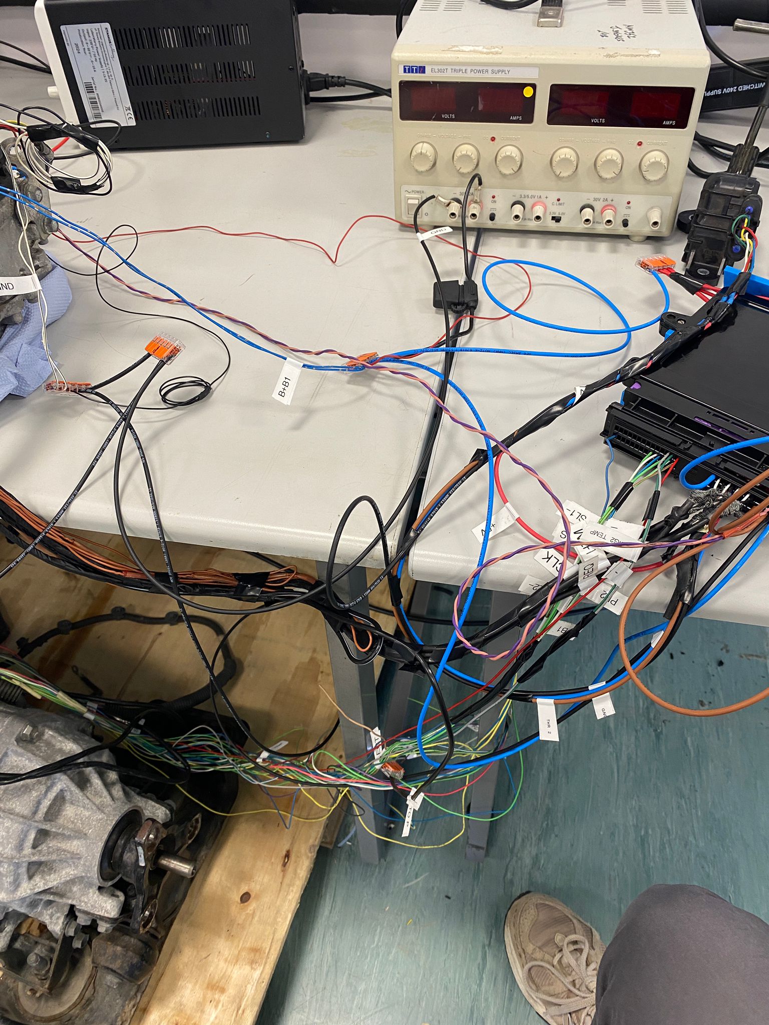

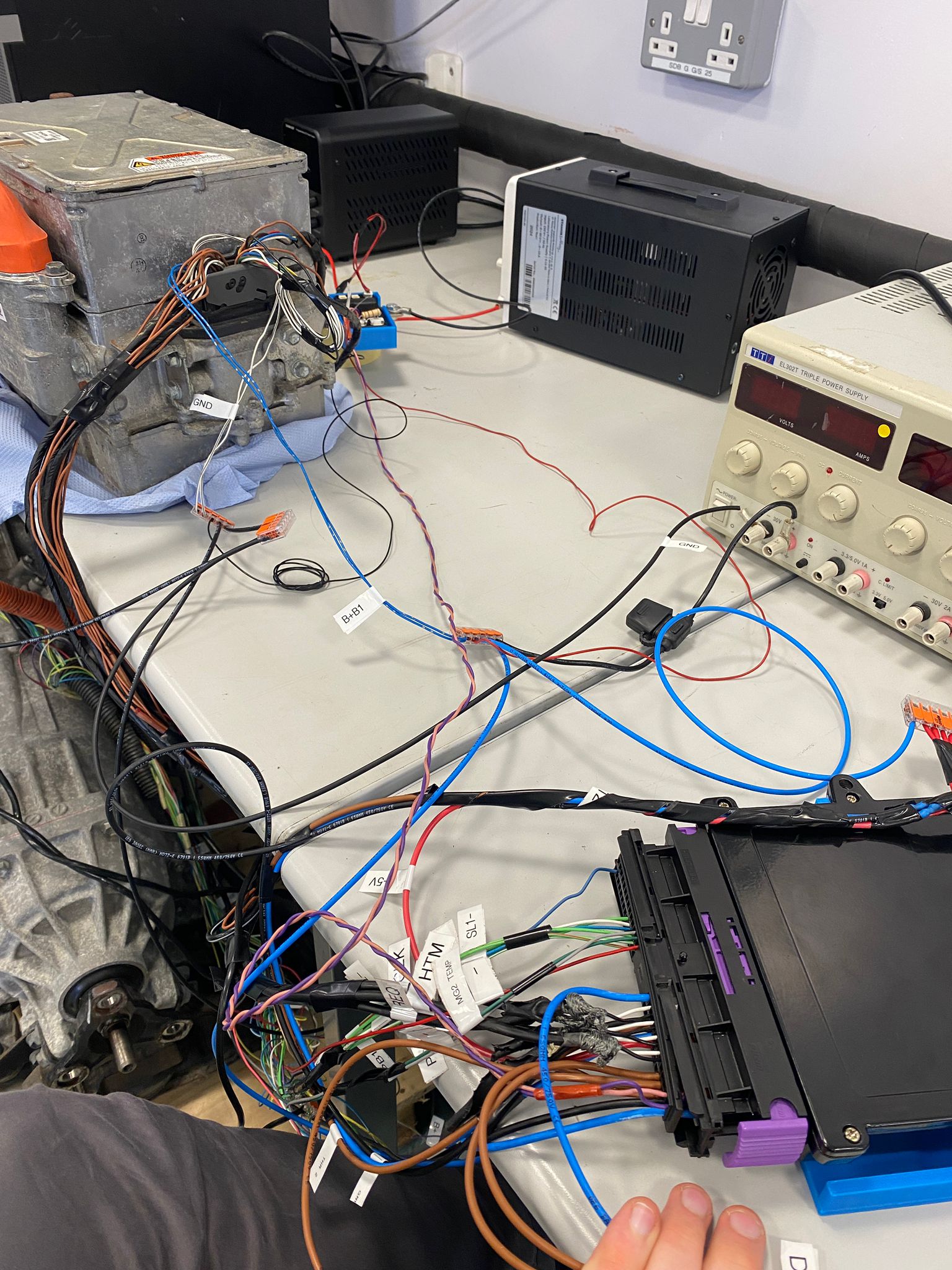

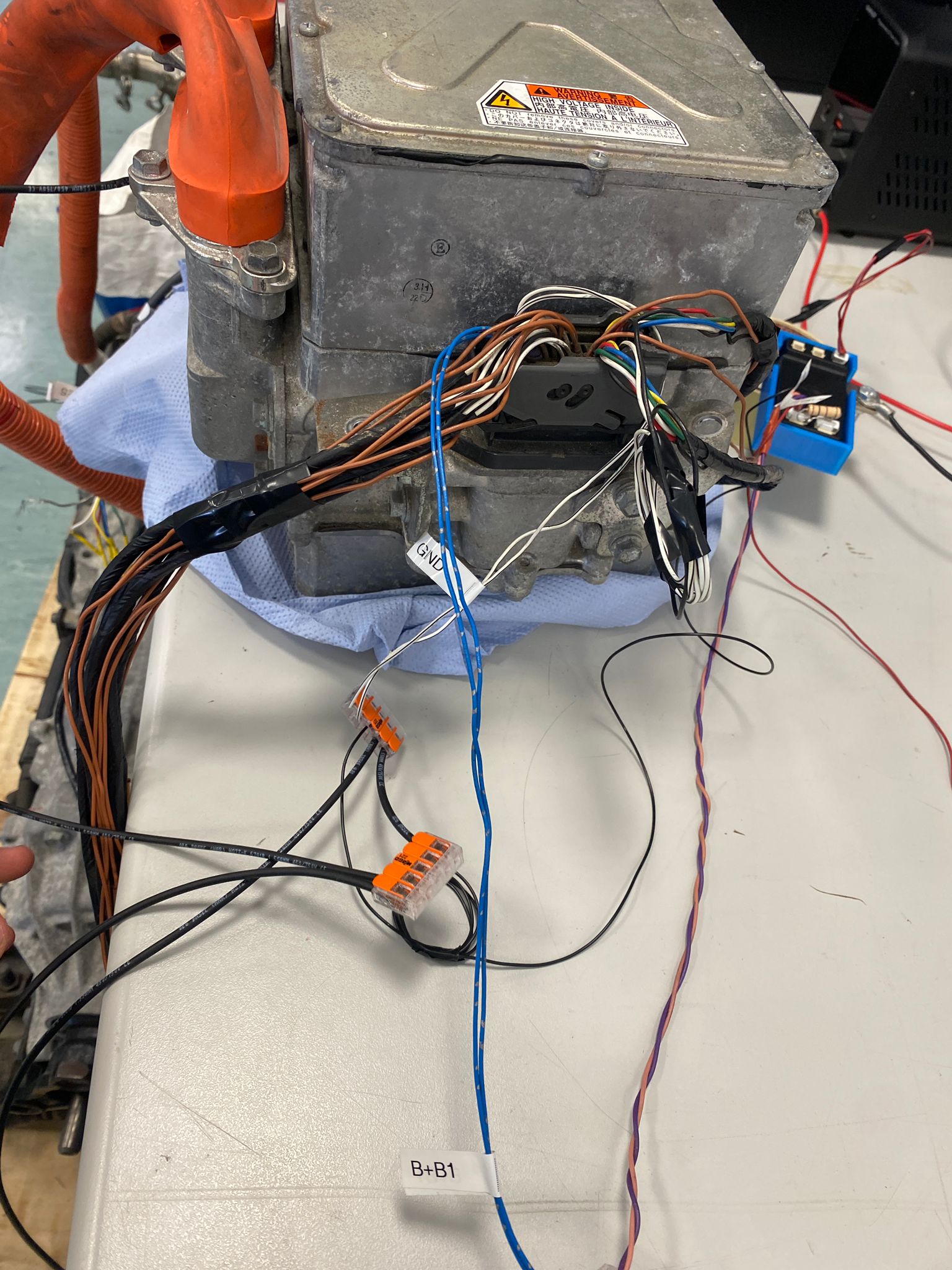

Ok so I have placed some photos of the low voltage wiring, bit of a mess at the moment but yes I did follow the wiring with the Gs450h and zombie from the start, there is a few parts of it i'm aware are missing, for example - B and B+ from inverter are not connected via a relay at the moment, they are just connected to a constant +12V that also goes into the zombie perm +12V.
I am working with the entire lexus Gs450h loom as we have the entire car, so all cables are stock for the most part including the resolvers. I have connected the inverter casing to the LV ground now as well. I moved the UDC1 to the inverter side (don't know how I expected to measure the voltage rising from where I had it lol).
I have uploaded the spot values as well, this zombie I have is on firmware 2.20.A (picked it up from where someone had it, they just bought it a while ago never started wiring it).
Thank you all
RianGill wrote: Fri Jun 06, 2025 2:06 pm for example - B and B+ from inverter are not connected via a relay at the moment, they are just connected to a constant +12V that also goes into the zombie perm +12V.
That wont work, you need the relay controlled by the zombie. The zombie pulls the relay coil to ground to turn it on at the right time.
Spot values are not useful if you do not have it in run mode or errored out also all your outputs are off.
Try changing the UDCsw to 0 and starting the zombie to see if it now enters run mode without errors.

Ok great news,
It is now working, it was in fact just the relay, seems to be running relatively smooth, still need to get a permanent lock for the input shaft done, I have the spline out from the clutch and will weld shortly. I will also redo some of the wiring to make sure all is safe.
