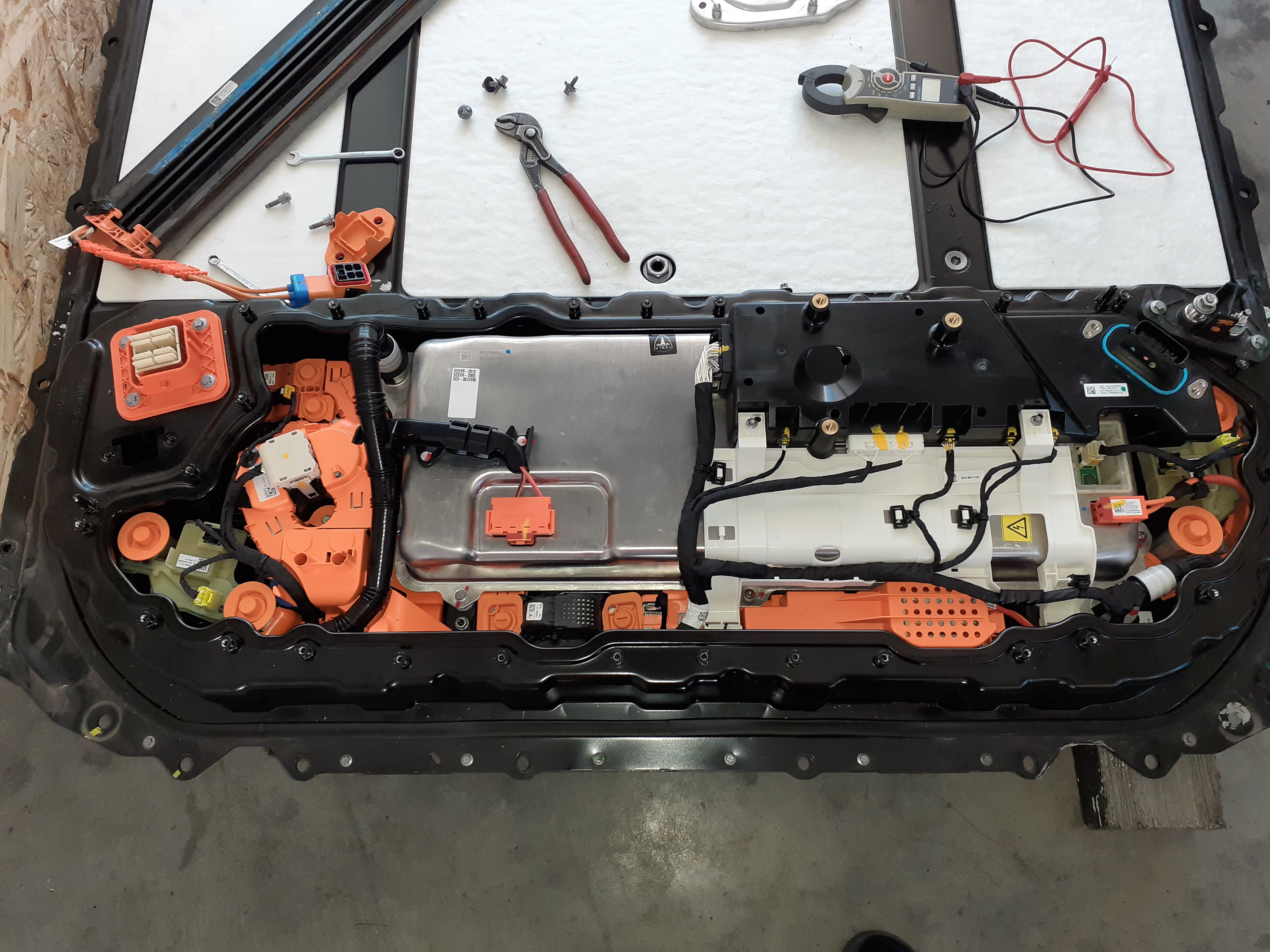

Setting up a thread to document the reverse engineering of the Model 3 battery. The specimen is from a European 2019 car with just over 20k km on the clock. We have the full guts of the battery minus the casing. First task will be putting it back together so we can begin discovering how the bms communicates with the cell modules. This will also provide a way to get some much needed info on the PCS communications with the hv controller.

The battery modules communicate via a variant of the ISO-SPI from LTC.
I have struggled myself trying to get it to work with the available dev kits from LTC, had no real luck getting it working.

I would say it be of great benefit if you pull it off. Wish I could help but almost started pulling my hair out after 8+ hours of trying to get communications.

DCA2617A with an LTC6820 on it. I have found some others who tried the same as myself and just found it too much of a struggle to get working.
I would almost think Tesla has taken the ISO-SPI and gave it their own spin, like they done with the Model S battery slaves.

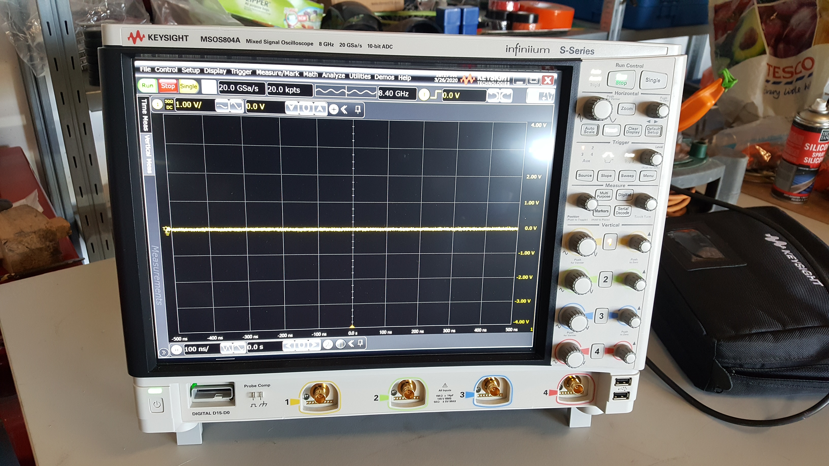

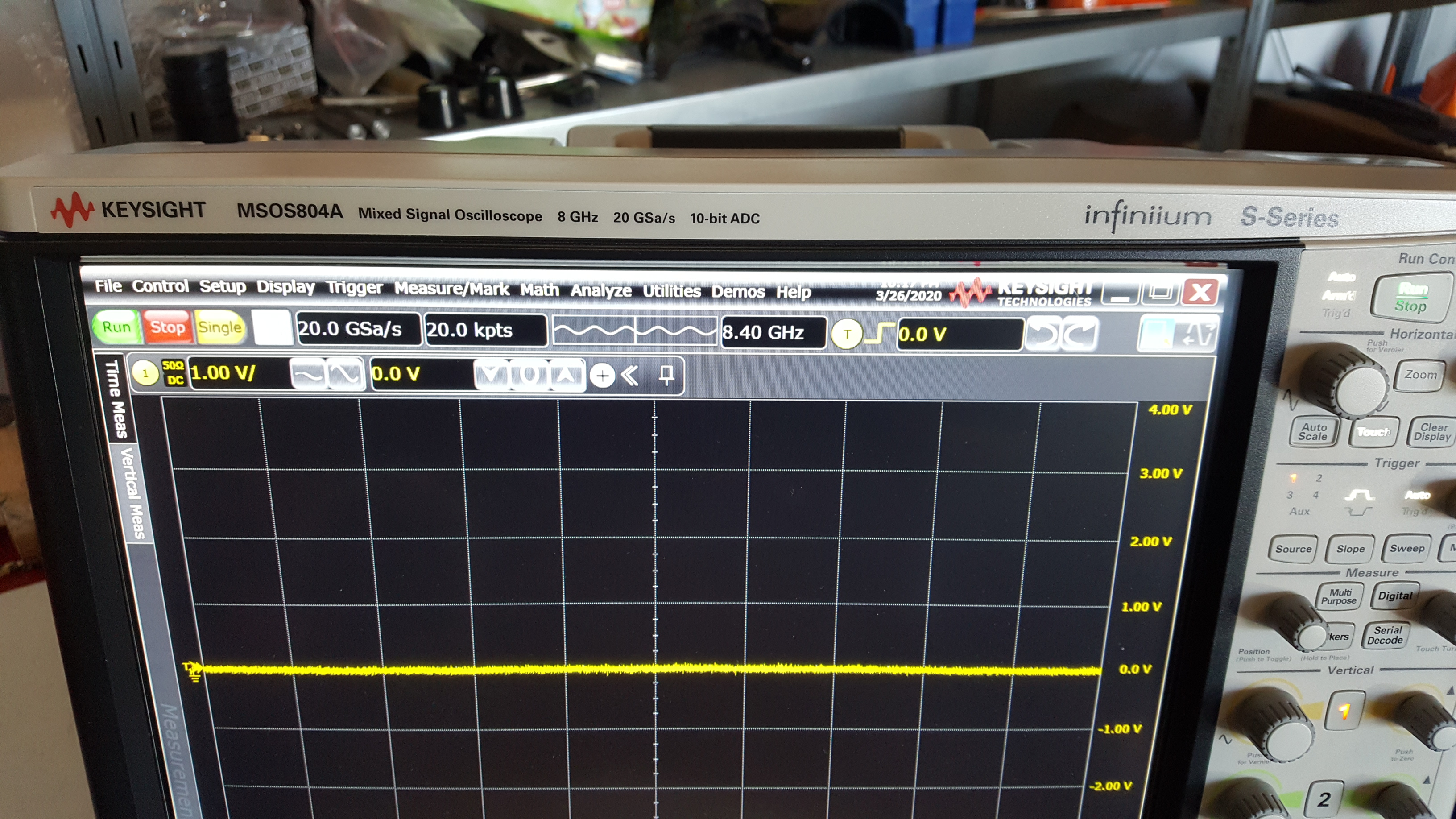

Let's see what this baby makes of Elon's weird bms comms ...

A little overkill perhaps?! That's a rather nice (and expensive) scope! : :D

WTF that's a serious badboy.

Only the best for Mr.Musk:)

Crikey, where did you steal acquire that from??
