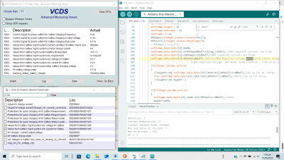

VCDS is connected looking at different actual values, erasing faults & coding
SavvyCAN running to send commands to find different CAN messages
Arduino due with CAN transceiver running Damiens code.

What I did notice, is that when I have the Arduino code running & Charger not yet activated
Frequency, Control voltage & Duty cycle are activated.
Current cond - StandBy = normal as I have not yet activated the Charge process.
Limit, Battery temp (spoofed by Damiens code) & A/C requirements seem normal.
The next 2 are where I am not sure how this works...
Voltage HV battery - The code is supposed to take AC supply Voltage, which it reads correctly, and duplicate it for simulating HV battery voltage. This stays at 0V
Current HV Battery - this remains at 0A, but I do not have a charge process activated.
Spoofing CAN ID 097 for battery voltage, it seems the values do not stay constant, so I am assuming there is a checksum thingy going on.
From what I understand, If Battery voltage is not detected, the Activate Charge will not function.
Does this make sense?

This is the .ino file I have.
- VAG_phev_1.ino
- Updated code that got charger working ONCE
- (23.42 KiB) Downloaded 6 times

Re: VW GTE 3.6Kw charger 5QE 915 682 AF reverse engineer
For info, I do not have the charger connected to a battery, so spoofing all the way to get it initially to work with the good old cooker element test, as per the irishman....
