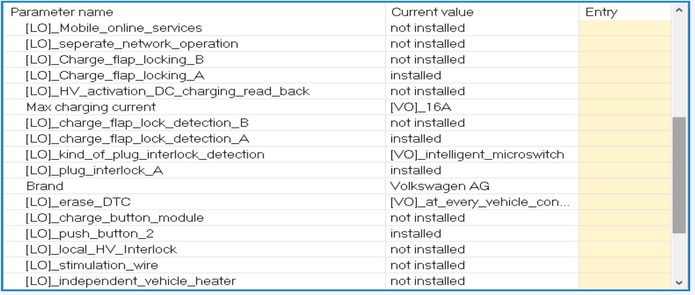

You will also need to spoof the lock feedback signal. I coded it out with ODIS, but it was still expecting it and causing a fault.
Re: VW GTE 3.6Kw charger 5QE 915 682 AF
Can you take a snip of the coding values in ODIS (The list of available options?)
Do you have the charge plug wired to the charger similarly to a golf GTE wiring diagram? Just trying to determine if you're using it in a 'stock' type arrangement, as mentioned the lock feedback and plug temp sensors are likely needed.
You may also need a few LED lights for the status indications, as well as a momentary switch for the charger port button.
Shouldn't the pilot control signal come from your EVSE?

It was over a year since I looked at it, I'll try dig out all the screenshots and can logs from discord.

I did workout that my Chinese type 1 to type 2 adaptor I was using at the time turned out to have the lock cutout too large so the lock pin was over extending, which was possibly my issue with the feedback.

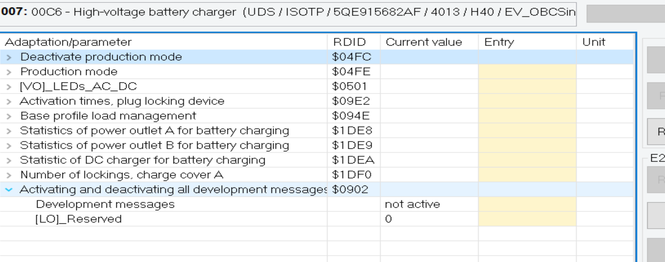

I don't see any actual values in VCDS relating to the maintenance or pilot lines, and I have yet to find anything relating to them in the CAN messages. Their voltages do not seem standard either. But in a normal oem setup, either of these signals would flag a fault and cancel any charging. I'm thinking of putting 100kOhm resistor on each line and connect to positive to see if there are any changes.

Use ODIS. The signals and faults are listed there
I'd use ODIS and see what you get for the plug resistances for the locking and temp sensors.
Confirm they're coming in on the A channel and not the B channel.

Still no luck in getting a charge going. I have been adding more messages, however they throw up quite a few additional faults, which might or might not be adding extra problems to the charge sequence.
Anyhow, I thought I would share & see if anyone can pick up issues that can break down issues.
I do have a question regarding 0x124[5], this byte is required for the Battery current actual value, but is being used to set the Idc setpoint. I cannot get to spoof this value, which might be where part of the problem is.
Re: VW GTE 3.6Kw charger 5QE 915 682 AF reverse engineer
In your sketch, some of the ids are in decimal, but notated as hex.
for instance your BEM_05 has a ID of 0x869, but it should be either 869 (decimal) or 0x365 (hex)
Is your charger coded for a EV or Hybrid? If it's coded as a hybrid, may be worthwhile trying to code it as an EV (or vice versa)
THANKS HEAPS @Mitchy!
The decimal/hex ID's explain a few of my findings, as I have been using the mqb dbc file along with your e-tron code & DomT's log to try and find additional ID's. I probably have been using the decimal ID's and not the hex version.
I'll add the Magic Bytes you provided thanks, and look into messages with crc functions from @DomT's log, but that will take some searching.
I am trying to put as much into the code, so SavvyCan and VCDS don't have too much to do but follow along. Otherwise, another computer is in order to spread the load.
I'll swap my charger version from Hybrid to Electric & see what that does too! Thanks again for the reply and vital info.
