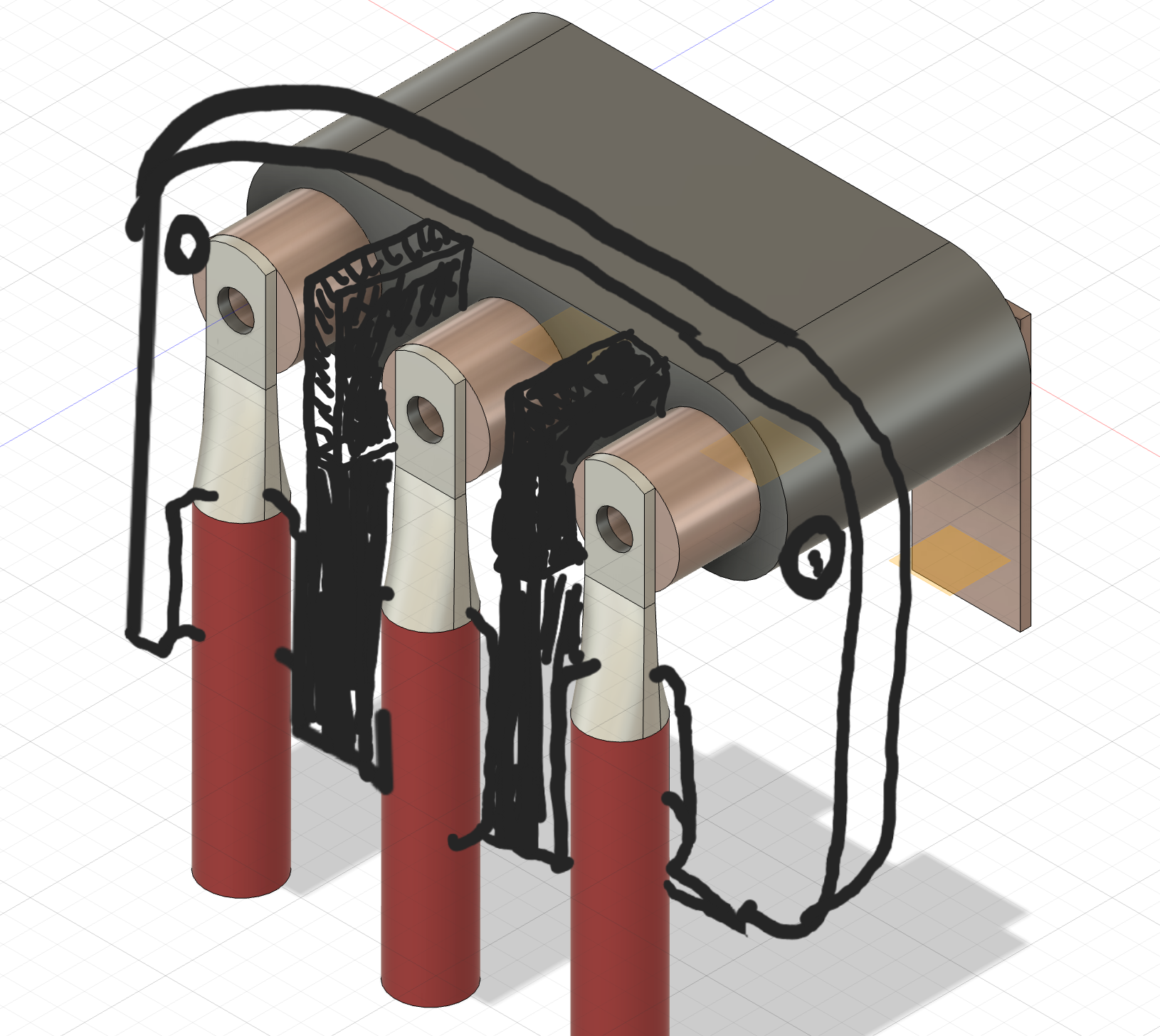

Vaguely planning...
Would something like this be outrageously dangerous for the EM57 phase connectors?
I'd much want to avoid putting anything on top of the motor now (where the phases typically stick in from) as the space is tight and the whole thing is rubber mounted and therefore free to move slightly, which cooould squish the connector built on top.
But it has the side hatch for tightening the bolts.
And since I can 3D-print and lathe, I could relatively easily print out a Nylon "sleeve" for some round copper bars with holes in the middle, then use longer bolts to connect the cable lugs to the internal busbars. Sleeve for isolating the copper rods from the motor body and stabilizing them so no bending forces would be transmitted to the internal busbars.
After that it'd be just a matter of sealing of the top and printing a weatherproof case for the new connector?
As these would be only a couple of centimeters long so I'm not concerned about conductivity within the material, but the only thing that worries me slightly is that normally the inverter busbars are squeezed in there between two flat coppers, so contact surface is much more than what this would achieve seeing the round rod would only contact the busbar on one side...
Since it's HV and I lack sufficient qualification, hivemind please help am I being stupid or is this actually viable way out of my problem?
Thanks in advance!

I'll let others comment on the safety, but if you do this I'd be interested in a similar setup if you're happy to sell one on? Thanks
My thoughts on the safety is it's probably fine. Provided you get good connection. The bolt will pull everything tight, so provided the faces are clean you should have the same amount of copper (or more) than originally when compared with the original busbar.

You may bump into issues with your vehicle inspection if they are strict on the emi side of things by using external wires vs internal busbars. That aside, I believe this can be done safely.
This is what pops into my head I drew the phase wire section a bit too tall, keep it short but effective to not get into vibration induced fatigue / failure where it overhangs. If you get the spacing right you could use a silicone to seal the wires to the adapter & cover. If you're really good you could do some thick orings and grooves for them and avoid the silicone mess.
And if you do nylon internally and for the cover you could print a 3rd piece / thin orange cover for the color / safety side of things.
You could also flare the standoffs on the inside to make better connection if needed / worried. Keep the gap between the busbars as your safety gap, unless they had a non-conductive wall between them. Then you need the divider to achieve the same effective air gap or a larger gap.

Simpsons did it
As this is basically a reiteration of something that exists, why not take a look how one implementation has been made and see how to adapt/improve the design from there?
https://inductiveauto.com/product/nissa ... 25VsPEtW-K
As Cera is from Finland, I don't see an issue on the emi as current rules for conversion don't really ask much regarding that if the vehicle being converted is old as this Voltswagen is.

Oh! Hey yes that's pretty much exactly what I had in mind!J0hannes wrote: ↑Thu Jun 26, 2025 2:41 pm Simpsons did it
Yeah I don't think EMI restrictions/rules apply to 1976 here, so should be all good inspection-wise.
Yes adding spacers like this between the wires sounds good. I might just steal the idea of using those threaded cable passthroughs used in the linked product for waterproof connections.jrbe wrote: ↑Thu Jun 26, 2025 11:56 am This is what pops into my head I drew the phase wire section a bit too tall, keep it short but effective to not get into vibration induced fatigue / failure where it overhangs. If you get the spacing right you could use a silicone to seal the wires to the adapter & cover.
Of course! I'll see what I can doJacobsmess wrote: ↑Thu Jun 26, 2025 11:27 am I'll let others comment on the safety, but if you do this I'd be interested in a similar setup if you're happy to sell one on? Thanks

Did you see what @Windraver did for this on DIY Electric Car? 3D printed covers used to connect on top. I know you said you wanted to avoid that, but might be food for thought and he shared his files.

Yeah I think this should be doable.
There's a protrusion from the motor case just below the rearmost phase in my setup, which necessitates longer copper and bolts, currently around 80mm length. Could shave off some 1.5cm from that if I could bypass that screw protrusion somehow. Oh well.
But anyway with this my phases would end up looking something like this:
(I'm learning how to use Sweep -tool in Fusion
I can also attach the wiring to the motor mount I made previously, as I understand EU directive requires bolting down HV wiring every 20cm or so.
