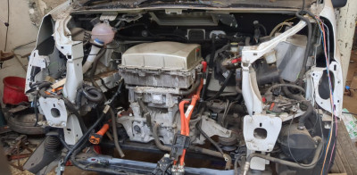

Progress so far. Leaf stack fitted to van. The driveshafts are with a local engineering company, they have a plan but won't give me a guarantee! :shock: The next step is radiator and shove a Leaf battery underneath on the floor, wire up the Zombieverter and try and get a motor spin.
Leaf stack fitted.
Leaf stack fitted.
I have a rough plan for a battery box to house the innards from 2 Leaf packs but I still have to determine how I'm going to get 2 Leaf batteries talking to the Zombieverter. As I see it there are 2 possibilities. First would be a CAN bridge to combine both batteries so the Zombieverter thinks it has a 54kWh Leaf pack. The other option would be to get the Zombieverter to connect to both batteries, one on CAN1 and the other on CAN2. Now I'm not a programmer but my son has just finished his 2nd year of computer science at university and he needs a summer project. :D I've introduced him to Damien's Zombieverter videos so that he gets an idea of how they work. Anyone have any thoughts on the 2 battery problem?

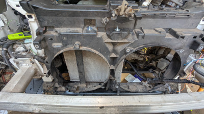

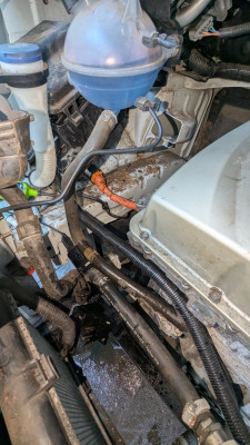

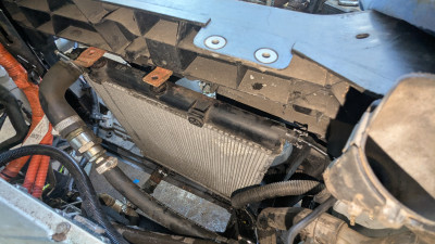

Project update. I've fitted a radiator from a 2008 Peugeot 207 1.4D. The Expert radiator was blocking the charge ports. The new radiator has been moved left to fit the charge ports in. System filled with anti-freeze and bled. I'm using the Allied water pump and a combination of Allied water fittings and Leaf water hoses. It's not pretty but it's functional.
