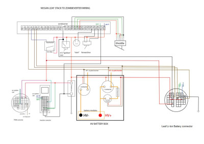

I'm going to be working on wiring the ZV this weekend so I updated the table here. I've also added to the diagram but I'm not sure how to add that to the wiki so I'll leave it here for now.
Added battery connector
