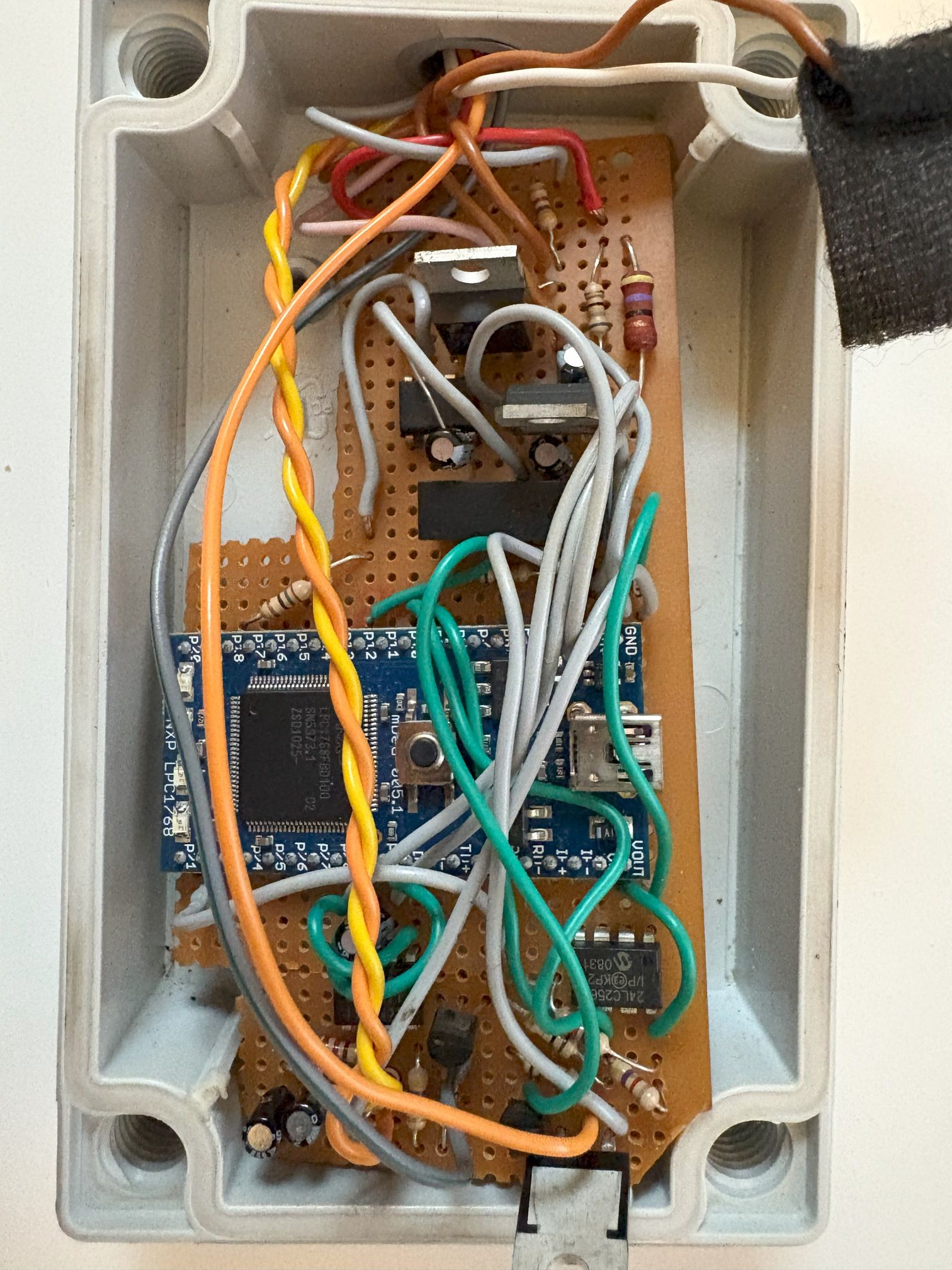

Hi all,
The Original ECM from the diesel engine is still in my Volvo V50 viewtopic.php?p=81063&hilit=v50#p81063. On the original conversion they connected an mbed NXP LPC1768 to the ECM (crank sensor, cam sensor and engine temp) and the CEM for the fuel sensor. It looks like it is can controlled via the original (deleted) motorcontroller. How can I figure out how to control this (via the Zombieverter)?
- There is no code to be found (only Hello world) on the mbed (when I connect it to my laptop and it shows up as an USB station).
- There is an external EEPROM connected to the i2c. I tried to get the code from it via a dump with a arduino, but that gave only a long list of the numbers 255. In the beginning a few others, but not enough to be the code.
- One pin gives a constant pwm signal (so I assume there is some sort of program on it)
- Can the code be stored on an other place which is'nt shown on the usb interface? Is it possible to extract the needed can commands if I find the code?

I have the can logs from Damien his V50, these work on mine.
The issue is that I don't have a can log from the previous electric motor controller (the Magtec system) that was controlling this micro controller. Therefore I have no idea what kind of commands this needs. If i can find out what commands it needs, I could reuse this controller. Otherwise there should be found an other solution. The micro controller is not sending anything by itself over the canbus (checked with a oscilloscope).

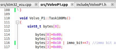

Re: Fooling the original ECM that the engine is running
Damien! You're doing it WROOOONG!
Message 0x0300410E is sent in a 10ms interval! Your car will explode if you only send it every 100ms!
I am making little progress. It is an very steep learning curve.
Using Damien his can logs is interesting (not realy working like in his video). Message 0x0300410E is starting the powersteering (and a lot of lights on the display, but not the engine malfunction light (that has been removed from the dashboard
)). The power steering keeps running even when there is no more message sent. So blowing it to pieces with every 100ms a message is an real possibility
. I found that sending signals to the ECM is difficult, but looks like it is possible. At least I can trick it easy so it thinks the motor is running so the powersteering starts working. But the rev counter is not reacting smooth to it. The fuel gauge is also possible to get working with a pwm signal. The temperature gauge is not working on a pwm signal.
