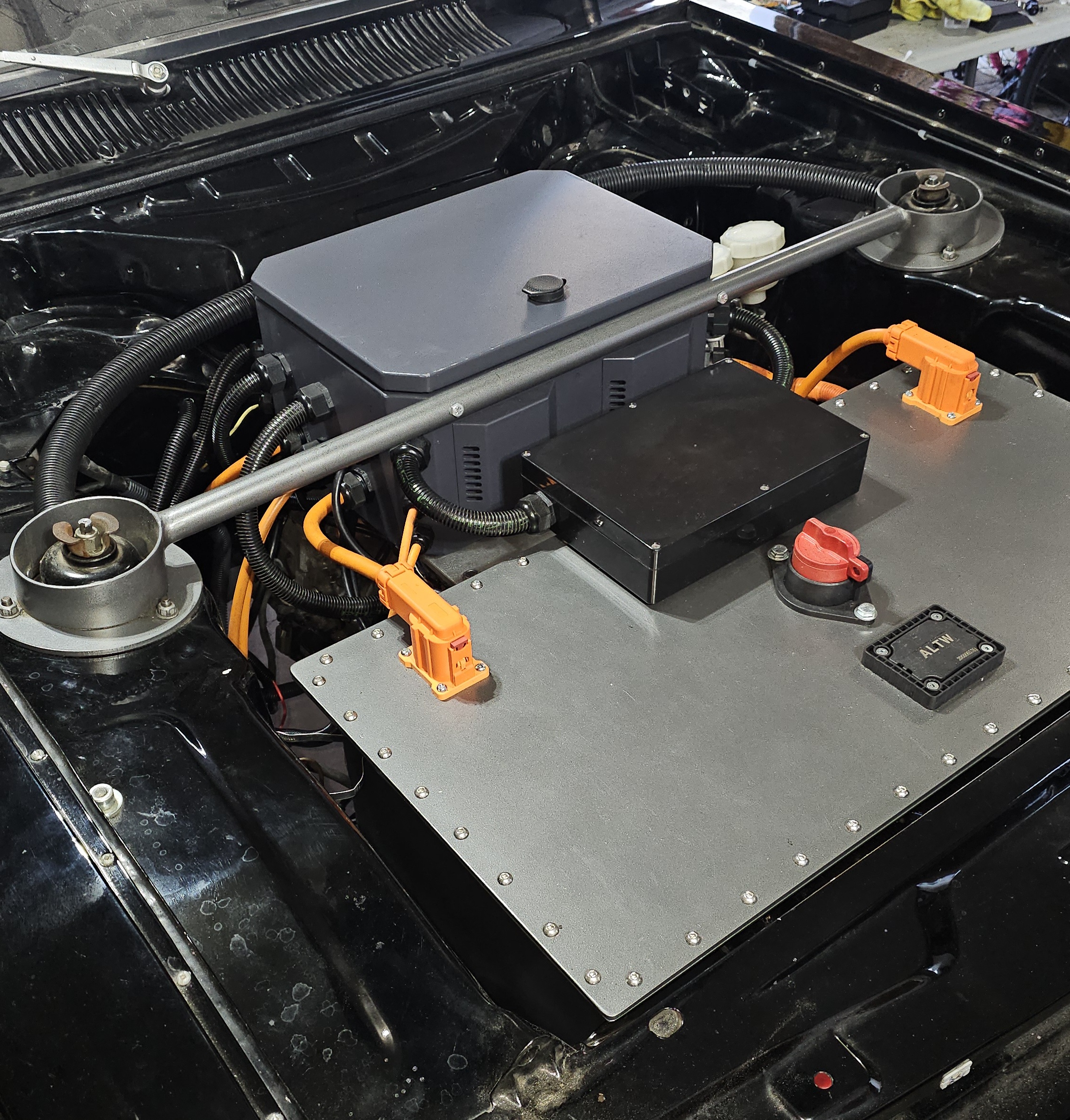

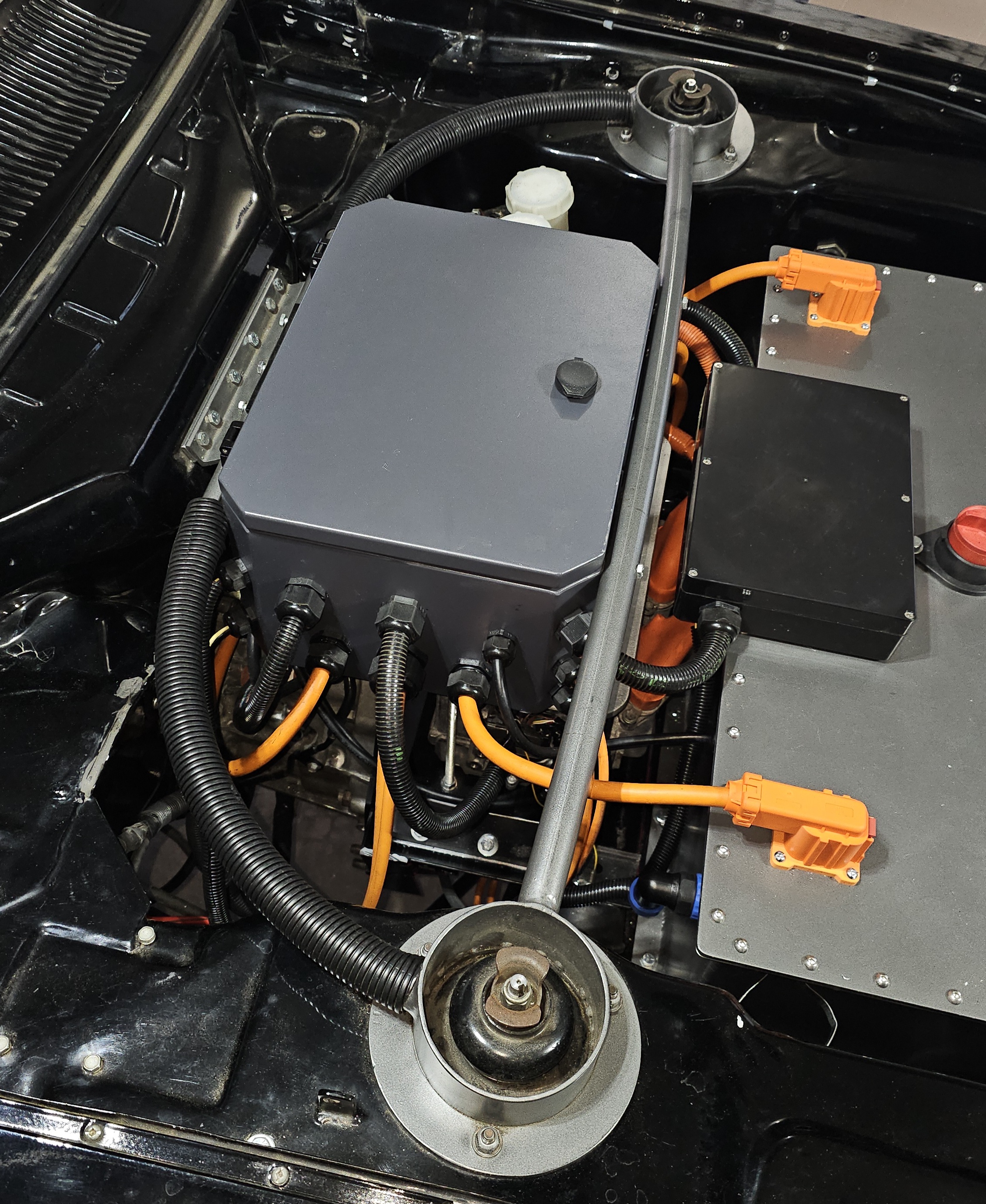

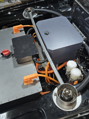

Some progress
Pretty much all the physical items in place, final wire up in progress.
Posts: 6754
Has thanked: 382 times
Been thanked: 1574 times
Re: WIP 1974 Ford Capri + GS450H
Wow, that is a super clean installation!
