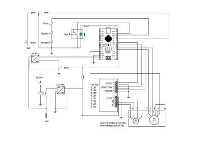

Over on this forum user dddrewski has posted his park pawl implementation using a Cloudray 3-Phase Stepper Motor Driver 3DM580S driven by an Arduino Nano. It's not complete but there's enough there to get started.
Here's the wiring diagram as built, and the arduino nano program to run the transmission park pawl motor.
The first time it runs, the park indicator light flashes. You push the park button and it will do a homing routine to move to park, and remember the position.
The arduino stays powered all the time, so it remembers to state of the park pawl after that.
I there are a couple of voltage dividers in there that I didn't write down the resistor values. I don't remember, but they're probably in the 100k ohm range. They result in the nano only seeing 5V on inputs.
I also didn't write down the resistor value on the LED output. It was a 3V LED, so I just tried a few values until it read 3V across the LED.
The only thing I may change is to put the Resolve-EV controller into Neutral when park is activated. Right now, it will go into park while the Resolve-EV is in Drive or Reverse.
