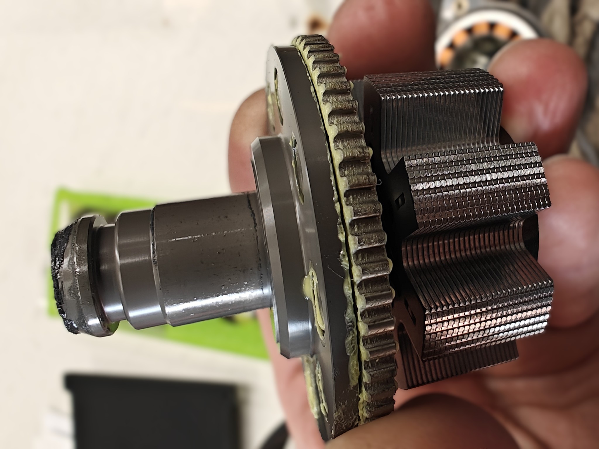

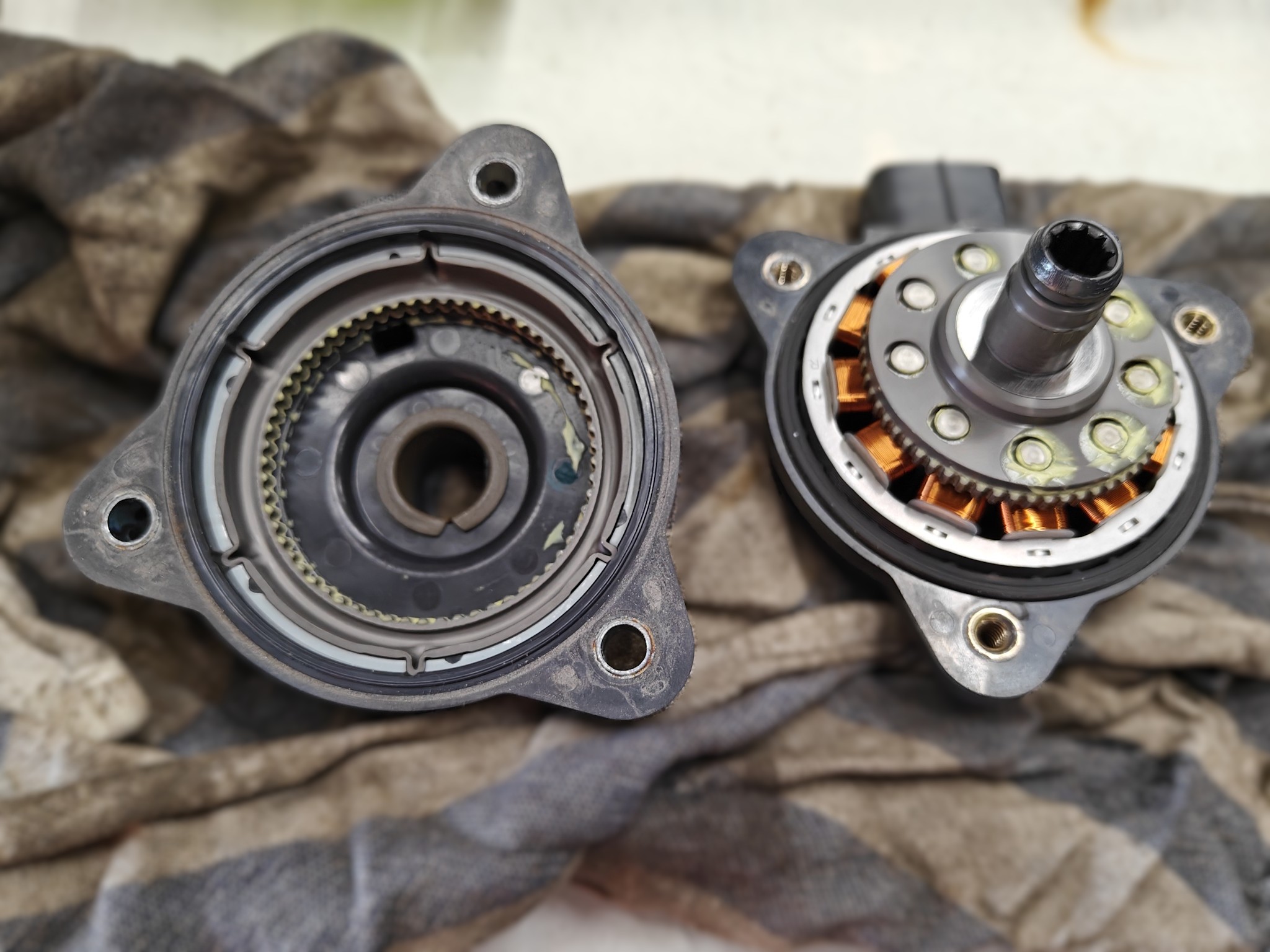

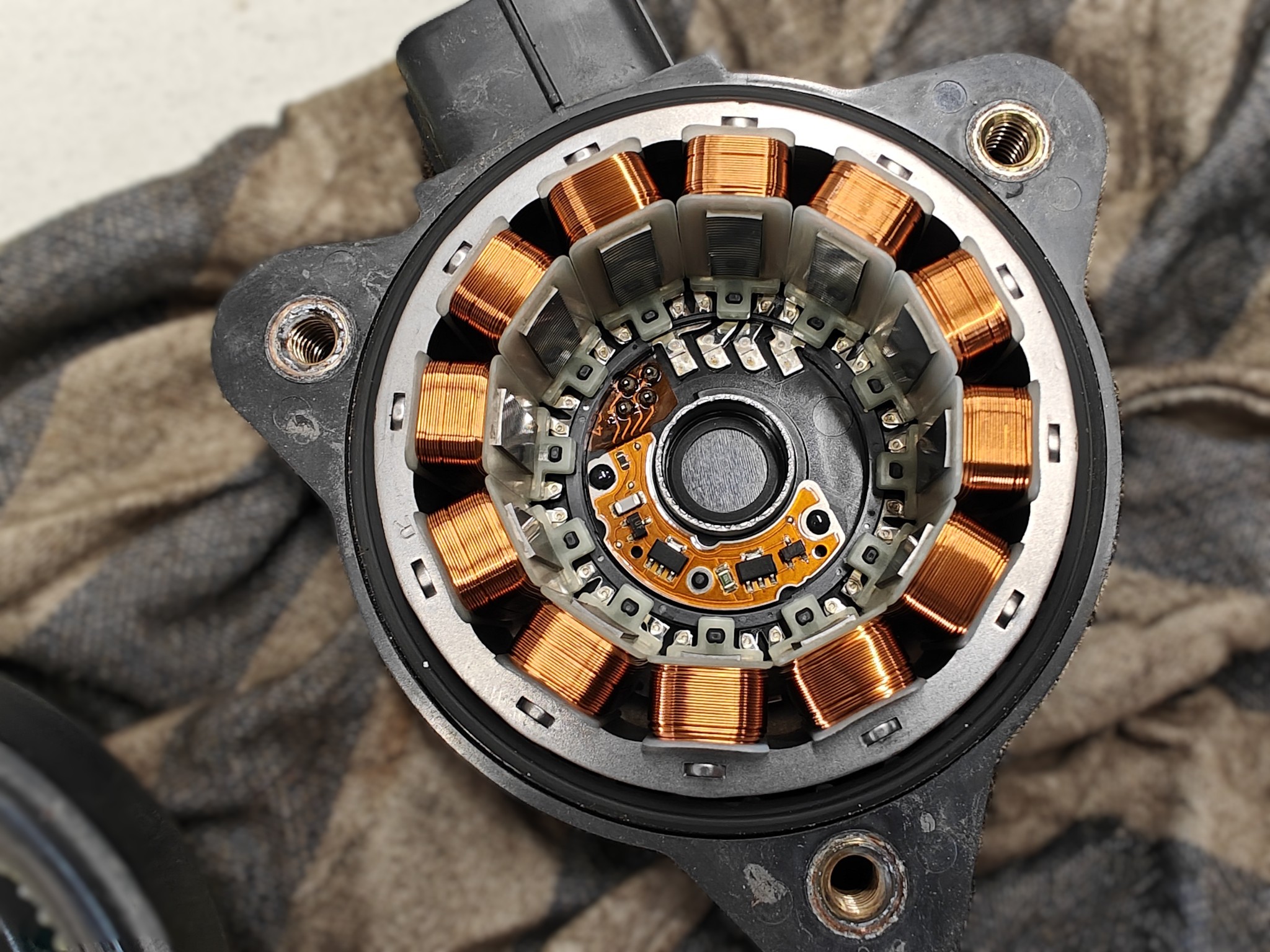

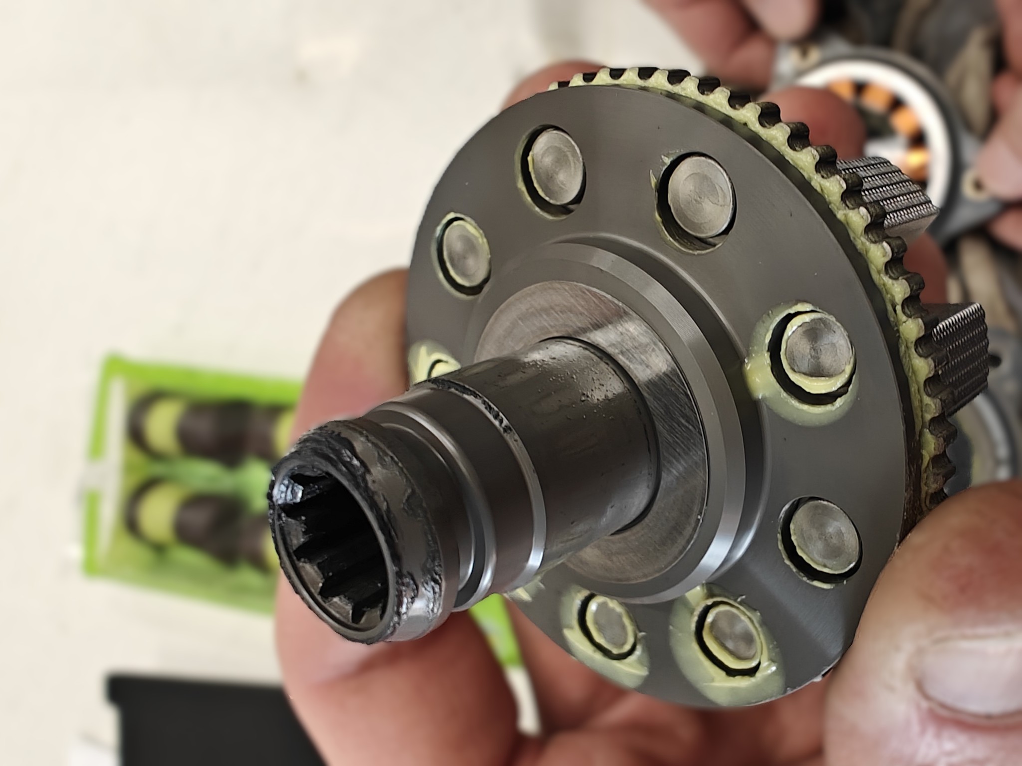

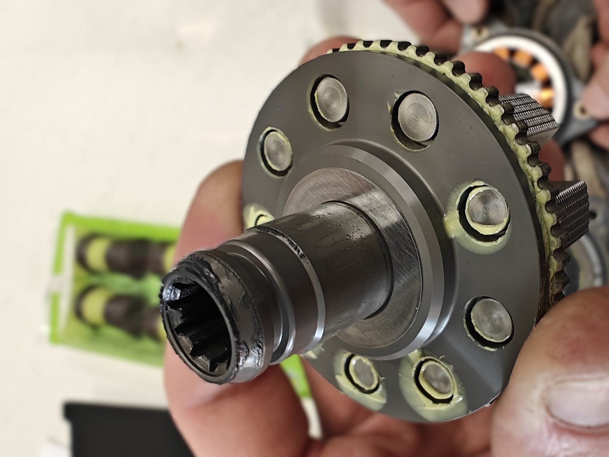

In case someone wonders what this is made of, I happened to open one "accidentally"
If you remove the srcews which hold the actuator on the sheetmetal part, the motor splits.
This is SO COOL!!!
There is a Cycloid gear drive in this :D
The motor is a switched reluctance motor

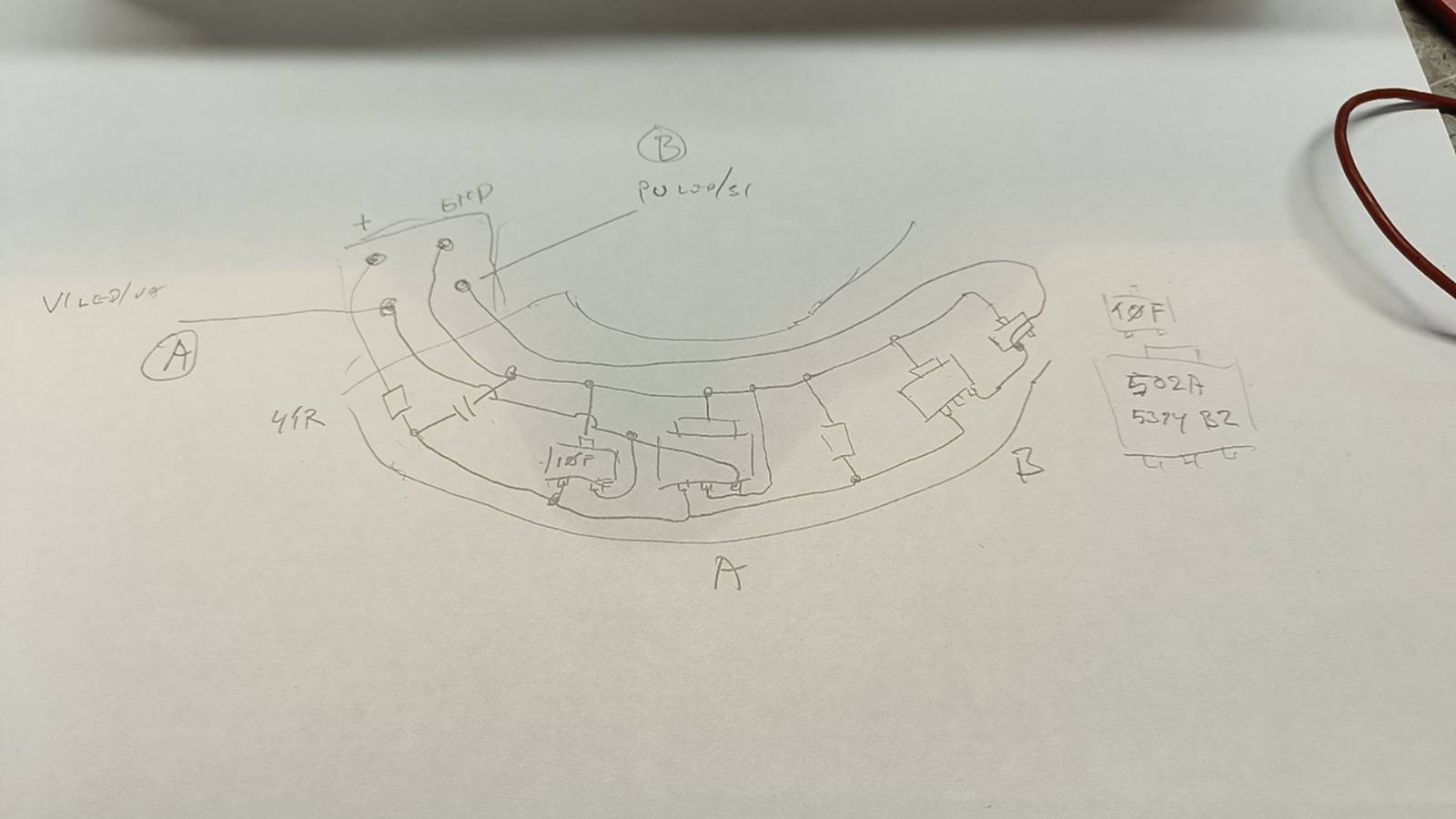

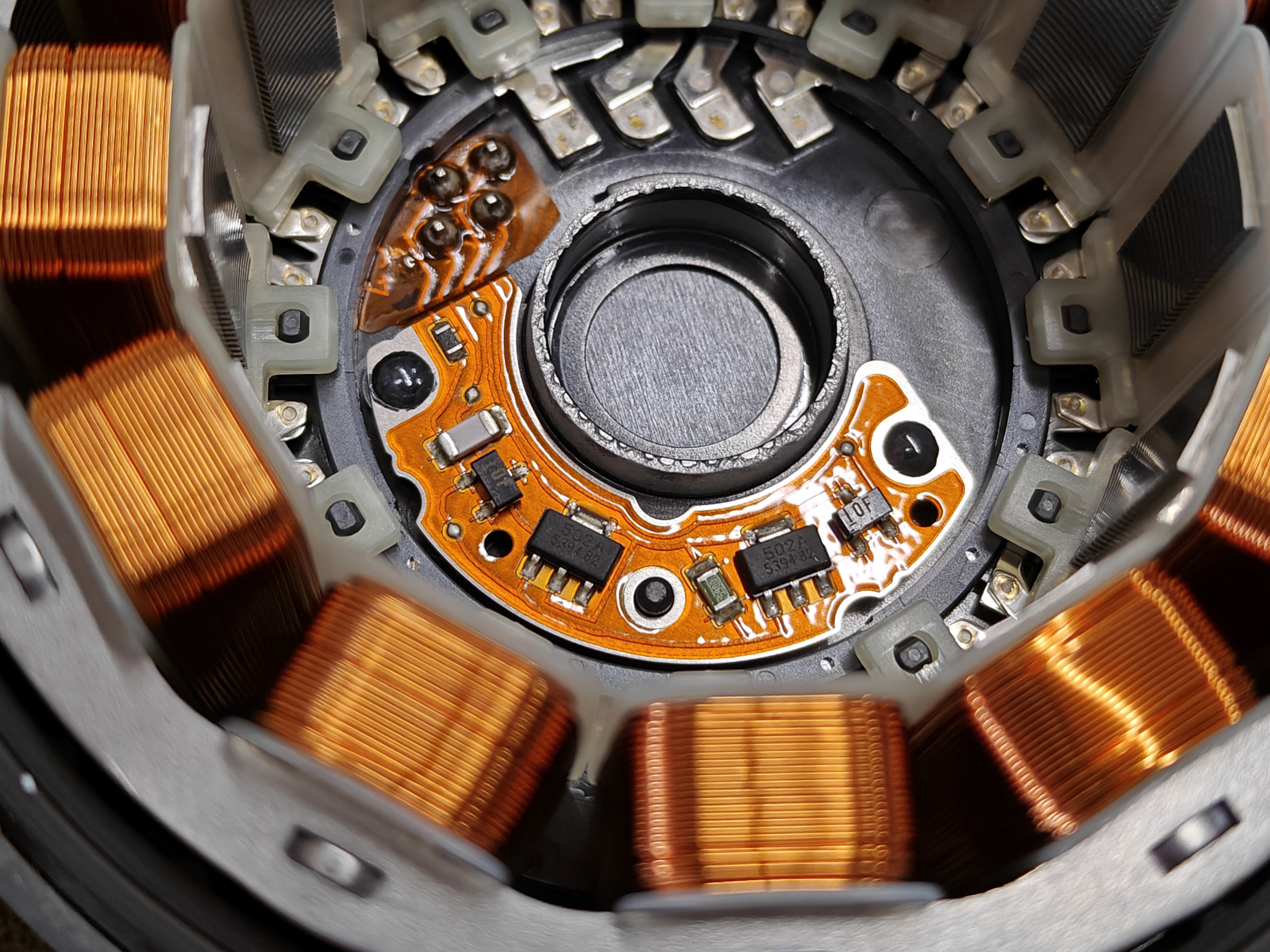

Two SOT-23 hall sensors I0F scribed on packaging --> Could this be TI DRV5023?
Two SOT-223 502A 5394 82 --> Voltage regulators for hall sensors?

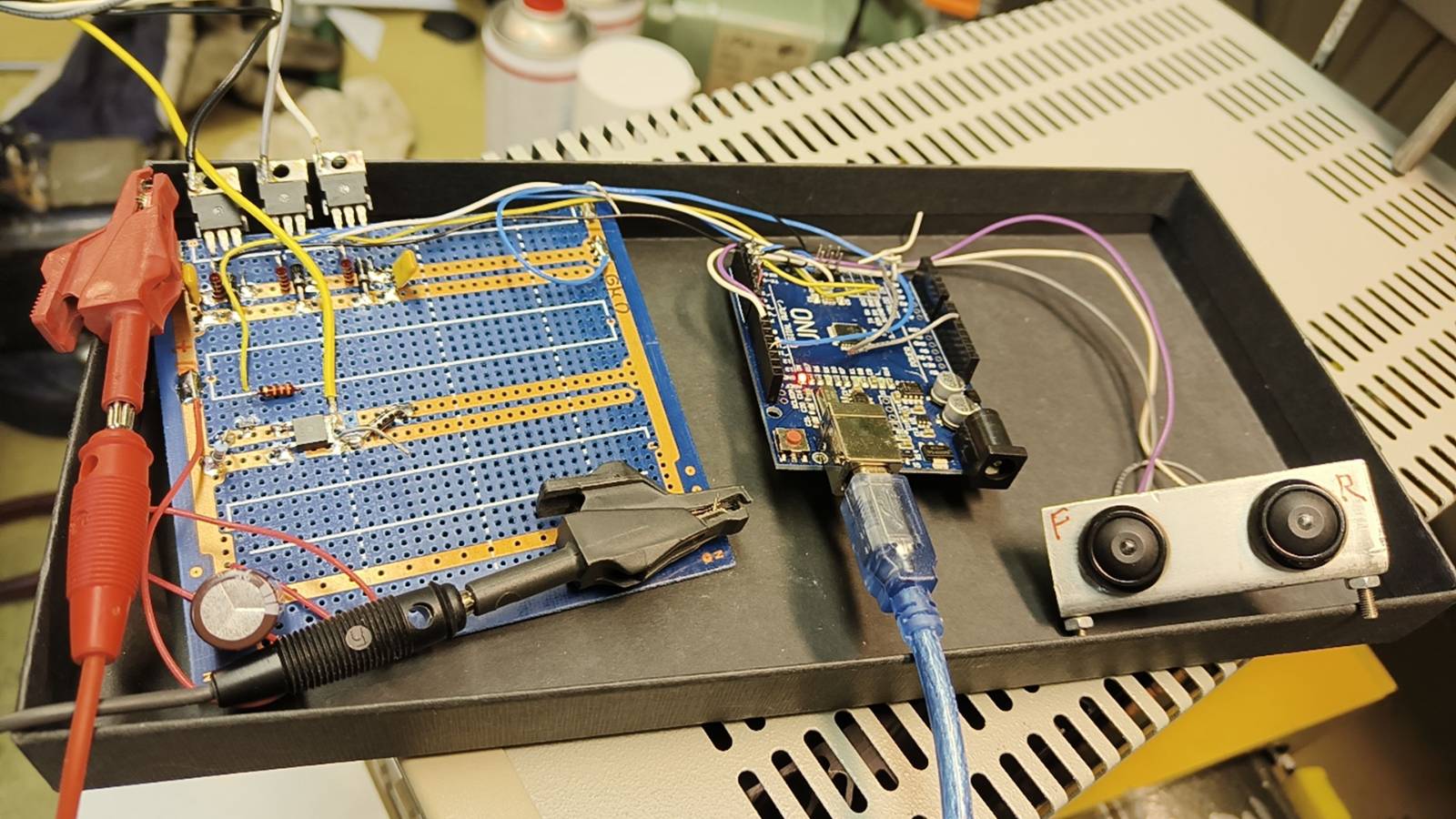

Hi, Just for your information; I have a developed a controller for these park motors, based on Adafruit CAN Feather or Rapsberry PR2040 Zero. It can be controlled by CAN (feather board only) or analogue (switch)
If anybody is interested please send me a DM

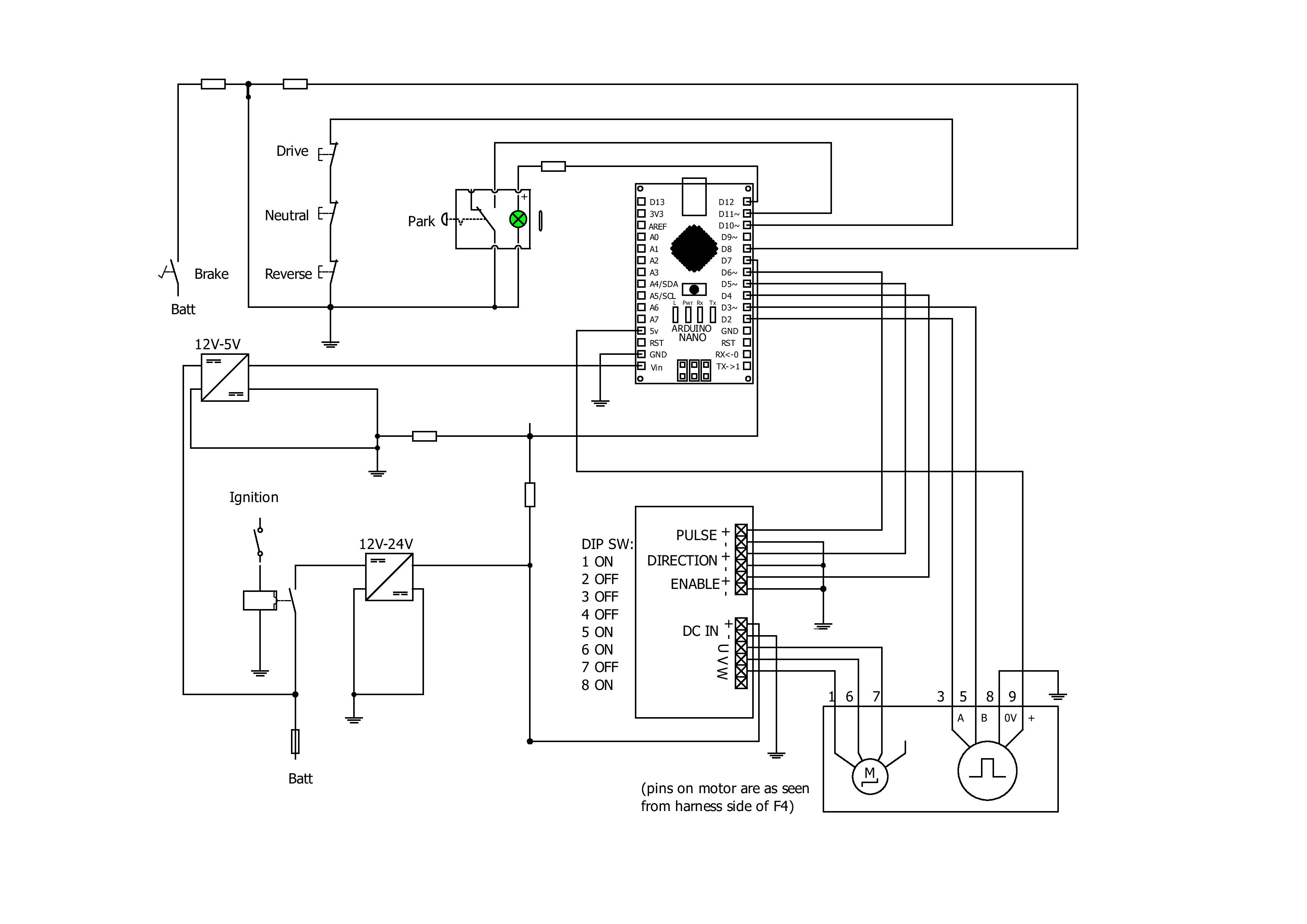

Over on this forum user dddrewski has posted his park pawl implementation using a Cloudray 3-Phase Stepper Motor Driver 3DM580S driven by an Arduino Nano. It's not complete but there's enough there to get started.
Here's the wiring diagram as built, and the arduino nano program to run the transmission park pawl motor.
The first time it runs, the park indicator light flashes. You push the park button and it will do a homing routine to move to park, and remember the position.
The arduino stays powered all the time, so it remembers to state of the park pawl after that.
I there are a couple of voltage dividers in there that I didn't write down the resistor values. I don't remember, but they're probably in the 100k ohm range. They result in the nano only seeing 5V on inputs.
I also didn't write down the resistor value on the LED output. It was a 3V LED, so I just tried a few values until it read 3V across the LED.
The only thing I may change is to put the Resolve-EV controller into Neutral when park is activated. Right now, it will go into park while the Resolve-EV is in Drive or Reverse.

This looked like a viable solution, however, I was not able to get it working, hence the design of my own controller.
Mine is also less bulky and it does not require 24 volts to run it.

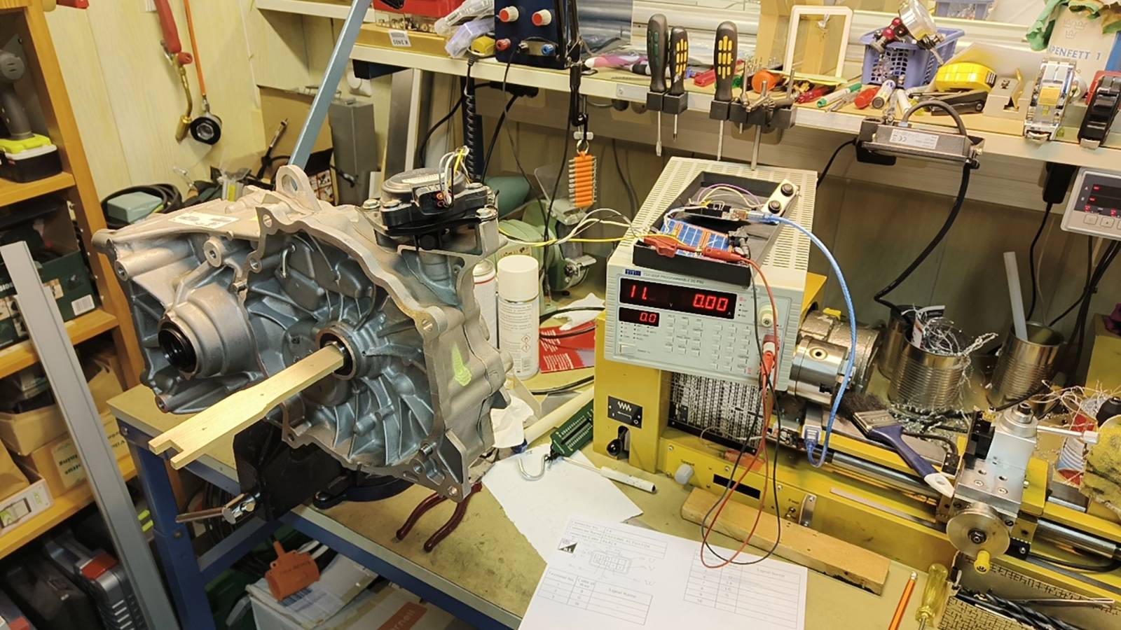

J0hannes
Posts: 159
Has thanked: 21 times
Been thanked: 182 times
Re: Nissan Leaf park actuator motor
Post by J0hannes »

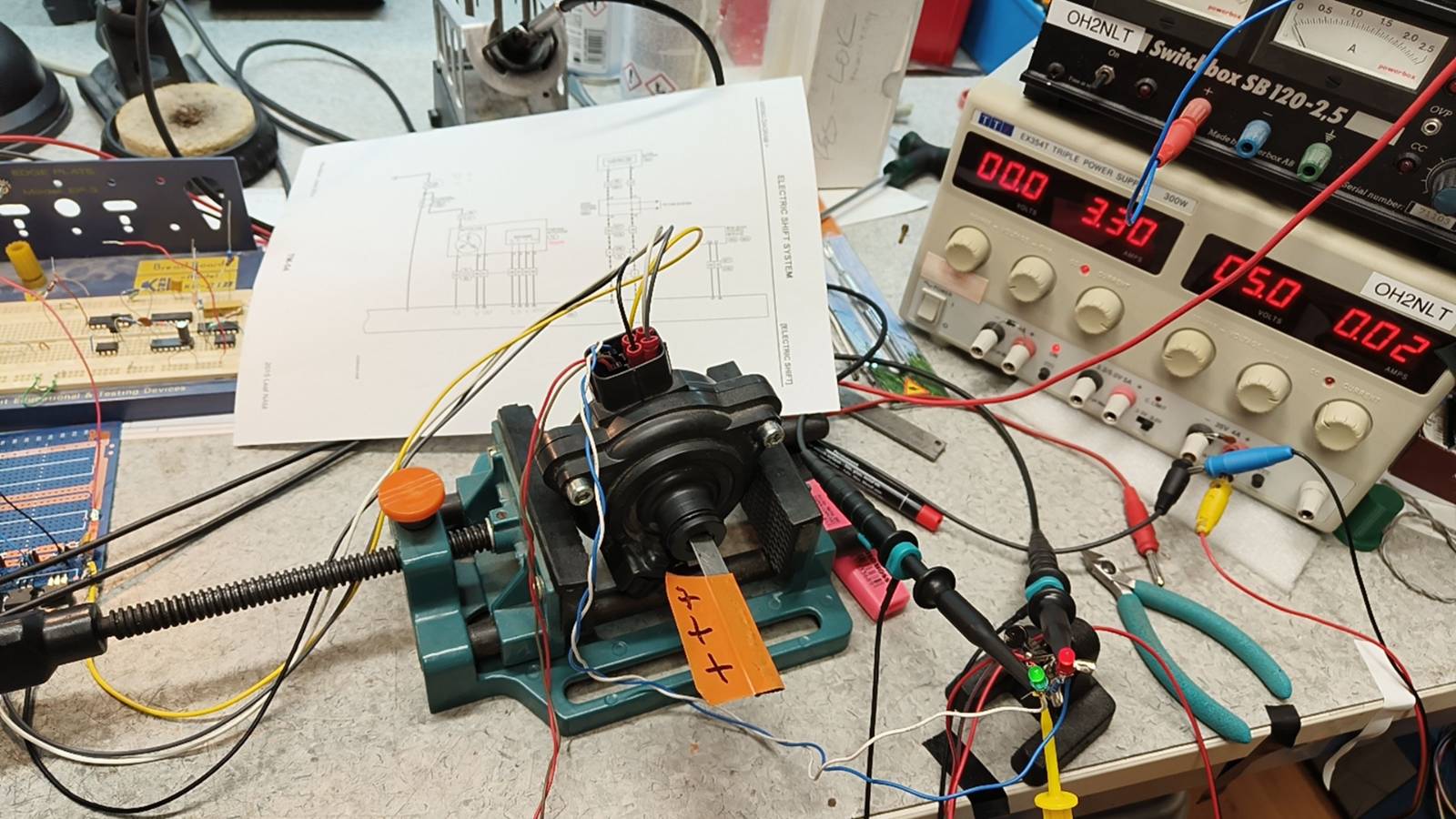

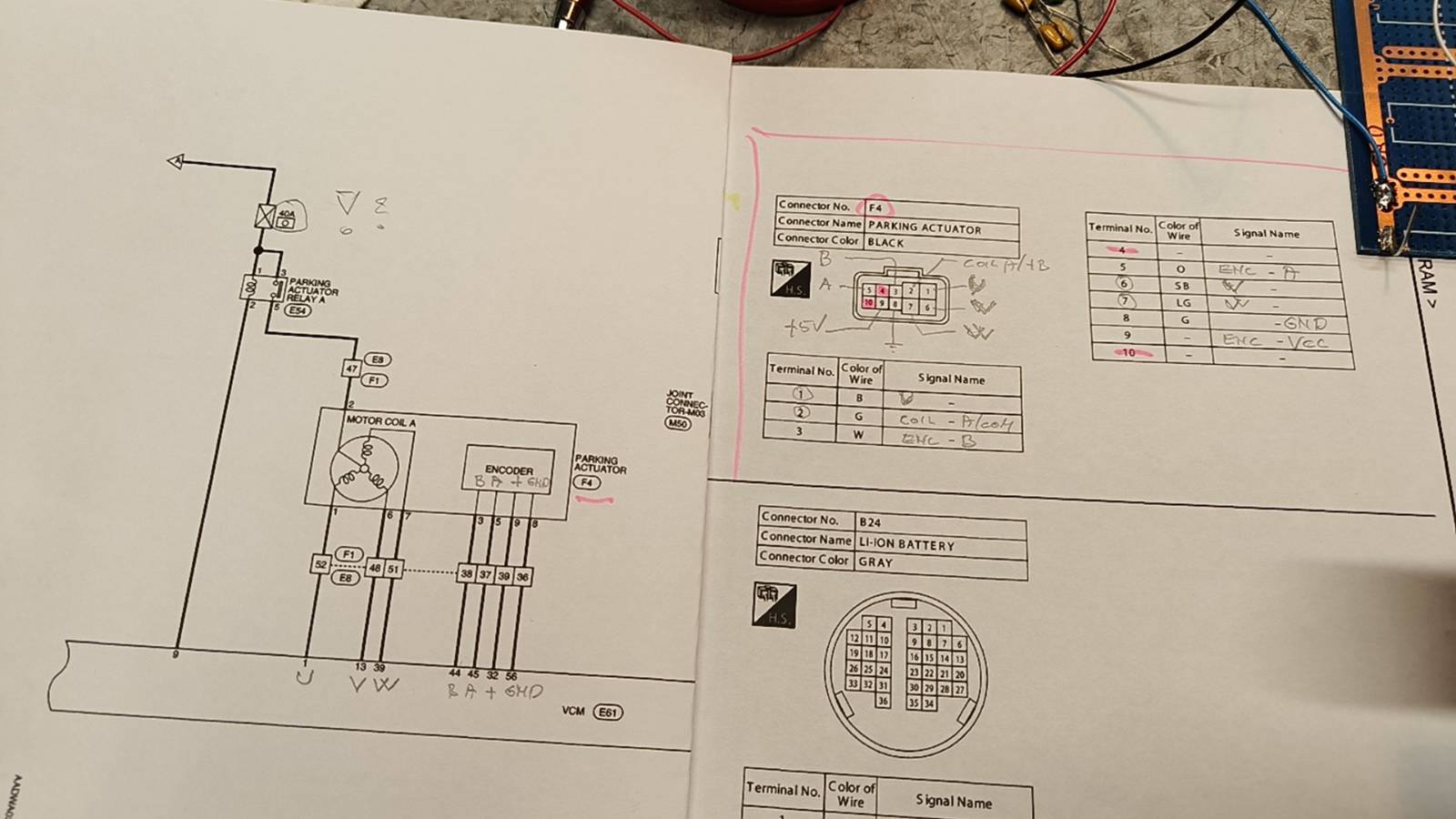

My father got curious about the park actuator motor and is working on motor control, this'll probably become some sort of controller which would be open source.
He pieced together the connector pinmap and wiring diagram, so it's now useful :)
Schematic of the motor FPCB
Hall sensors are TDK Mikronas HAL502 type
https://www.digikey.fi/en/products/deta ... -A/5271763
10F SOT-23 type not identified, but he's most certain that it's a double protection diode
Motor first spins, just feed forward
After few nightshifts, the motor dyno gives approx 7kg on a 161mm lever, so that's approx 11Nm already!
Currently running feed forward.

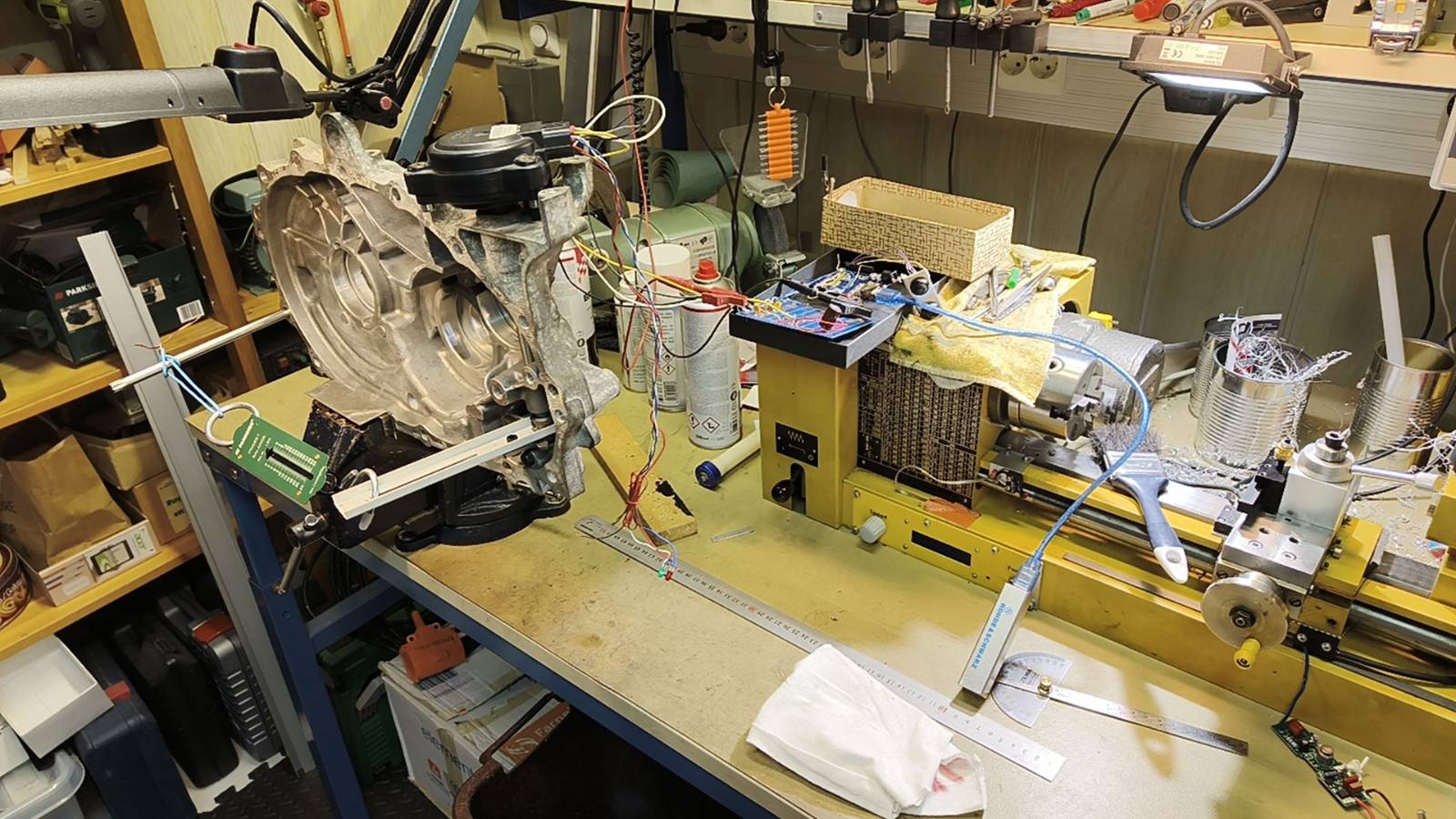

More information from research dept.
Almost certain that the SOT-23 is a 10F diode
Also, Renesas is Japanese manufacturer, so that would also make sense.
The actuator motor is a SCSRM type
Some observations:
It's 155 encoder A or B pulses from end to end
Angular movement is approx 30 degrees
Motor resistance 1,35ohm / phase
Phase inductance varies between about 1,6mH to 4,4mH depending on rotor position
phase coil saturation. On pole ~4ms, between poles ~1ms
Now the test code has been improved, so the actuator doesn't change direction when it hits a hard stop and misses steps.
Testing with park pawl and input gear
Powerstage
In the video, you hear first disengage and then engagement of the park pawl. As the tooth is not aligned with the pawl, you can totate the gears until the pawl engages by spring force.

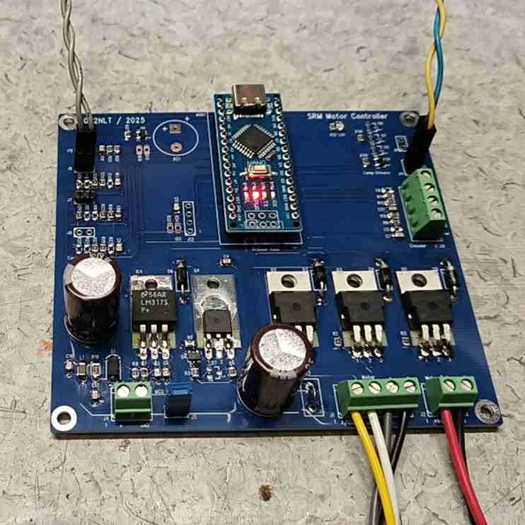

HW and SW for park actuator controller

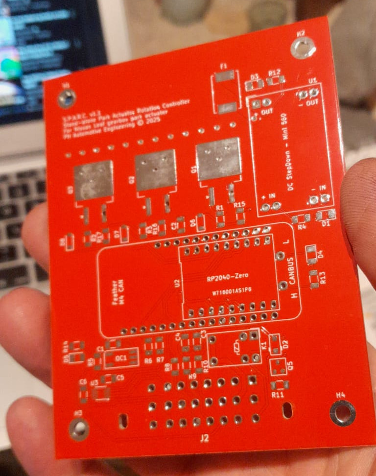

Post by J0hannes »
The SRM contoller is now available for anyone who wants to make one for themselves :)
Hardware has the following:
  • Arduino nano is used as controller
  • Three configurable control inputs, meaning they can be used switching high or switching low depending on your application
  • Two inputs for hall encoder
  • Two configurable outputs for relay / lamp / led
  • Output for three phase SRM motor (the design is tested with Leaf park actuator motor)
  • Power supply for motor power can be shared with the controller, or they can be separated if you desire
  • Motor power supply protected by polyfuse
Hardware files:
  • All hardware files are offered AS IS.
  • SRM_gerber.zip made with original design on Pads. PCB can be ordered with this
  • SRM_KiCad_designfiles.zip contains KiCad design files. They were converted from old Pads design. Files were opened first with newer Pads VX and then exported and saved to Altium project, which was then imported to KiCad. So be aware that there may be some discrepancies of bugs of any sorts. On a quick overview things look like they should.
Software V 1.0 with the following functionality:
  • SRM motor control with encoder feedback
  • Safety functionality, brake pedal must be pressed before park lock operates
  • Serial communication for functionality and fault feedback
  • Fault detection forward and reverse direction (over/under travel and stall)
  • Audio feedback on succesful lock/unlock
See all the details on Github
