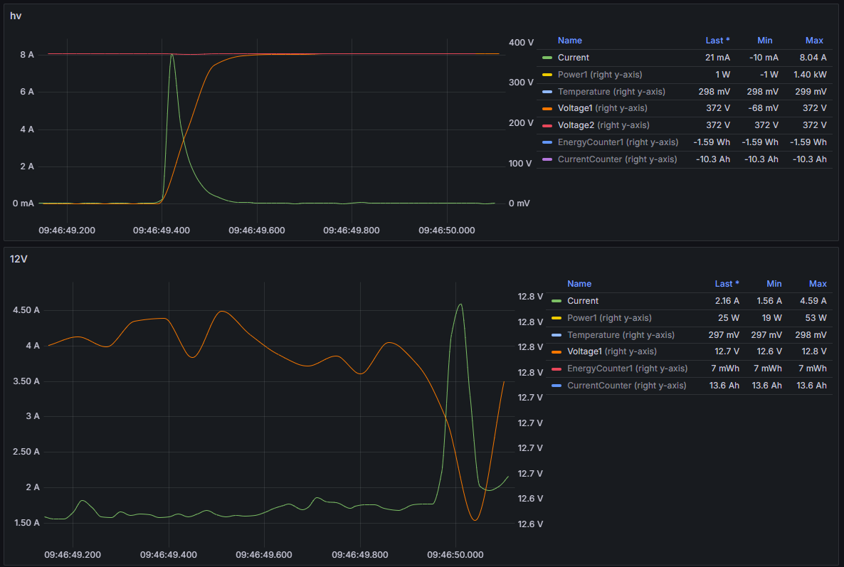

Precharge with 33R 100W resistor

I have seen 18R 200W ceramic resistors in OEM switch boxes...
