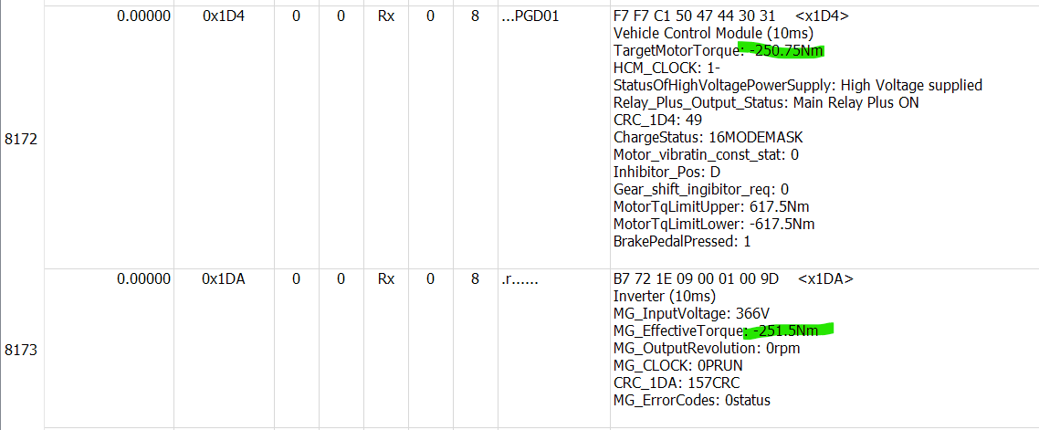

Re: Leaf full stack not reversing properly
Houston, wehave TORQUE
I did this test just by holding against the brake and vehicle not really moving. Now we have symmetrical torque
CAN trace from the test Parameters

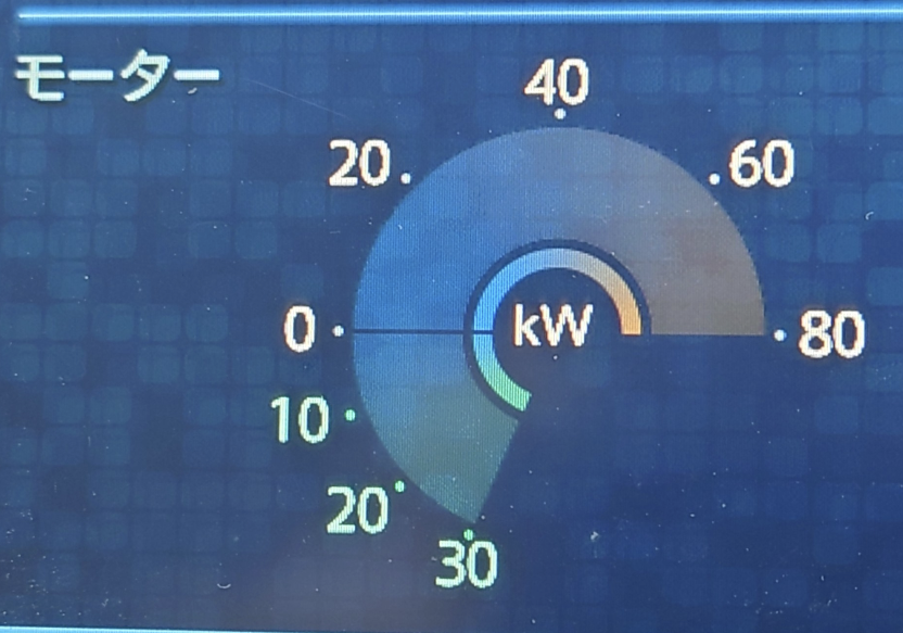

Why are we still saying to the leaf motor that we are pressing the brake pedal while driving?
In the 0x1D4: Brakepedalpressed =1
Also if there is same torque limit both ways, will it mess with the regen?
From Leaf OEM display, regen goes to about 28kW in B mode:
No idea it seems to have no impact on the inverter.
Yes this is why its now removed in the vehicle testing branch and will be added into a release upcoming.
