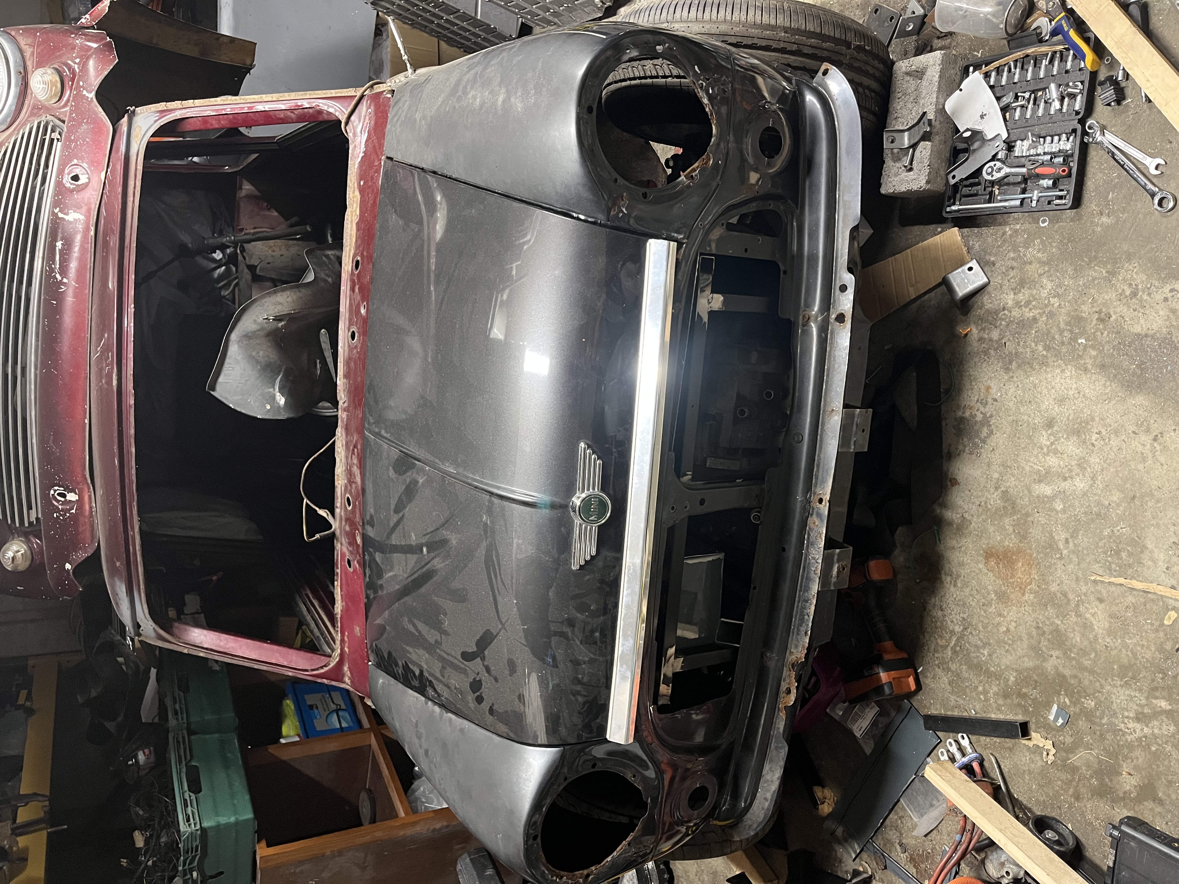

(WIP)Classic Mini, outlander rdu
Re: Classic Mini, outlander rdu
I’ll probably get some made up once we’re up and running, got it lovely and straight but the bmx has probably thrown it well out of balance, it would probably shake the diff to bits

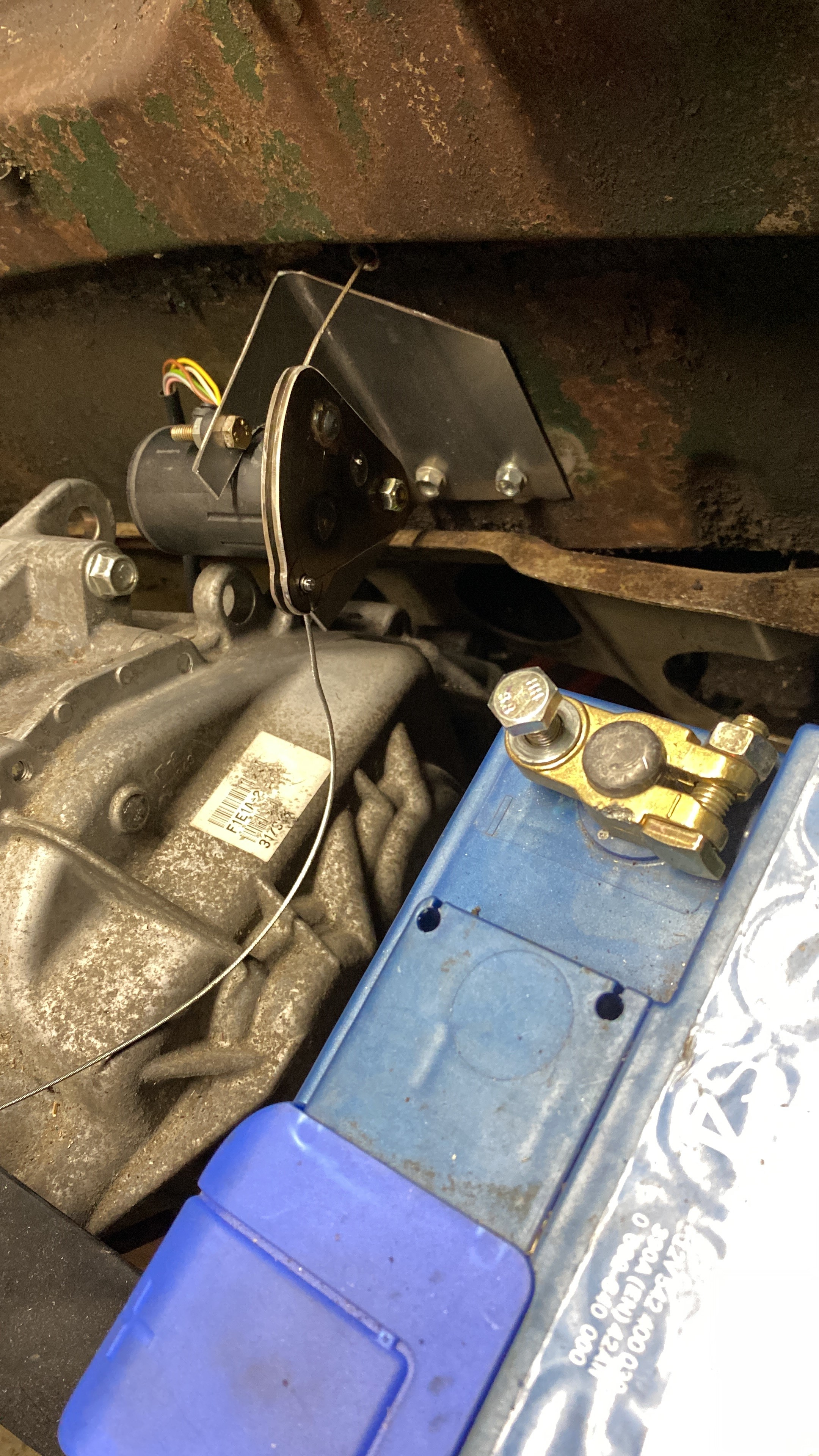

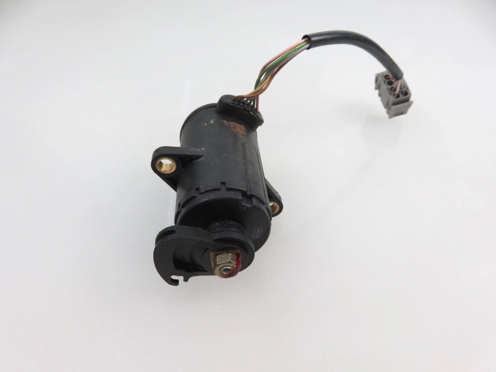

I use a BMW E46 pedal sensor like this one in my Mini conversion:
I mounted it directly to the bulkhead oposite to the pedal:
So inside the cabin it remains original.
I had to make a bigger wheel out of sheet metal for the correct gearing. I used the brass inner part of the original wheel and replaced the plastic part.
The bolts are the fixation bolts of the pedal, but originally they were welded to the bulkhead. So I removed the original ones with an angle grinder and replaced it. The bracket shown is too weak, I stiffened it with additional ribs. Just use thicker sheet metal and you should be fine.
The sensor has a return spring, but it is too soft, the pedal "feeling" was not good. I added an additional return spring to the wheel. Unfortunately I made no pictures of the final result and now everything is jam-full (it sits below the inverter and DC-DC), so I cannot make a good picture.
The sensor is no dual sensor, as I hoped due to the six cables. The remaining cables are for the kick-down switch and something else I forgot. Single sensor is not recommended as I read in this forum. But I hope it will work nonetheless. Up to now I have driven only a few km's, but it worked good.

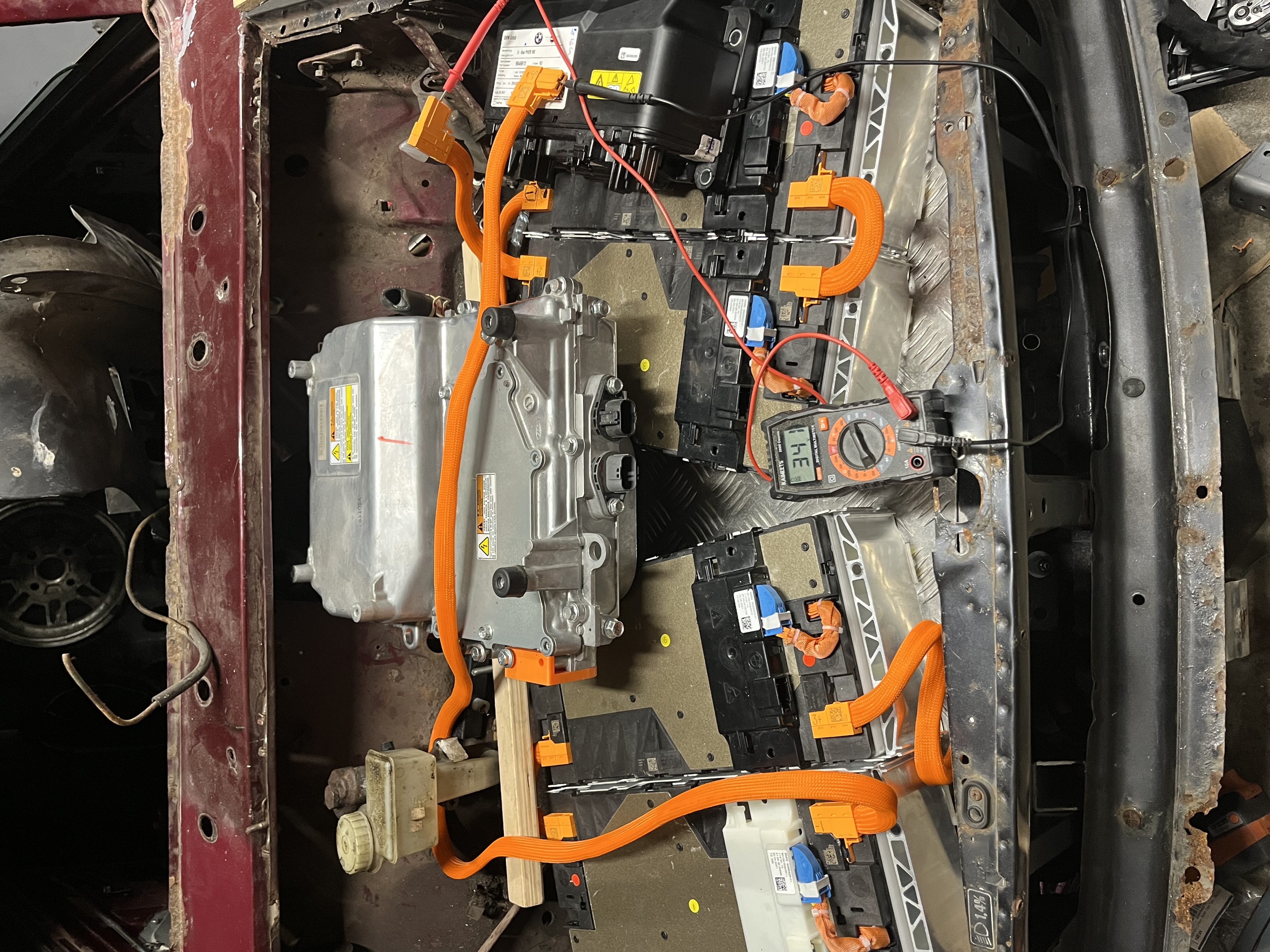

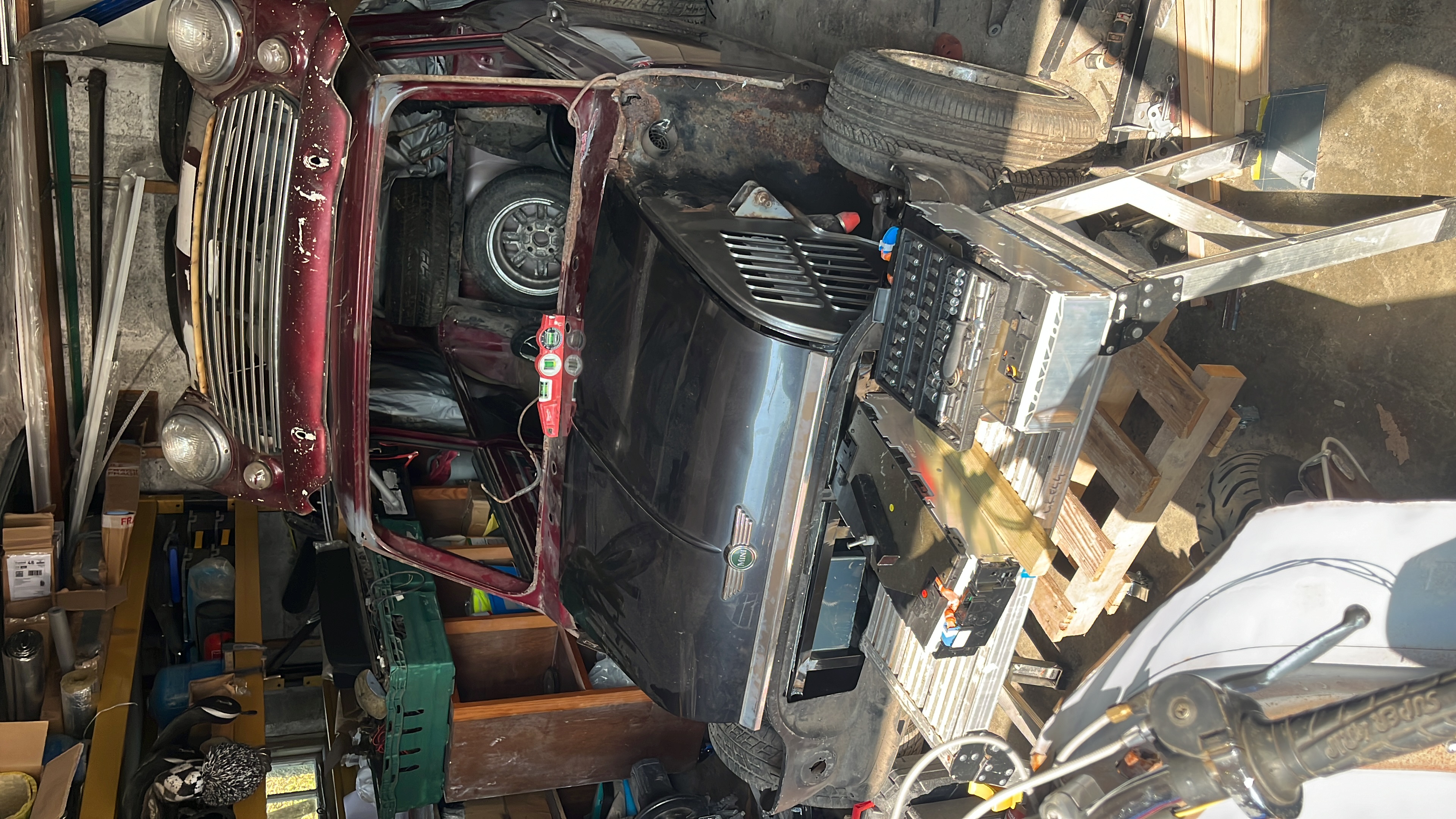

So I’ve currently got the full bmw 6pack crammed in the front of the mini with inverter and sbox sat in there too. 341v according to my cheapo multi meter
Don’t trust the slightly bent front pamnel so i went and cut the front off the parts shell i have sat outside.
Two lower modules are boxed and under the shelf and boy its tight!
Just need to build the top box and i can mount the inverter and pipe up the cooling, just waiting on a parts delivery to be able to crack on
Sure but how is the motor cable going into the inverter? And how is the HV going into the inverter?
Also where is the radiator? And where is the charger and dcdc?
All looks very much a tight squeeze yet seems to border on the possible.
Its extremely tight tom, there is room for the inverter to motor cables to pass between the battery boxes to the under side of the temporary checkerplate. The hv can pass around the back and go either side of the inverter. The charger will probably have to go in the boot or maybe under the front seat using the gear stick hole for access. Not sure if any of this will work yet but its weirdly enjoyable trying to work it all out

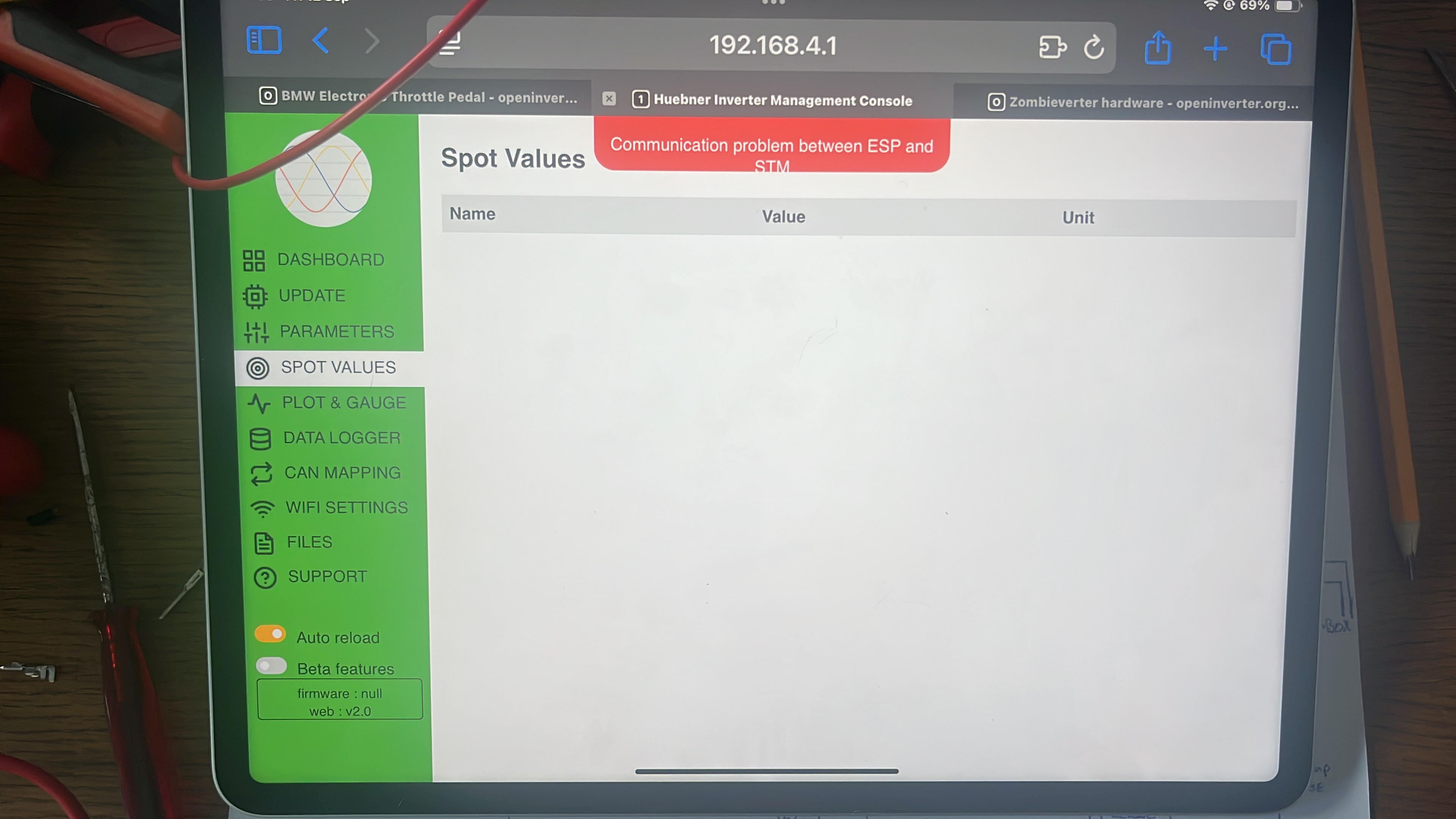

So I managed to get the pedal sorted, turns out I have some sort of coms issue, keep getting this, does anyone have any ideas of what could be causing it and what the best solution is, it’s driving me nuts, thanks in advance
Jacobsmess
- Posts: 871
- Location: Uk
- Has thanked: 545 times
- Been thanked: 153 times
Re: (WIP)Classic Mini, outlander rdu
Looks like your WiFi isnt communicating with your zombie, they deleting the JSON files on the files tab. Then fully power off leave it a few minutes and try again. Failing that, it might be worth reflashing the zombie firmware.
I frequently get the same issue and it seems to be completely random when it appears.
I'll be updating the Zombie soon but if that doesn't work I'll try replacing the WiFi module.
Its really frustrating, the other day it was going Pot values-whiteout-redbanner-potvalues
every 10-15 seconds like it was on a loop. I looked on wiki and it looks like some have managed to set something up through obd/can but I don’t really understand how it all works, damien mentioned it in one of his lab updates but hadn’t managed to confirm as he had a cheapy china adapter that didn’t work
I am getting the same error after I put the ignition on. I have to do all my changes and then put the ignition on to test.
If I remember correctly if I am not doing autobrefresh I can still do changes even after the ignition is on.
I use the Tesla SDU. This happened only after I introduced the ESP32. On the inverter with WiFi on the board when I did not use the ESP32 I had no issues.
