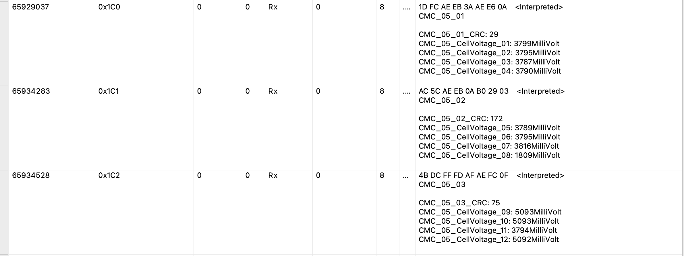

Anyone seen a BMS board reporting seemingly wrong voltages?
Using a multimeter they all measure ~3.8v

moonshine wrote: Fri Feb 17, 2023 12:07 pm Any news on this? I will probably soon receive a couple of GTE batteries for using with a PV hybrid inverter and was hoping to avoid having to drive the contactors with any external hardware.
Was the precharge relay also engaged when you tried this?
If no further info is available in this matter I will try to some variants of these 0x09C & 0x3A6 and see whats really needed to keep the contactors closed.
I figured this out, from the internal can bus at least viewtopic.php?t=3560

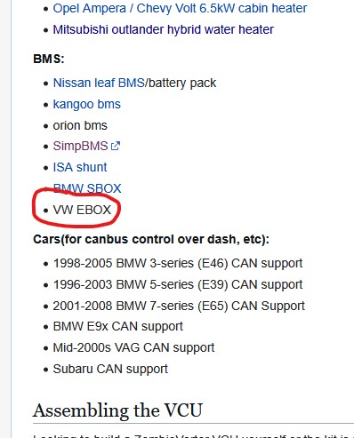

tom91 wrote: Mon Aug 11, 2025 8:22 pm Do you have CAN logs to reverse engineer this?
No I don't have CAN logs. I read the Zombie supported list and I hope that this VW EBOX is what's inside this hybrid battery.
Posts: 2962
Has thanked: 328 times
Been thanked: 847 times
Re: VW Golf GTE battery
Yes, but that is just the contactor box which is on an internal CAN bus. Just like the battery modules also on an internal CAN bus.
The Battery controller/BMS master is connected to those two CAN busses and then connected to external connector the rest of the car.

tom91 wrote: Tue Aug 12, 2025 8:59 am Yes, but that is just the contactor box which is on an internal CAN bus. Just like the battery modules also on an internal CAN bus.
Thank you! If Zombie VCU doesn't work directly then I have SIMP BMS module also, I saw somewhere that Zombie somehow communicates or connects to it.
