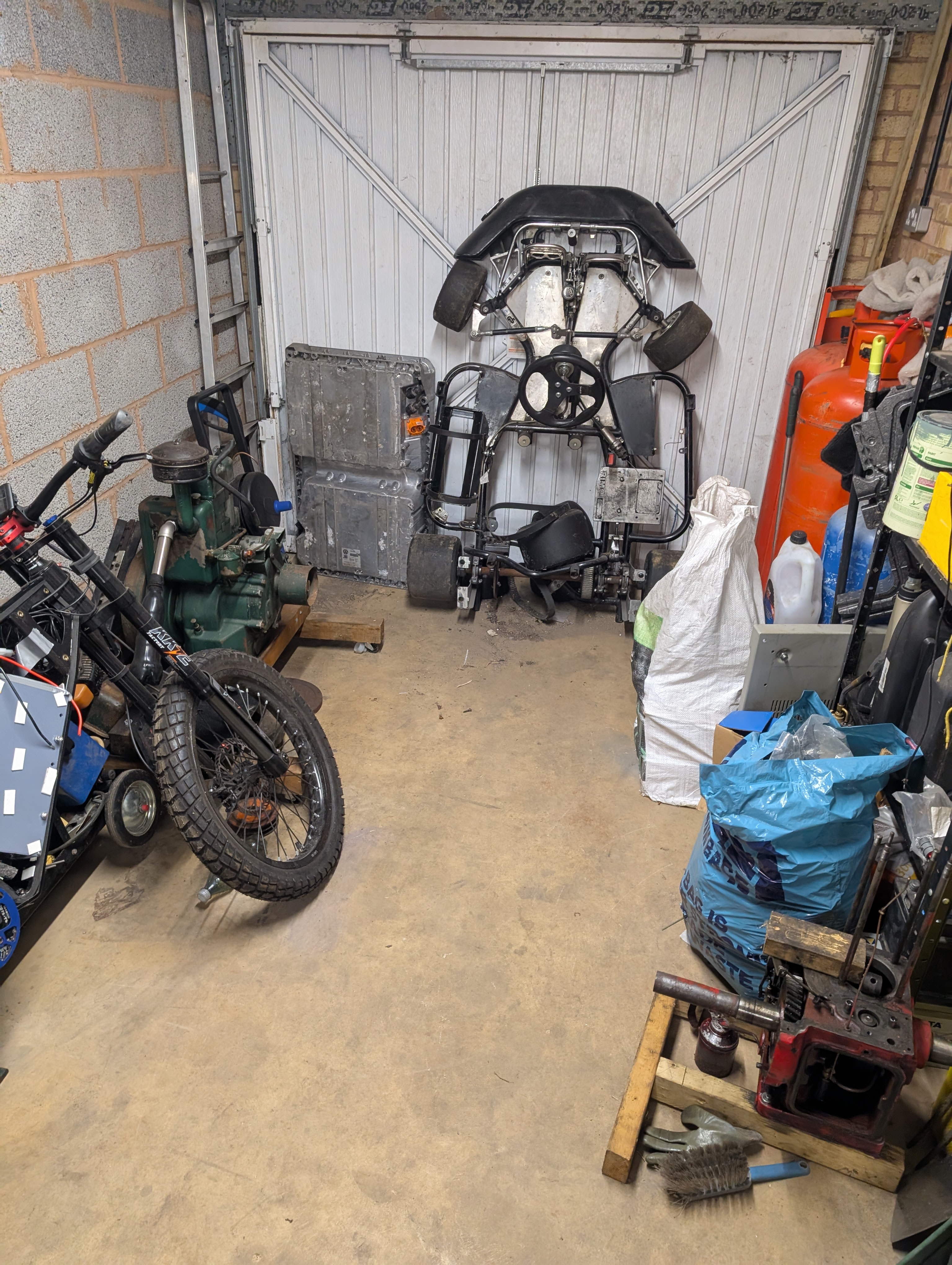

Got garage a bit clear and got the test mule down off the wall.
It's an EX rental kart. The whole thing is 3mm steel so not going to be blisteringly fast. But probably better being sturdy given I will be mounting 2x 24s VW Passat modules on it.
Need to sort a lower seat mount and extend the steering shaft as I am 6'4 and fitting is not going to work otherwise

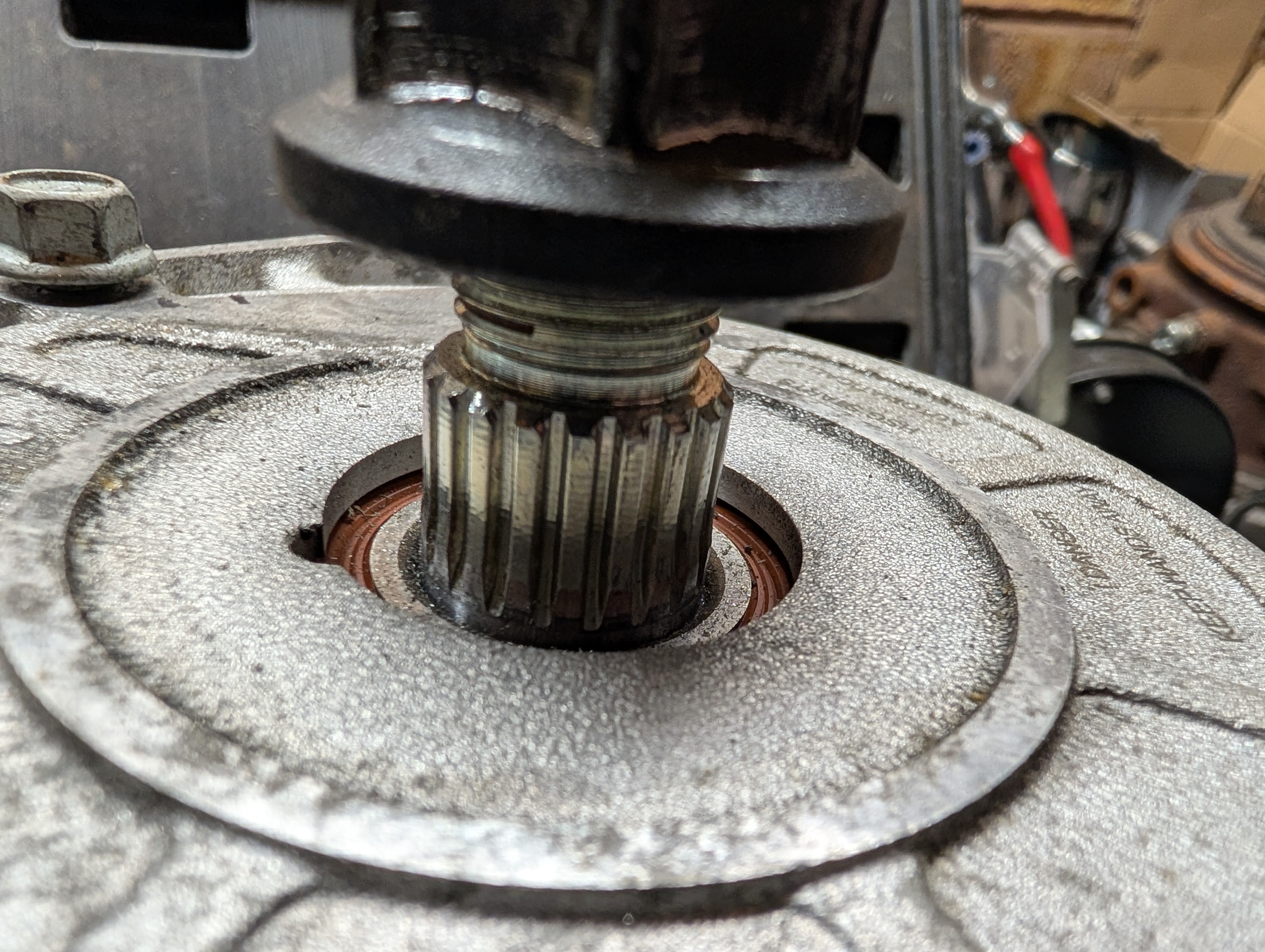

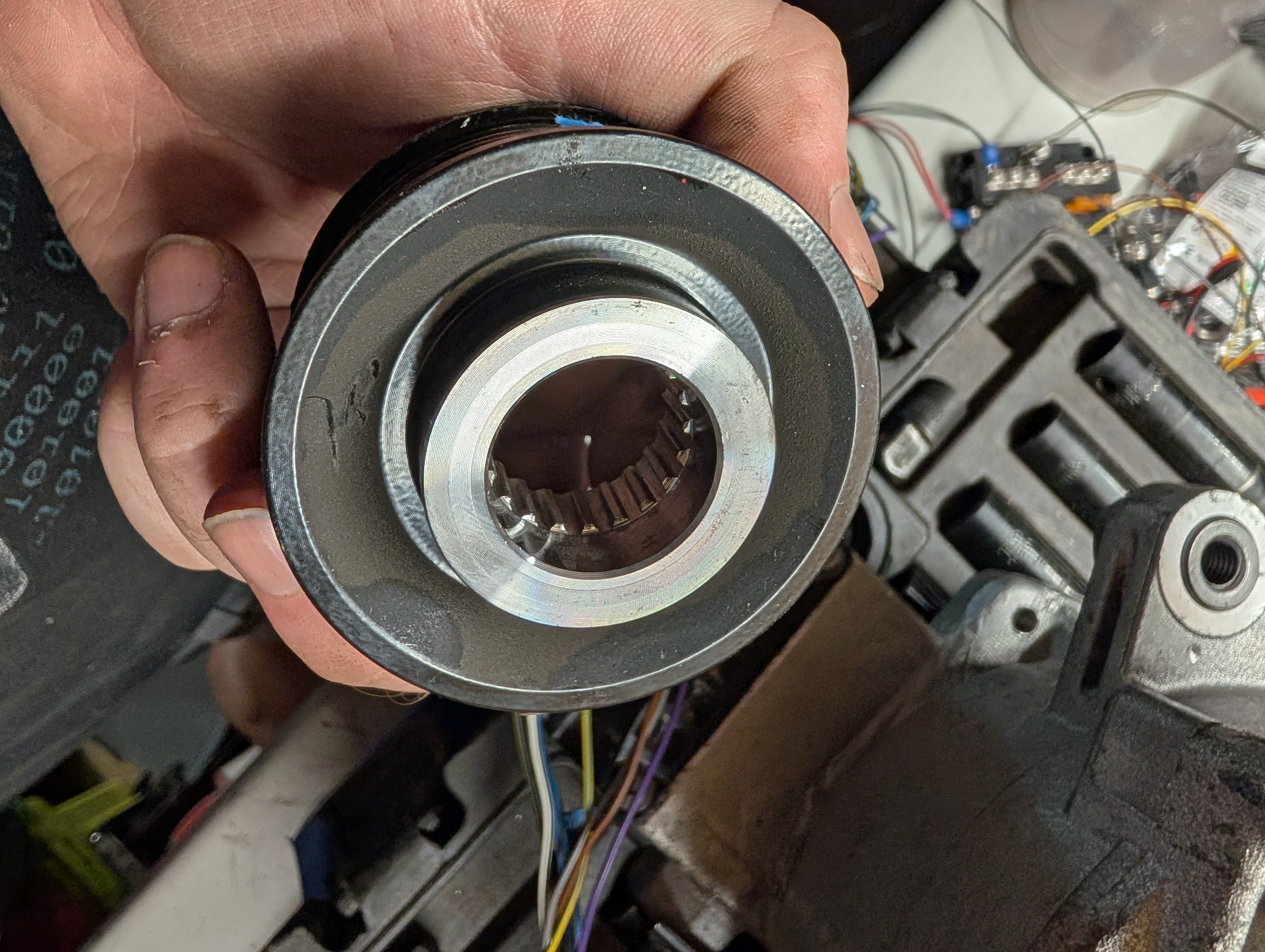

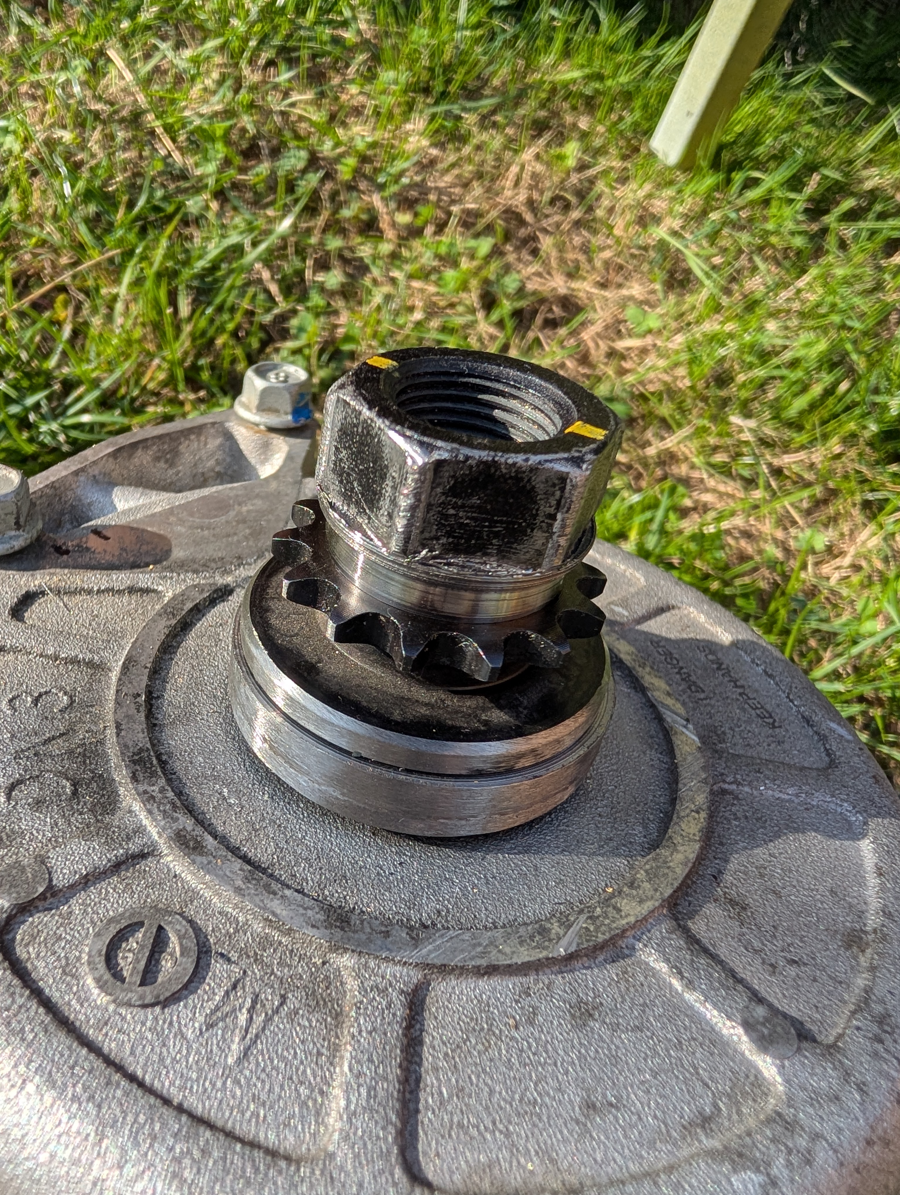

Bit more progress.
Got the pully off of the HSG. Man that was a fight. was a recall issued for the nuts coming loose. I think the fix was emptied a bottle of mystery goo into the threads. I was bending a 1 inch breaker bar.
Splines is not what i was expecting. i read somewhere about a non standard 2.5mm keyway.
I am attaching a rotax max drive sprocket to use existing kart chain drive HW.
I think best plan is cut up the existing pully to keep the spline drive and spacer. then weld the rotax sprocket on the end and turn up a spacer so the nut is at the same depth as before.

You might be able to get a new hub machined / EDMed (or have the HSG pulley machined) so you can swap sprockets.
Is your 3d printer SLA / accurate enough to test print splines? Could go the laser cut sheet metal route too if needed.

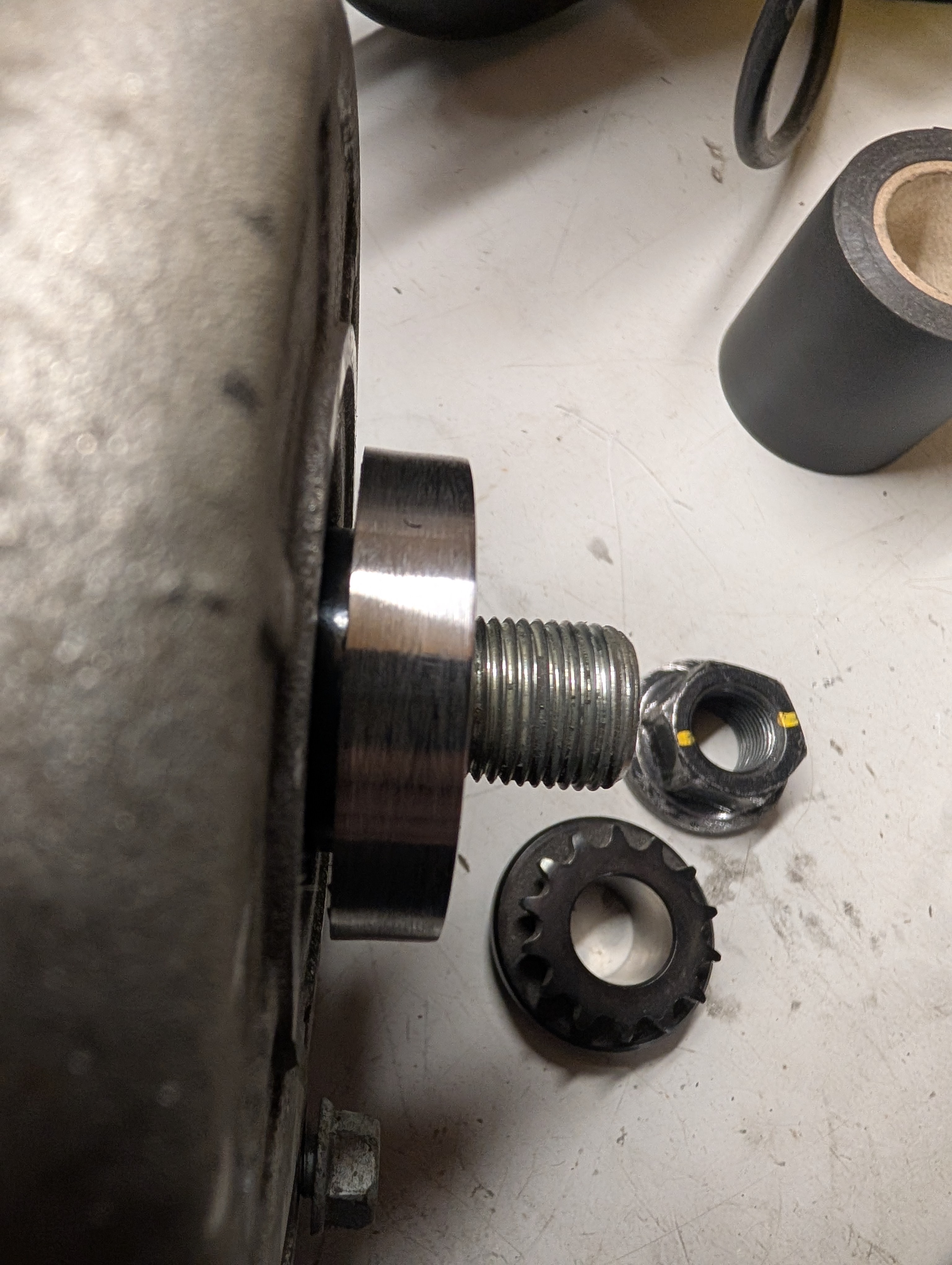

Thanks. Starting to stray into build territory now
Sla printer is absolutely accurate enough to print splines. Just I'm kinda lazy.
Gearing isn't so bad. The axel sprocket is designed to be quick switch so won't have to swap the motor side one.

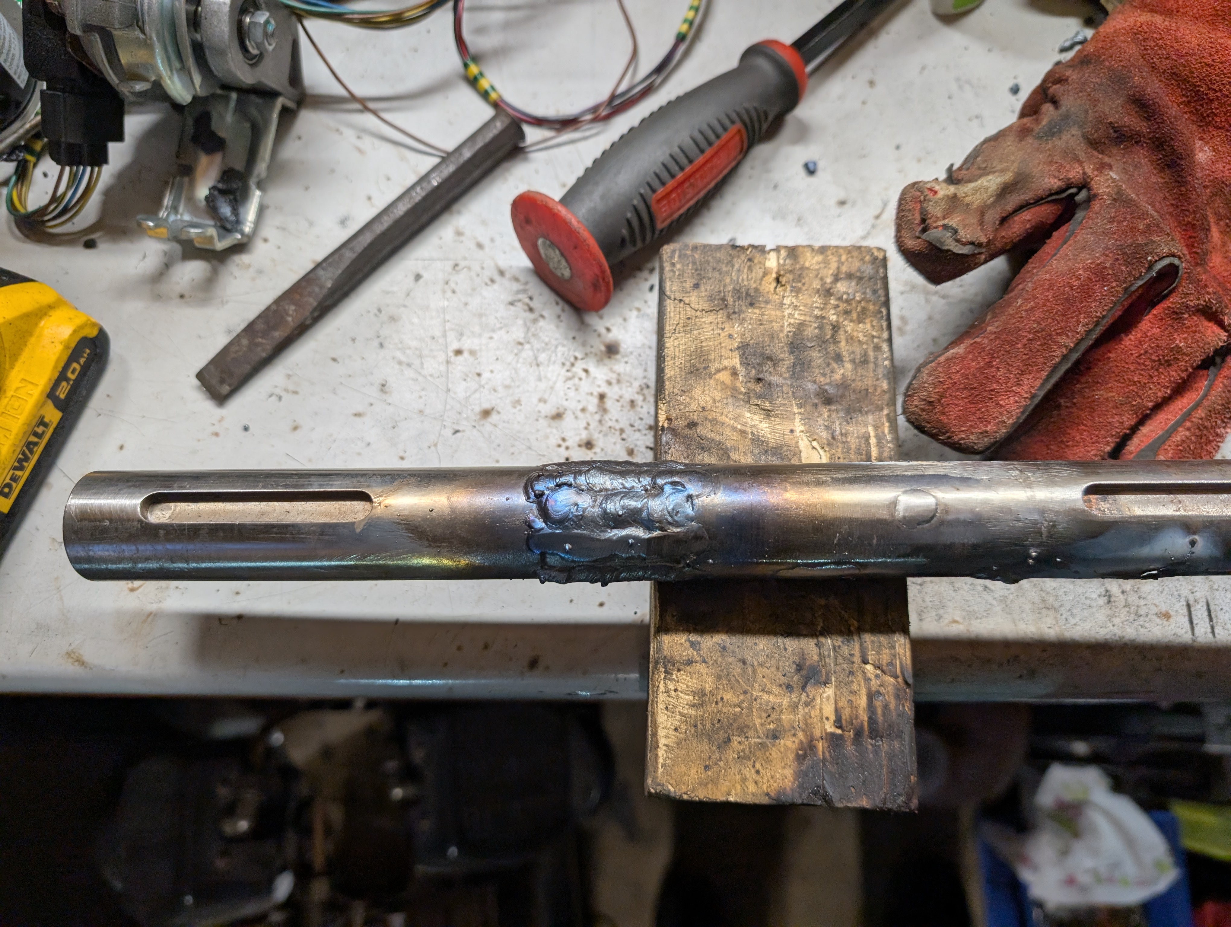

Rotax max kart engines rev to 14,500. The HSG is rated to 14,000 rpm so I have used a rotax front sprocket. Should match up well enough. Rotax engine is about 30hp but it's all top end. HSG at 20kw is fairly close. Worst case I get bored and put an outlander rear motor on instead. Really make the IMA inverter sweat.
I machined down the standard pulley. Sprocket fits perfect on the shaft. Will weld sprocket to standard pulley core. Rough machining was done by spinning motor without field weakening, and using an angle grinder.
Will do proper machining on a mini lathe but wanted to get the worst bit done first.

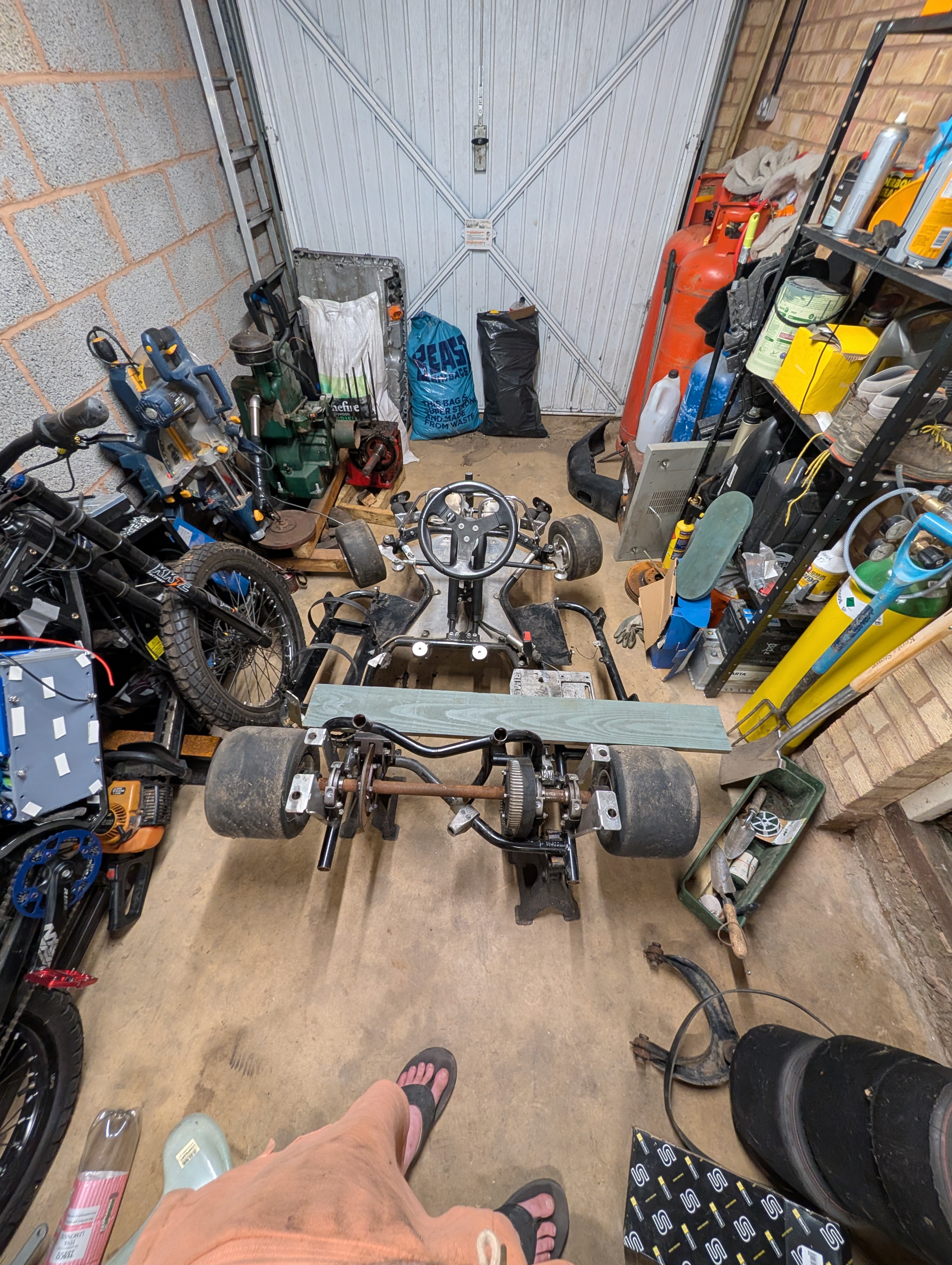

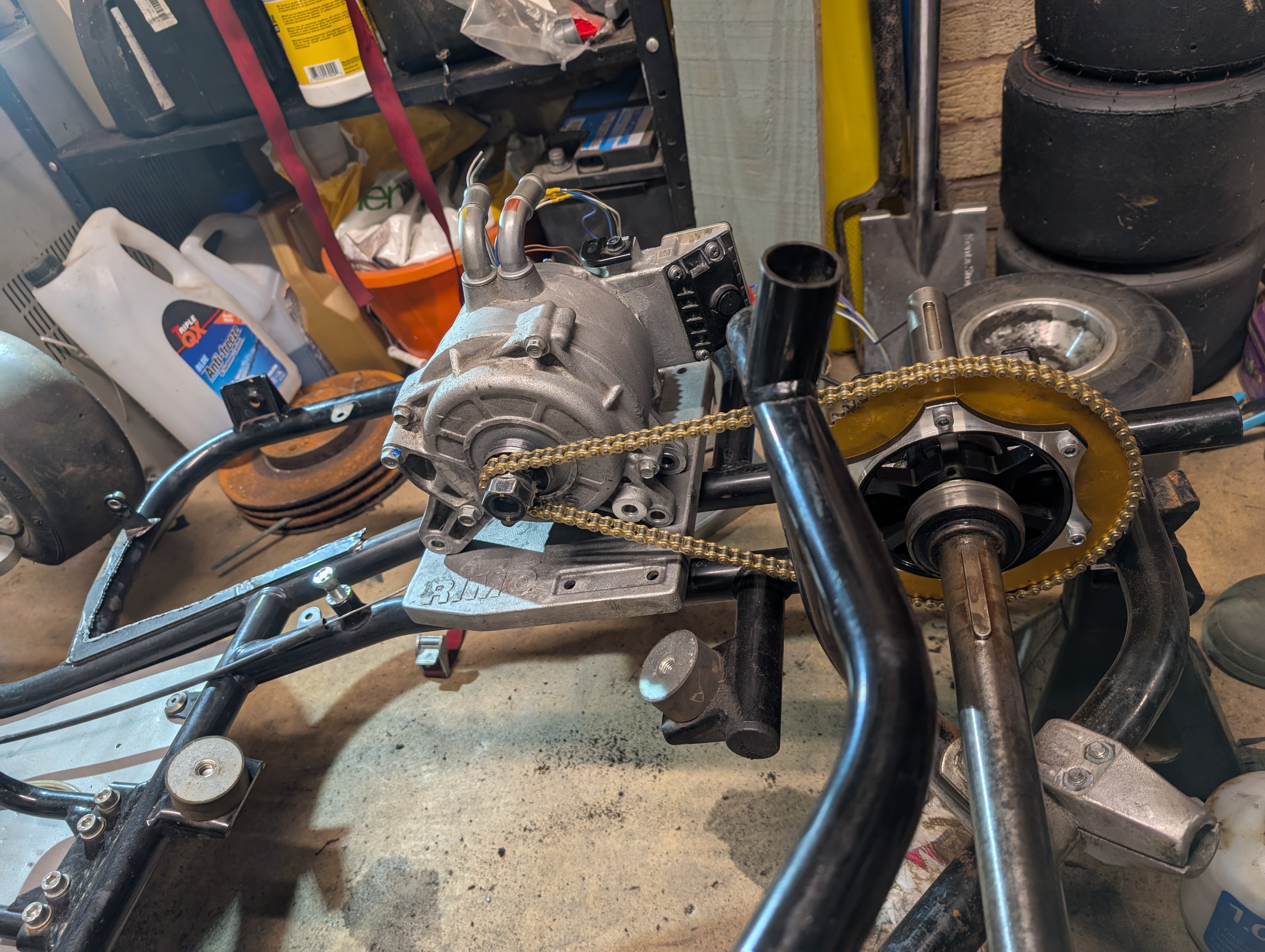

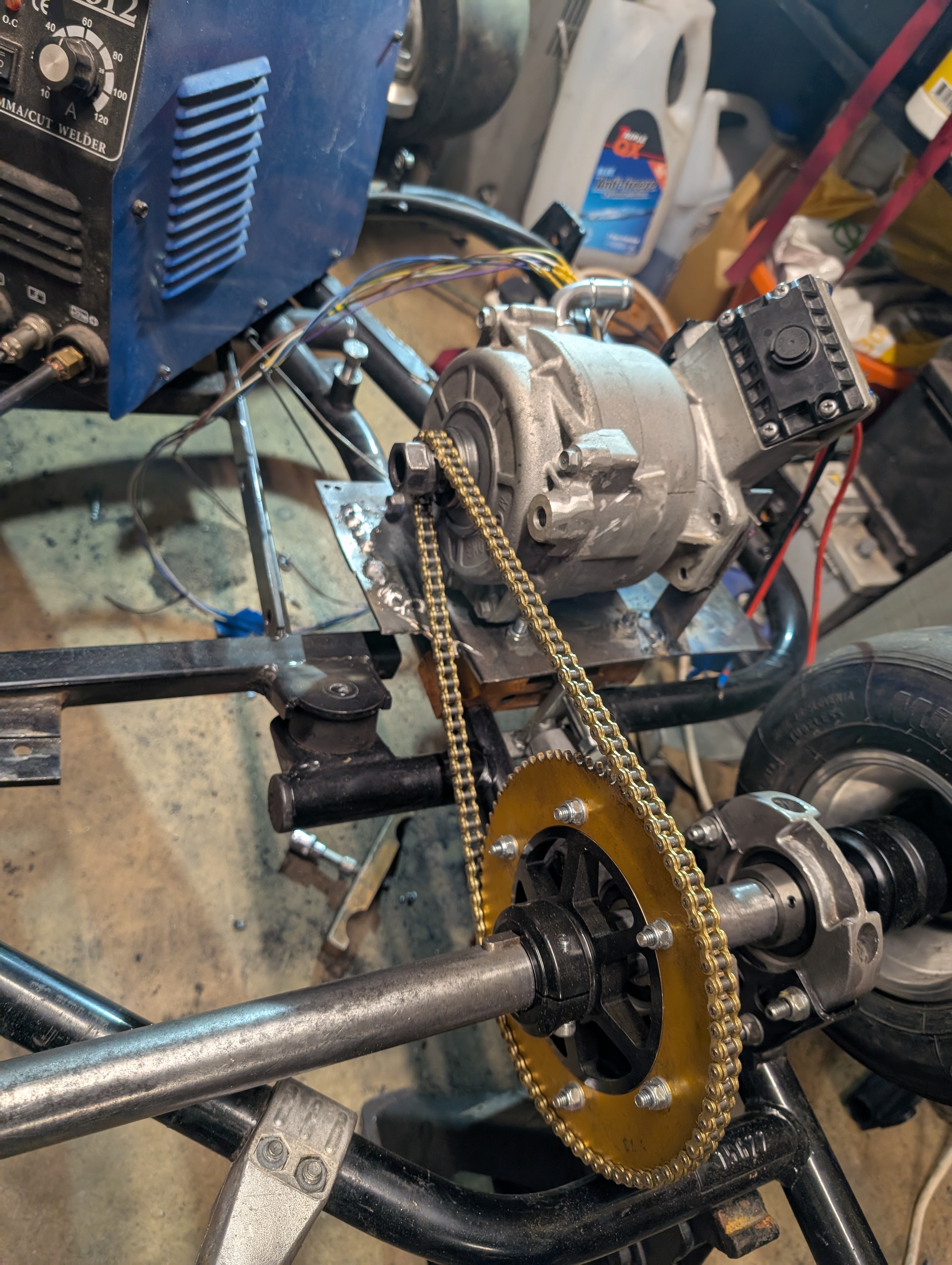

Hi, Mini update.
Chain drive is sorted. nut still has about 6mm of thread engagement not great but not terrible, as the loads will be lower then went running a micro Vbelt. Need to sort driveshaft. it seems a bearing failed and then the shaft started spinning inside the bearing and ate away over a mm of shaft diameter. current plan is weld it up then grind it back concentric. if that doesn't work then new shaft.
Next step is motor mount. I am going to cut off the OEM HSG mount points as they are not concentric to the shaft.
I will instead use the tensioner and idler pully mounting points. with this sort of speed the chain must be very well aligned.
I still need help with odd motor behavior, but that can wait till it is all mounted and running the axel with a break so I can apply load to it.

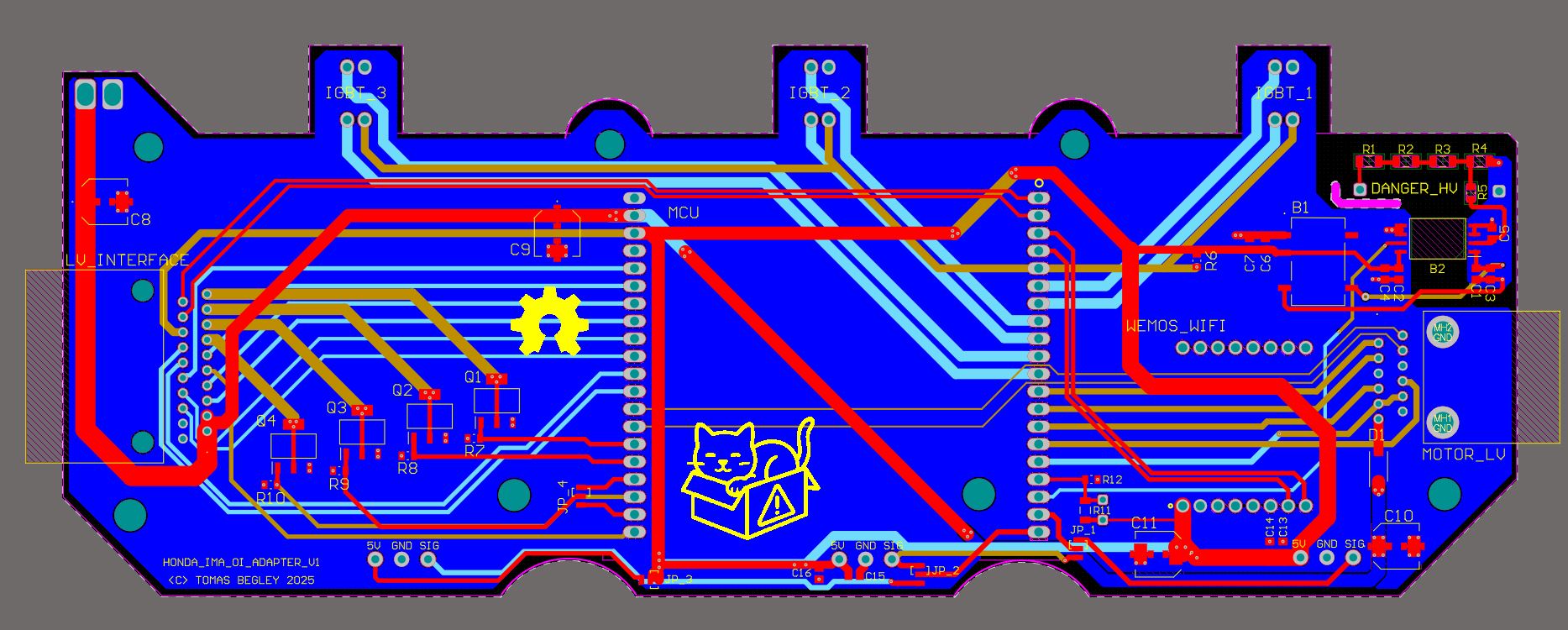

Have had some questions come in around the adapter board I did so figured I would post here to make it easily accessible.
The below images are of the V1 version that I had made. there are some changes I will make if I ever decide to do a rev 2 of the board.
so things of note, firstly it does not need that many 12v capacitors, I would probably keep the one by the mini mainboard and the one by the IMA inverters feed in the top left. ditch the rest.
secondly I had it setup so you could select which current sensors you wanted by soldering a bridge across the jumpers. Not worth it I will ditch this in favor of permanently having 1 and 2 connected.
thirdly D1 is to prevent the 12v battery connection from backfeeding into where I am connecting a dcdc converter. I will remove this in favor of a harness mounted one in future. it is easy enough for someone to bridge or leave empty of they do not need the additional connection.
(edit: reminder to put SD card slot and RTC on v2, CAN debug, flashing, and logging, should still work on v1.)
Hope this helps.

I've been reading on ways to convert Mentor PADS projects to KiCAD. Turns out most promising method is to use Altium as it can import the PADS projects when they are firs exported in ASCII format. KiCAD can read Altium project natively.
A colleague at work showed me quick how nicely KiCAD opens a native Altium project, at first glance there was really no problems at all! Same can't be said on importing a PADS project to Altium, all sorts repair needed before one can use the design...
So if you eventually would want to share the design files for this, you don't have to necessarily do anything overly complicated to have an accessible KiCAD project of your design
Beggernator
- Posts: 40
- Joined: Wed Dec 20, 2023 5:11 pm
- Has thanked: 12 times
- Been thanked: 25 times
Re: YA-HI (Yet Another Honda Inverter)
That's really good to hear, I haven't experimented with exporting different formats from Altium. only importing of various types when we adopted Altium a while ago.
Will try and do a test export when I get a free moment. longer term test I would be looking at a possible revision of the mini mainboard. probably when it too cold to be out in the garage.
I would give that its own thread to discuss options / apatite first. more vs less VCU functions ect. connector pinouts, so on.
Now back to progress I have made with the test mule.
Issue I faced with the existing shaft. clearly bearing locked up at some point and the shaft became easier to turn then the bearing did, I suspect it was like this for some time as it was nearly 2mm of steel eroded.
My excellent welding. tried to rotate the shaft 180 degrees every time to keep the heat stress equal. mostly worked, was a tiny bend to the finished article. quenched then tempered it back to blue so hopefully the shaft doesn't just crack at the first big bump.
I wanted to put it on a lathe but the only one I have access too that is big enough was down for maintenance. so I put it back on the kart and used a drill to spin it over while using a belt grinder, test fits and some hand finishing got it to a solid "good enough" state. no play in the bearing and appears to run true.
Last but not least. motor mounted, chain tight. ready for some load testing, motor mount will get some less bad welds when I get some gas for my MiG. I must admit I never quite got the muscle memory for stick welding, its like TIG but the electrode runs away from you the whole time you are welding.
Will try and get the inverter mounted and some proper phase connections sorted this week and some more test spins can start happening.
I think the current phase connections have more resistance and inductance then the motor itself.
Thanks for the help so far. I will probably need more once the motor is spinning again.
