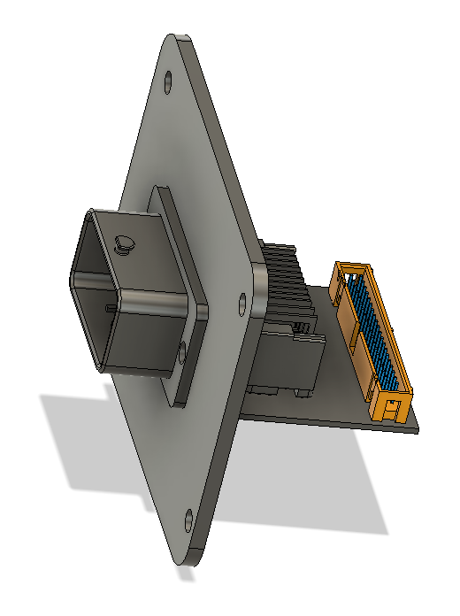

Great stuff. One of the things that gives me pause for thought is the proprietary connector and the need to get the mating half.
Looking at the housing there's an adaptor plate with a seal:
So a 3D printed part that uses the seal is a possibility. Here's a mock up with a molex connector (£7 from Farnell), fitted to a small PCB with a 40way IDC connector which could be connected to the main PCB with a ribbon cable.

@Jack B, I remember from your videos that you've used a similar connector, but I can't see it in my notes. What was it?

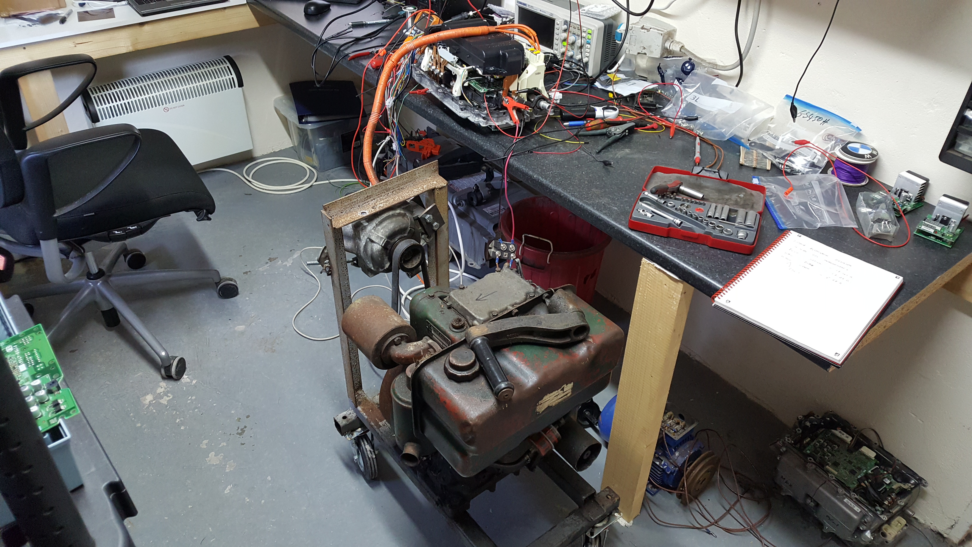

Did some diesel cranking with the prius inverter and learned a few things. The temp sensors in the igbt block work perfectly with the "Semikron" option in the inverter. The prius inverter heats up fast which makes sense as the heatsink is very small. I bypassed the temp sensor input to the inverter and kept cranking. Seems Toyota were onto my game and at 100C the igbt driver backs off very smoothly and bring me to a stop regardless of the pwm command.
So I can't blow them with shootthrough, cant blow them with too much current and now I can't blow them with too much heat.
Great stuff, would also work for the Leaf inverter which uses the same super secret connector. Would you like to share the production data or sell the part?

Hey johu, don't mind sharing the data so anyone can print their own. I'll check out the Ampseal parts and see how they fit. I'm not too happy with the molex part I chose as I'm not sure how to seal it to the new plastic part. Maybe it needs some of Jack's Tiger Seal. Also, I thought the ribbon cable might be better as 2x 20 way.
Has the leaf got the same adapter plate with the seal? If not we can design something to fit instead, but use the same connector, PCB and ribbon cables.

Cool. To me the Nissan outlet looks exactly the same. After all it's a TE part. https://www.te.com/global-en/product-1939561-3.html

Yep, identical. So the Ampseal connector is maximum 35 way and Mr Bauer is using 39 ways for the Prius Inverter. Will keep looking.

34 way is the max ampseal but there are other variants. I was able to buy the unobtanium plug from a guy breaking a prius on ebay.

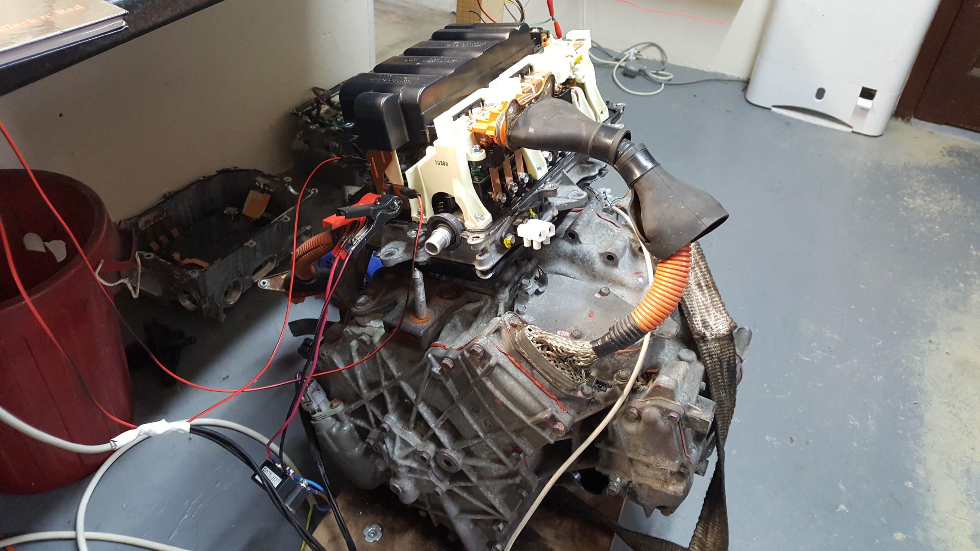

Making some progress with the Prius inverter. Now running MG2 in my modified Gen 2 transaxle with the planet carrier welded to link MG1 and MG2. Should make a good dyno system as I can run one motor in regen and one in drive for testing.
