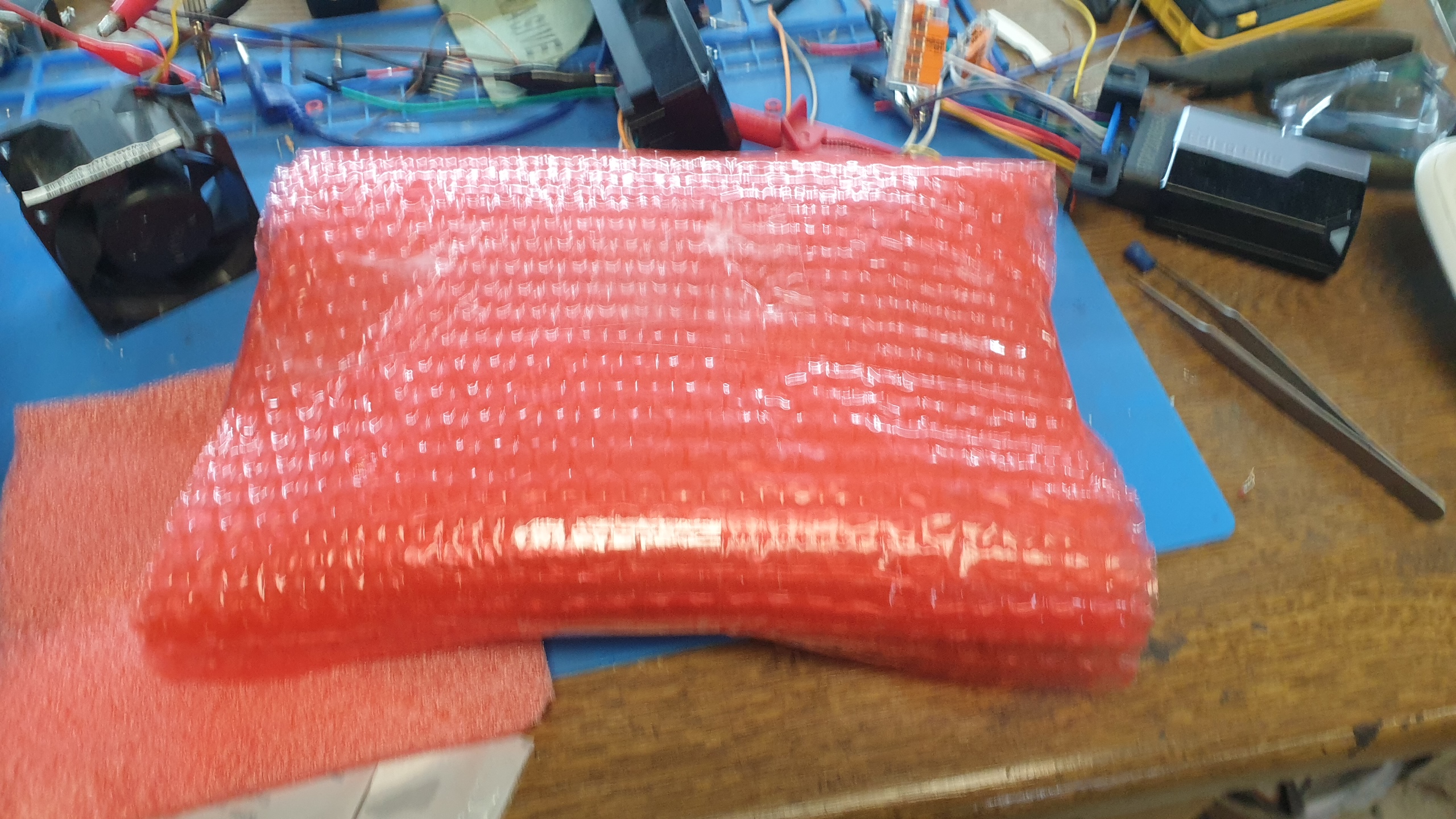

A new Zombieverter was built up this morning to include header and wifi module. Flashed with 2.30A , bench tested on my prius gen3 setup. Then flashed with the Parameters for the E46 (with Gen1 leaf as the OP), taken to the car, fitted, started as normal and ran the motor. Removed , packaged and now awaiting a shipping address for dispatch. A video of this has been recorded just in case as has the serial number of the STM32.
I very much disagree with the approach of randomly swapping parts until something works but thats me. I hope this solves your problem.
Edit : If you need one to one support I can recommend : https://foxev.io/speak-1-to-1-with-an-ev-tech-expert/
