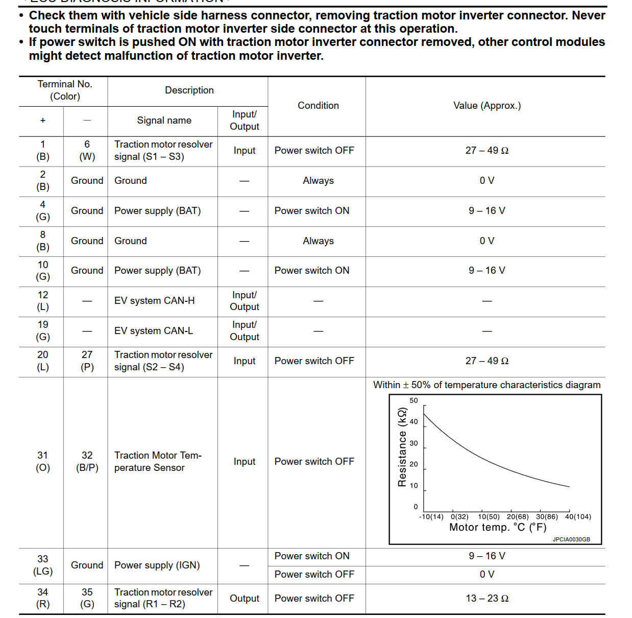

tom91 wrote: Thu Sep 04, 2025 2:31 pm Just watched your video. You are looking at the resolver signals, I guess you unplugged it and it gets unhappy it can not see the required resolver feedback.
It also looks soldered and botched together. Did you modify the OEM harness?
Yeah, its "botched together" as I mentioned above. I've taken it apart and started over from zero so many times now, i've stopped making it pretty. It will be properly repaired once I get to a state where that is justified. Its ugly but there are no shorts and I measured continuity from pin to pin. it was taped over, but that was removed for making the video. I appreciate your concern, agree its not pretty, but it is functional for my current needs.
I have been using this image I posted below as reference. Also as I noted above, I measured these pins and got what I felt was appropriate "~40ohms for sin/cos, 20 ohms for exciter, and temp sense was 15k-ish. No shorts to case. Seem about right?"
As I understand it, here is the correct wiring I've conjured up from the sources I could find. Maybe I got the connector backwards, as the pin numbering on the connector is reverse the manual. Note: when I disconnect HV and spin the motor by hand, I can see speed go up to a positive number, and when i spin it opposite direction, it goes to a negative value (on the gui) - spot values.
PDM Pin / Resolver Pin & ID / color
1 / 1 Sin + / Black
6 / 8 Sin - / Green
20 / 7 Cos + / Pink
27 / 6 Cos - / Blue
31 / 4 Temp gnd / Orange
32 / 3 Temp / BLK&PNK
34 / 5 EX / Red
35 / 2 ! EX / Green
After re-reading this, I'm not sure if what I'm trying to show is being conveyed so I want to clarify; I plug it in, power on and in that brief period it spits out the waveform and then stops. Only then do I unplug anything. Maybe that's what you meant, but I just wanted to make sure its clear since you're taking all this time to help.
I'm guessing it doesn't like my resolver wiring, but I guess I'm not seeing the correct way based on my understanding of the resources and measurements I've come across.

No idea but your inverter is not happy with the resolver. If it is plugged in and you see that behaviour something clearly does not add up.
Did you start with an OEM harness? I do not know how the twisted pairs are and the shielding is done of the resolver wiring.

tom91 wrote: Thu Sep 04, 2025 5:10 pm No idea but your inverter is not happy with the resolver. If it is plugged in and you see that behaviour something clearly does not add up.
I'm using the original OEM one and wired 1:1 as it came. The pairs are twisted and shielded.
I'll wire up a new one and see what happens
Well, thanks to you driving me to rewire it again (thank you!), I've discovered an issue with the wiring, and for the life of me, I can't make heads or tails of this. Is the exciter single-ended? I guess I expected differential
I have it wired correctly per the 2011 Service Manual. But the pins don't match the circuit. I can't see any other way for the pins to line up, so I can't imagine they're transposed...
Referring to the green external PDM connector, Pin 35 (exciter R2) is connected to motor temp sense ground on the PDM (pin 31) .
Please see my photos, and if you have any idea what the hell I've done to mix all the pins up . Is this some half year revision or something?

Looks to me that you're on the wrong row for the motor controller board. Looks to be labeled 1-20, then the next row is 21-40, right? I see it as you have 17 and 15. Unless you're labeling another connector number at the PC board..

Still no dice but here's a running list of where I am if anyone is keeping up:
  • ZV will go into Run with full Nissan battery pack and BMS installed.
  • All wiring has been checked and I'm very confident is correct.
  • Resolver wiring is correct, shielded, twisted pairs, coils compared impedances against manual (38ohm SIN/COS/15ohm EX/15k ohm Temp). Continuity from resolver (external ) all the way to PDM PCB
  • Resolver pairs were swapped individually and in multiple permutations just for reference.
  • Motor will spin briefly if the ZV&PDM are powered on and pedal pressed within the first 1-2 seconds of boot up. (PDM will put this out regardless of presence/connection of ZV)
  • If a 7-10khz signal at 6v P-P is sent from a standalone to the resolver exciter, I can see opposing some waves on SIN/COS pairs that alternate when the motor is spun by hand
  • Torque and speed are registering as -204 and 16383 which are the defaults/fallbacks I've found in the code , and I now get that reading regardless of resolver in any wiring setup or if it's plugged in . (Something not right here)
  • Pedal is calibrated
  • Using solid standalone 13.5v /80A psu for 12v system.
  • ZV has been updated to 2.30
  • Leaf ran without error or codes prior to disassembly
Also of note: Zombieverter arrived with components broken off, and have not been able to get a response from Damien regarding possible issues regarding that. I don't think it's causing an issue as they were broken at the solder joints and tested ok out of circuit and were cleanly resoldered. Still suspect of this.
Any suggestions anyone has would be appreciated. I will leave this open and update it for others if I find a solution

Ok, I'm literally waiting for paint to dry so I'll jump in. I did indeed receive your email (amongst many others) but as I have made crystal clear in the past I DO NOT get involved with other people's projects. Nothing against you or anyone else its down to me being not in a fit mental state to disengage. What that basically means is I won't be able to sleep until everyone's project is up and running and that is a very quick way to a breakdown.
So lets see : You have a known good leaf stack removed from a car. Connected up with the OEM loom correct?
The motor will spin briefly if throttle applied quickly after Run mode entered? But will then stop responding to throttle requests?
If so this indicated the inverter entering a fault state.
You do not receive motor rpm nor motor temp correct?
Here is my advice. Make a video, show us everything. Nice and slow and in detail. If you don't wish to appear in public just make it unlisted on youtube and send Tom and I a link. You can then delete it when we have seen the setup.

Yes it is wired correctly and the temp sensor is included . I will again post my wiring below . There is continuity from the PDM pins (internal) to the end with the connector on the motor. It is all connected. I'm not sure if this in reference to another temp sensor, bit the one on my resolver is connected.
I'll also restate, the resolver pairs match the impedances listen in the service manual, whether I test them on the connector, or all the way up the wiring loom. The temp sensor changes with climate conditions and appears to be functional and accurate. I have swapped pairs to see if there is a difference, no difference is observed in operations or UI numbers.
1 / 1 Sin + / Black
6 / 8 Sin - / Green
20 / 7 Cos + / Pink
27 / 6 Cos - / Blue
34 / 5 EX / Red
35 / 2 ! EX / Green

Here is a manual with EM61 specific wiring info to compare. https://www.thunderstruck-ev.com/images ... 9908742192 on page 11
It maybe good to run leafspy on the CANbus with an obd2 adapter to try and read the inverter faults if possible. I have never tried this myself, or ever personally wired a leaf drivetrain.

If the inverter was running in the car then its likely to be fine. Something however is causing it to enter a fault state from which it will not recover until all 12v power is removed for a time and reapplied which explains the effects you are observing. A leafspy check would be most revealing as Tom suggests.
Re the problem of the Zombie having component damage I doubt its the problem here but I will of course send a replacement if it looks to be the cause.
Circuit diagrams , board layouts and BOM are freely available on Github : https://github.com/damienmaguire/Stm32- ... r/Hardware

I got a Leafspy scan once I read the .... manual, and i've attached it below. I'll leave that up to interpretation. A lot of if is complaints from disconnected CAN systems, but it also has what may be a resolver or a handful of other things.
I did also read the motor when I spun it by hand, and got a graph in the ZV UI. It works both ways, and Im assuming speed is derived from the resolver output, so there's that. If thats the case, then that points to possibly ok resolver?
Also, the motor does spin up when the initial blip happens at the boot time, and it appears to be responsive to throttle input for those brief few seconds. Also a check for the resolver being ok. Coils are all still within spec, no burns or shorts, no discolored enamel, either....
Are there resolvers available? The leaf Service Manual says replace the motor if the resolver is bad.
This is still screaming bad wiring, but I just cannot find where that could be.
Again, thank you all for helping and sticking with me.

Looked these up for y'all
Nissan FSM lists these on a priority in which they should be checked
1.
  • P0A8D 14VOLT POWER VOLTAGE
    P0C79 DRIVE MOTOR A INVERTER VOLTAGE
    P318E CAN ERROR
    P3193 CAN ERROR
    P3197 CAN ERROR
    U1000 CAN COMM CIRCUIT
2.
  • P0A1B DRIVE MOTOR A CONTROL MODULE
3.
  • P324F DRIVE MOTOR A INVERTER IGBT
beeetown wrote: Sat Sep 13, 2025 12:43 am This is still screaming bad wiring, but I just cannot find where that could be.
Why you don't want to share your full wiring with few images?
Have you checked that you supply the inverter enough +12V power and that your lab power supply? Are you supplying a high enough voltage (9-16V as per TMS-32)?
P0C79 Drive Motor “A” Inverter Voltage Too High
If the high voltage DC voltage is too high
• Traction motor inverter
• High voltage harness or connector
• Li-ion battery
• High voltage parts except for trac-
tion motor inverter
P318E CAN data error
If traction motor inverter detects CAN data error
VCM
P3193 CAN data error
Li-ion battery controller
P3197 CAN data error
Electric shift control module
U1000 CAN communication line
If CAN communications signals continu-
ously cannot be transmitted
Harness or connectors
(CAN communication line is open or short-
ed.)
P0A1B Drive Motor “A” Control Module
A malfunction is detected in the traction motor inverter (motor controller) Traction motor inverter
CAUTION:
If this DTC is detected simultaneously with P0A8D, inspect the 12V battery first, as it is suspected to
be dead.
P324F Drive Motor “A” Inverter IGBT Over Current / Over Temperature /Over Voltage
• If an over current has occurred in the IGBT
energizing current
• If IGBT temperature is too high
• If there is overvoltage in the high voltage DC
voltage
• Traction motor
• High voltage harness or connec-
tor
• High voltage cooling system
• Li-ion battery
tion motor inverter
CAUTION:
• If this DTC is detected simultaneously with P0A8D, inspect the 12V battery first, as it is suspected to
be dead.
