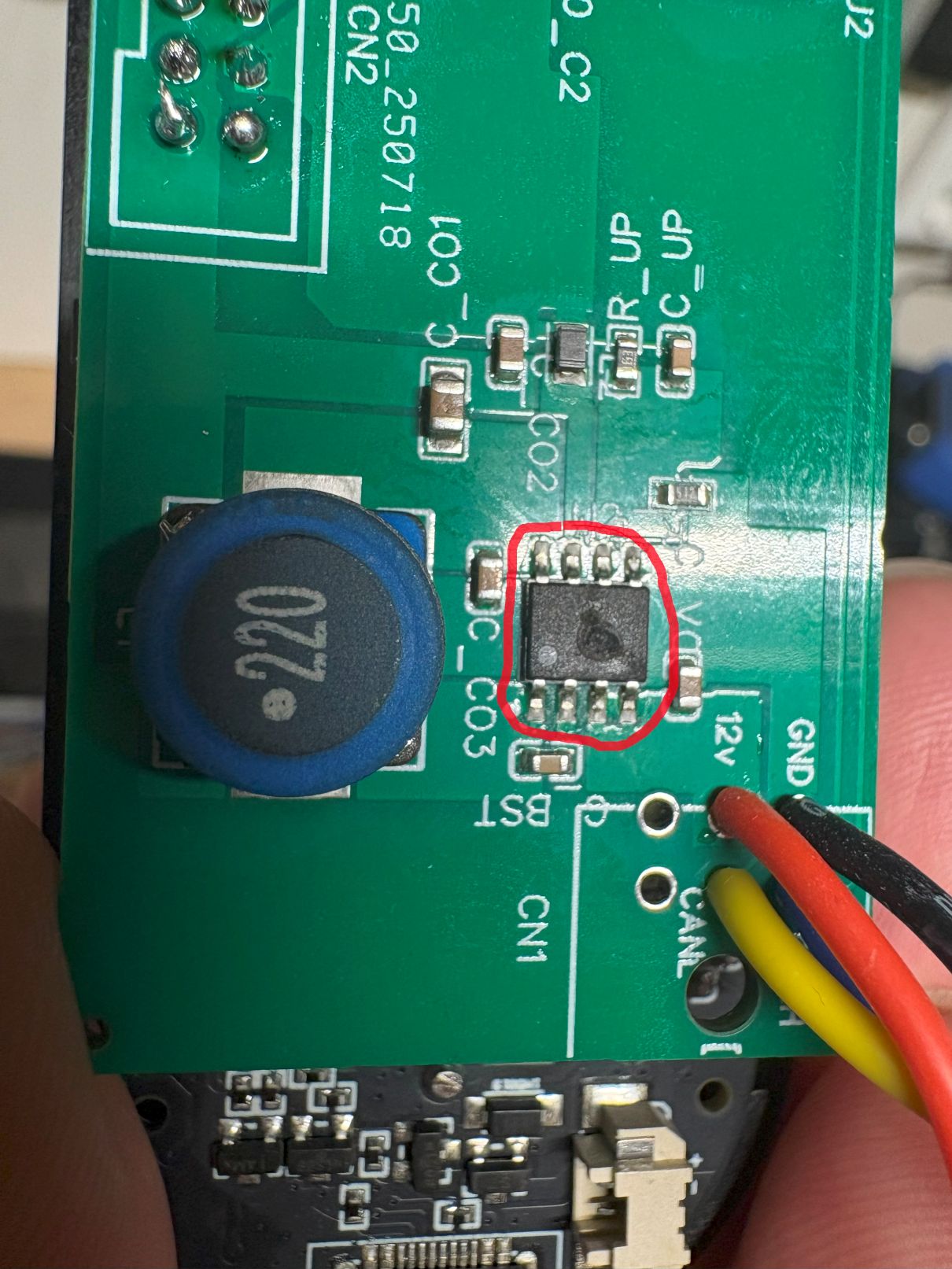

Thanks, I got it programmed and updated via OTA (now with working spiffs). If you know what you're doing it's not that hard at all
But still no communication with the Zombieverter. And when I was looking what happend on the can bus, the ground wire fell on a live 12v contact
. Resulting in smoke. The Lilygo does nothing anymore
. The board is also broken. The part circled in red is burned out. Do you know its part number (I can read D9 and the rest is burned)? Then it might still be salvageable.
If the board is beyond repair, is it then possible to use an SN65HVD230 CAN Tranceiver Module?

That's not the can transceiver, it's https://item.szlcsc.com/137138.html but the can chip might be dead too. I've got 1 board left, I'll stick it in the post to you.
SDO should work on either interface with the looks of it, but you could try changing the ODB2can in zombie.
canInterface[1]->RegisterUserMessage(0x601); //CanSDO
canInterface[0]->RegisterUserMessage(0x601); //CanSDO

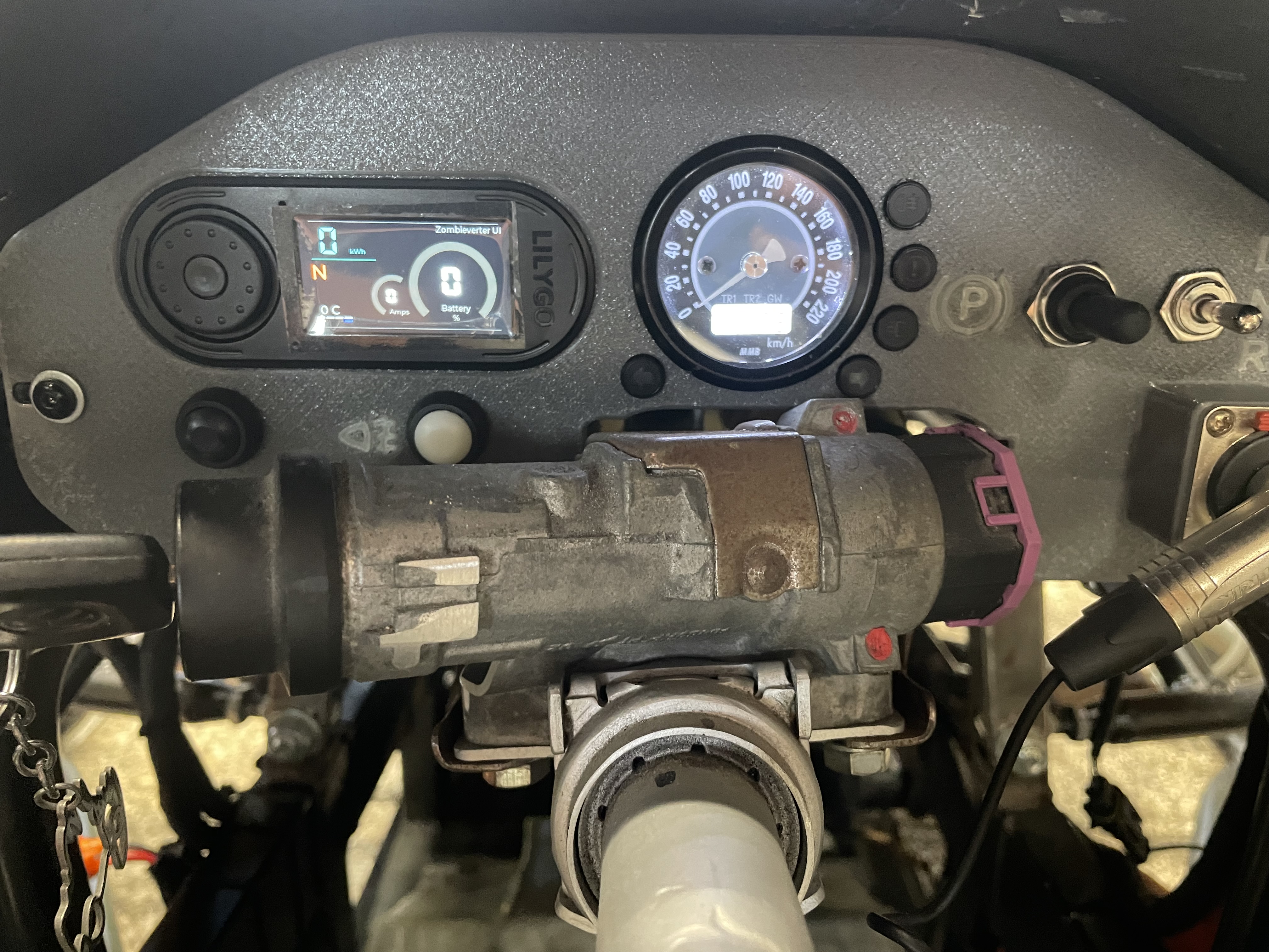

I have the Display working. The new chip, which I soldered on the board exploded, so it is beyond repair. So thanks again to Jamie for the new board. But I also got the Lilygo working with an regular can module and usb power (so you can use the Zombieverter Display without the special board).
I made a video about it. It took me a lot of effort to get this far, so maybe the video can help someone to get it a bit faster.
