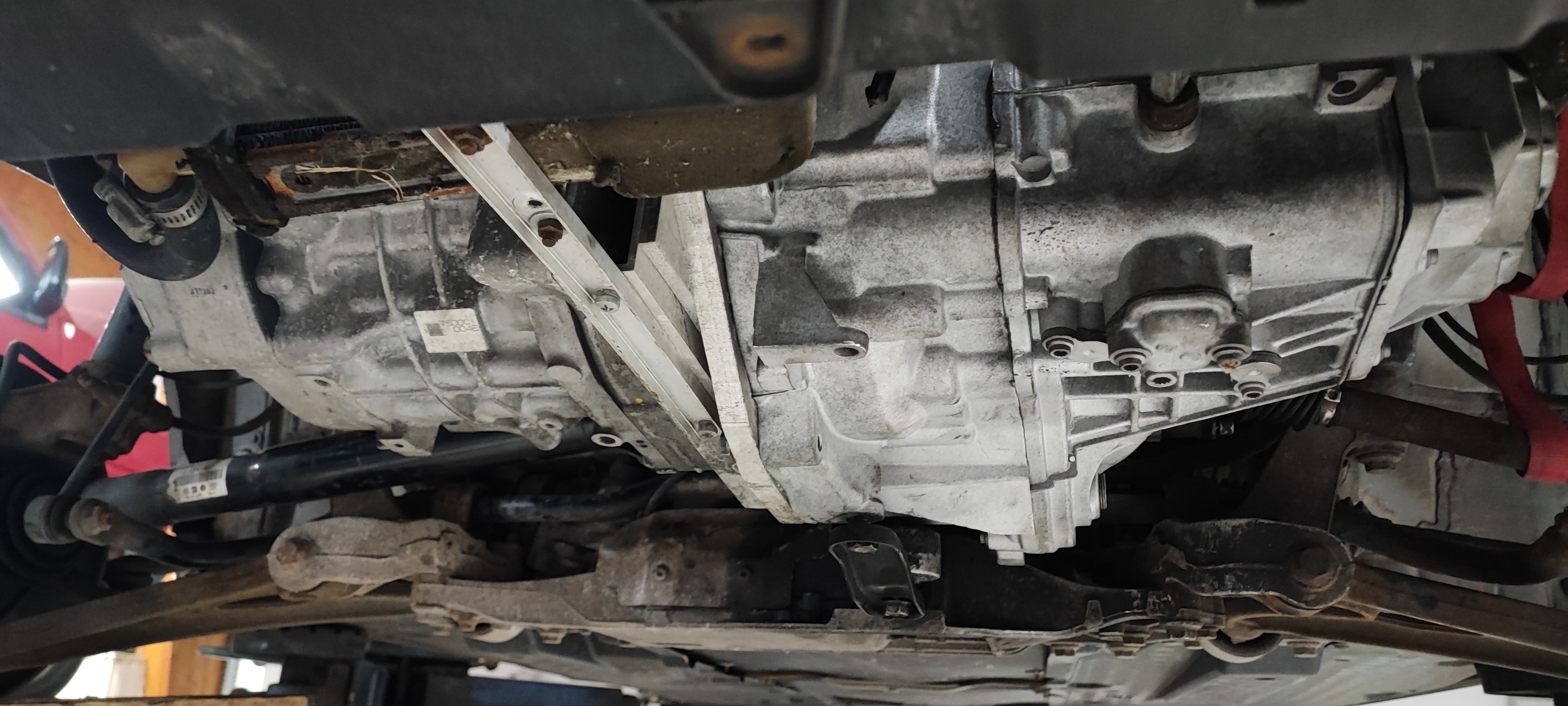

I was thinking on some failure modes for transmission diff section....
Contaminated gearbox oil (or lack of oil).
Grinding due to insufficient lubrication.
Vibration from increased friction and heat.
Drain and inspect oil for metal shavings or burnt smell.
Worn differential bearings
Grinding noise because of bearing wear.
Vibration especially noticeable at low RPM when load is minimal!
You need to look for metallic parts in gearbox oil and inspect bearings for play.
Damaged pinion or side gears, i would think probability of this would be lower...
Grindingnoise here means worn gear teeth.
Vibration because of uneven torque transfer between wheels.
Look at gear teeth for pitting or breakage.
Damage to output shafts, this is why i asked if you can actually apply torque on the way up hill.
If splines are worn on CV joints... Inspect stub shafts for damage.
_________________________________________________________________________________________________________________________
All in all you need to drain the sump and inspect the oil for metal shavings. Maybe use a small magnet and move into the drain opening to see if you can pickup additional shavings.
Than take off the stub shafts and inspect them for wear.
After that you should find a specialist with propper tools if you want to dissassemble transmission further...

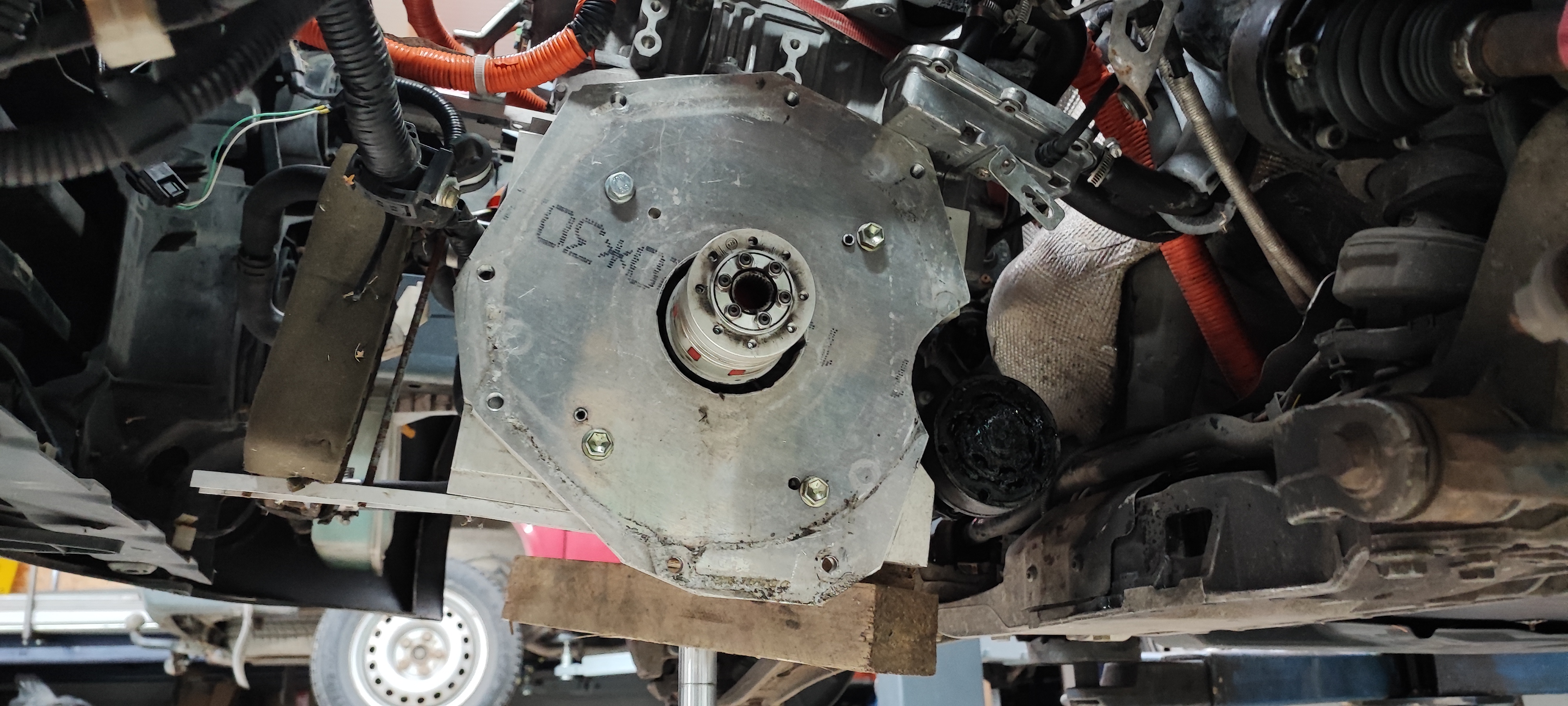

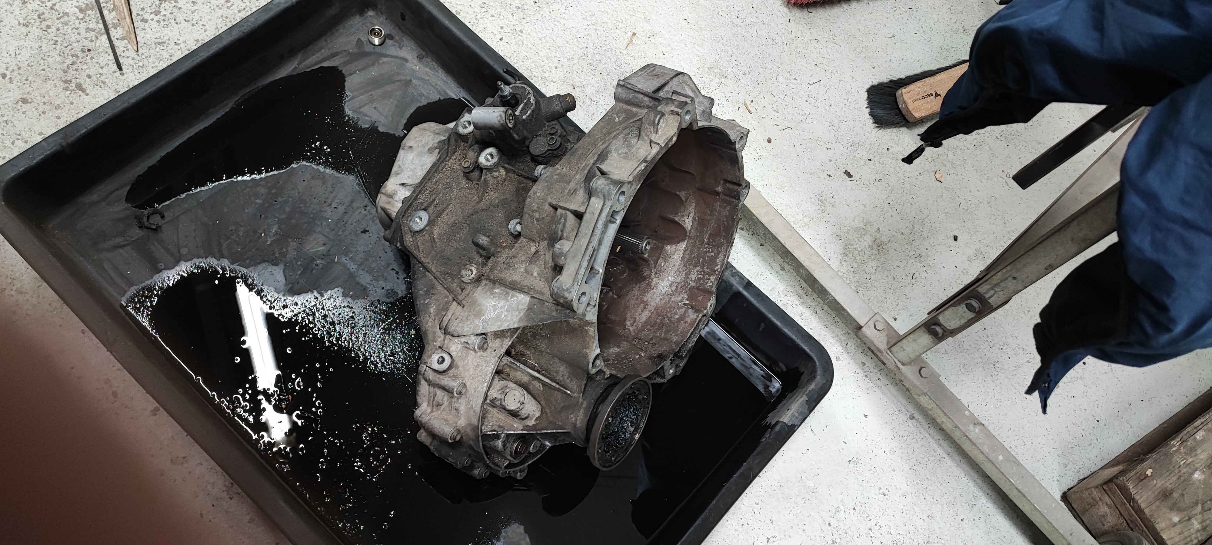

Today we got cracking on the gearbox swap. I got an overhauled one for roughly 900€ delivered. It is in and very shiny
When turning manually even without oil it sounds much smoother than the crusty one As arber suggested a lot of metal was in the oil. Did we use the wrong oil? Did we not fill up all the way? Or is the gear box just old? Who knows. This time I know I need to get 2.5l in there and the oil came with the gear box.
While at it I also inspected the shaft coupler and splines and everything looks great and has no play. Should be back on the road tomorrow, perhaps with a quieter and more efficient car.

Hm... do you shift using clutch or simple upshift or downshift on unloaded motor?johu wrote: ↑Wed Nov 12, 2025 6:04 pm ....
Could be that your old TX was already bad when you got it...
With the new one i recommend you drain and replace the oil. Which year Touran do you drive? Up to 2010?
As far as i see your Touran should use 2.5l synthetic 75W-90 gear oil that meets VW specification G 052 171 A2 or G 052 726 A2.
Release oil from the bottom plug, refill oil through the side plug. This will show you are full when oil overflows.

Synchros are very likely bronze, / brass, so a bronze / gold color. Some glitter is normal on a high mileage transmission.
Bearing bits are chrome / shiny / dark. Gears are too.
What rpm are you spinning the motor to normally? It's still my guess that the input rpms were run too high and one or both of the input shaft bearings failed from high rpm then got into other sensitive areas and cascaded.
Is there slop in the input shaft?
Gear oil and engine oil end up almost the same viscosity when you look at them on a chart. VAG gearboxes usually need friction modifiers for the synchros to work well, but otherwise as long as there's oil in them up to the fill point they're usually fine.
Do you have any close ups of the metal bits? May be able to identify some pieces.

No clutch, see above. But I hardly ever shift but keep it in 3rd
Nailed it
Most of the time it sits around 4000 rpm, max speed is 7500 rpm but I rarely ever go there
No, it's solid. Also if I change to neutral, hold on to the input shaft and spin the output the noises are still there.
There weren't solid pieces in the oil (or they haven't come out), more of a glitter, bronze and chrome.
Too bad I can't take the transmission apart because it is sent back in exchange for the new one. I could ask them to send me pictures or a report or something, maybe they've got the time...
