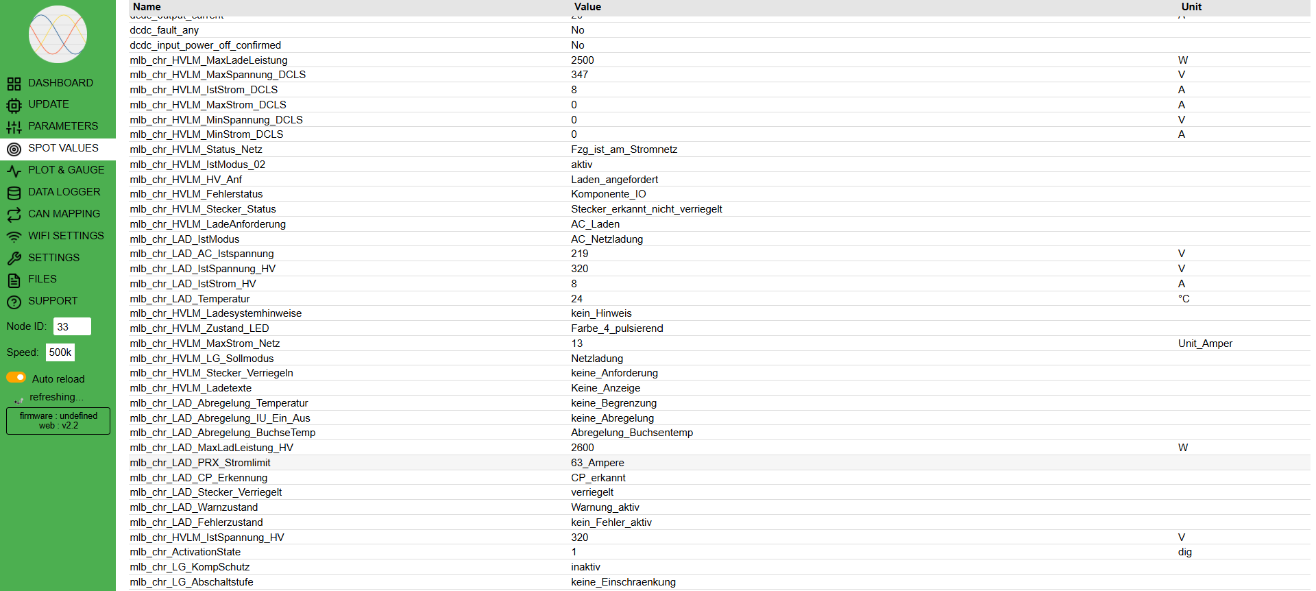

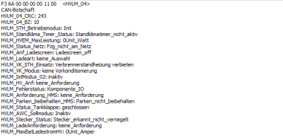

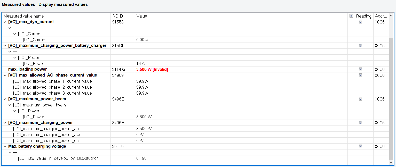

I've begun updating some of the documentation and wiring diagrams, As I've finally got to the stage of installing and actually charging with it using Zombie. Been trying to align whatever values/datatypes between each. Since I've made some mistakes in some of the conversion/scaling.
For some reason I'm getting capped at 3500w
Even though my lvl2 cable is detected at 40A (240V)
I'm seeing the following values:

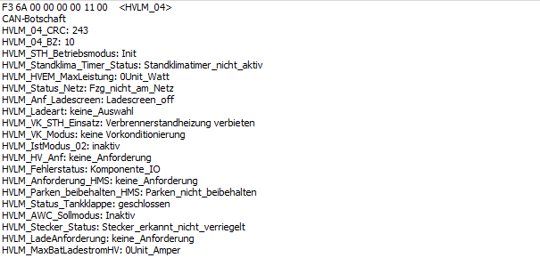

0x488 - HVLM_06 - HVLM_MaxLadeLeistung: 3500w
0x53C - HVLM_04 - HVLM_HVEM_MaxLeistung: 3500w
0x67E - LAD_02 - LAD_MaxLadLeistung_HV: 3500w
I suspect that it was a previous charge limitation that was entered via the charge scheduling system.
If you have VCDS, I think the charge limitation values below cross reference to the CAN messages above:
IDE08639 - max. loading power
ENG125868 - maximum_charging_power_battery_charger
ENG250367 - maximum_power_hvem
I should hopefully know more tonight, as until last night I was only testing with 120v.
Going to connect up with ODIS / PIWIS to see what other runtime values I see... And if any other errors are generated.

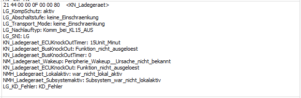

I'm using a 2518FD SPI CAN channel added into zombie. So my Can-Send is slightly different but other than that it's pretty much the same.

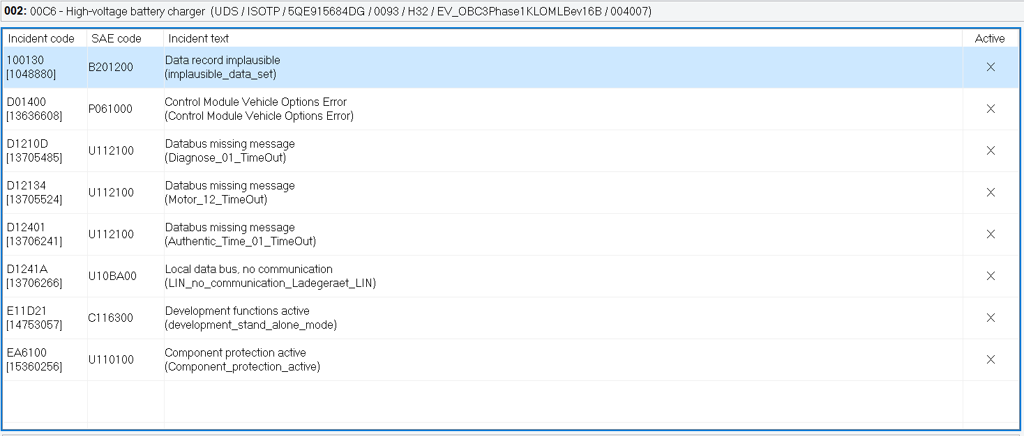

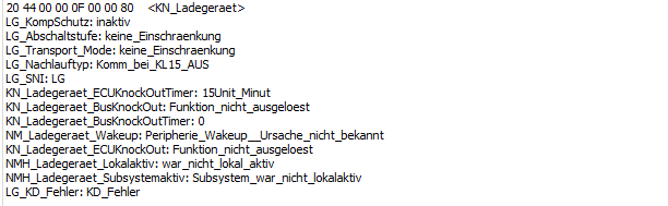

I'm starting to think that Component Protection is tripped and causing a charge reduction.
I should say... I know component protection is tripped :(
Since I get the DTC for it. (U11010)
Although I'm unable to find anything that references a reduction in power output with it active.
I believe you have more faults active as your charger has a later software rev.
I started with 0070, but updated it to 0089 tonight. After which I was greeted with similar faults.
Have you been using the charger much in operation? I'm wondering if I tripped the Component protection by a timeout, or if I sent a misguided command and it wanted to call back to the gateway.
I'm also on a single phase. But I didn't attempt to change the Current from 63A to 32A (like you have set) but unsure if you're getting 11kw from a single phase connection?
Charger starts up with a single phase/module, max of ~8A output, After a few minutes you can hear it load balance over to the 2nd module, whereby each split ~4.1A
Input AC current is ~15.7A @ 244 V
If you do connect up via CAN sometime, it'll be interesting if you have the Component Protection active.
CAN ID: 0x17F00044 - It's the first bit
If it activates - and you see a reduction - It may be game over for this type of charger.
The older units do not seem to have component protection, so there still may be hope for them.

I've been digging deep into this over the last week.
I've upgraded from 0070->0079->0089->0093
No major changes between the various revisions, other than some new faults.
Dala had a log from a Taycan which helped to confirm/eliminate some items.
I've added the logs, converted to Savvycan format. (Note there were no timestamps, so they're just in sequence)
You may find that on newer charger software revisions, the CP and PRX canbus messages contained in LAD_02 are not working, this seems the same as the taycan logs, these worked on charger firmware 0070 (I have logs with it being detected), but after that the signals were likely depreciated?
My faults after the software update did increase, but looking into them, it seems common that the newer revisions have several ghost faults.
Diagnose and Authentic time signals were added, but the 3500w limit remains.

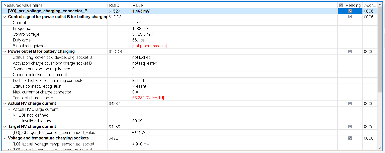

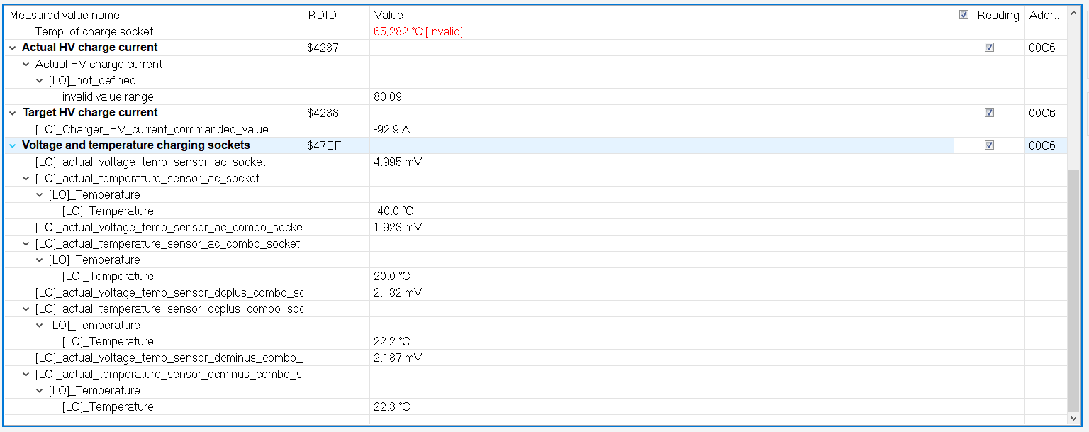

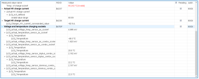

Below are my runtime values,
My charger is a 40A unit, and seems to be correctly detected, yet I still have a 3500w max charge rate.
Target charge current is mis-calculated in ODIS, The base value is -102 Amp, so my value of -92.9 A = 9.1 Amps
From the Log Dala provided, the car was being charged with a 9A plug (and correctly detected as such), and so it's max charge rate was set to 2000w.
I've jumped deep into BAP messages to see if I can somehow find out if it's a global charge restriction/limit.
although I've cleared to the factory charge profiles using the ODIS adaptions.

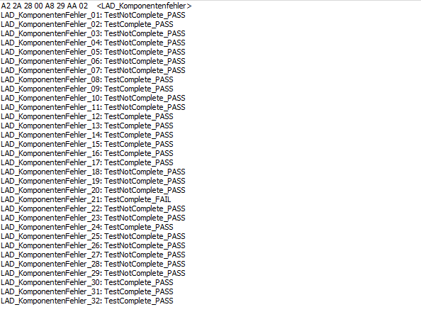

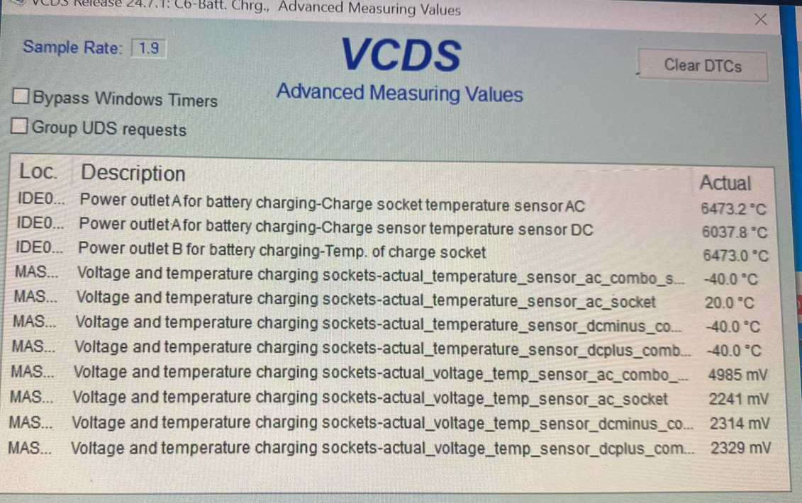

modellfan
Posts: 177
Has thanked: 20 times
Been thanked: 61 times
Re: MLBevo Charger- 11kw & 22kw Info
Post by modellfan »

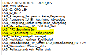

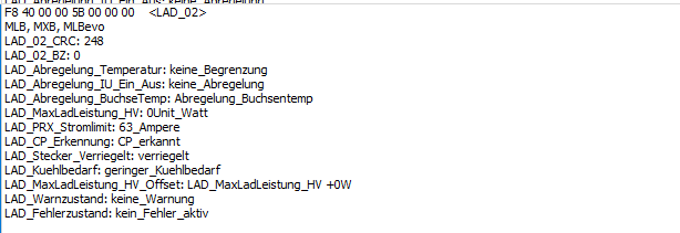

Built in my battery box this weekend and wanted to go for a ride. My ecu didn't let me, because it thought a charge connector is connected even it wasn't.
IN VCDS the value of charge Port A says, that it isn't connected. I am really confused why the live values say something different then the raw can output. Charging is still working. Can you do me a favor and measure the resistance between PP and PE in the charge port? Maybe I got moisture there over the winter. I have 3kohms when the charge port is connected with the charger; no evse connector inserted. After some tinkering :
Now I also get:
Which I definitly didn't have in earlier logs:
My LAD02 is like this, maybe its about the CP:
Do you have any idea what the self test numbers mean? I got a test failed:
charging session.csv
(8.67 MiB) Downloaded 6 times
Mitchy
Posts: 147
Has thanked: 7 times
Been thanked: 91 times
Post by Mitchy »
With the port disconnected from the charger unit, I have the following:
PP-PE Resistance @ 2.7kohm
Open Circuit on CP-PE
(I'll measure it with the charger unit connected in a few hours)
I haven't been able to find anything about the tests, however I have several that are failed. I believe #38.
I've seen more/less trigger pending the valid CAN messages, so some are likely due to the time signal, etc. It's also likely some are related to the 2nd charge port input and most definitely the missing LIN system.
I've decoded about half of the BAP signals, although none give any additional control over the charger.
The only major win is the fact one of the messages show realtime charge output in Watts.
There are still some messages outstanding but none that raise the 3500w limit I'm experiencing.
I see your log has the charge rate at 5A, can you still go above that?
modellfan
Posts: 177
Post by modellfan »
Thank you first of all? Do connector and charge unit connected you have 2,7k ohms? That is awkward. I thought they have a standard 4,7k ohms resistor in VW charge ports . I think it is also in the wiki . Might this be the reason for your limiting? PE CP I should measure .
Can I see your code ? Is it directly branches of mine ? I remember me fixing something in the target current calculation. Maybe this is also the reason for your limit.
I only have a 3,5kw outlet at home . Need to go to a friend to measure more . Will do it soon.
In headless action to debug the charger , is first run it without charge port connection and than also without can connection. Maybe this is how I got the Component Protection stuff going on.

I've ordered another charger.
Figured I'd either prove two units are non-functional, or migrate over and test some theories in getting a charger to work as a slave unit.
This will require Focci or a CP-PP master; but would allow you to gang chargers together for 11, 22, 33 kw... etc.
Will also reduce the canbus message requirement, as the 2nd charger only needs a partial number of Can messages; and acts like 3 separate current sources.
I've tested your codebase, along with my original teensy code; and the 3500w limit remains.
I did clear the adaptions within ODIS back when bench testing, so I'm wondering if that may have wiped out some base config.
If I do get the 2nd charger and it's fully functional, I'll be willing to try some more risky stuff with the 3500w unit.
I can source an adaption file online and load it for a test.
If all this fails, I'll hop onto the MG bandwagon. I'm UK bound for a week in April, so I'll try my best to source a unit while over there.
Mitchy
Posts: 147
Post by Mitchy »
Some positive news!
With a 'New' charger, using my existing codebase, I've been able to achieve ~40A from the EVSE.
The new wattage limit is 8900w (40A @ ~240vAC)
Component protection is showing normal (not triggered... Yet anyway...)
Details of the new charger are:
HW: H35
SW: 0088
ODX: 4007
Part#: 5QE915684CM

The wrongly detected charge plug solved itself away without doing anything. This limiting me to 3,6kw stay:
I get very weird temperature reading:
Any ideas?
