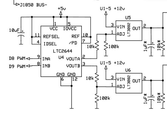

One of the things I will need to do with my hybrid is generate pedal position sensor values to feed to the stock ECU controlling the engine. I mean, in theory I could do a lot of work to take a torque input from CAN and write code for the Motorola CPU32, but then I'm not sure if my modified code will pass Oregon emissions (ie do they check the calibration verification number, which will change...)..so in theory a significantly easier job will sending out a modified pedal position signal to deal with the desired torque split between engine and electric.
I the GS450h board is Arduino Due based, which I think can do D/A conversion on two of the pins, however, I'll probably be driving this from something else. I've realized the inverter is probably going to live in the trunk as there's not exactly a lot of room in the engine bay with the engine still there... So I definitely would not want to drive such critical signals from the engine bay to the rear and then back again. This also means I may have to make custom HV phase cables.
In any case, what's the simplest way to accurately generate a 0-5V signal based upon a PWM to ground (ie low-side drive) output?

What about a LTC 2644, have used that many times where PWM filtering is not adequate.

I saw similar items on Amazon, my concern was quality due to the nature of emulating a throttle pedal I wanted as accurate as possible. I was actually looking at the LTC2644 - they have a LTC2645 demo board which is $75 unfortunately, and requires me to figure out how to get a 5V reference signal to it. Apparently the demo setup only does 0-2.5V output.
Also, wow that's crazy markup - the price of the device is $7 on digi-key. I guess I may end up designing a PCB for this (and probably something to handle cruise control as well). The non-CAN cruise control BMWs use a simple protocol that goes back to the 80s...but it's a pain to work with lol.

Why not just low pass filter your PWM? It's no exactly fast but a throttle signal isn't "fast" in computers terms anyway. So PWM 10kHz -> filter with 20-50Hz cutoff frequency (say, 10k, 1µ) will get you near perfect analog voltage

Hmm. Actually, yeah, I can do up to a 20kHz signal...which if the ripple is small enough that should be fine? Simpler is better, that's for certain, but I also want accurate is the issue.
Reading https://www.allaboutcircuits.com/techni ... g-voltage/ now
Oh boy.
Need to get some random caps like I have of resistors to give that a quick try. The other piece is my PWM is to ground, so I need a pull-up to 5V on it. How do you size that resistor? It's also going to be about response time again, right?

Am I missing something? The obvious solution is to leave the pedal connected to the stock ECU as normal, and take your readings from it, either directly (spliced in) or over CAN.
It sounds like your plan is to disconnect the pedal from the ECU, run it to your controller, then create a pseudo-output for the ECU. Is this because you want to be able to use the pedal, but have your controller decide if/when to throttle the engine? If so then I'd just use a filter as discussed above. I'd agree with the choice of a discreet controller.

I'm trying to manage the torque split between electric and gas, so yes, I'm trying to feed it alternate values.

Sorry, I meant a separate unit just to handle this, rather than sending analog signals through the car and back.
Either a microcontroller, or just some ADCs and DACS mounted in an enclosure, communicating with your microcontroller in the trunk over whatever protocol you choose. I2C wouldn't be suitable for this, but SPI should.
