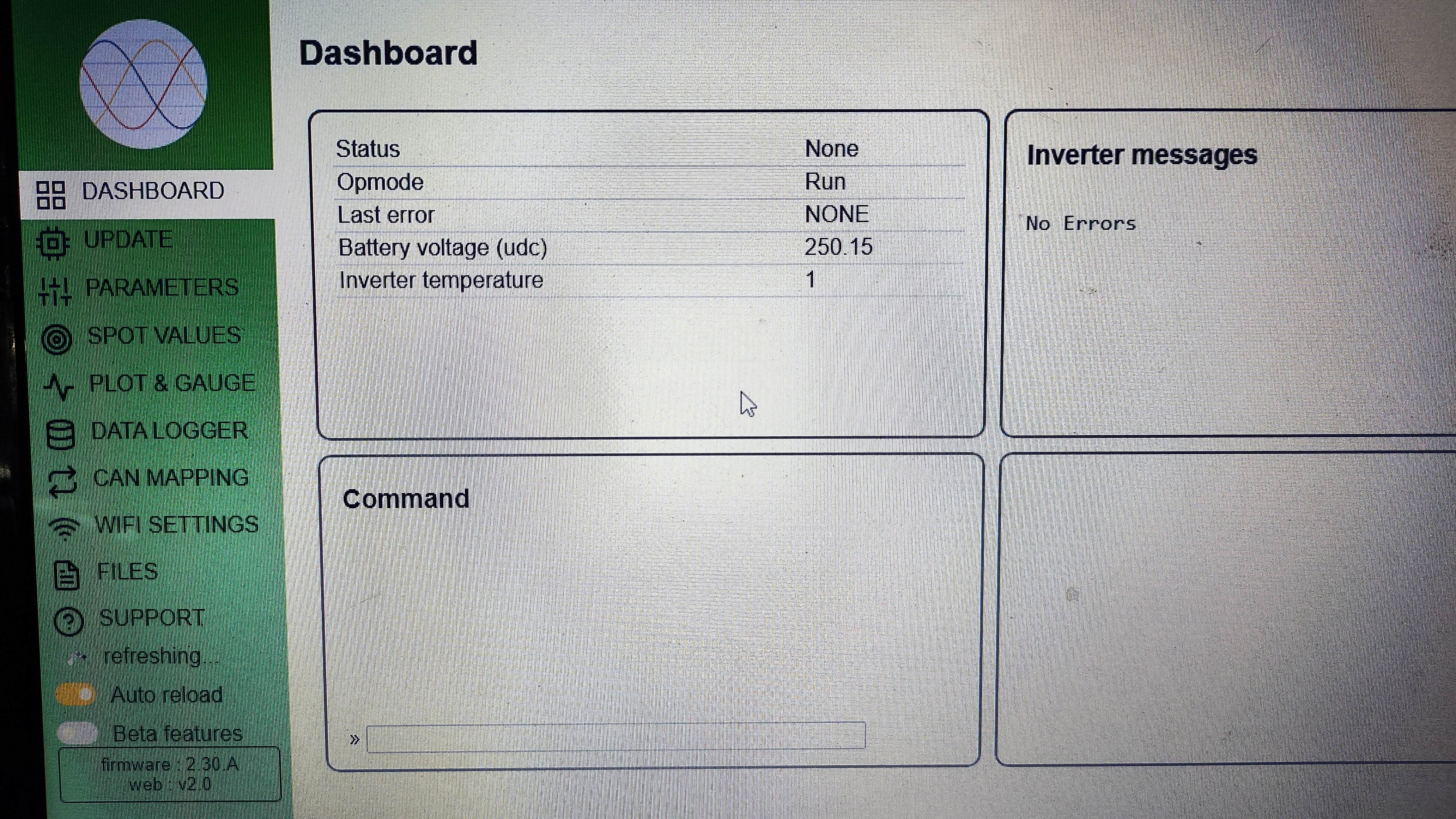

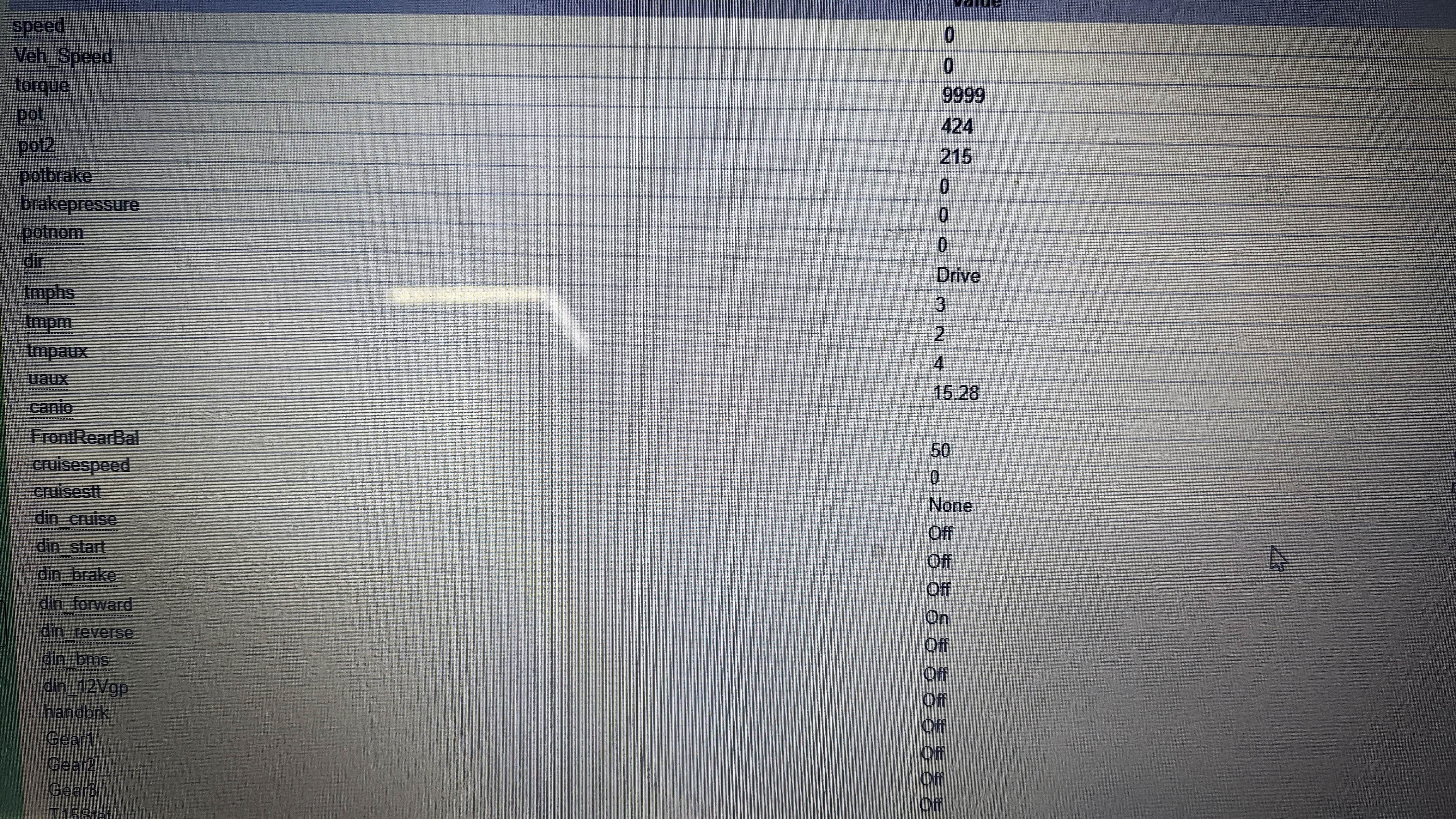

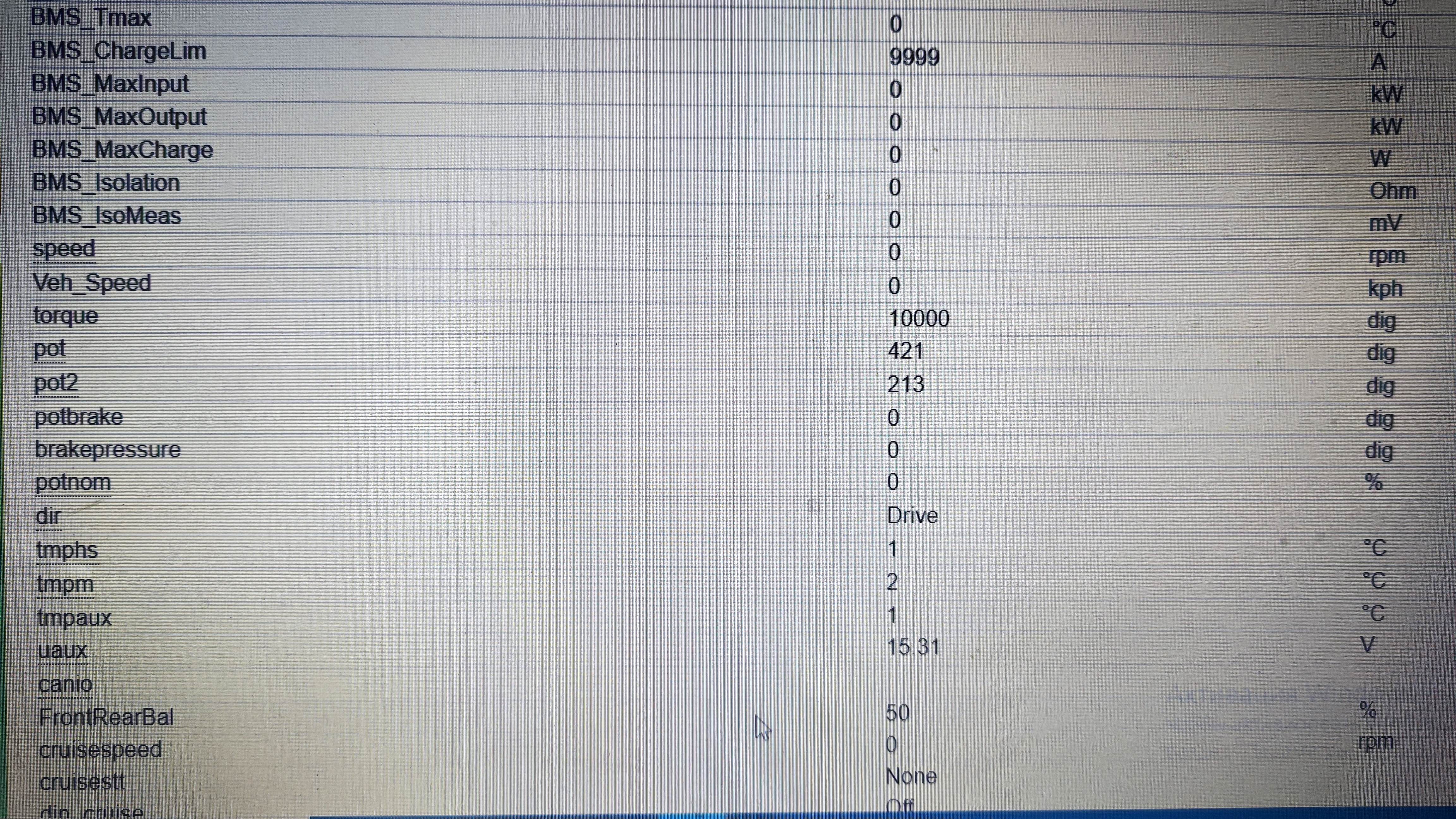

Hello,
I need help getting my Outlander Rear Inverter running under zombieverter.
I couldn't get it running on version 2.22a, so I updated zombieverter to version 2.30a, which didn't work.
Connecting a different inverter also didn't work.
Parameters INVudc, tmphs, tmppm the receive stably from inverter.
The resistance between CAN H and CAN L is 59 ohms. The resistance on the ISA and zombieverter is 120 ohms.
I probably missed something important.
I can't figure out how to attach a file.
P.S. I apologize for any inaccuracies; I'm communicating via Google Translate.

Hello and welcome.
You will have to add more context. Pictures, parameter file all that helps that we see the same as you
Hello there. You managed to get into RUN mode, so your IVT Please clarify. Is this the resistance when there is 12v applied to the system (I/e it is on) or when it is disconnected (I/e it is off)?
Resistance test for CANBUS only works when there is no power. If, with power off, resistance is 120ohm, you only have one working resistor. If it's 60ohm, you have two resistors (good). 40ohm means too many resistors (3). 0ohm means there is a short on the line.
Perhaps you have not set up your CAN network correctly? The two resistors need to be at the ends of the main line. This can be quite long. Any offshoots from the main line should be less than 30cm ideally.
My test set up (Zombie, Outlander RDU, IVT) runs fine on 2.30.
When I was setting up my test circuit, I also had an issue where the IVT shunt worked well enough to send the Zombie data to allow recharge to successfully complete and enter RUN mode, but the Outlander inverter didn't work. In that instance, I was actually missing a terminating resistor (I thought the Zombie had one but it did not). Adding the resistor fixed it.

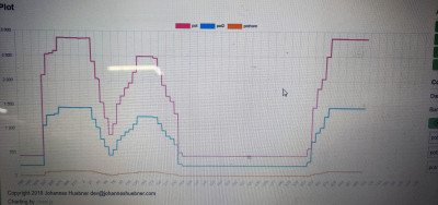

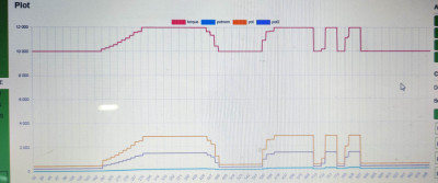

Re: Zombieverter VCU <> Outlander RWD <> ISA IVT-S

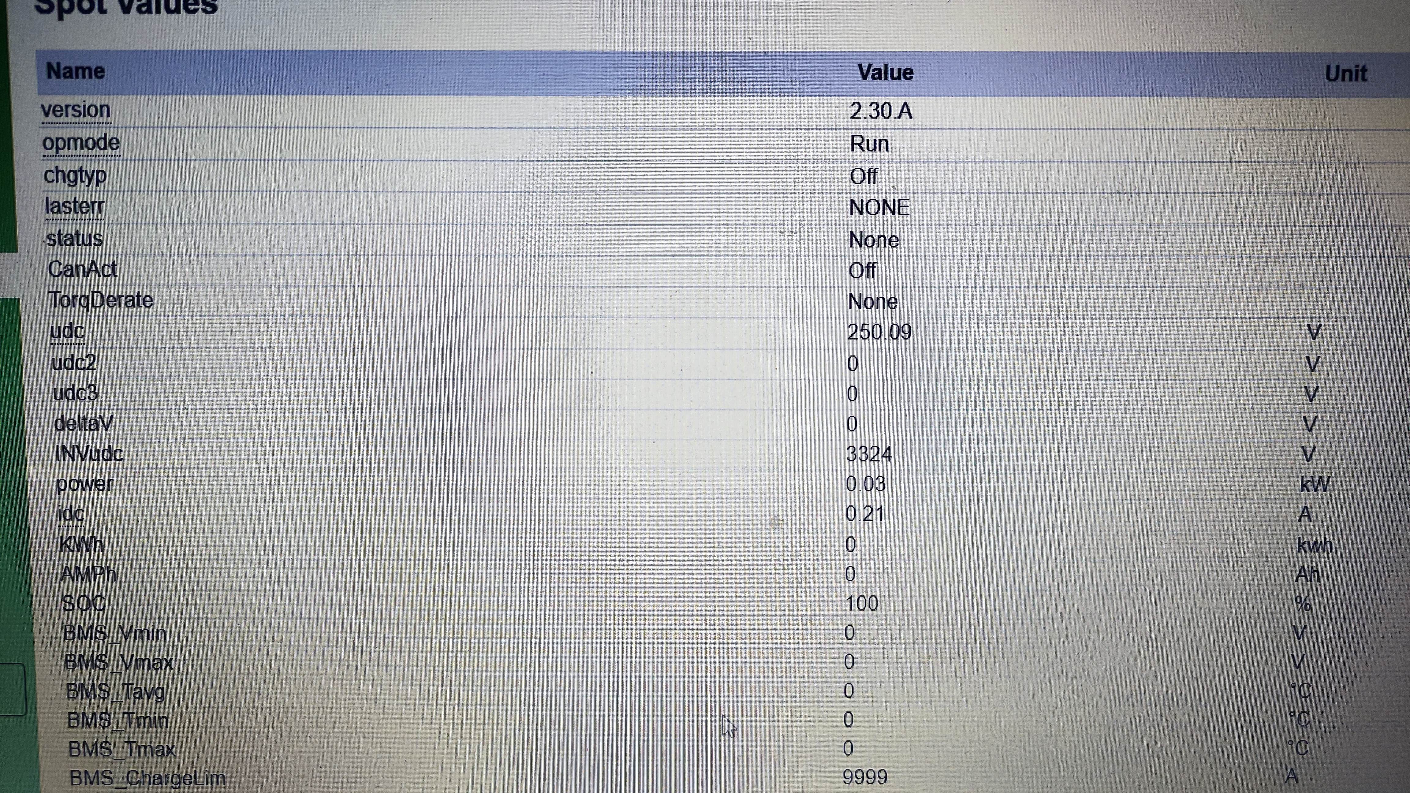

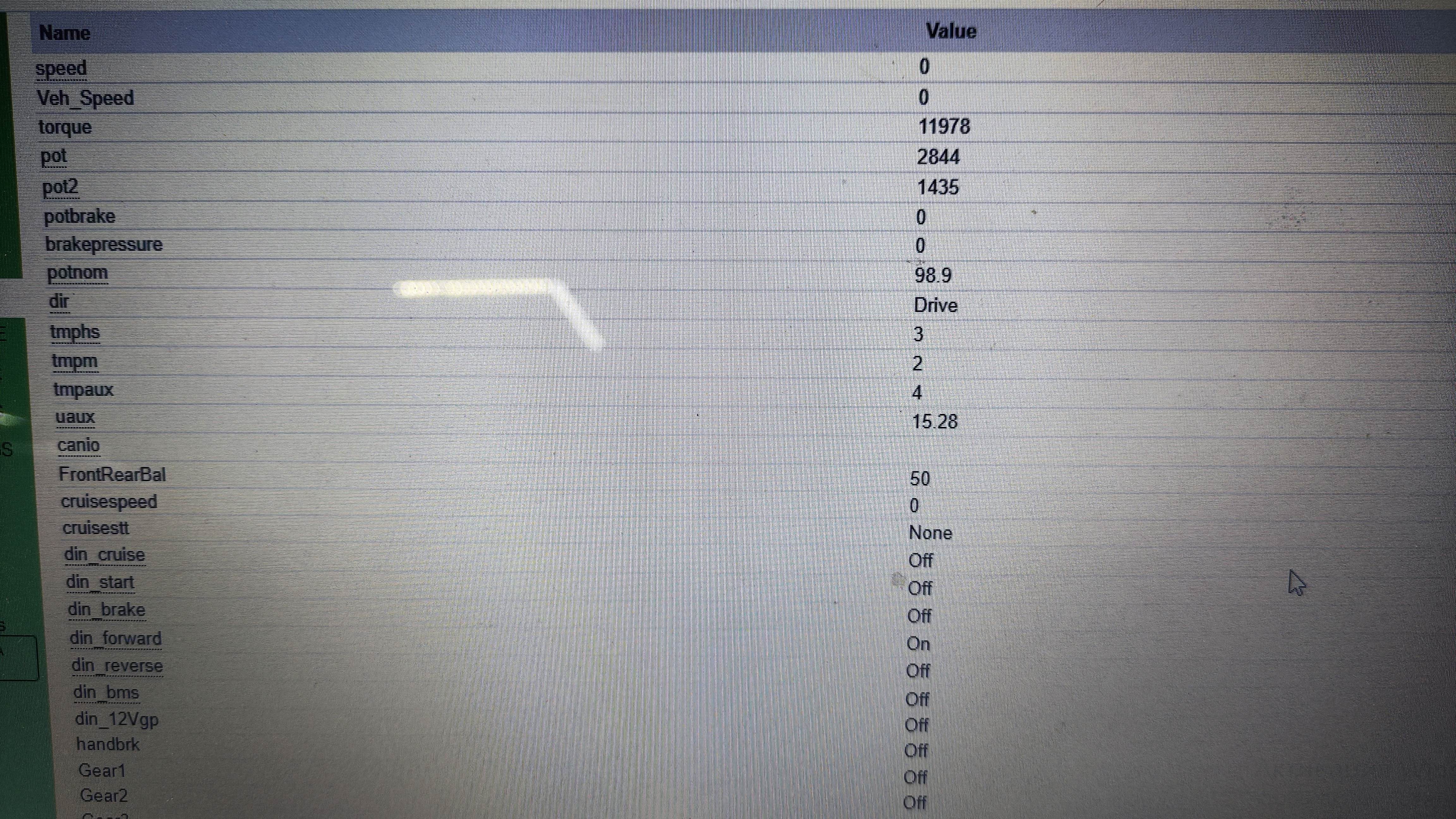

Good, and pictures shows also udc and power values so CANbus should be fine to both inverter and shunt.

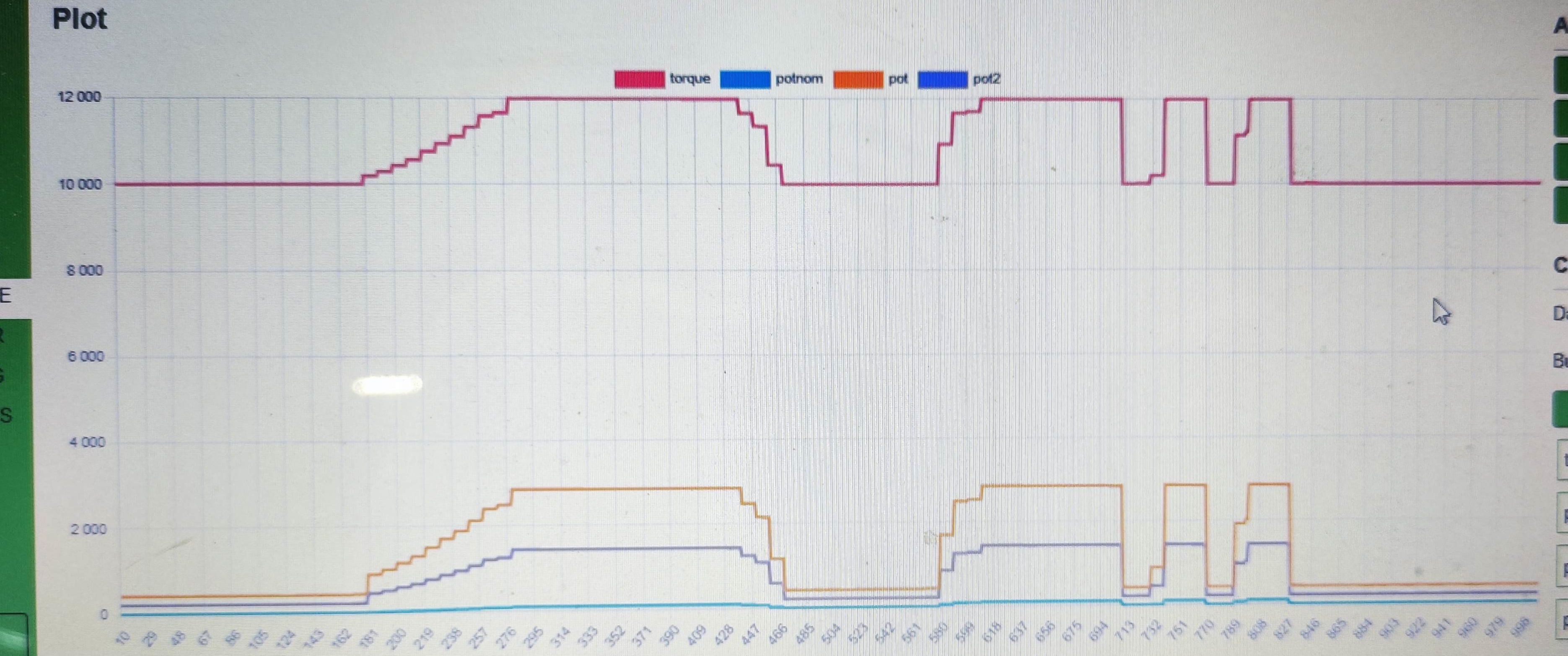

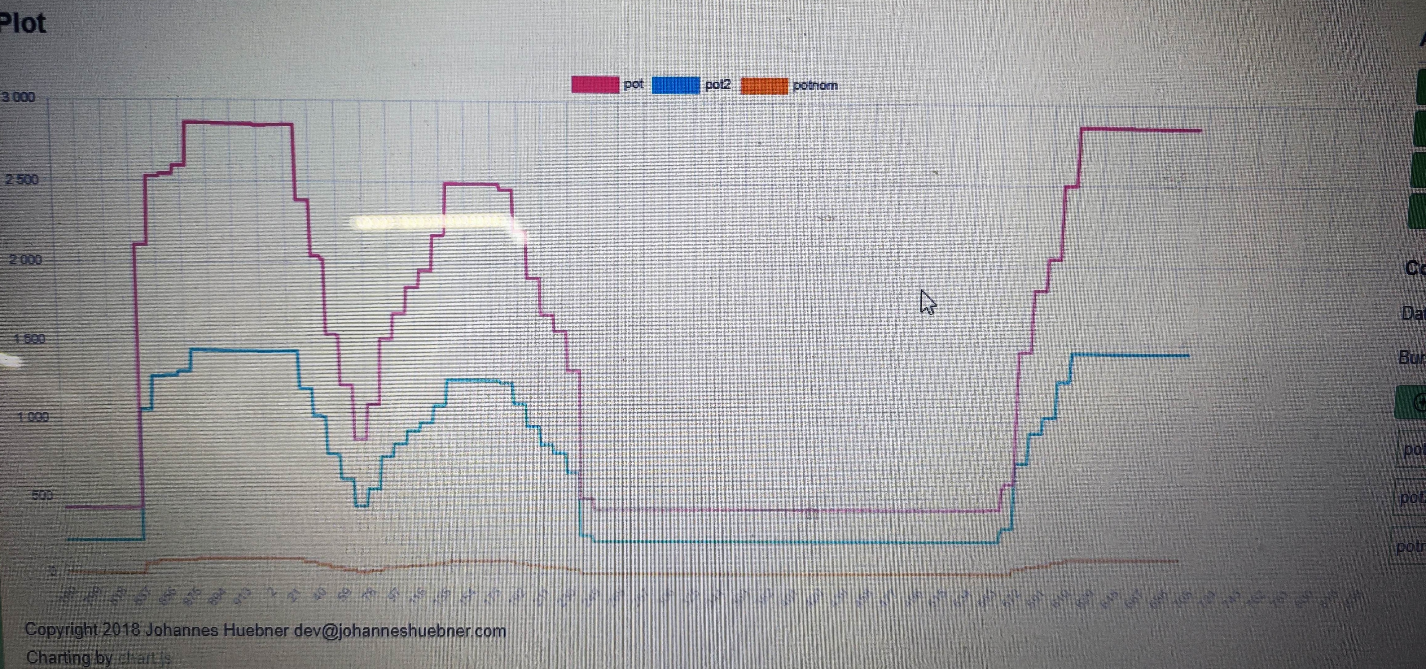

When you press throttle, pot and pot2 are getting higher, right? And how about potnom and torque, does those change value too?
recorded a graph of parameters potnom, pot, pot2evMacGyver wrote: ↑Mon Feb 23, 2026 10:36 am When you press throttle, pot and pot2 are getting higher, right? And how about potnom and torque, does those change value too?
All of these look good to us.
Please show your wiring of the inverter to motor and the HV wiring.
Thank you. I started drawing a connection diagram and checking the necessary signals on the inverter contacts. It turned out that I had mistakenly connected the +12 volts to the RSDN.
Now everything is fine, the motor started to rotate.
