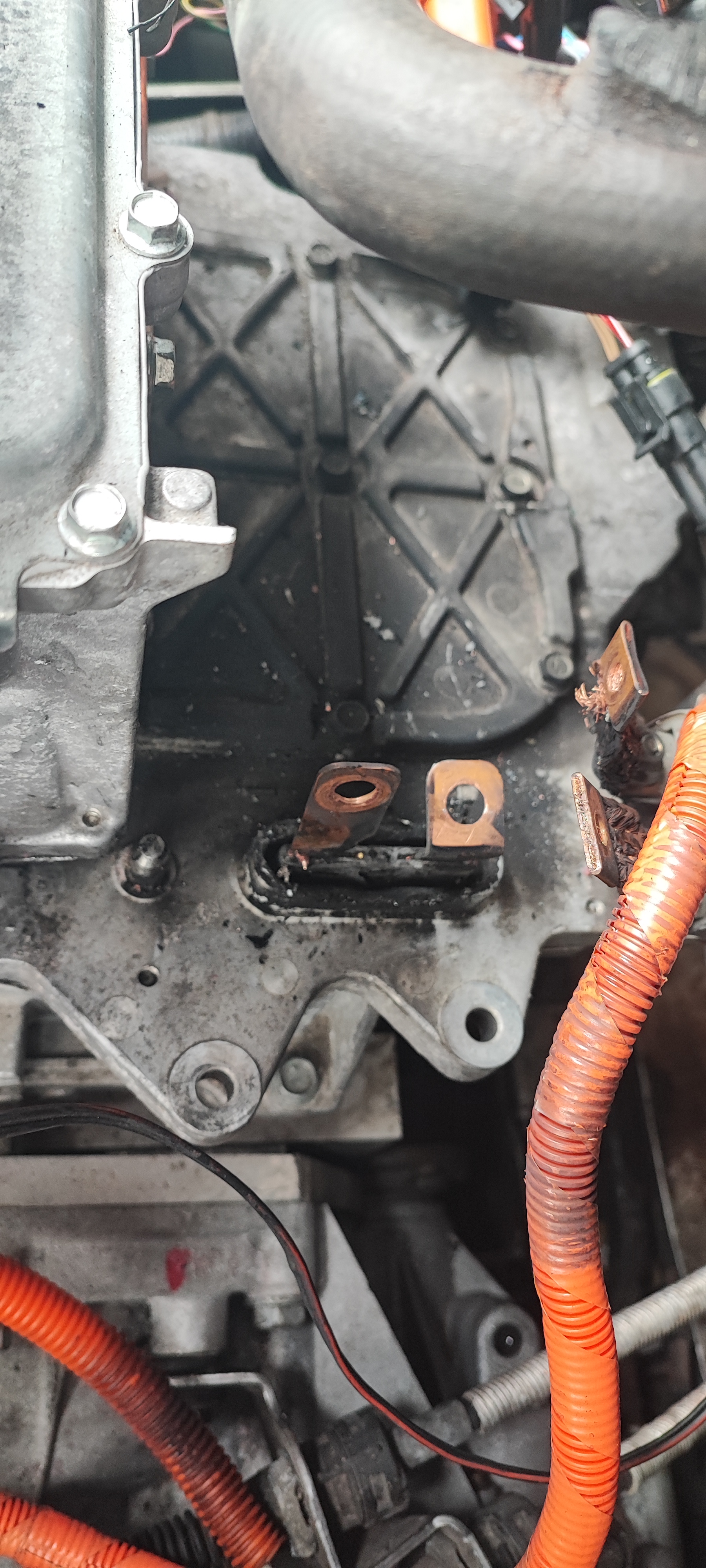

Was going to install a header tank for the heating loop today. When starting up the car to get the pump going an explosion came from the front:

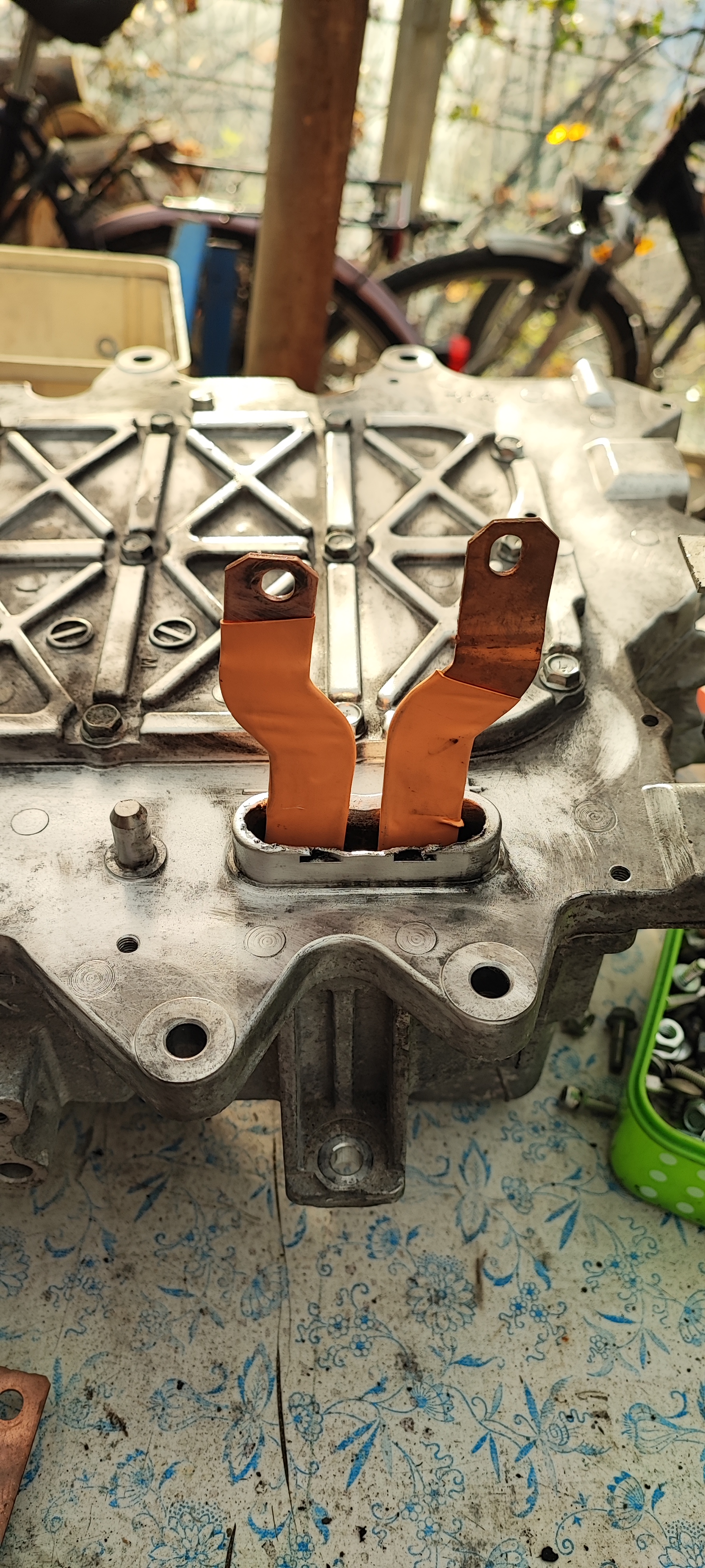

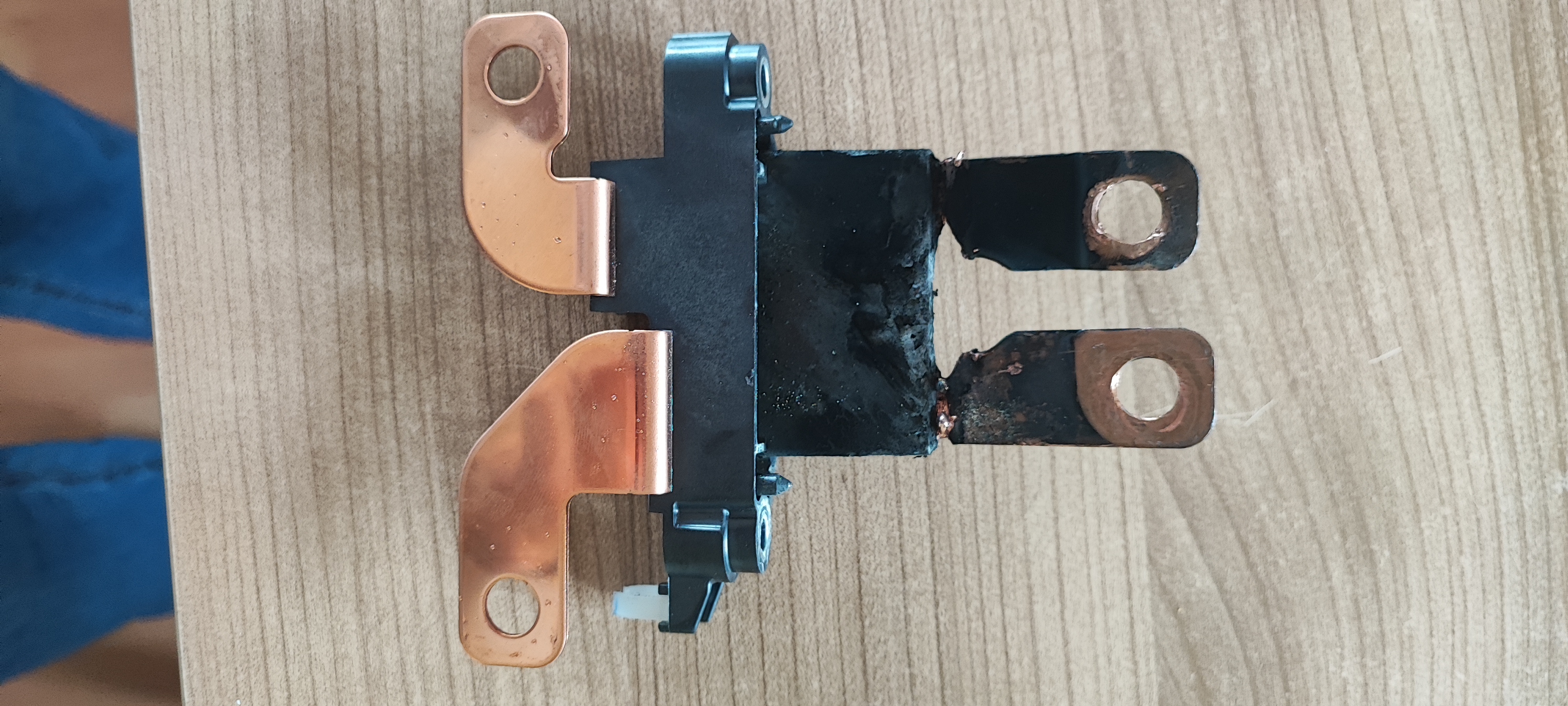

I think too much coolant got into this over the whole installation process. It was still showing 0 Ohms after the explosion. First I thought the inverter was toast but after taking it off
Inverter measured fine and still low resistance on the bus bar assembly.
Damage: most probably 350A fuse, contactors and precharge resistor. Maybe some wiring into the battery pack. Whichever was weakest. Will definitely have to get under the car as well.

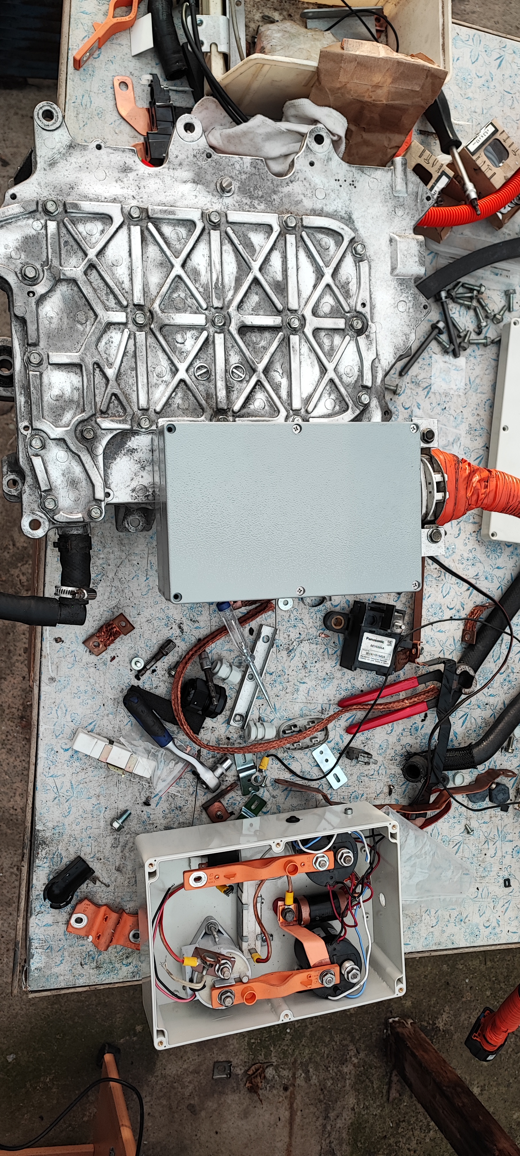

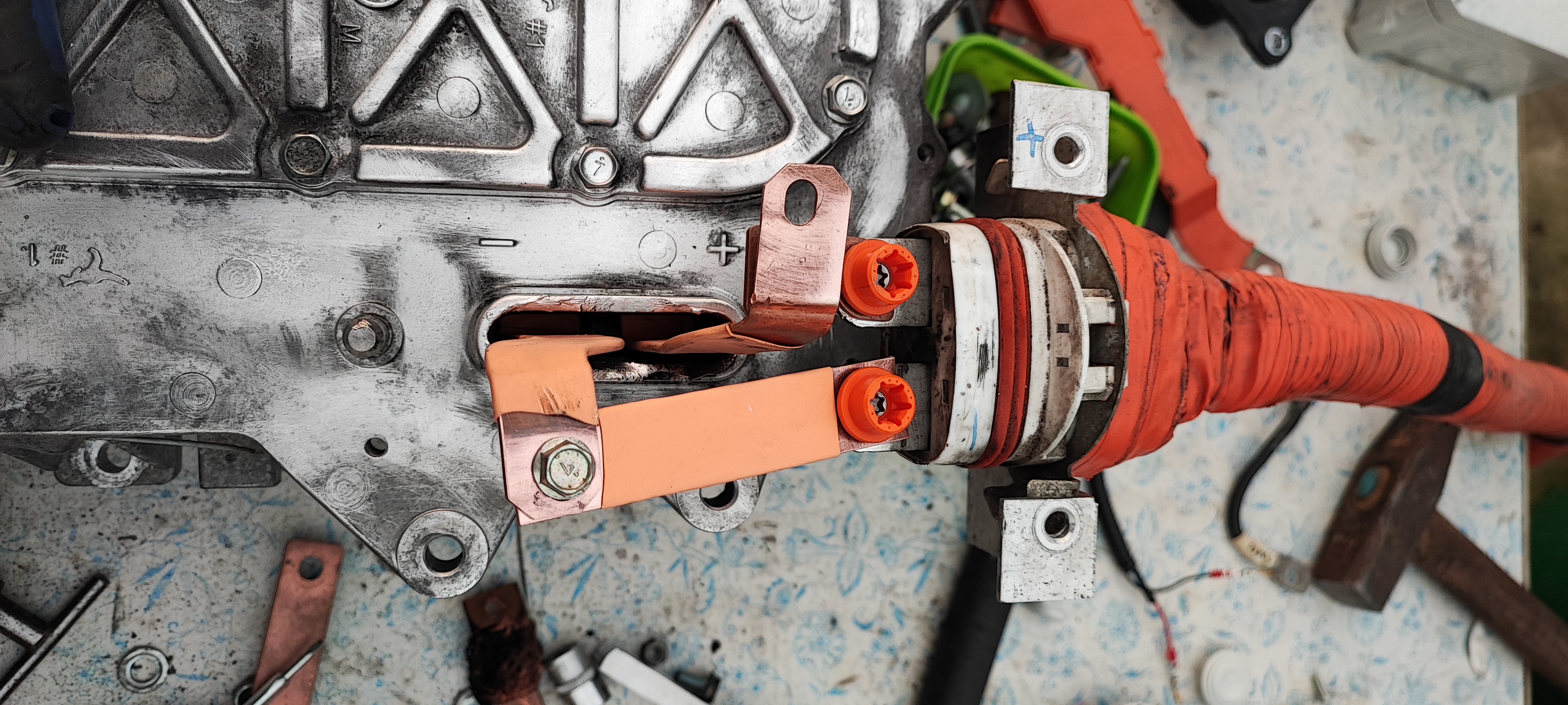

Decided that since the car is now taken apart I should use the chance to improve it.
First up would be the contactor block which was sort of unprotected in the exhaust tunnel. Will now put it into various boxes, still to be decided what goes where.

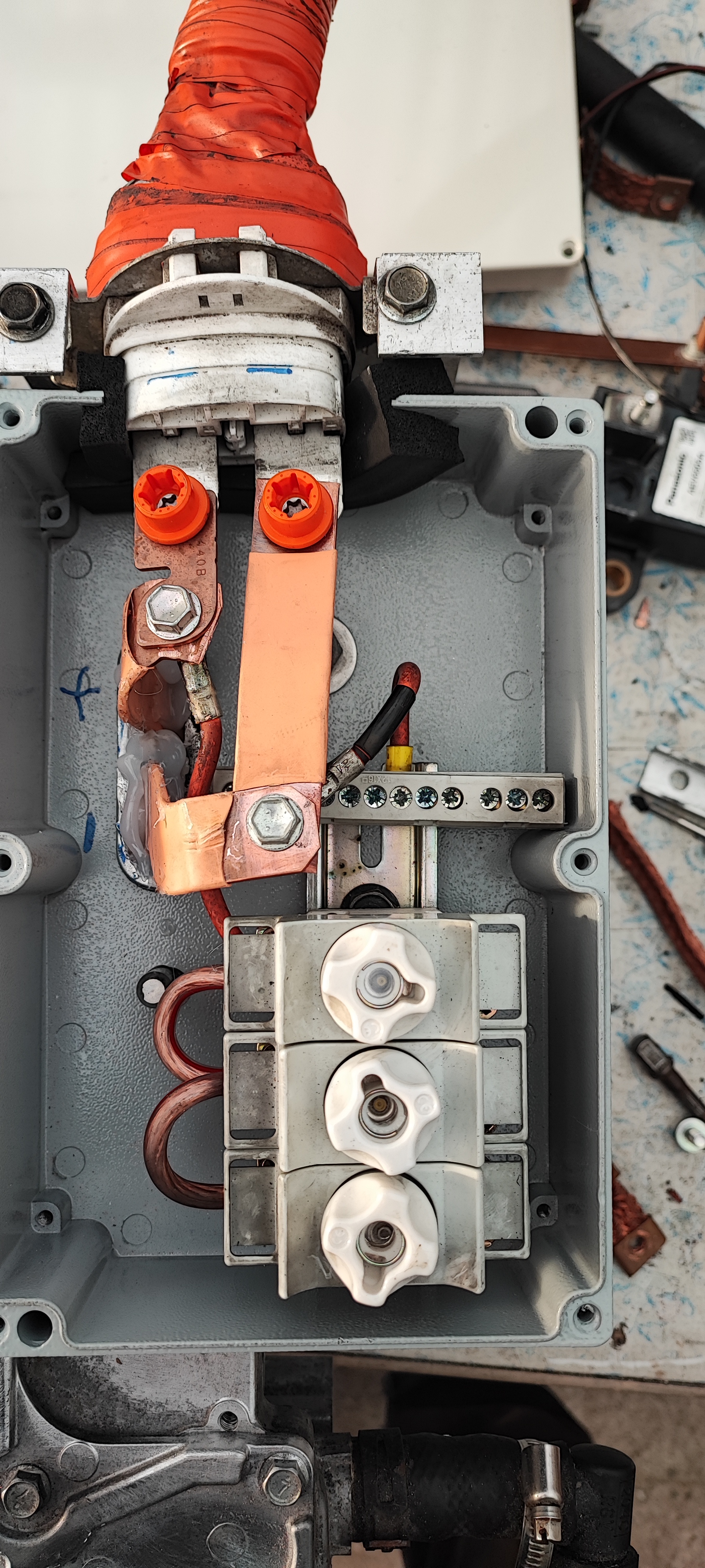

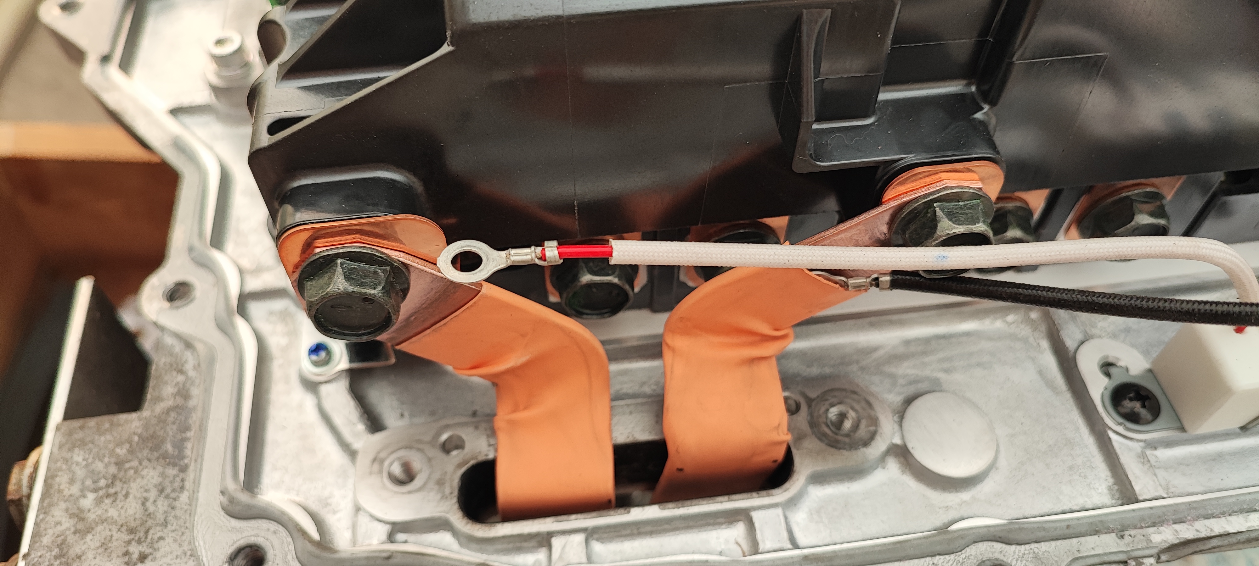

Then I thought it might be a good idea to try and replace the failed bus bars with something homebrew:
I ordered a 220x130x100mm box that fix next to the water cooling place and that I can seal off on the bottom. Will drench the hole where the bus bars protude with hot glue or silicone or something.
Then I don't need to wait for the replacement inverter and don't need to take it apart and can maybe sell it later on.
Been thanked: 1913 times
Re: [DRIVING] VW Touran powered by Nissan Leaf
More box work.

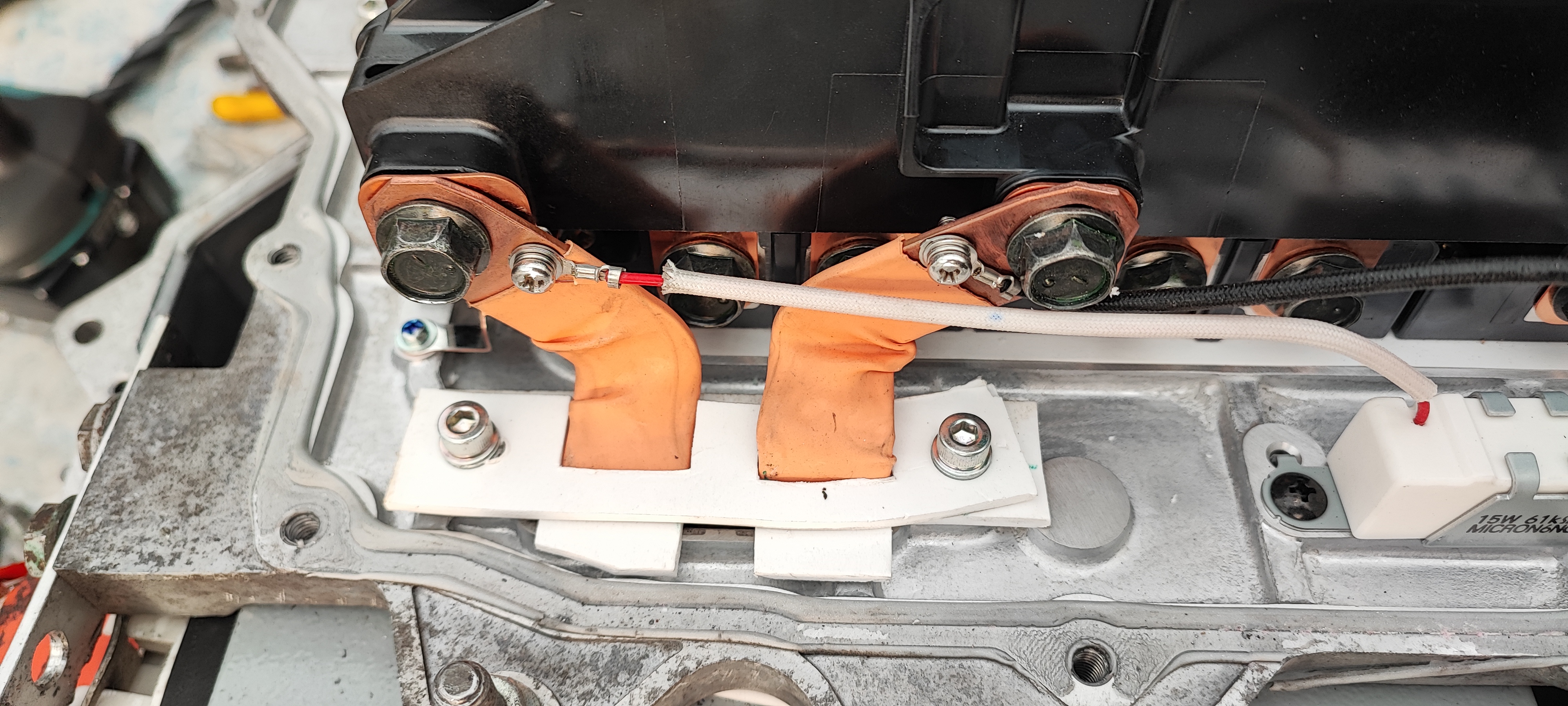

Added a plastic bracket to hold the bus bars
Test fitted fuses for heater and charger and one spare. Not sure if solid bus bars are the way to go since the cable will vibrate and move on load changes. Thinking about putting a 3D-printed part to better seal cable entry
The lid fits solidly and gives the cable bracket a little squeeze.

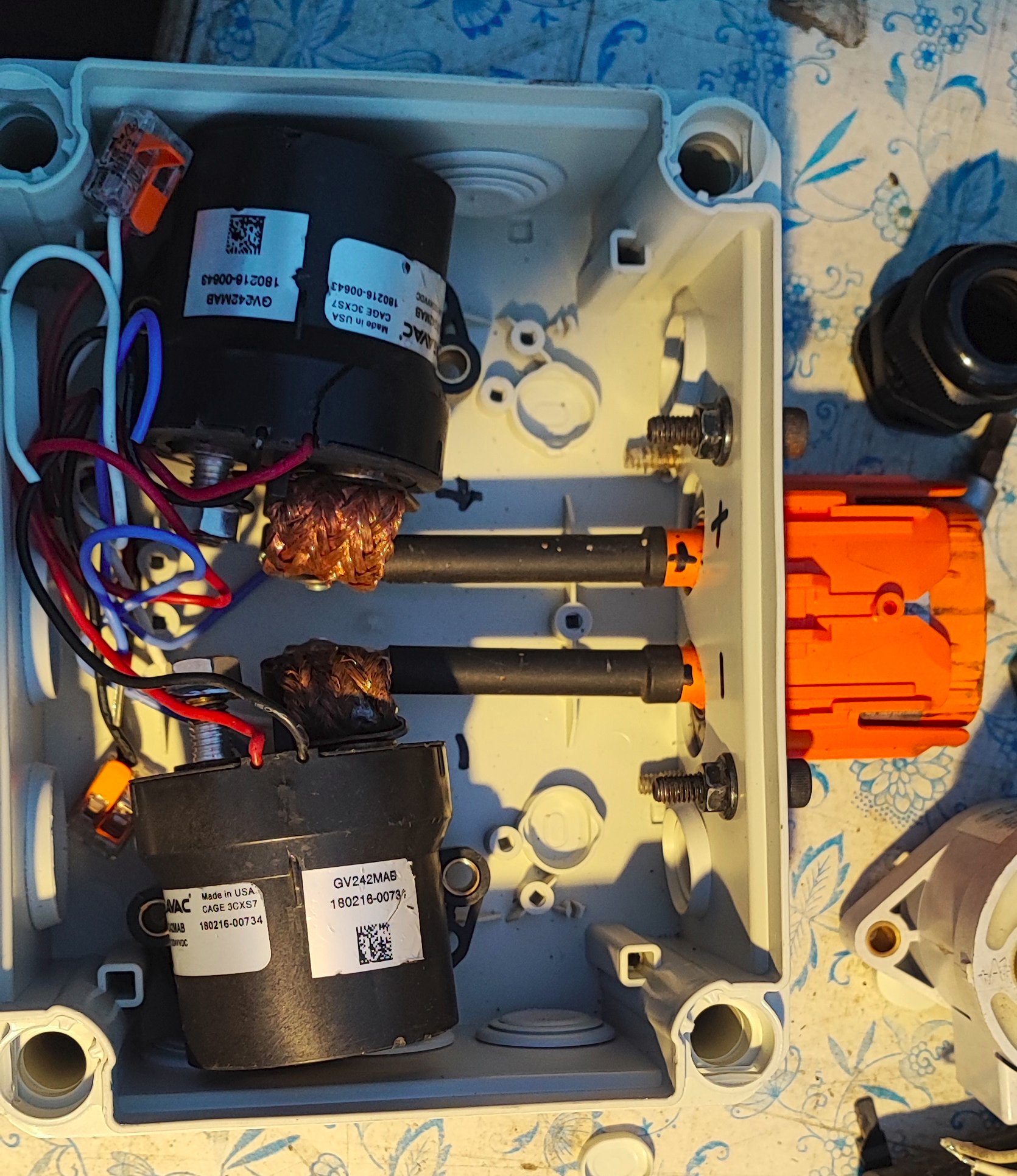

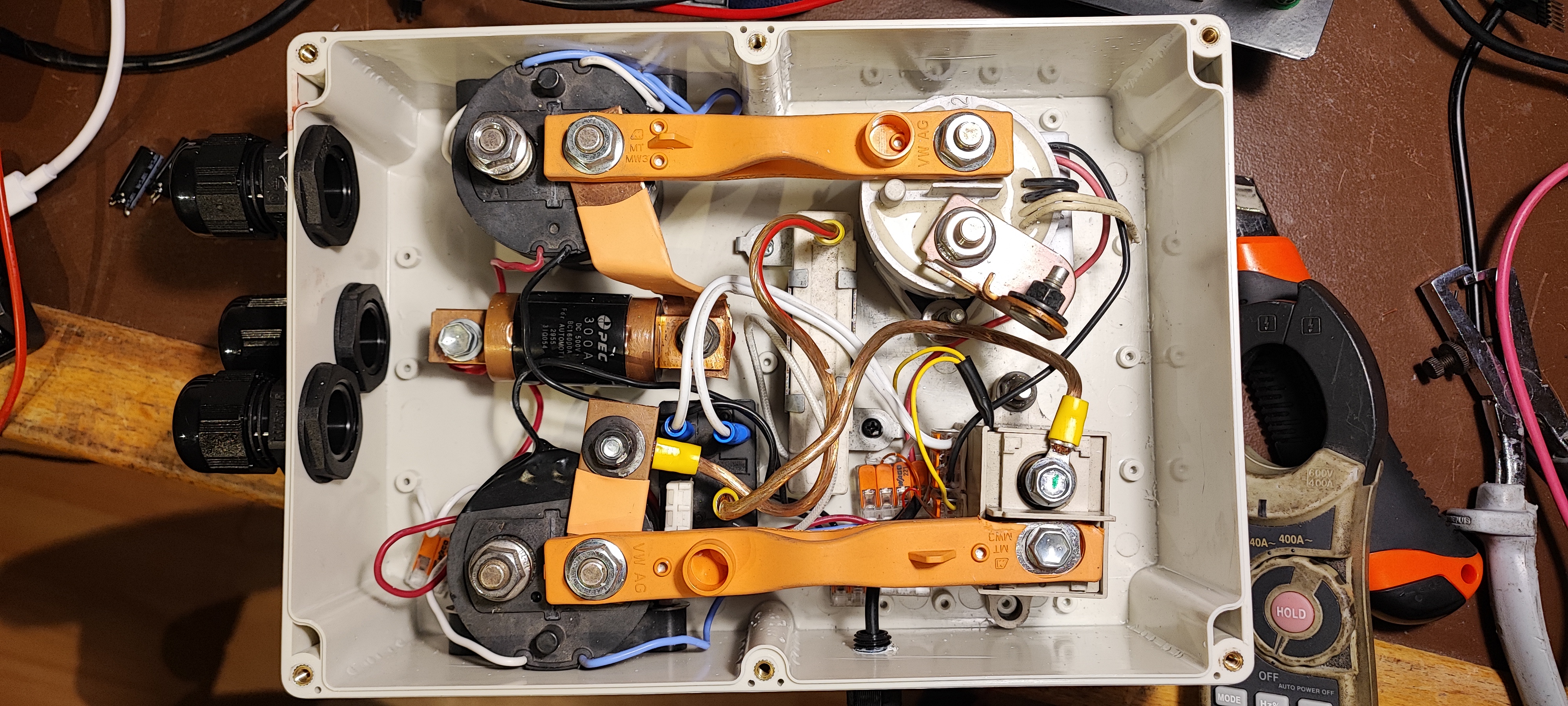

And contactor box pretty much done
Fuse is on the negative side, precharge on the positive.
I did some experiments with the economized EV200 and it does not play well with the ULN2003 in my VCU. It needs 2A to pull in and the ULN can't provide that. So the economizer stays full on and would fry the ULN in a matter of seconds.
So I opted for the left over Leaf Chademo relay for positive. It has the same rating as the former AEV6505 and takes 700 mA@14V. I might add my resistor/capacitor economizer to play it safe. The AEV only pulled 400 mA.

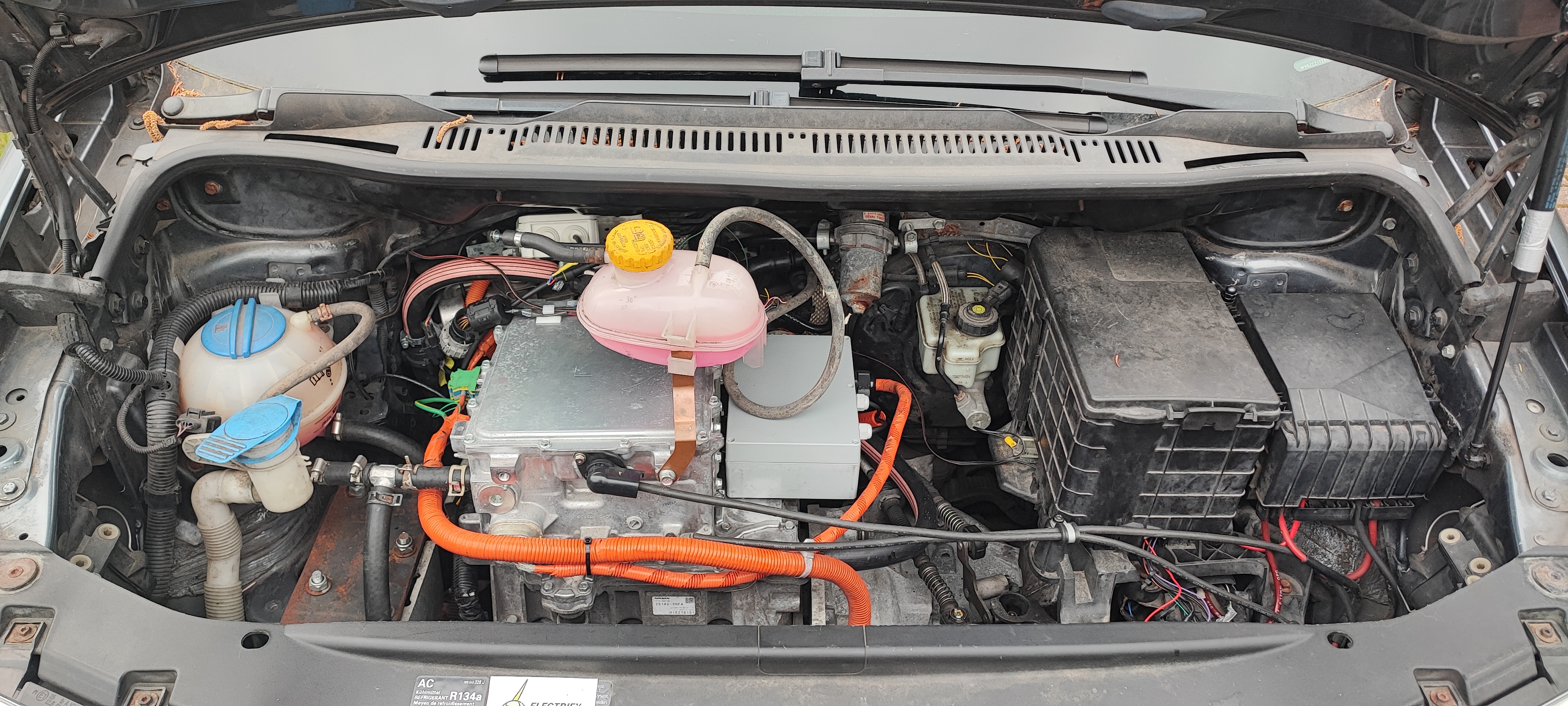

And it's all back together:
Looks cleaner without the blue inverter. Or at least looked cleaner before I installed the header tank for cabin heat with a not very stiff copper bus bar ;)
No change ever comes without issues: the economized EV200 contactor wants a healthy starting voltage and when the NMC "starter" battery is discharged to 3.7V per cell it no longer pulls in. So I consider installing a small booster converter to keep it happy.
I found I'd always had the same problem with the GigaVac contactors for CCS. CCS runs with the rest of the car off, most of all the DC/DC converter. So when the starter pack is low, those make noises but also don't pull in.
Was delighted how well the coolant loops de-aired themselves. The drivetrain one just by letting it sit for 1 day.
