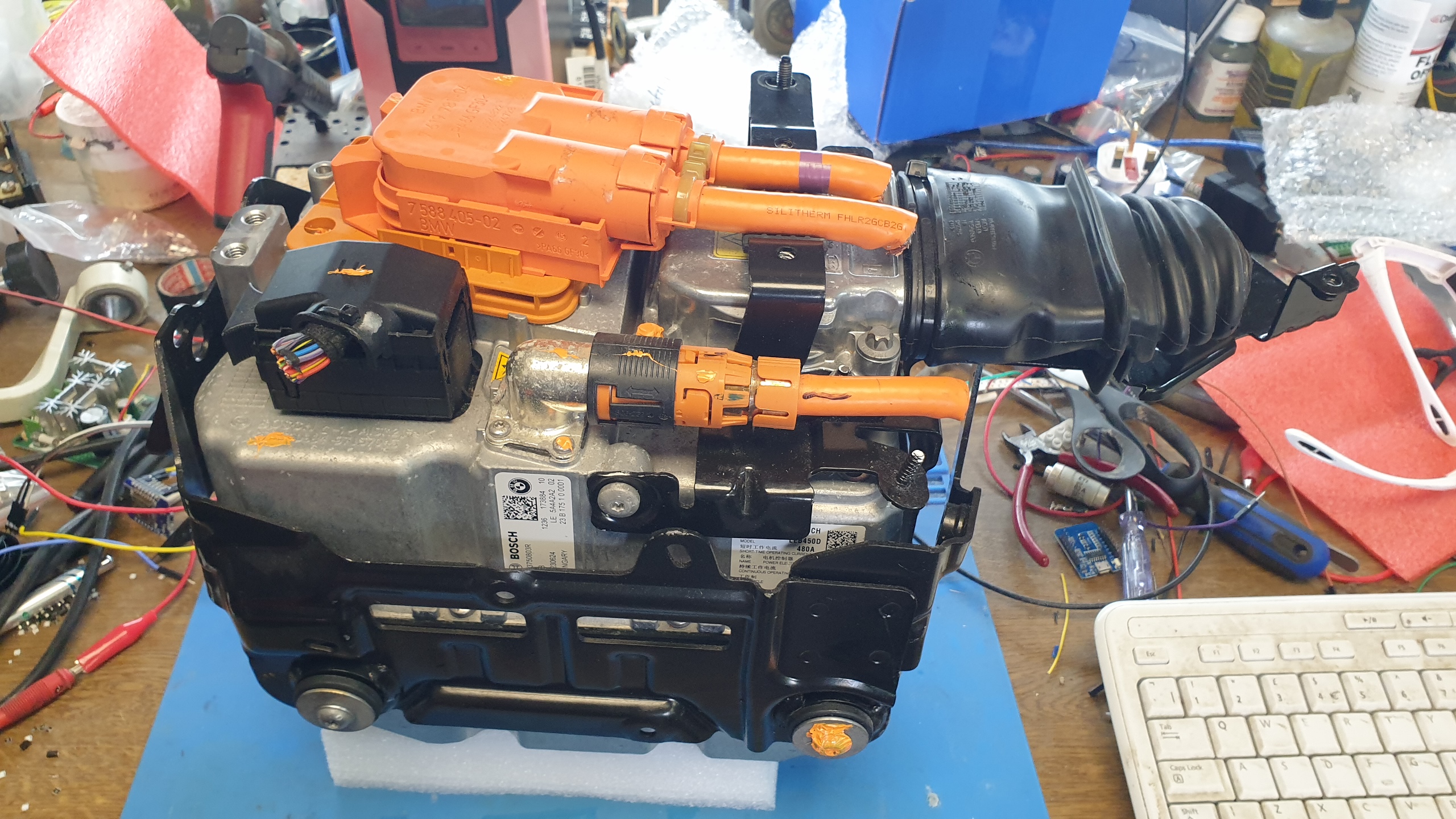

Back at this after a while. Sorry for the absence folks. Life and other things. Anyway, finally got my hands on the matching inverter at a reasonable price with the bonus of having the plugs still attached. This inverter will get an OI board. Also has a dcdc built in.

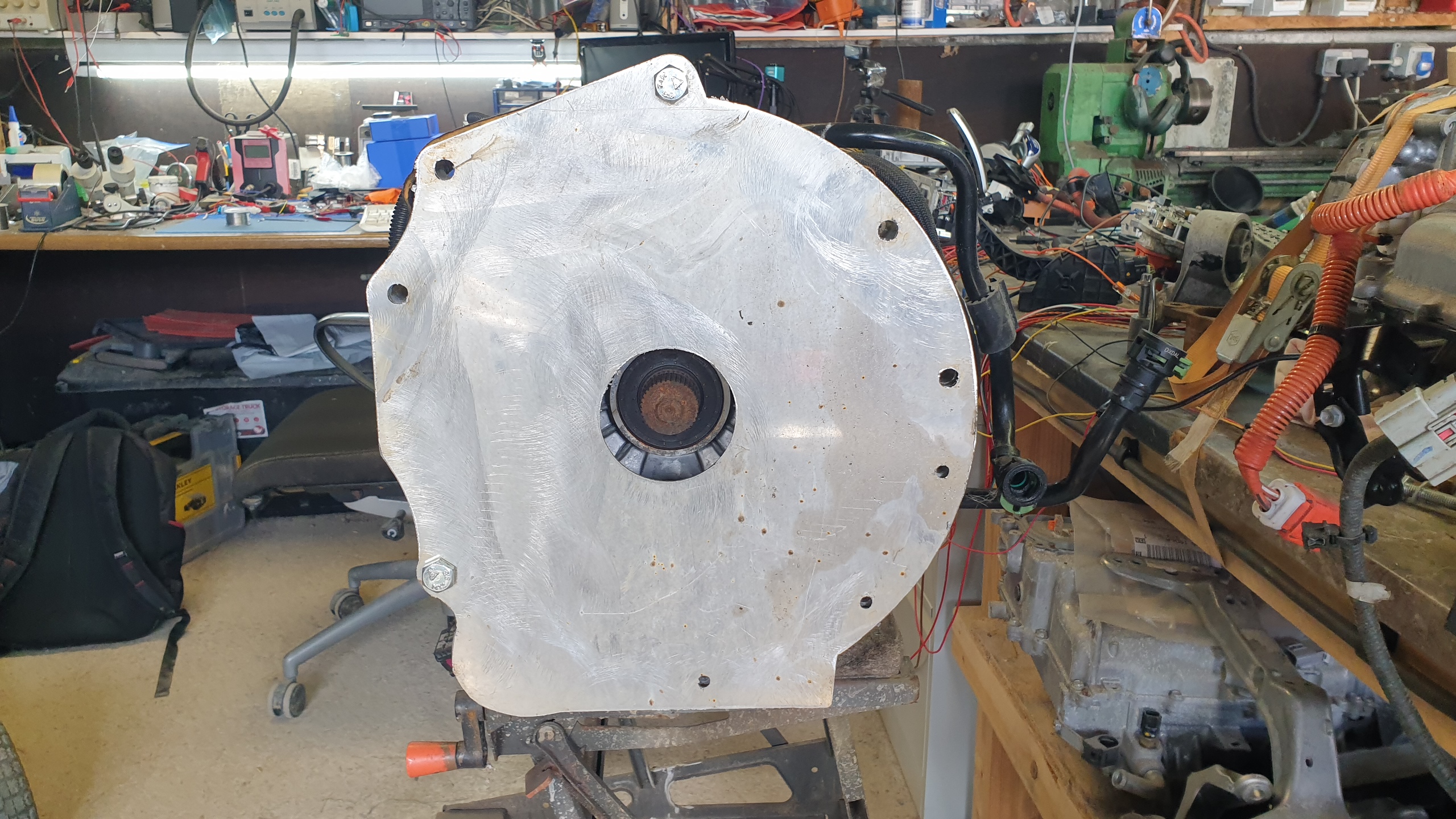

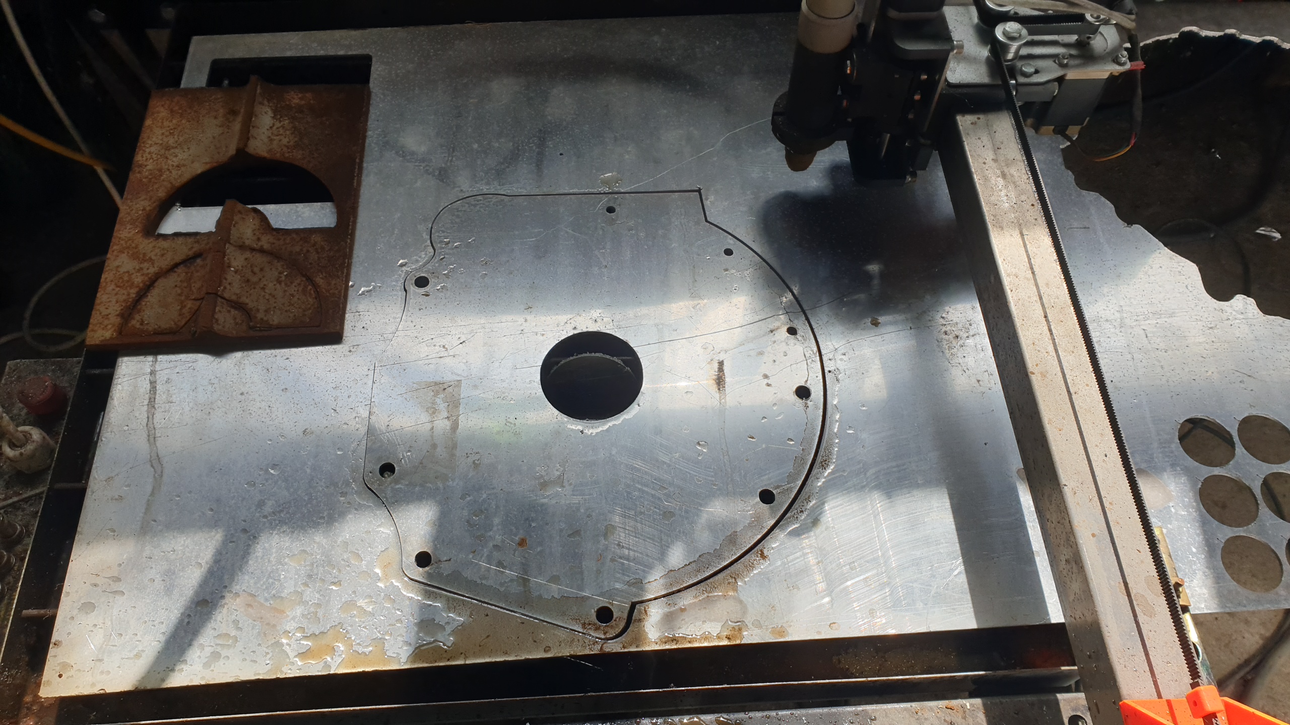

Also did a 3d scan of the bellhousing and cut out a basic adapter plate.

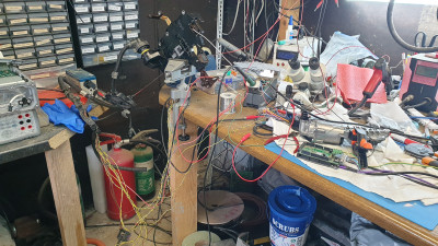

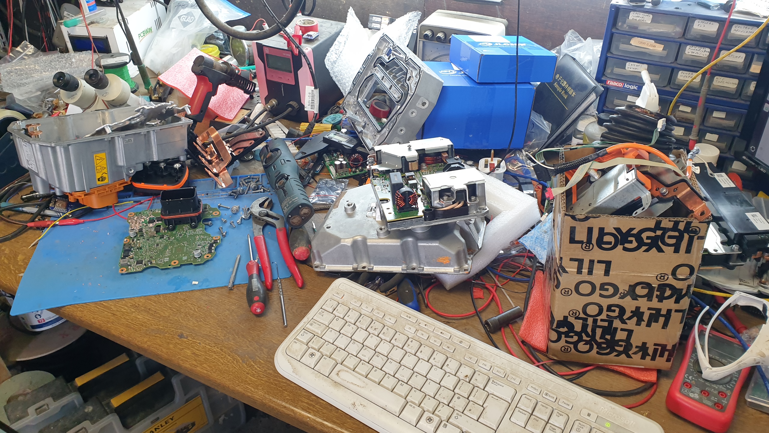

Messy work bench today

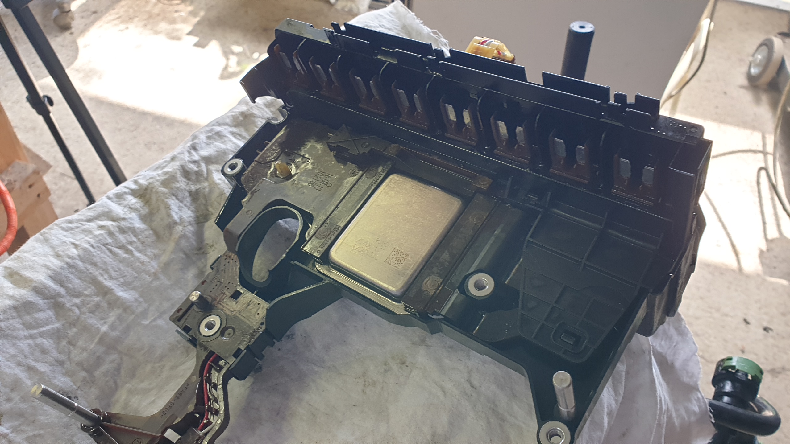

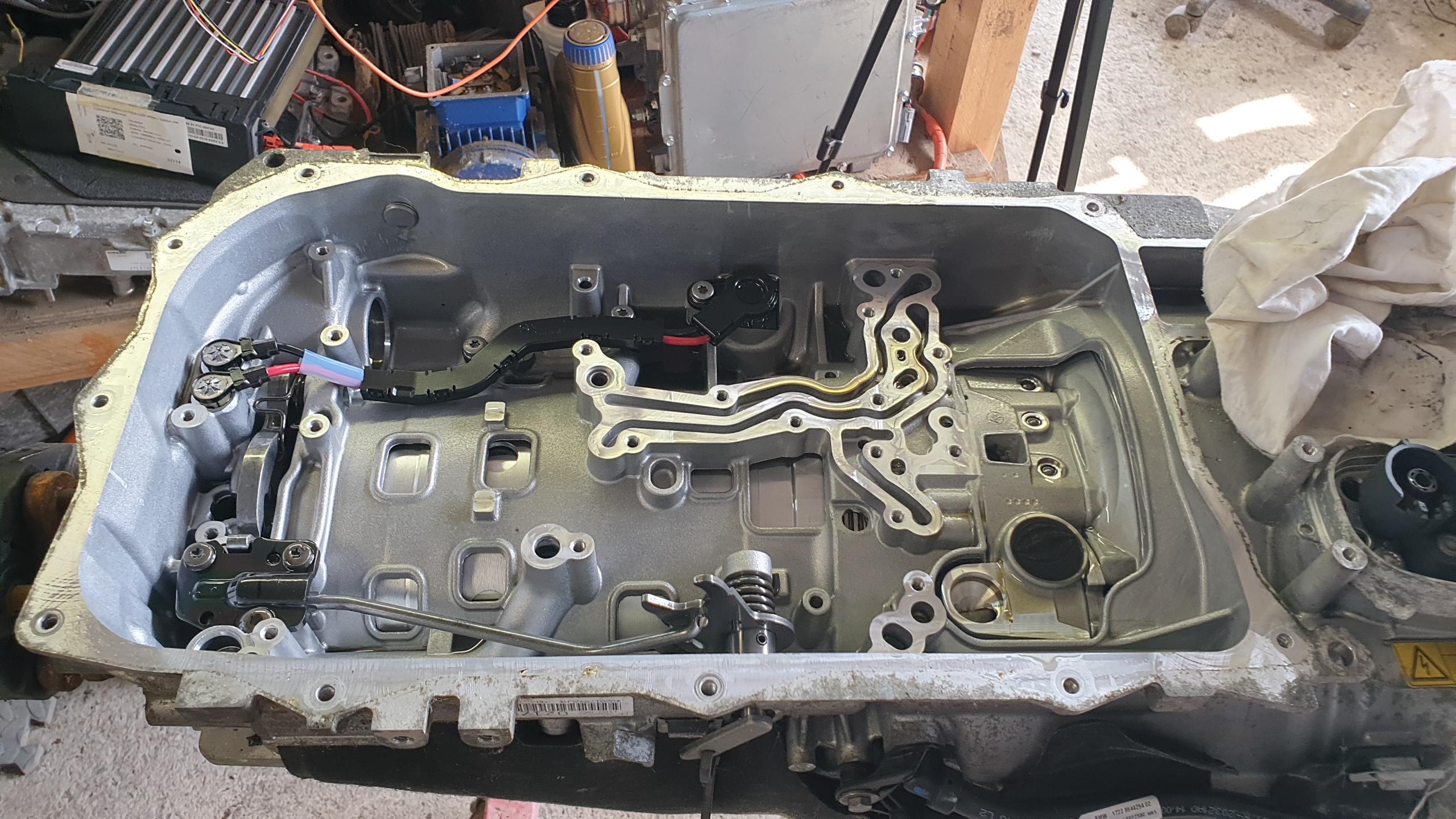

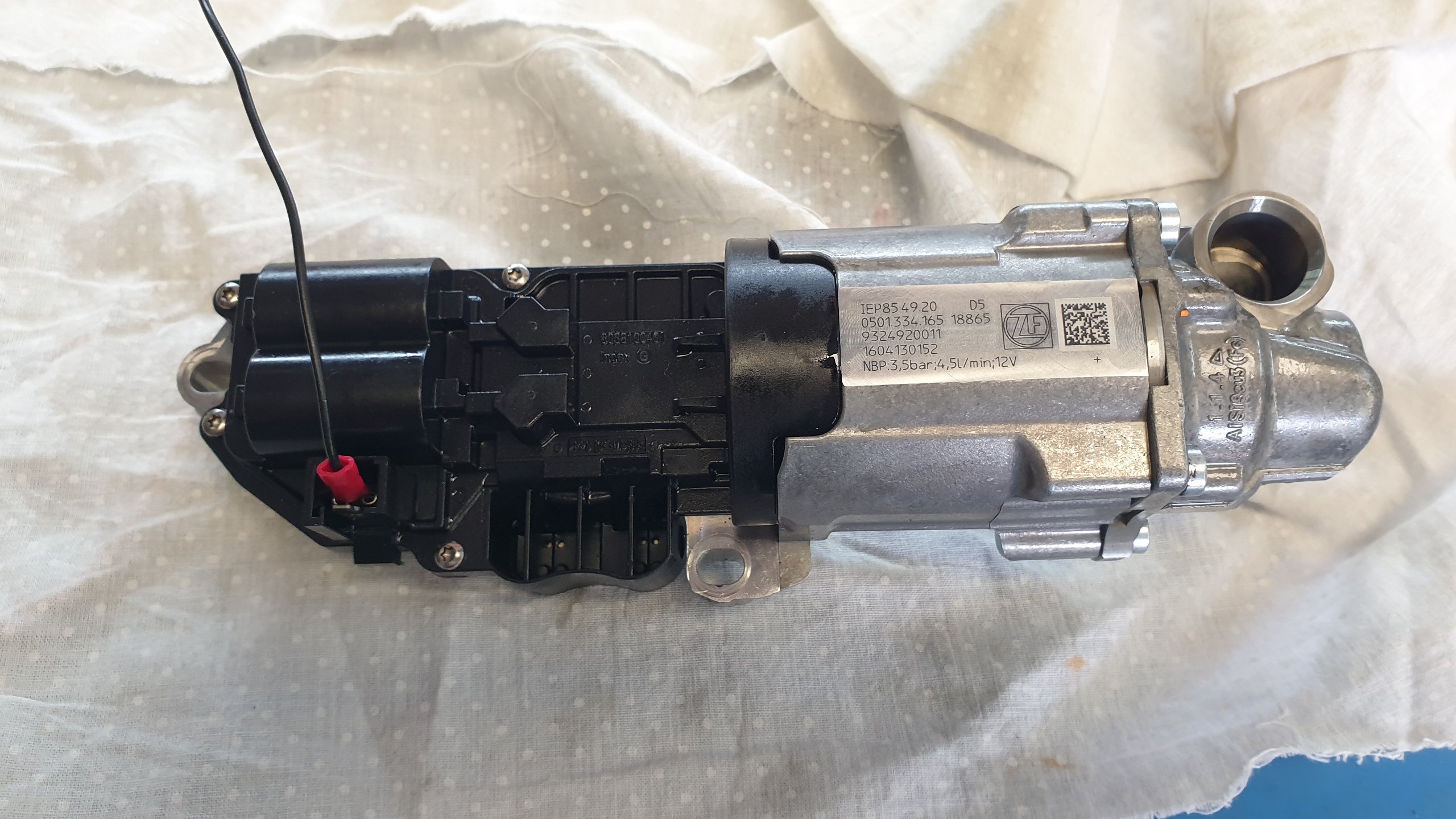

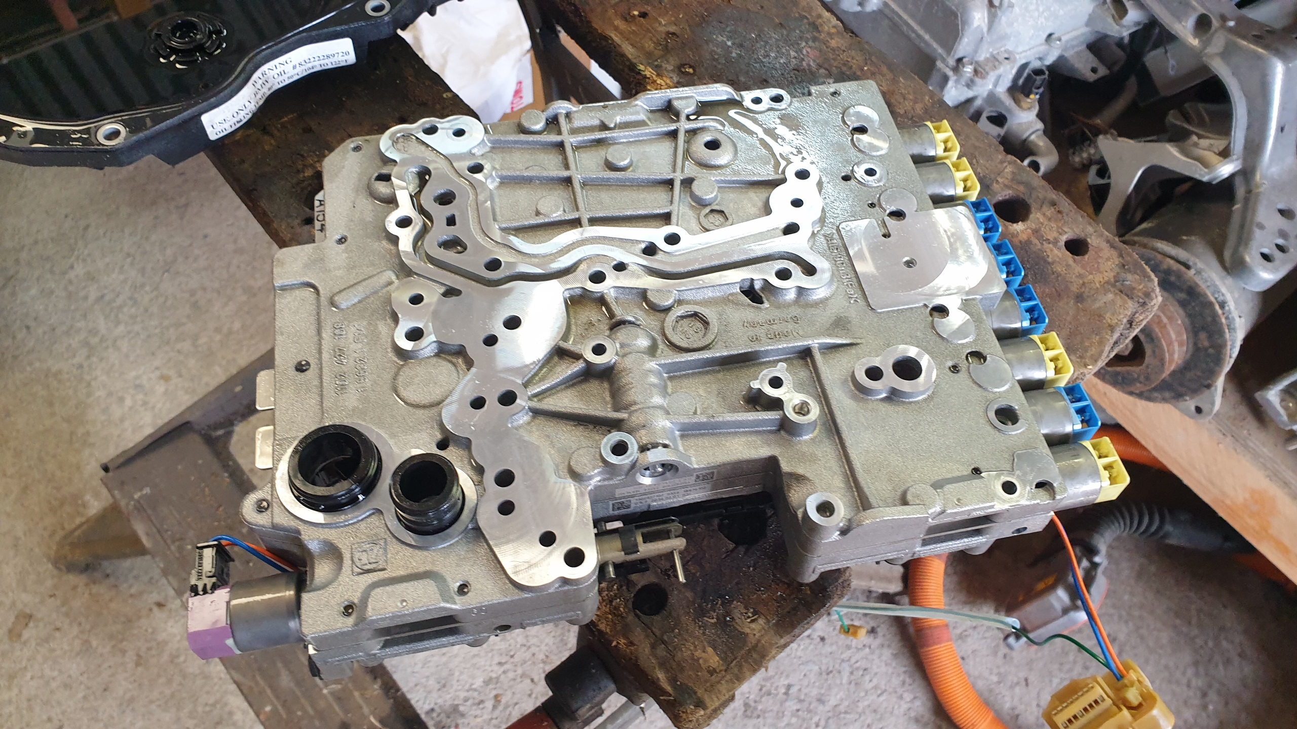

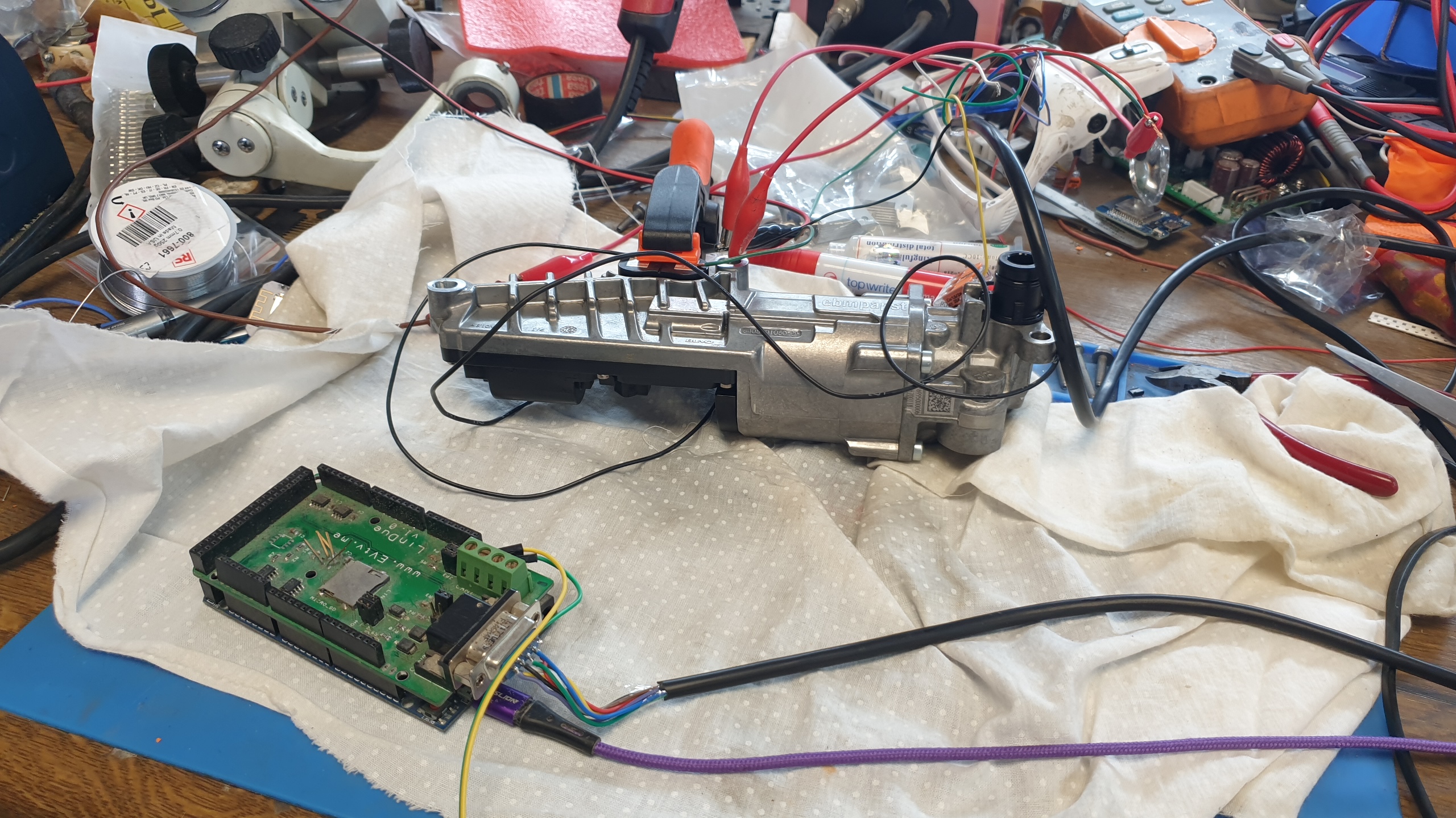

So in today's exciting episode. Got the aux 12v oil pump , valve body and tcm removed. Got to work on the pump. Naturally no info available. Discovered the following :
*Uses LIN V2 at 19200 baud
*Responds to ids 0x32 , 0x33 and 0x34
*Command id is 0x30. byte 7 is a counter from 0x00 to 0x0f.
So far I have not had the pump run but managed to trick the oem tcm into communicating with the pump via an obd adapter.
