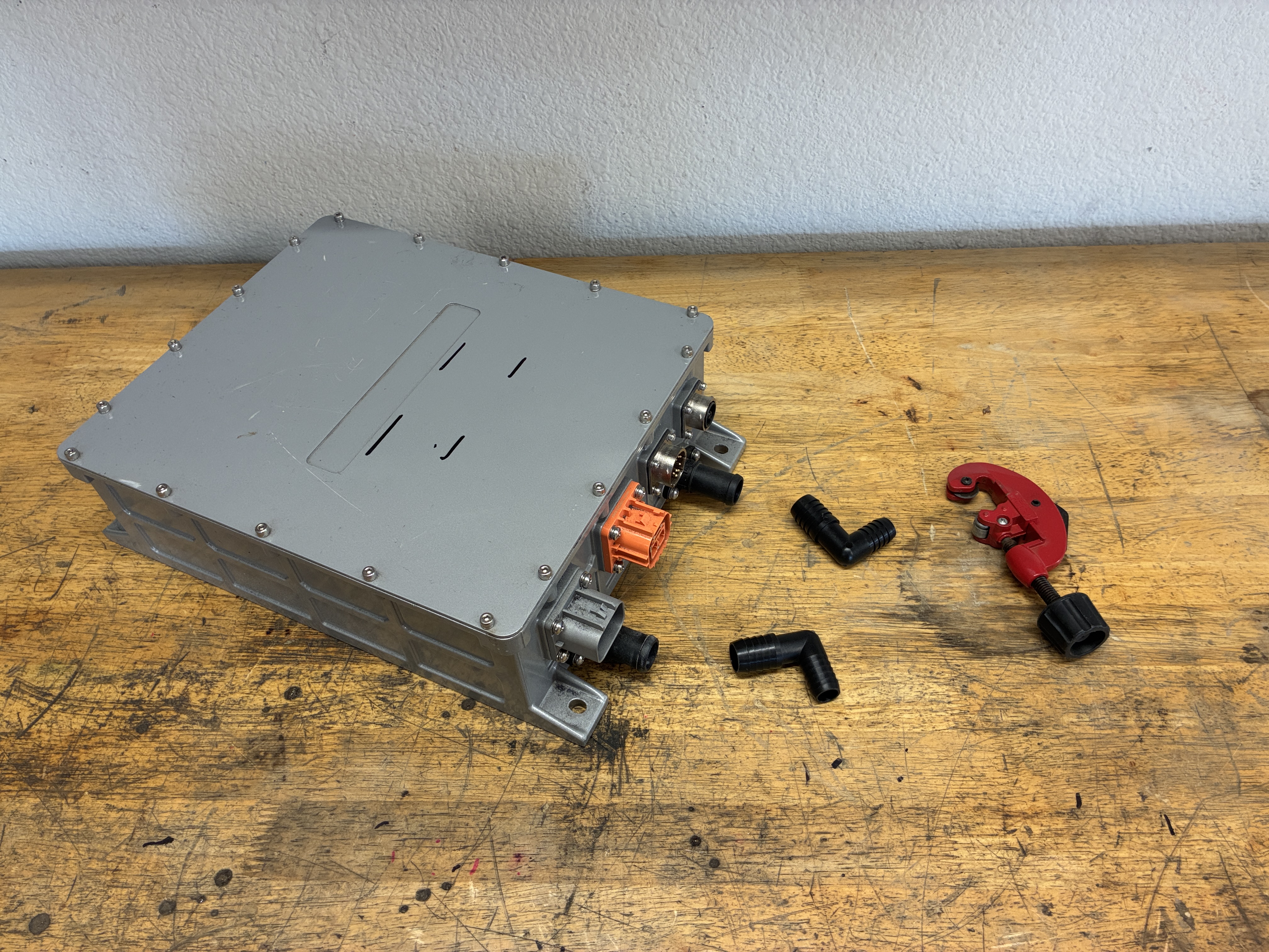

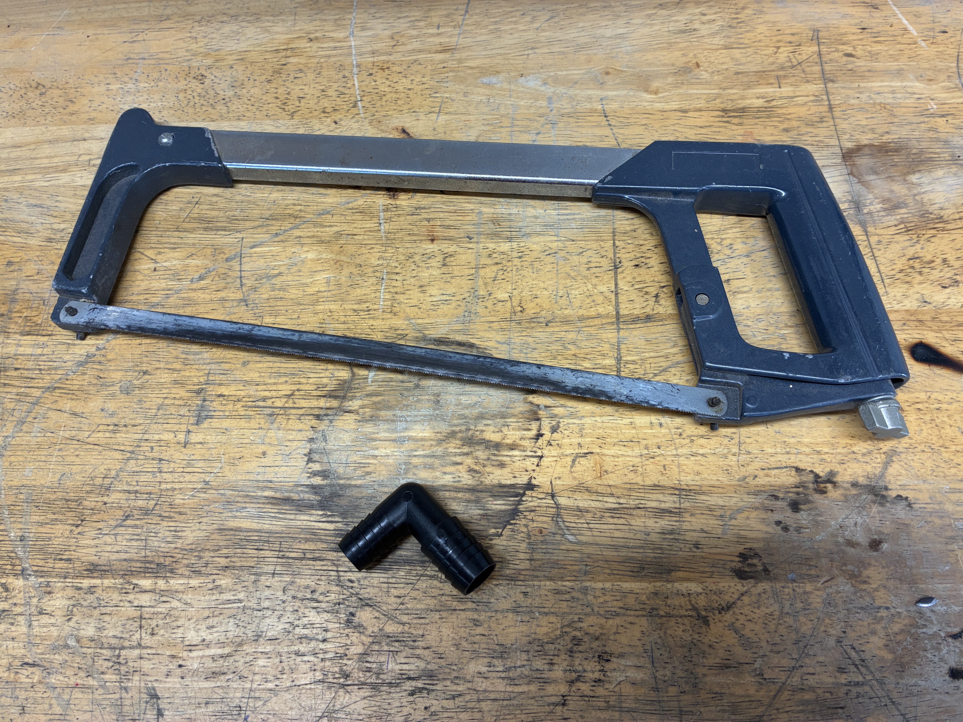

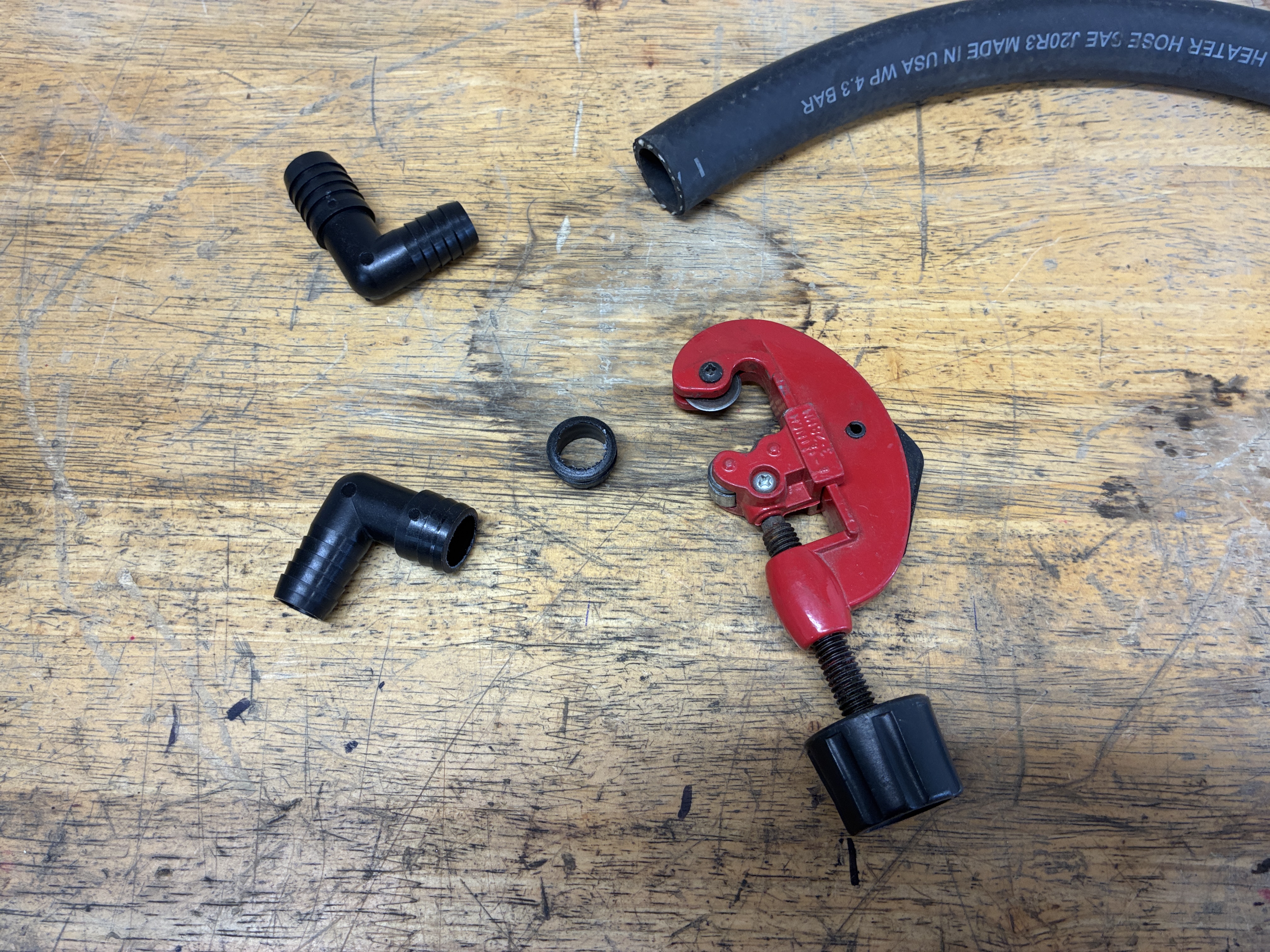

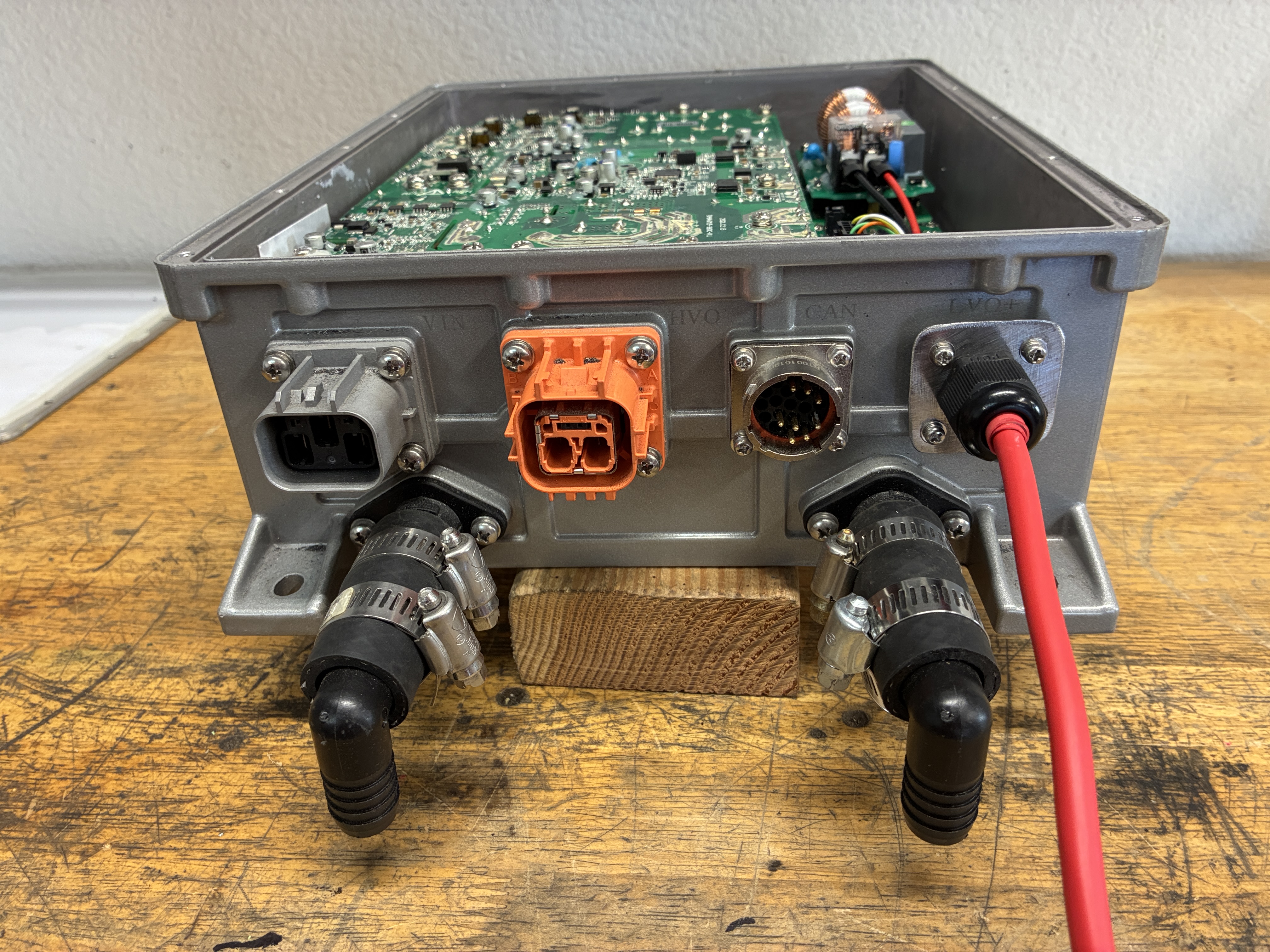

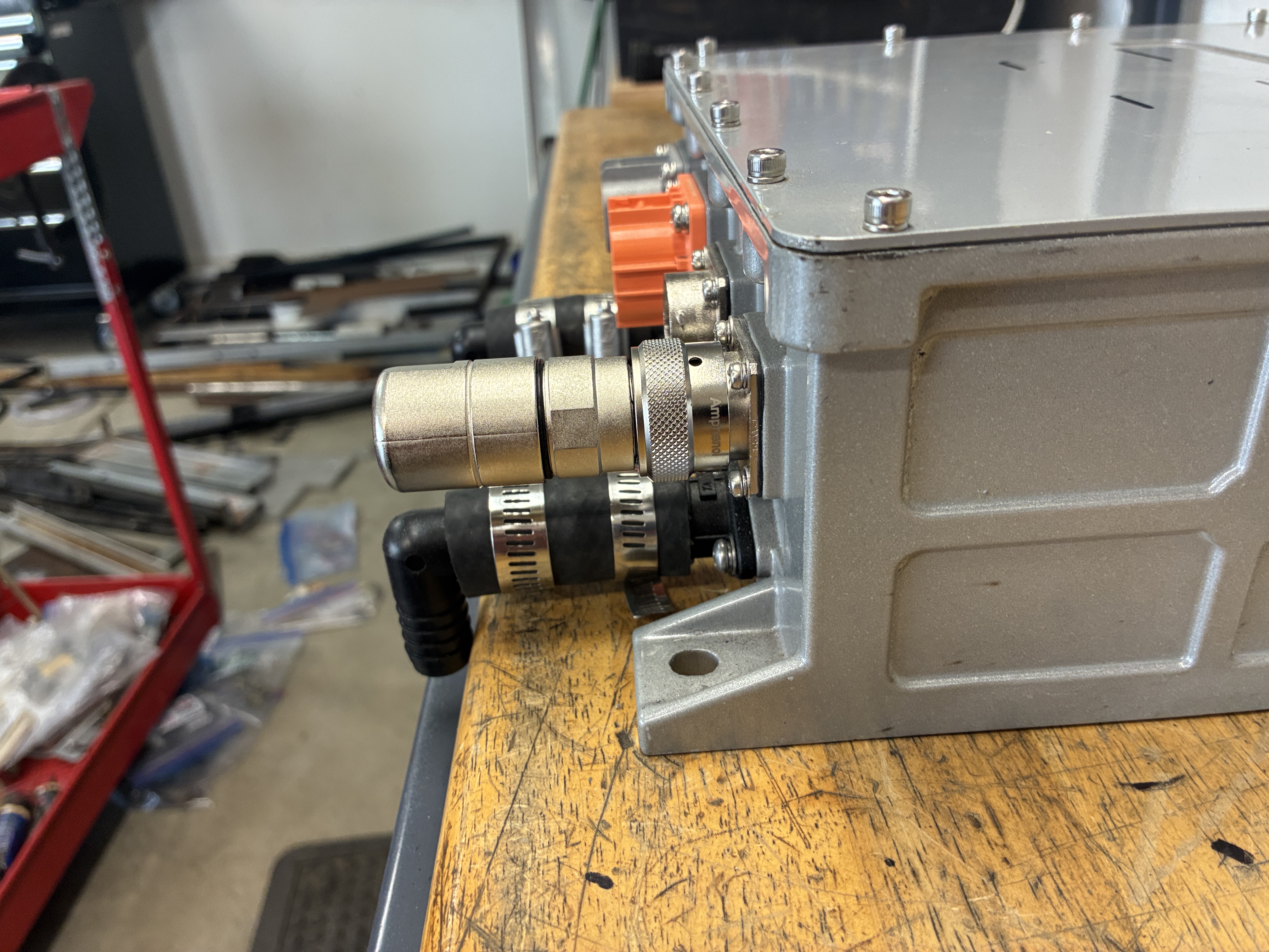

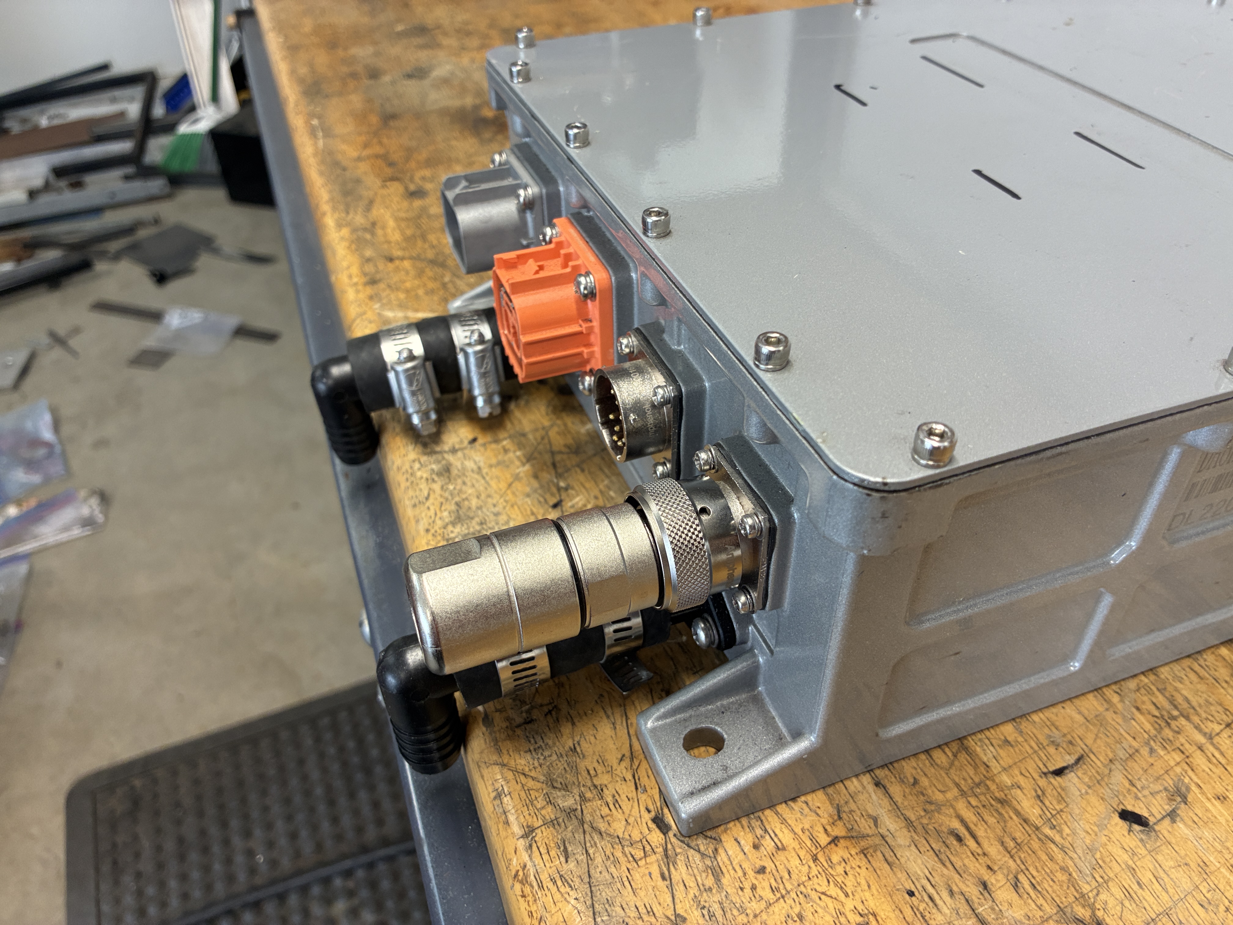

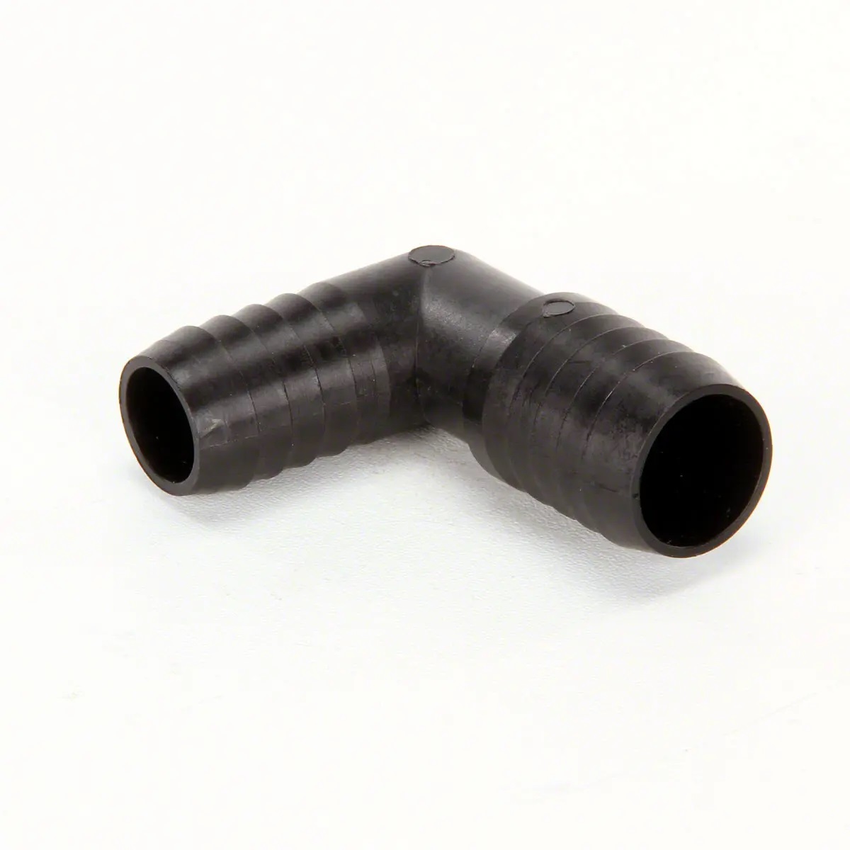

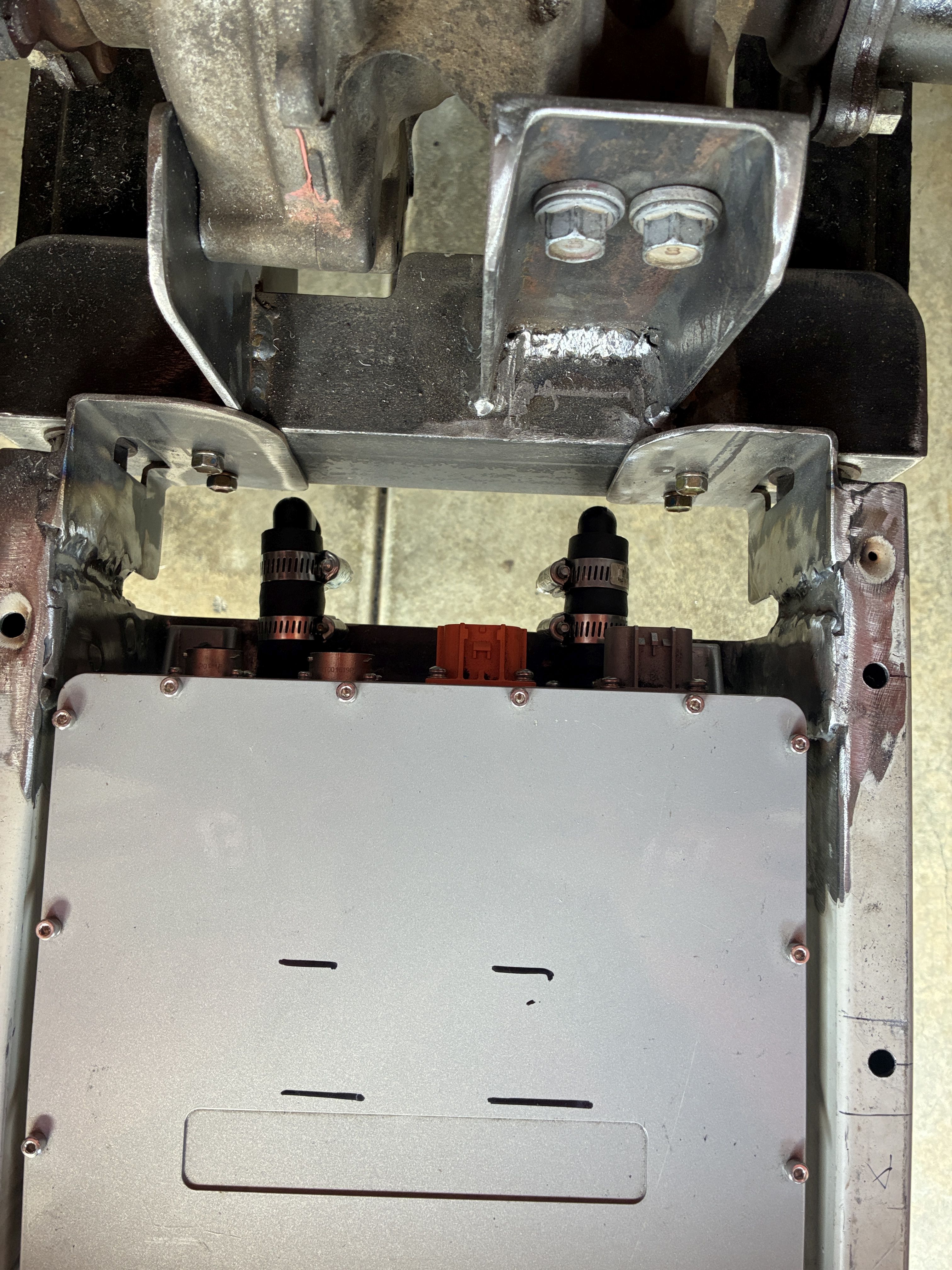

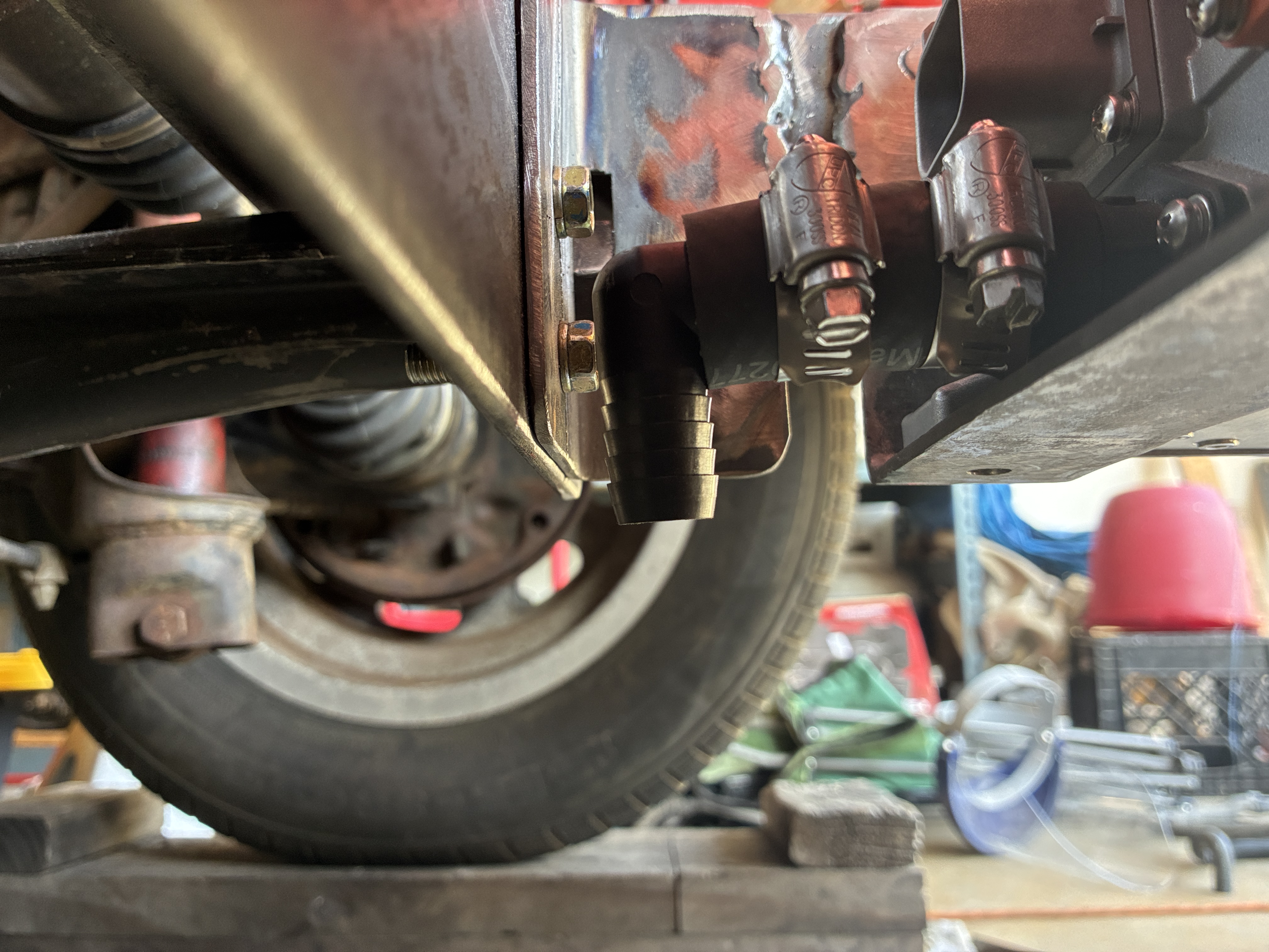

one of the things I don't like about this Ding Dong charger is that it's cooling ports are closer to 3/4" so slightly larger than all the other components (inverter, radiator, water pump) which have 5/9" ports, so I needed to order some reducers and since space was tight they had to be elbow
Hypro 3/4" Hose Barb x 5/8" Hose Barb Poly Elbow Fitting
https://www.spraysmarter.com/hypro-3-4- ... yGWJsbVxDD

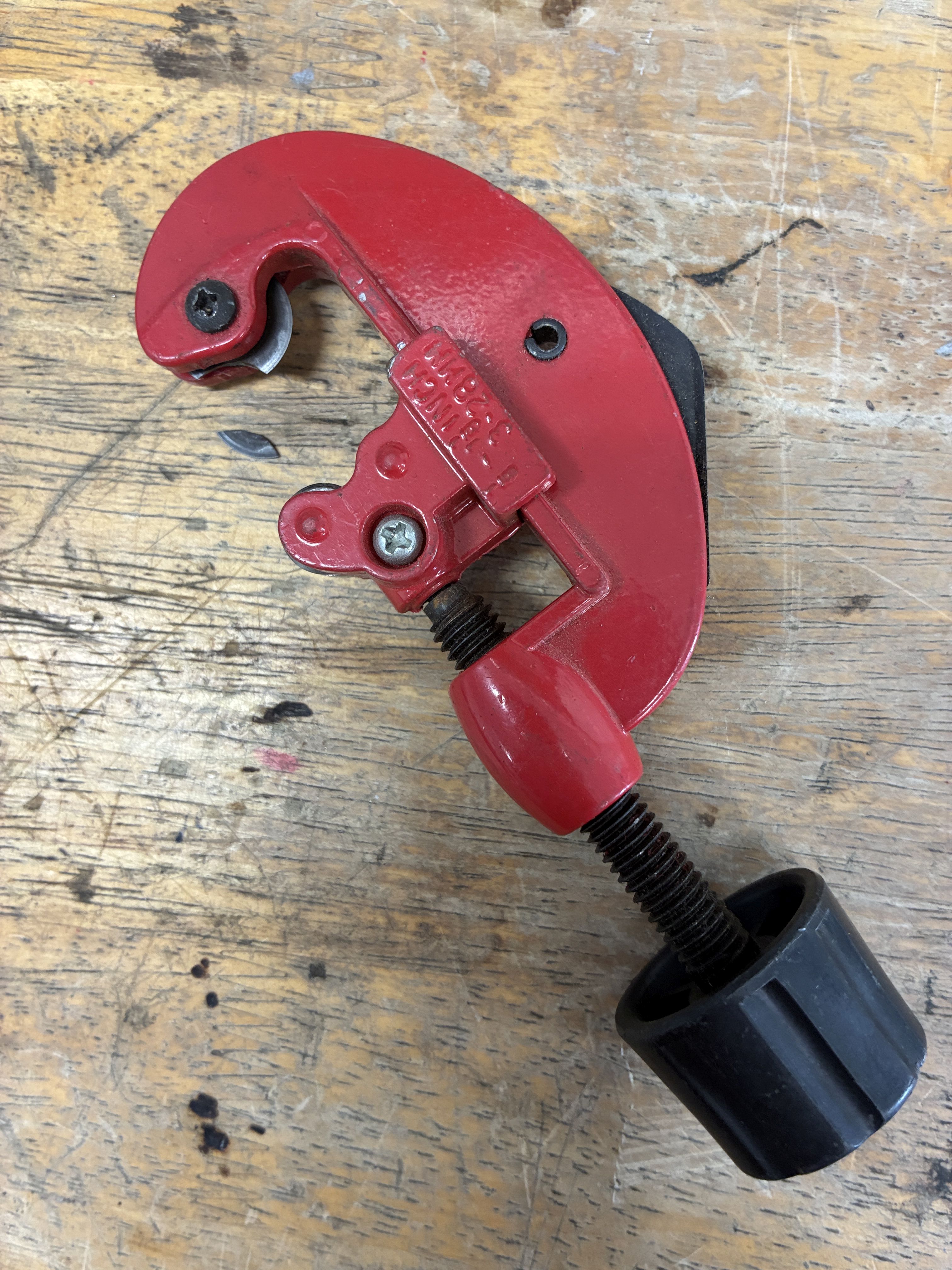

and so the elbows had to be shortened, thank goodness for the extra rows of barbs

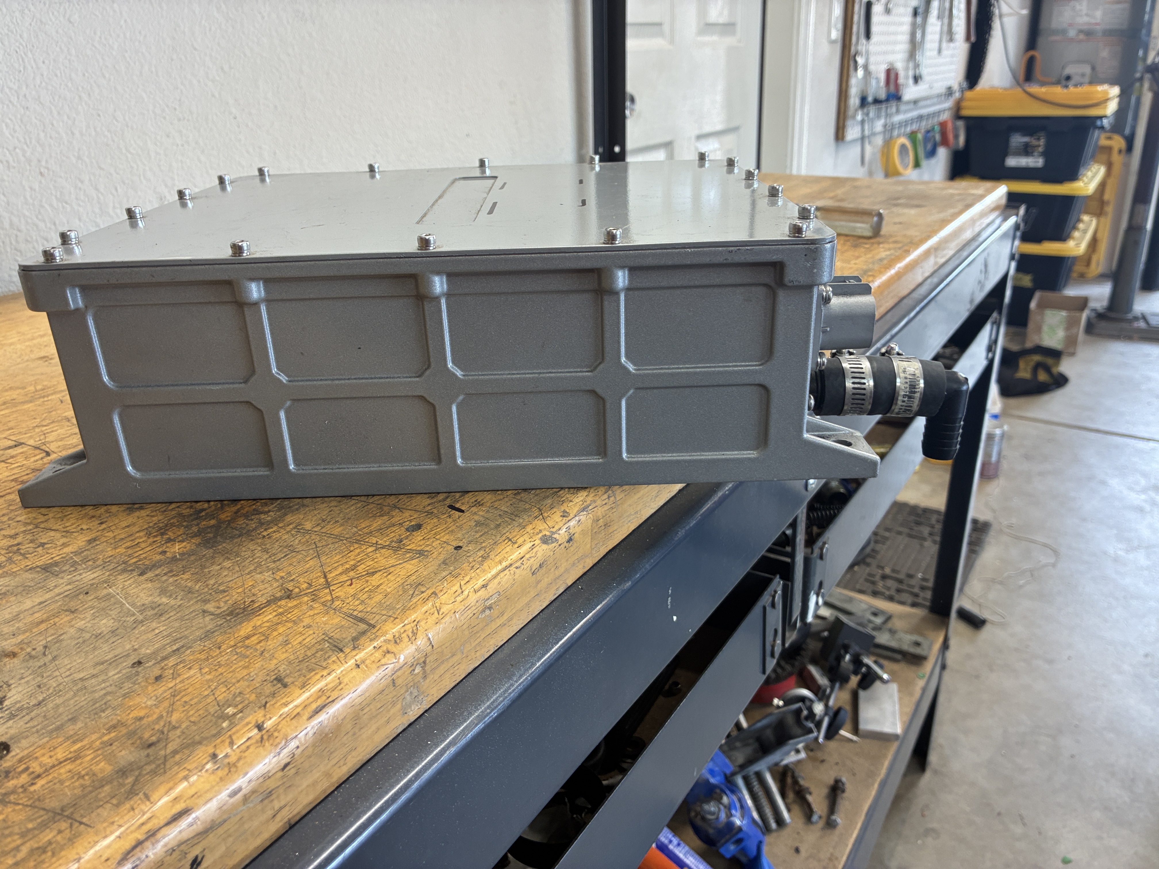

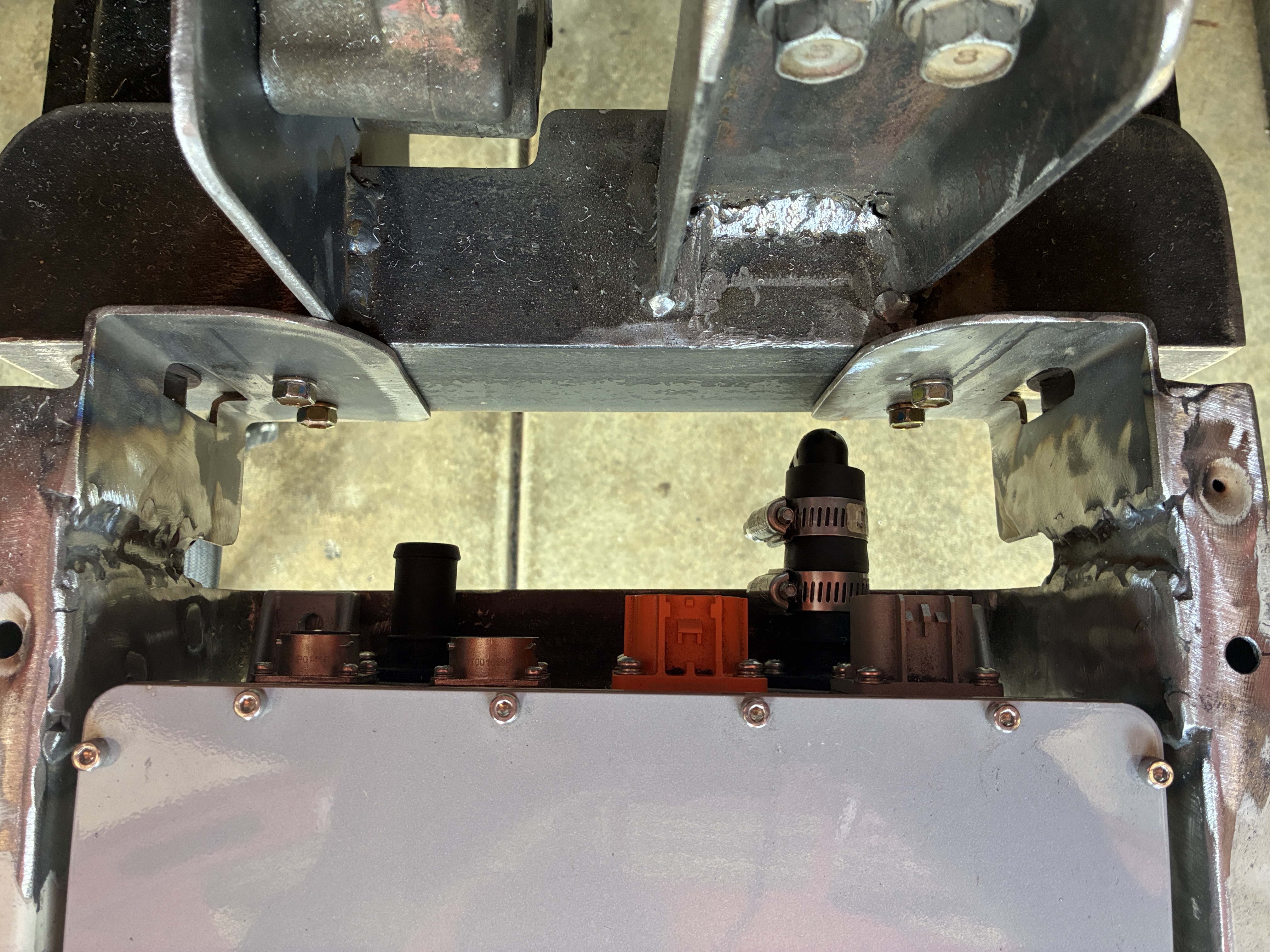

Re: Bunky the eBug: A 30 Day EV Conversion
and let's see how that fits... good enuff for the girls we date!

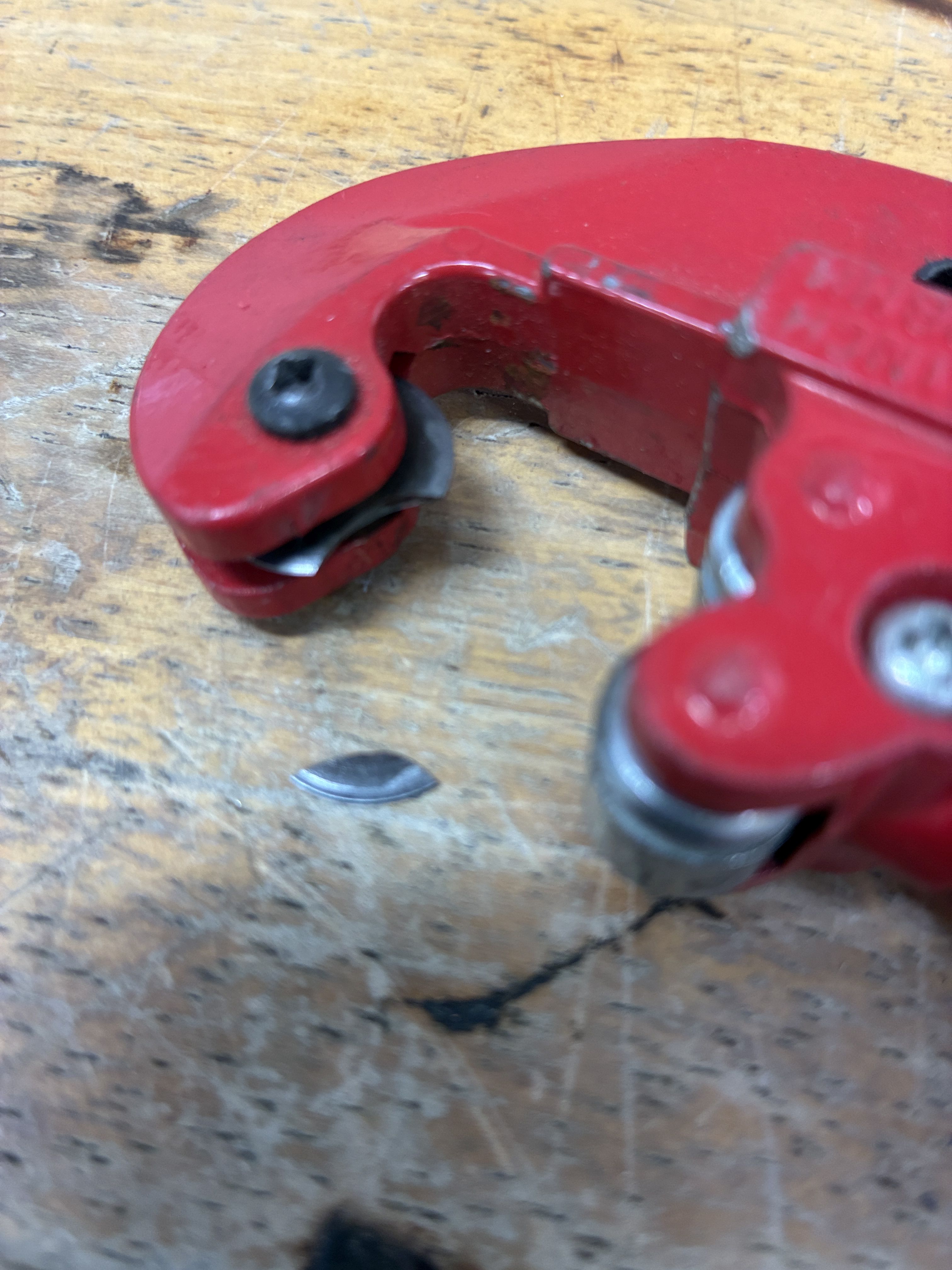

what the hell? since when does plastic beat metal?

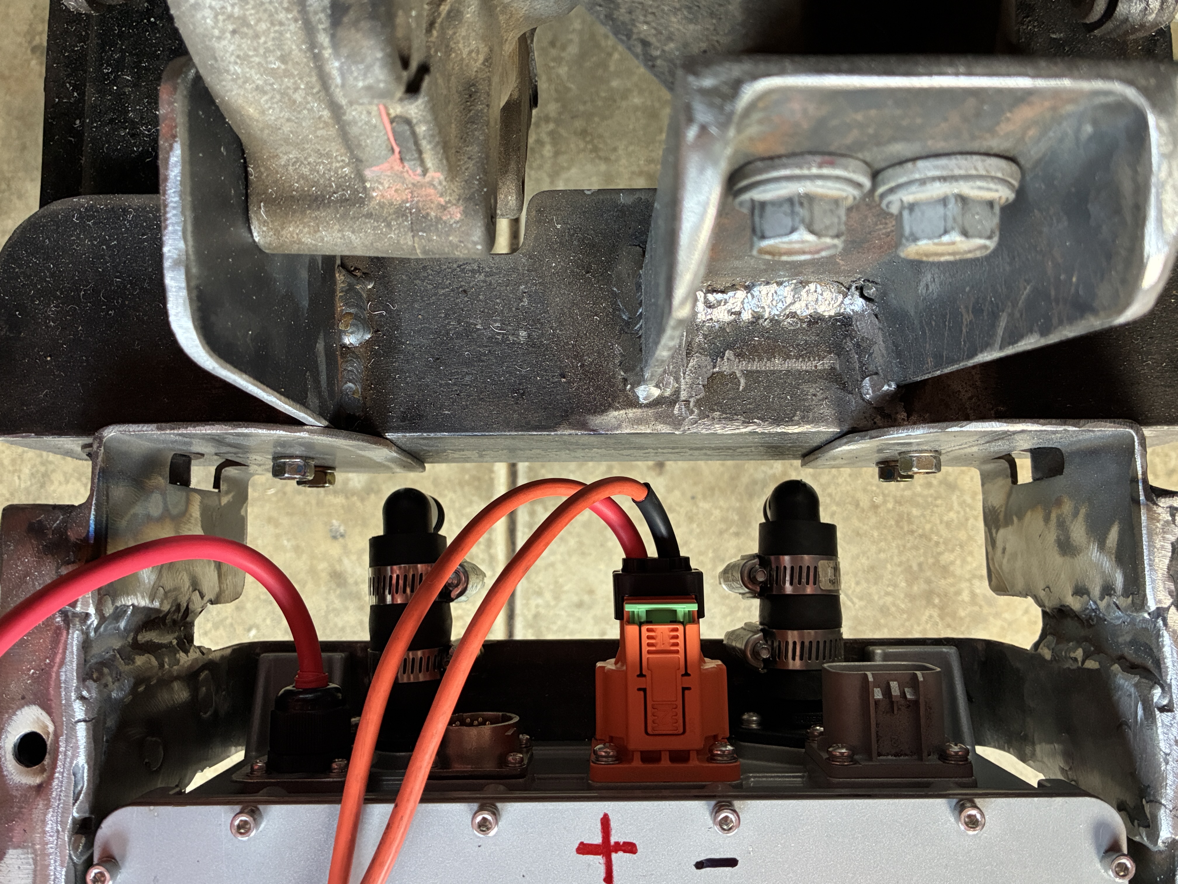

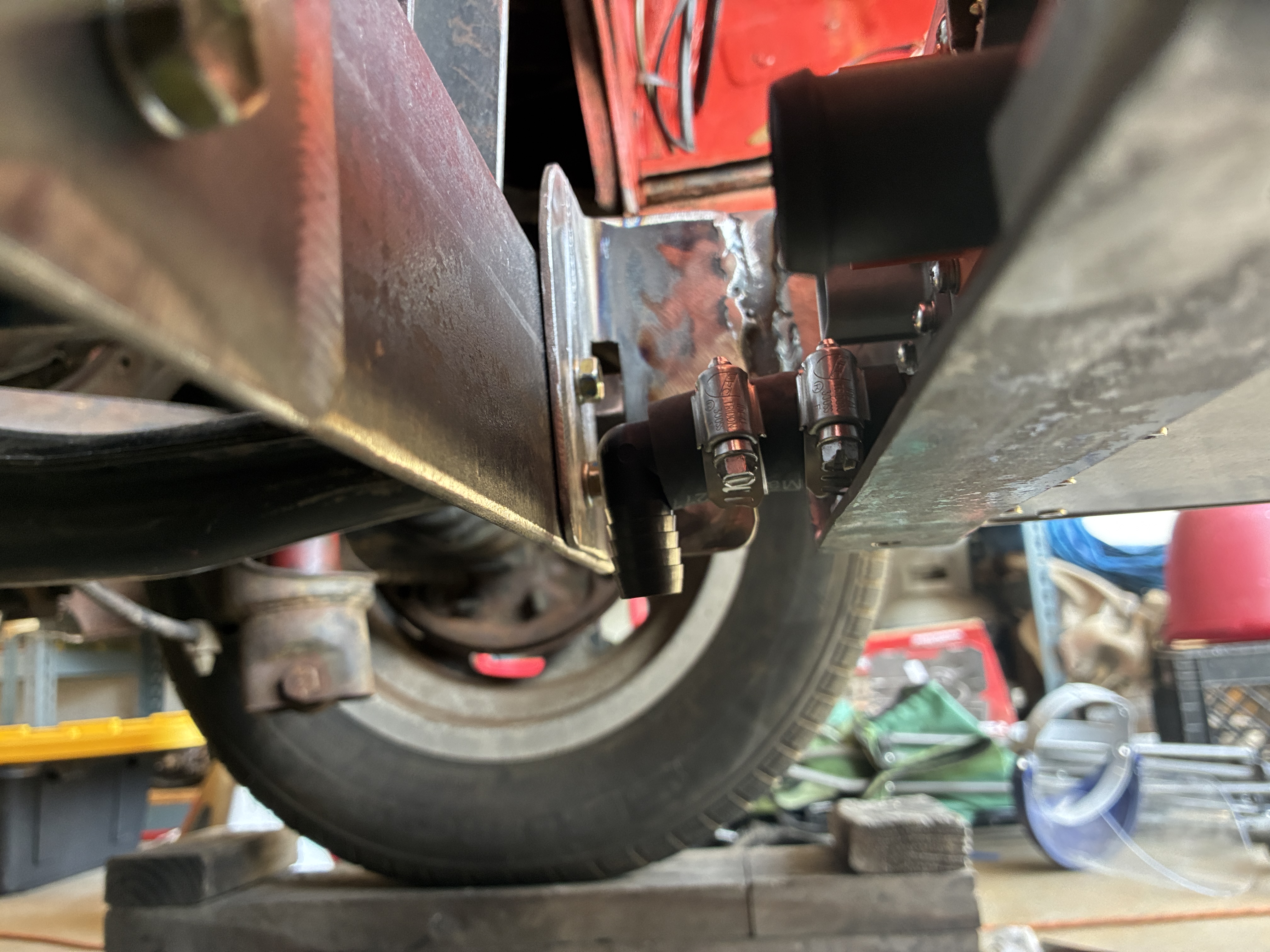

The Greg did not even skip a beat...
and we have clearance Clearance

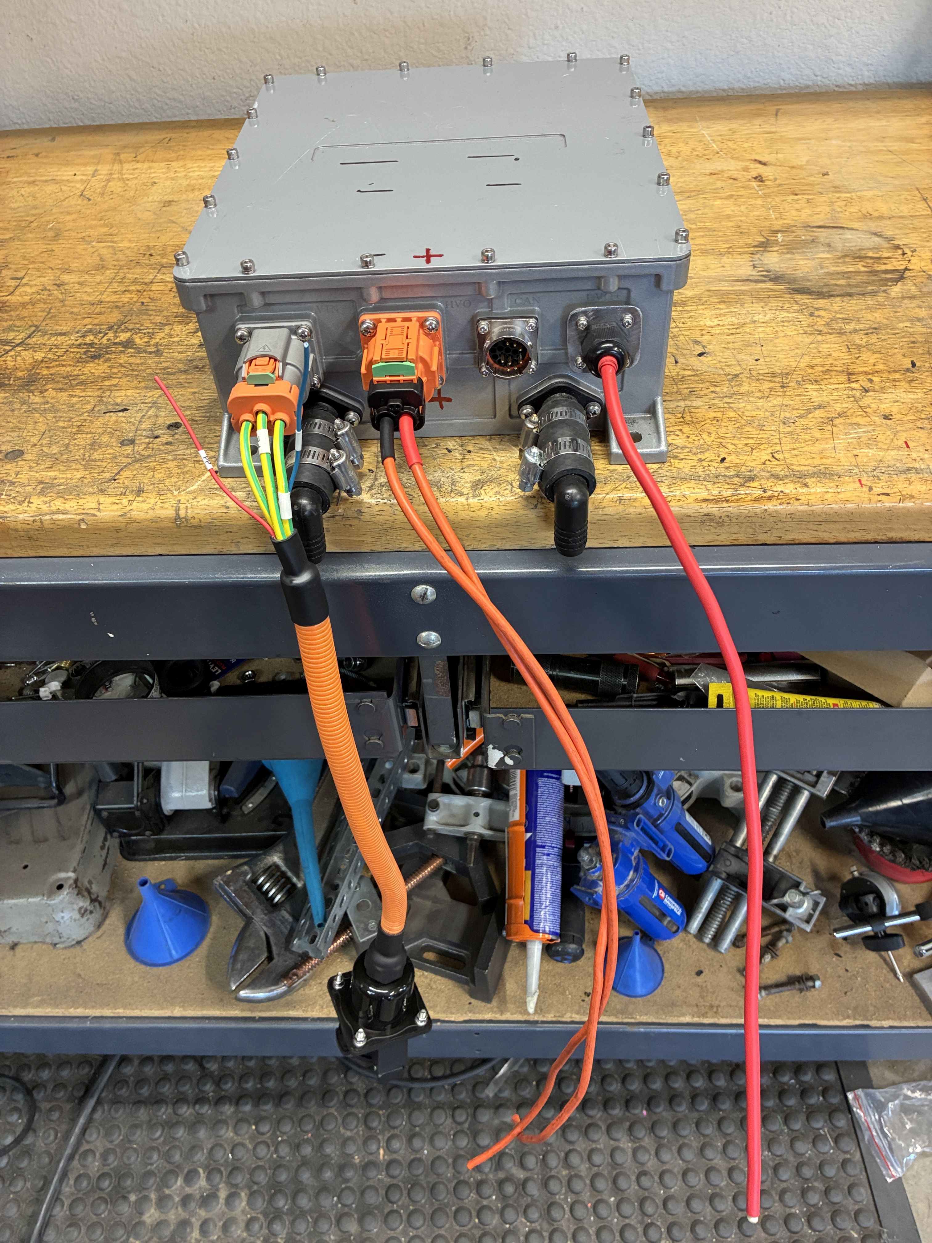

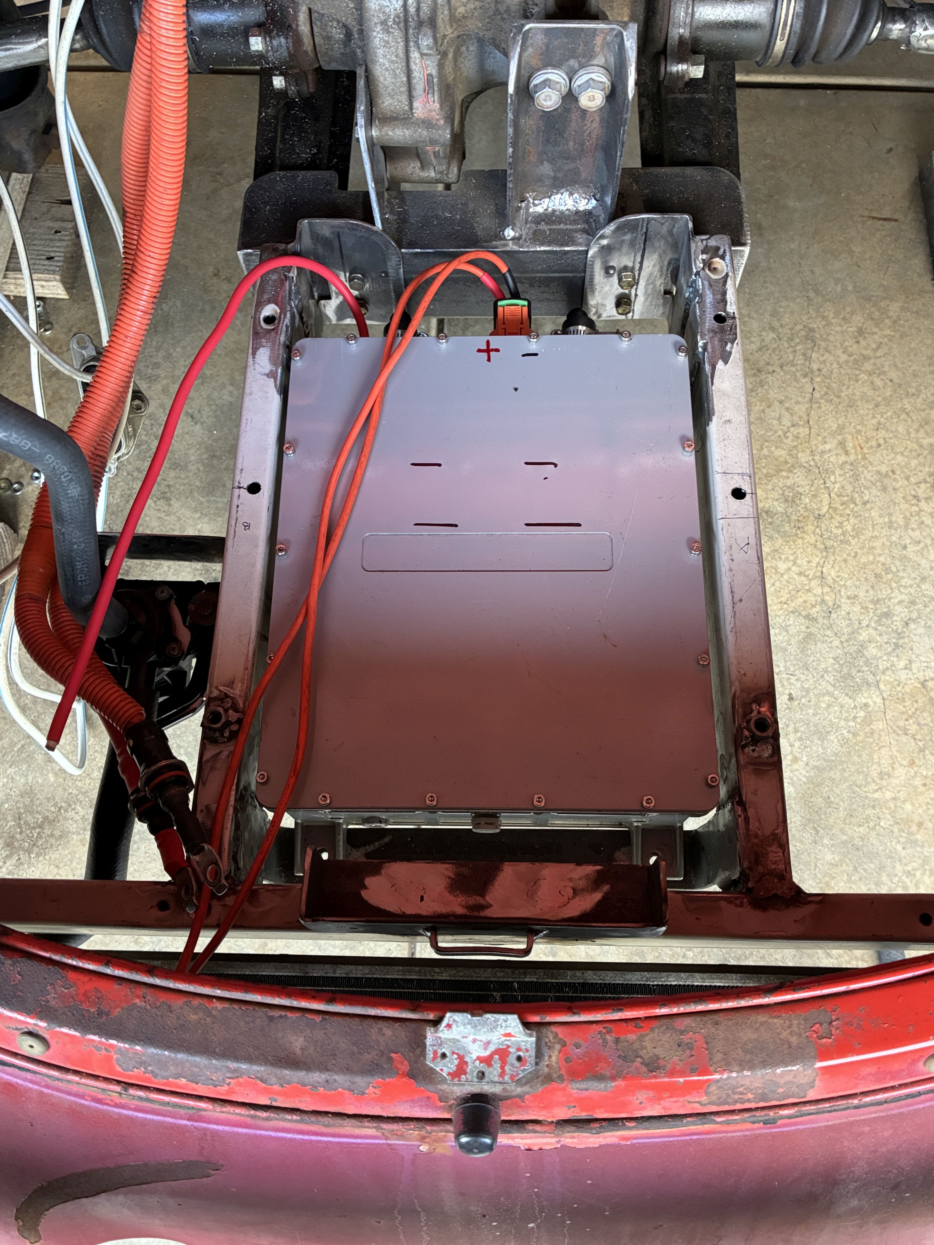

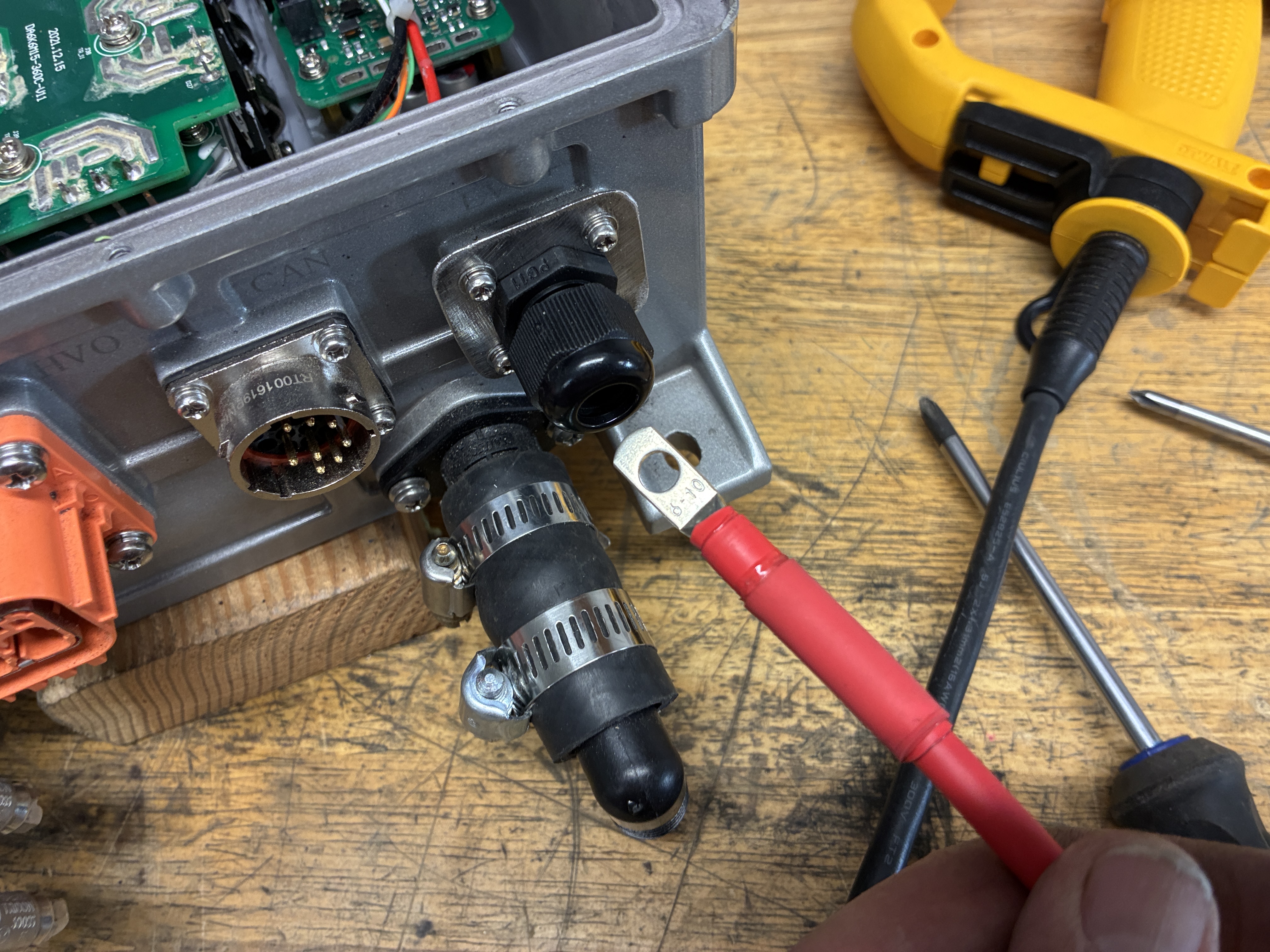

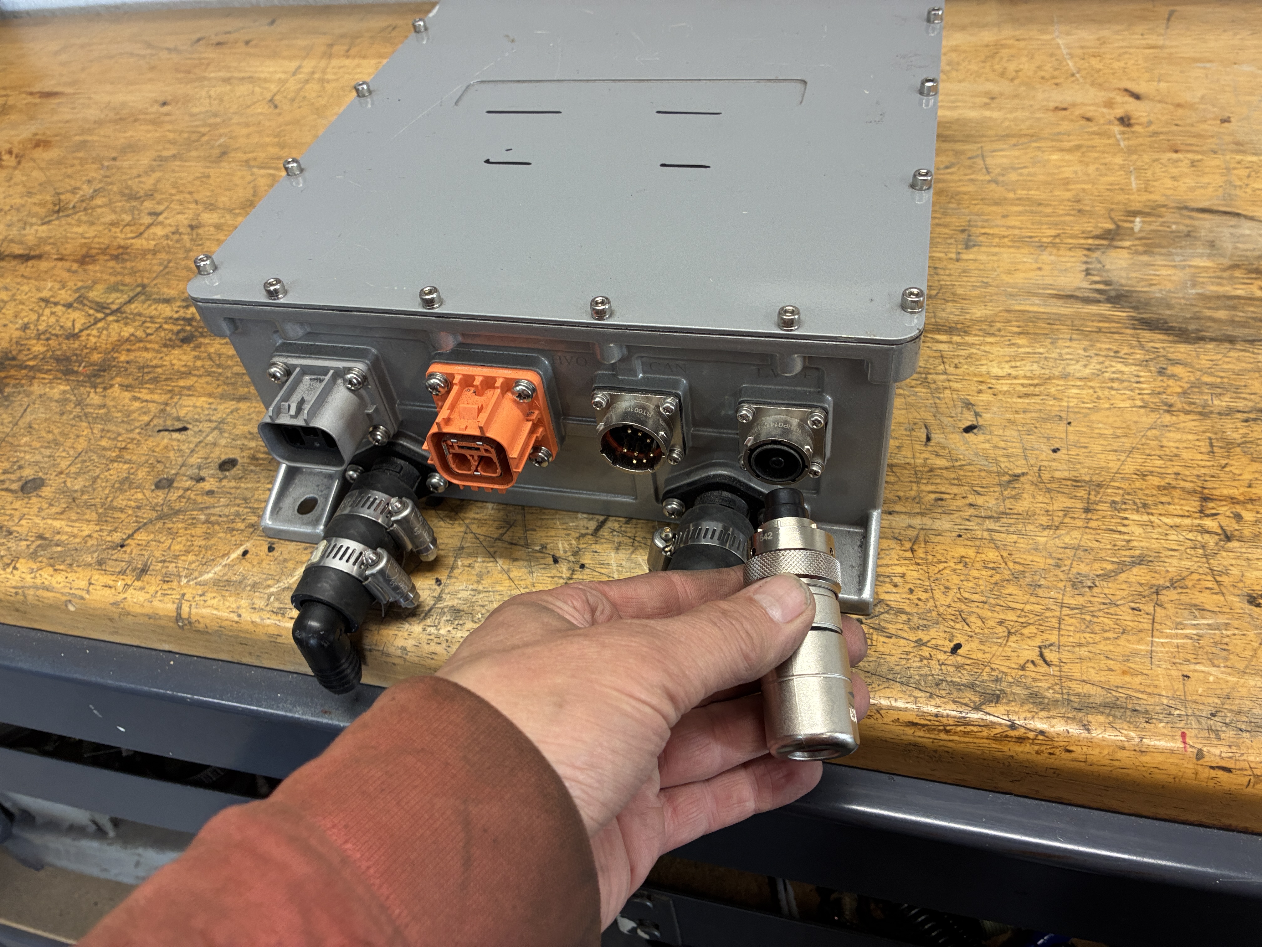

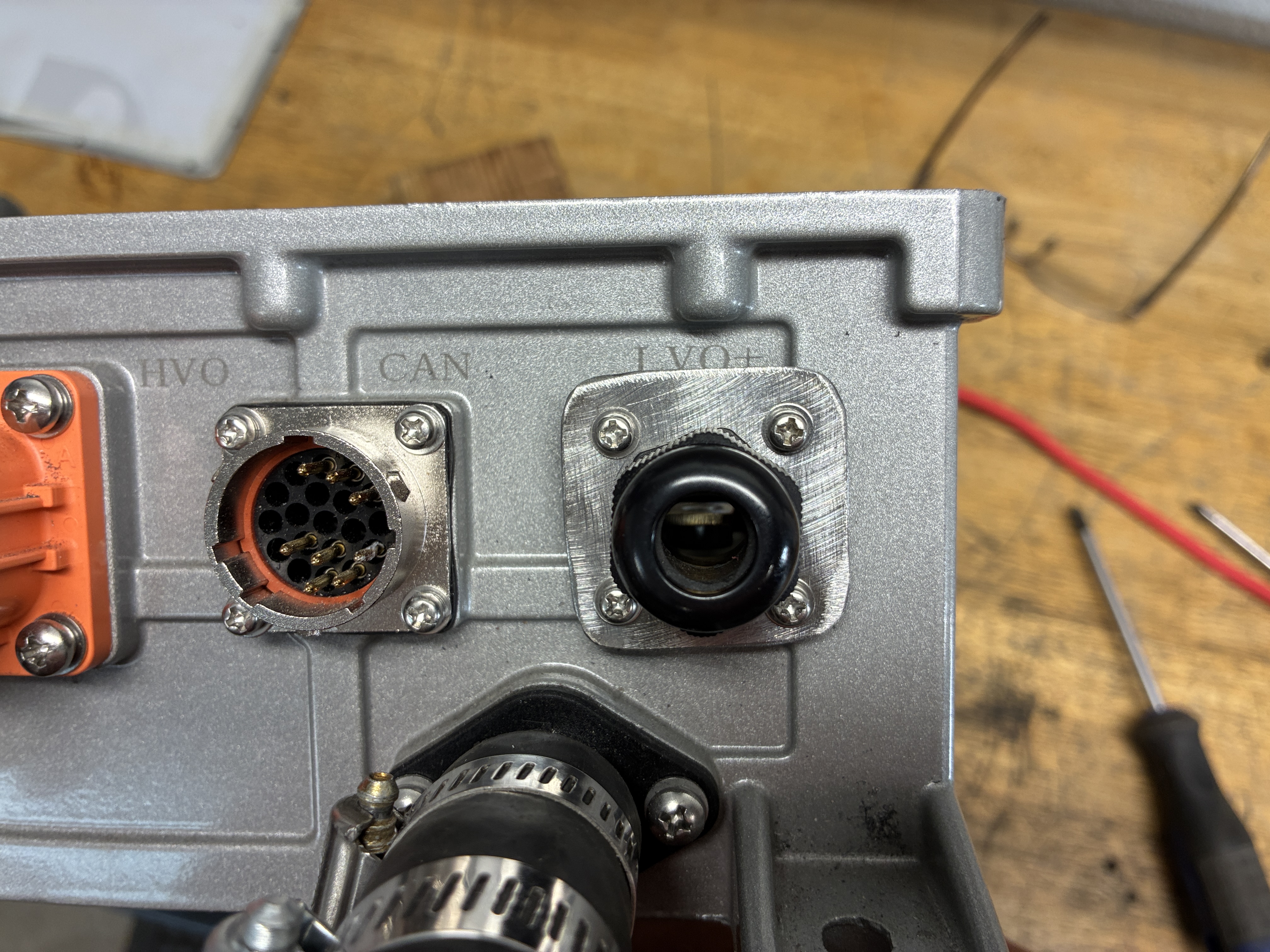

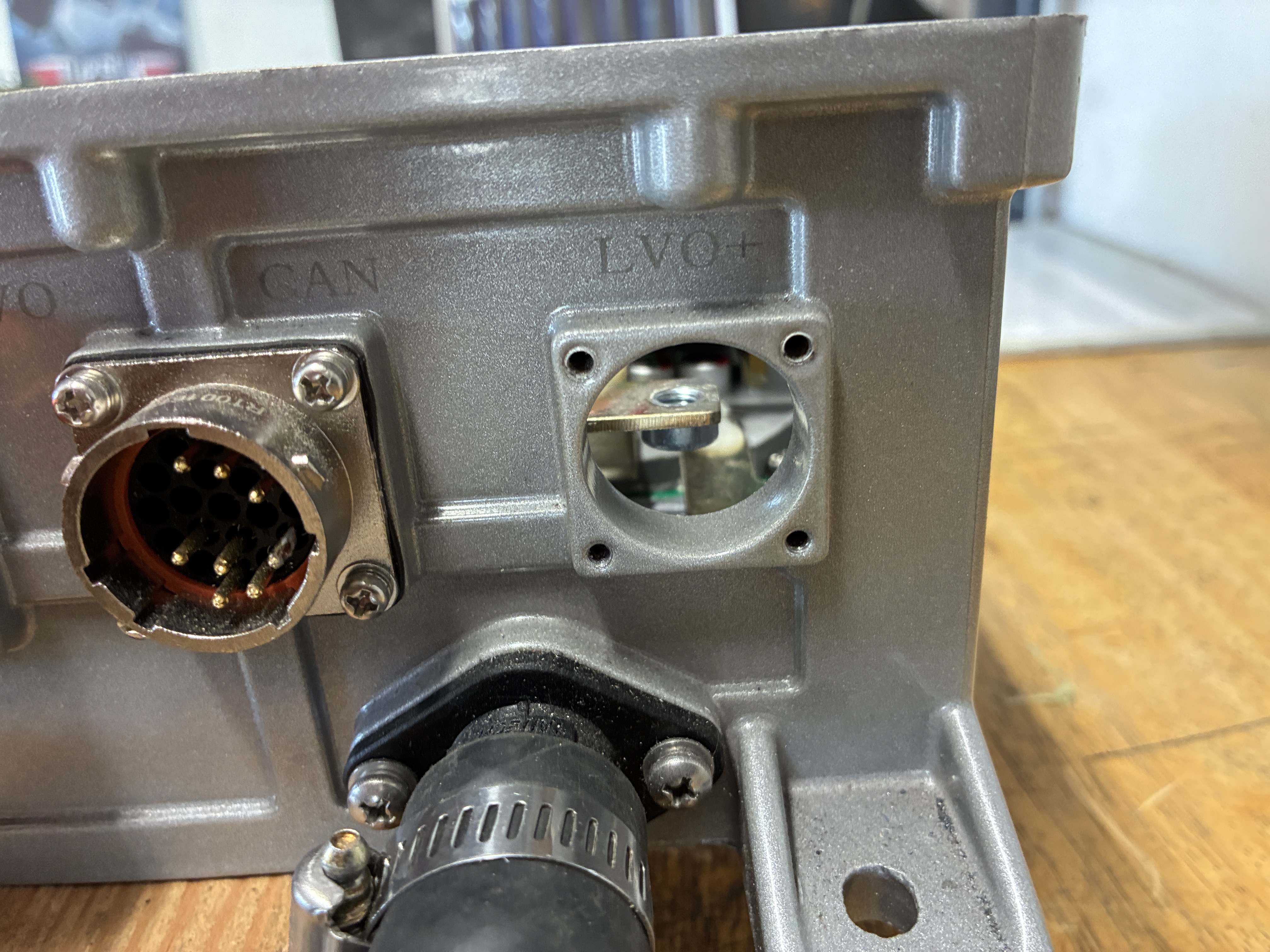

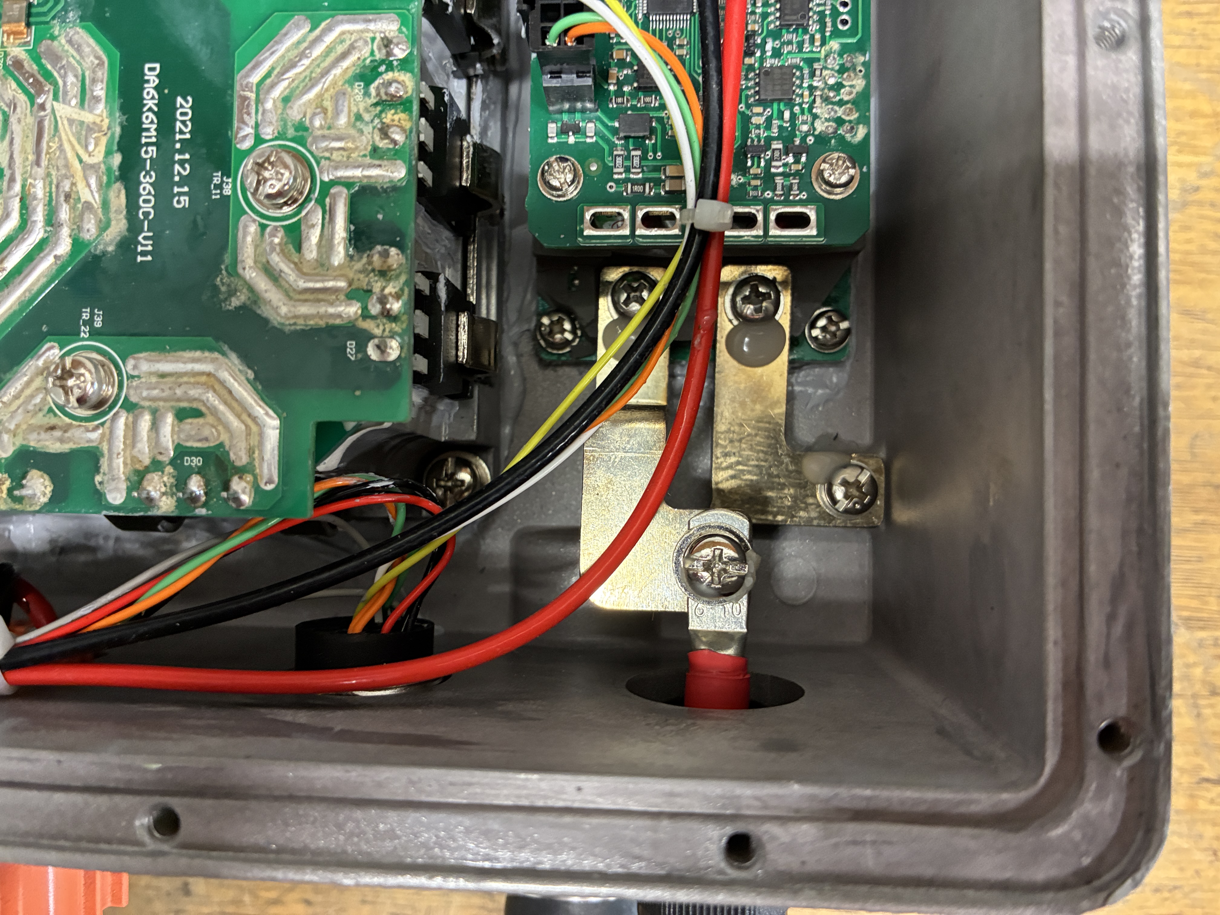

I was dreading wiring up this Ding Dong Charger/DC-DC Converter but here it goes
first up was this SINGLE WIRE low voltage regular 12 volt car battery charger cable, ie alternator cable
and folks we just don't have that kinda room

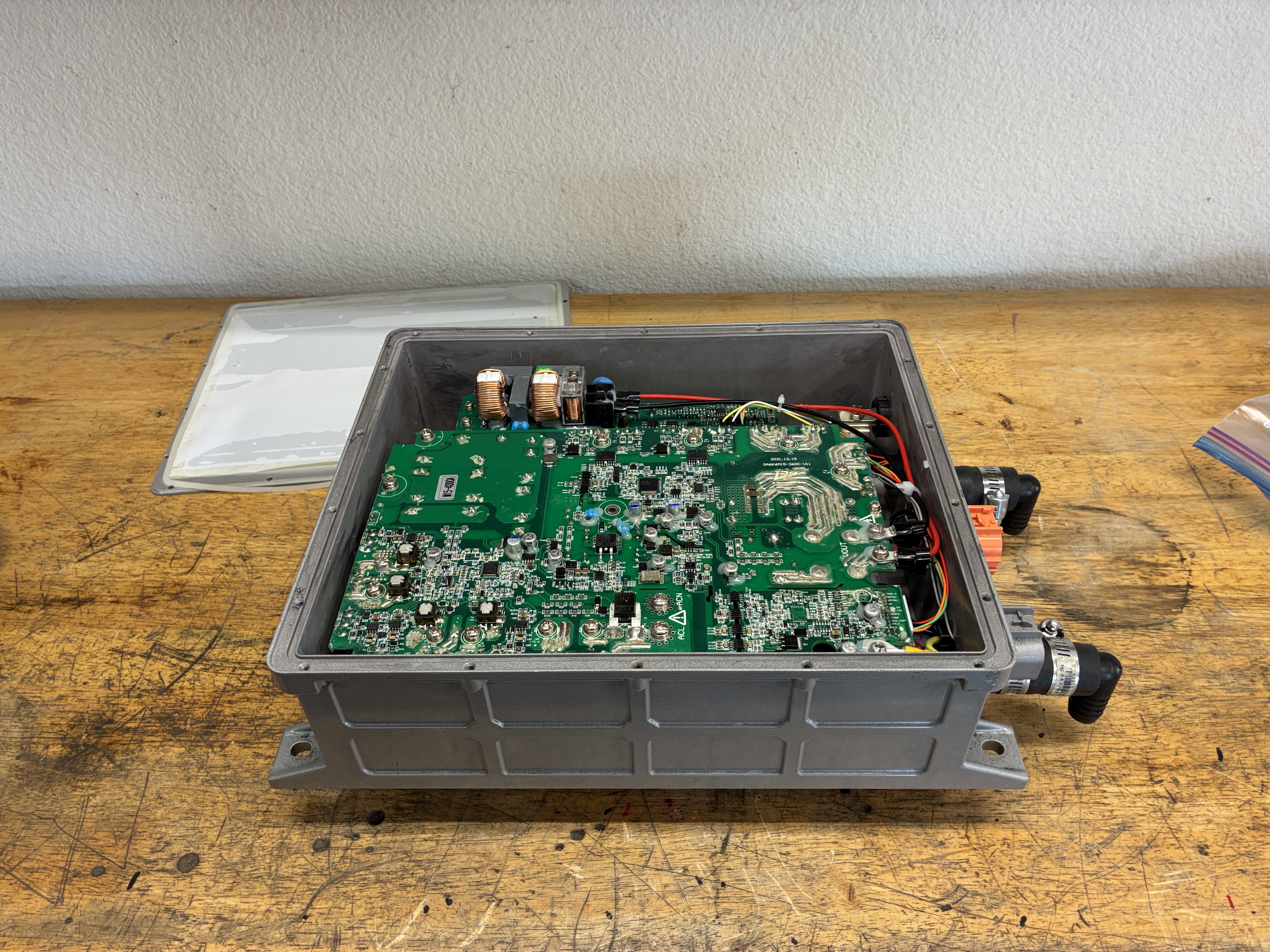

I will post excruciating detail of me having my way with this Ding Dong charger here I just bought a Dilong aftermarket charger - Now What? so that we can keep this thread focused on the bigger picture and our mission (driving to Costco for a slice of pizza) in case I haven't mentioned it already

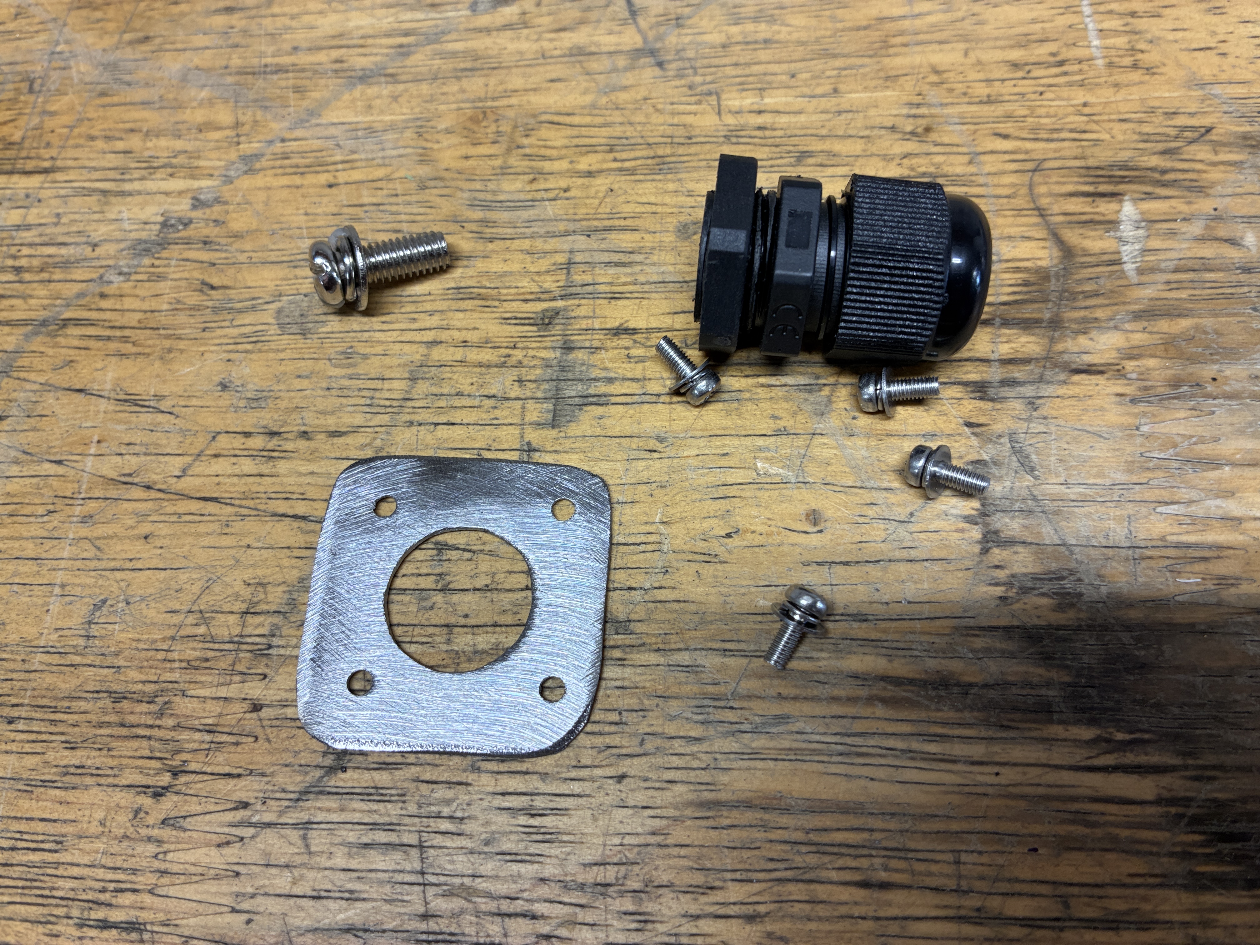

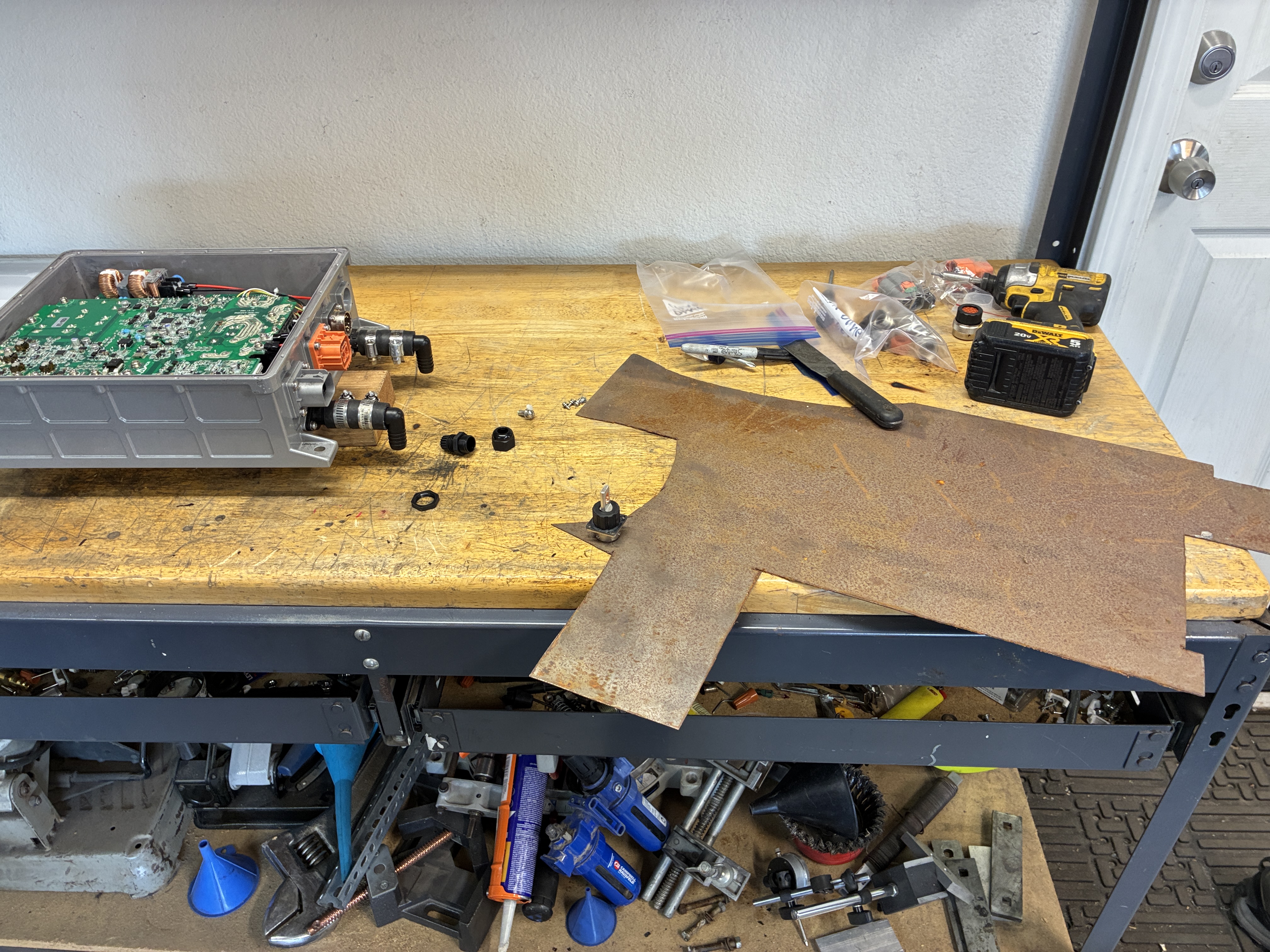

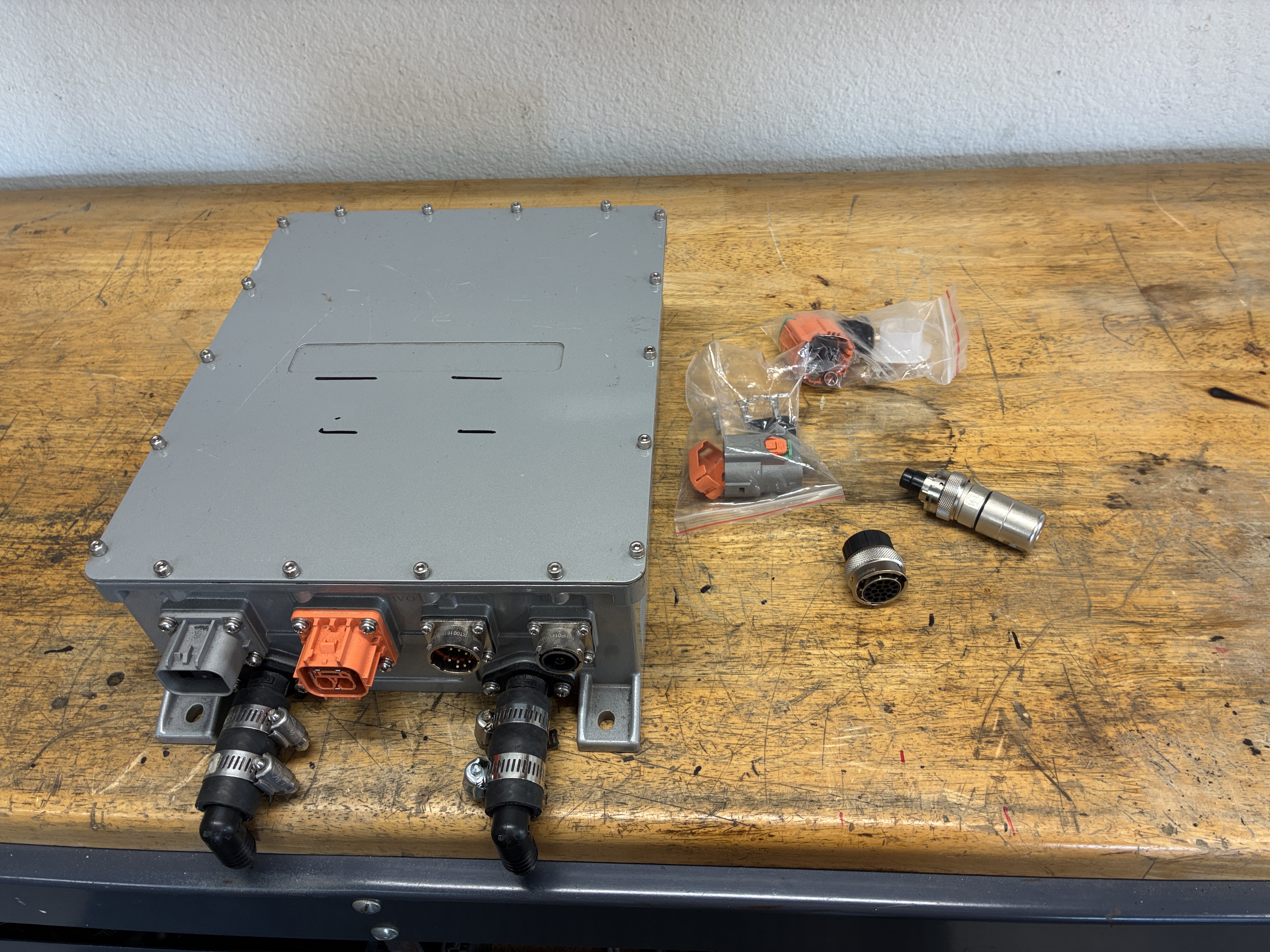

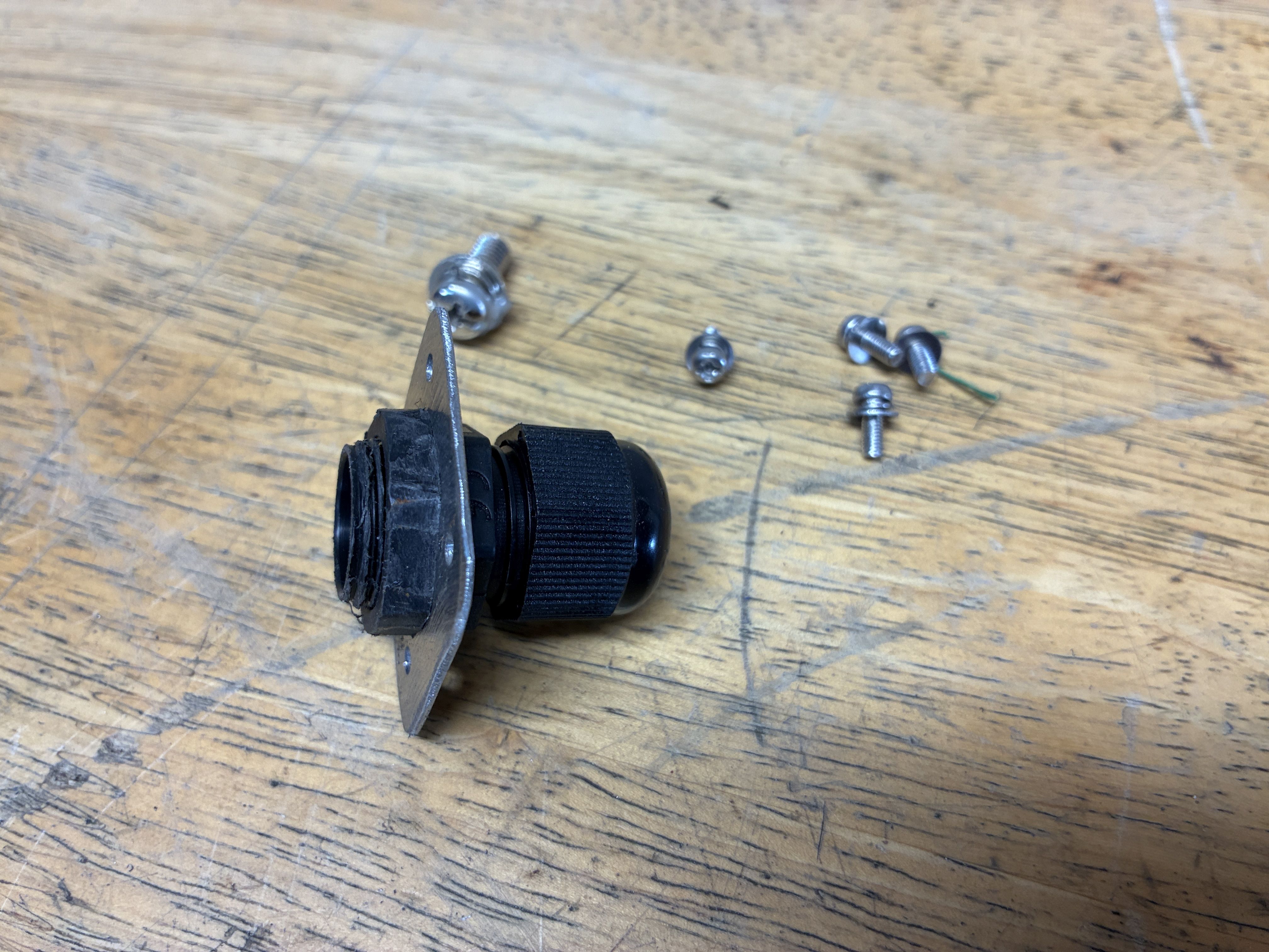

so out came the stock thingie
and we set out to make our own

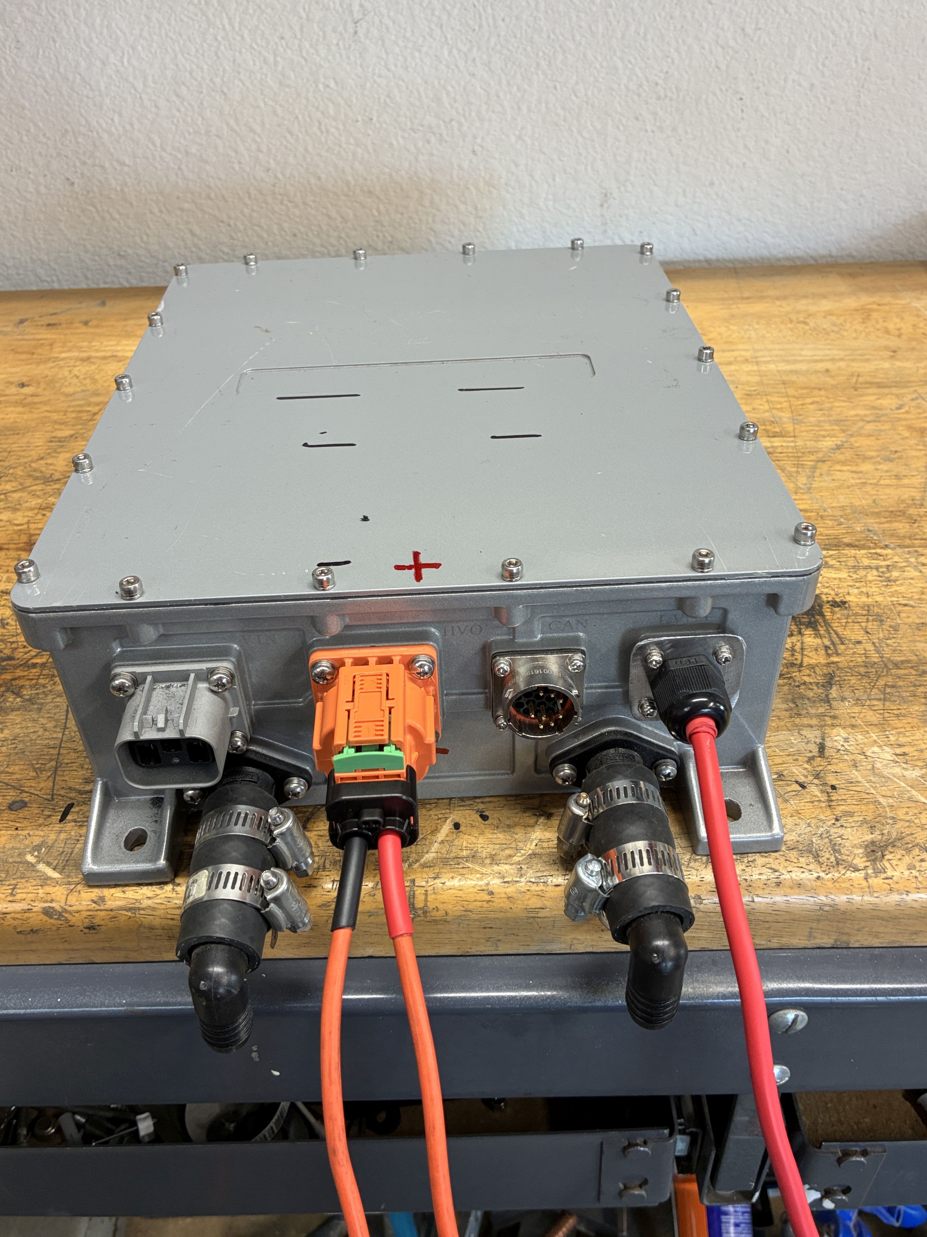

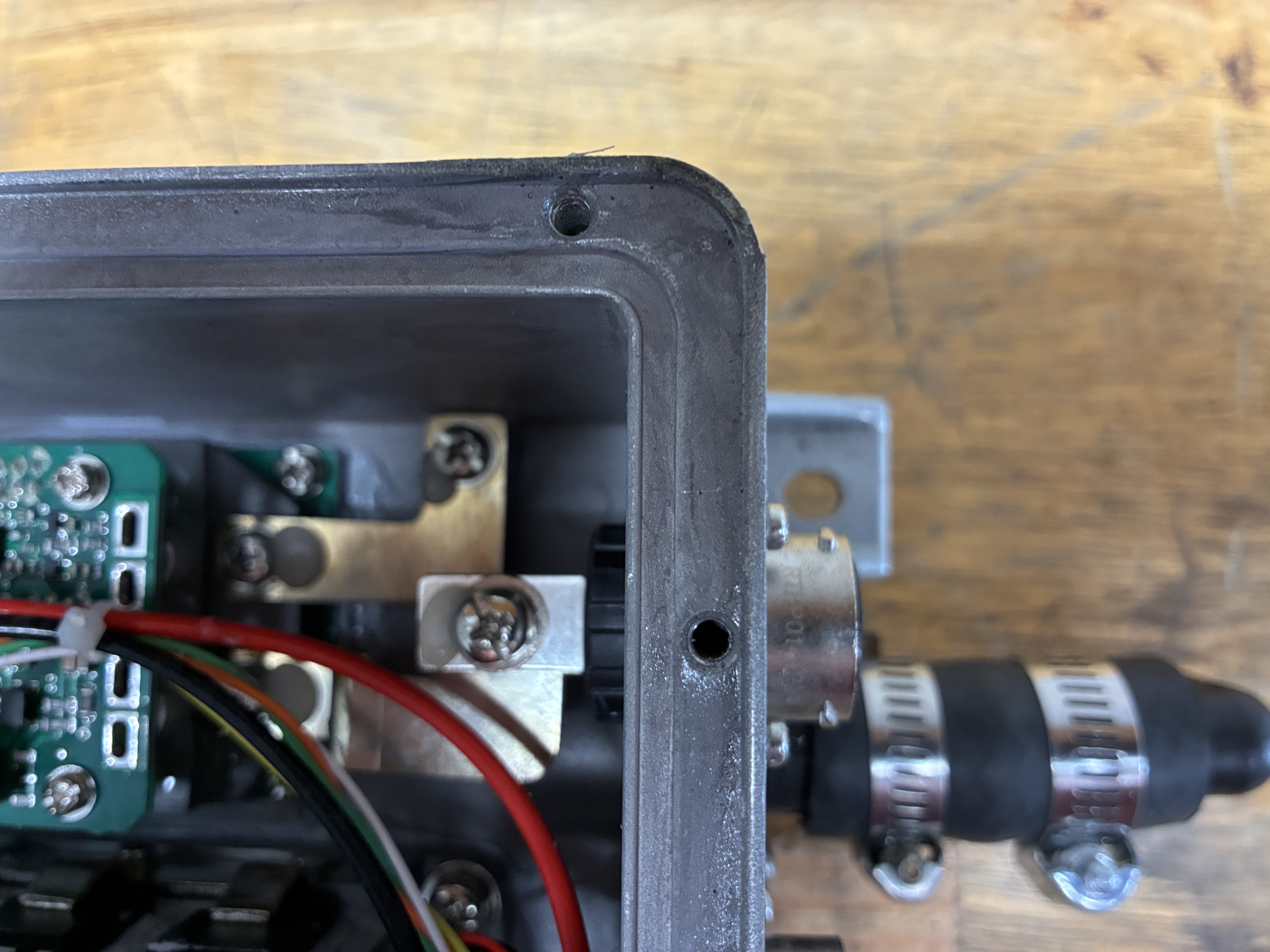

then I made the high voltage battery cable [more detail here: I just bought a Dilong aftermarket charger - Now What? ]
and checked for clerance

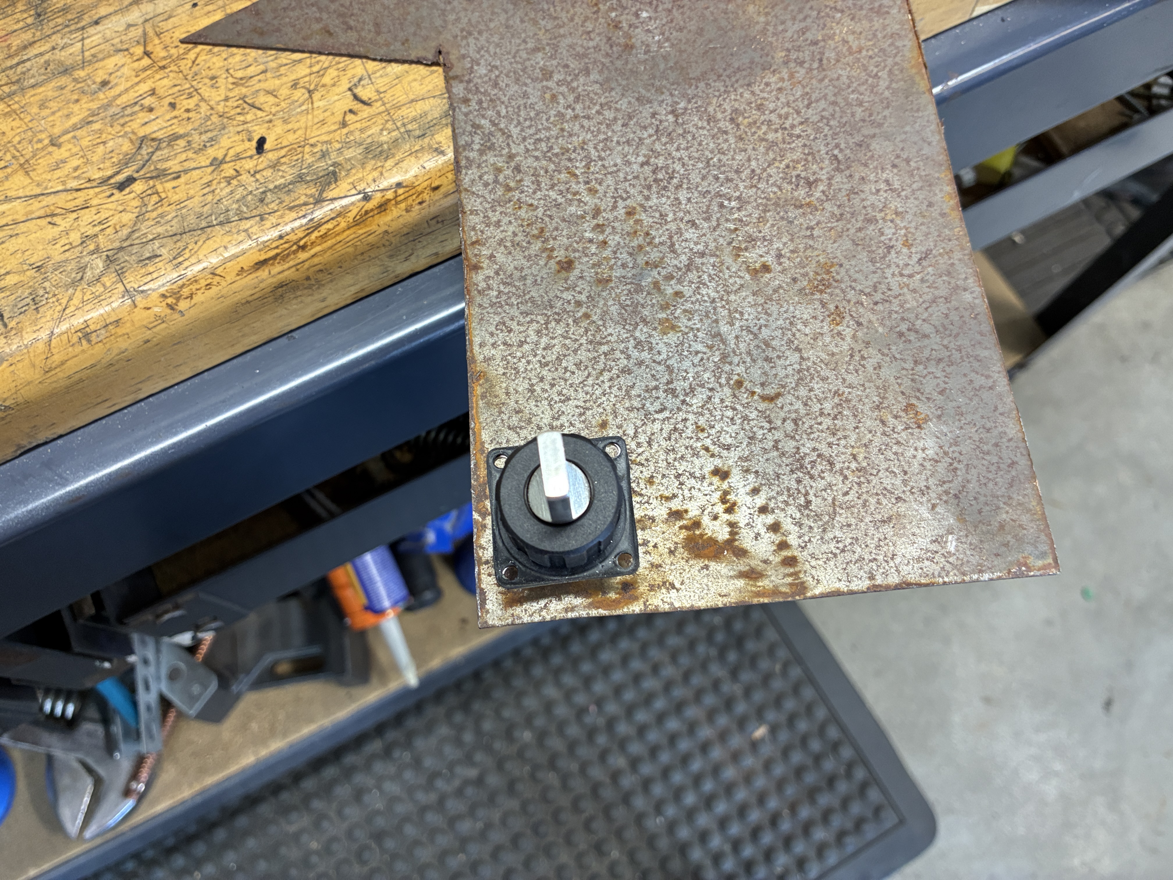

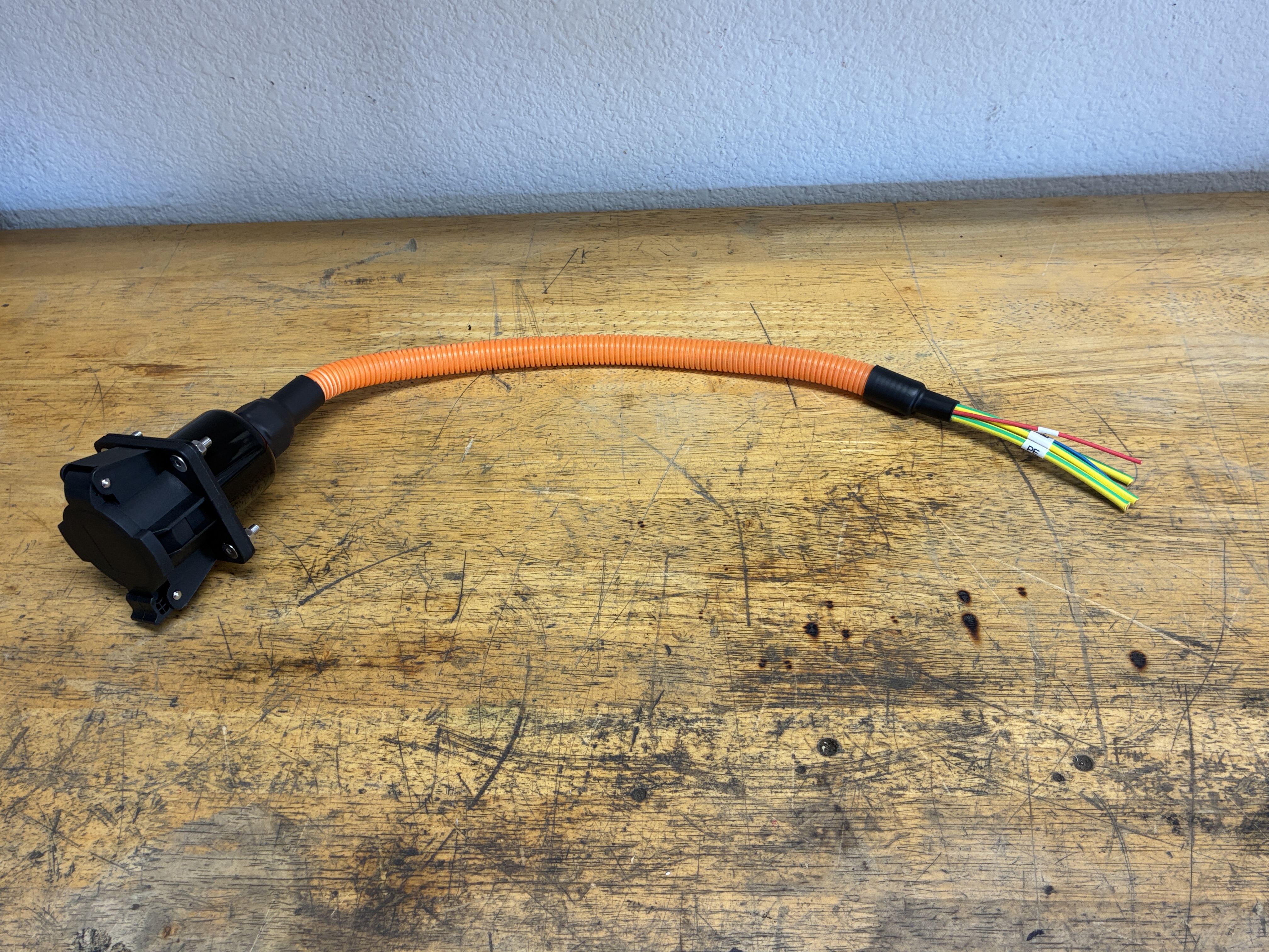

when searching for a charging receptacle I was surprised to find one at Walmart, so I had to order it
I don't think this could have come with a shorter tail
You do realise that every Nissan Leaf in the scrap yard has that connector. Also if you go for the 2011 model the cable goes all the way to the boot (trunk for those across the pond)Gregski wrote: ↑Tue Apr 28, 2026 3:43 am when searching for a charging receptacle I was surprised to find one at Walmart, so I had to order it
are we talking about the same thing? I was thinking of that dreaded 15 piece low voltage DC single wire chrome connector?
oh and that Leaf charge receptacle has leads even shorter than the Walmart one
