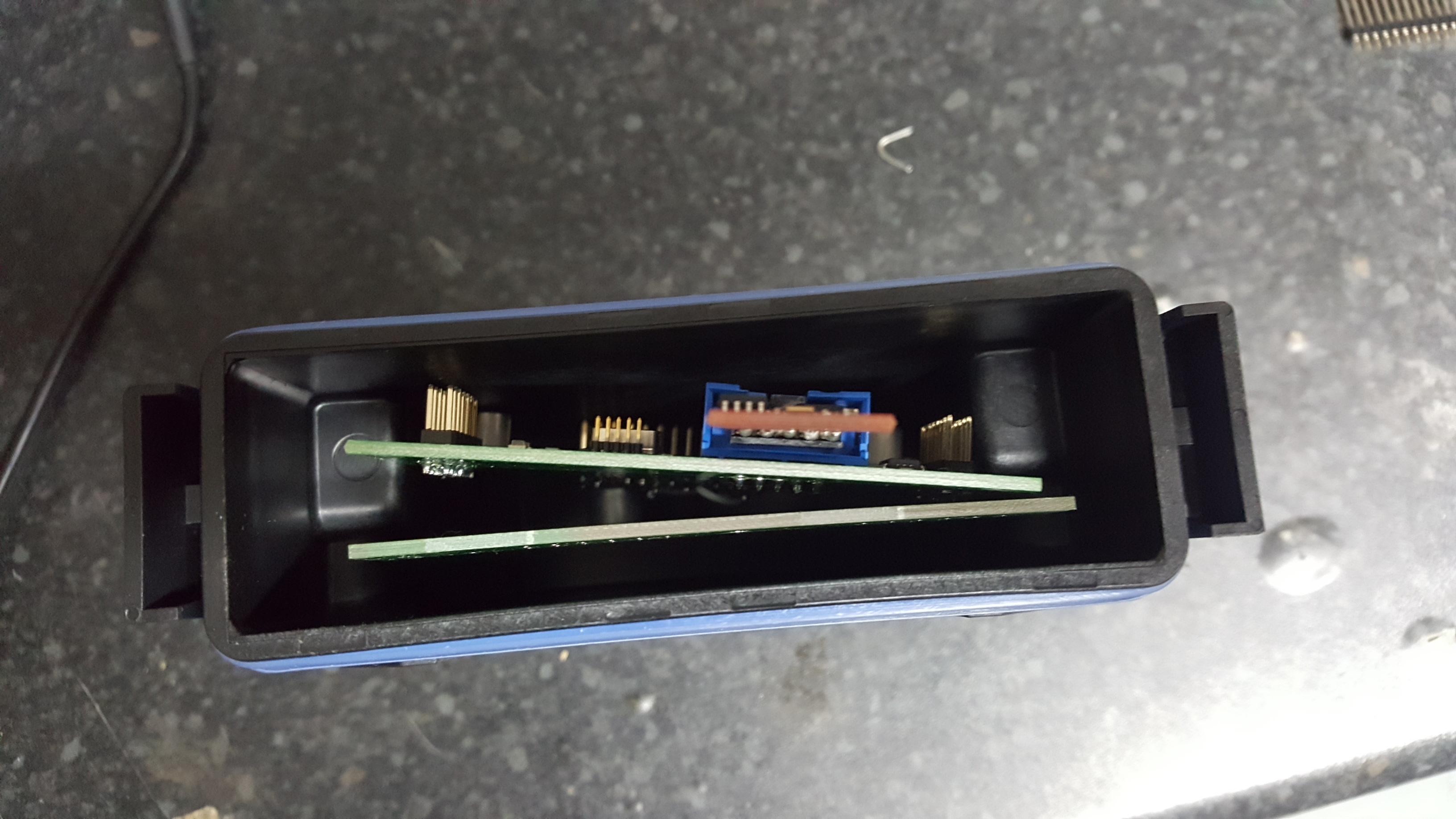

I'll have to check whether adapter + V3 mainboard fit in a ModICE enclosure. I would use the 20+20 version and loose 6 of the 26 controller pins. 12V/GND come from the inverter, emcy_stop, mprot, and 2 outputs will be dropped.

I have a few modice enclosures here. I'll do a quick test and see if a v3 mainboard will fit on top of a lexus vcu board:)
Posts: 3666
Has thanked: 12 times
Been thanked: 351 times
Mainboard about 2mm too wide to fit an me mx enclosure :(

Jack Bauer wrote: Sat Apr 18, 2020 10:19 am Mainboard about 2mm too wide to fit an me mx enclosure :(
ok, so either I shrink the main board by 2mm, or find another enclosure, or reconsider putting it inside the inverter. Thanks for checking, anyway!

So I guess the democratic vote for "outside" is pretty obvious. I consider redesigning the main board to be 2mm narrower. I might use a lower speced 5V regulator to save board space. It only supplies the logic anyway and we have seen even the 3A version has issues supplying the gate drivers when they have to do heavy duty.

johu wrote: Mon Apr 20, 2020 1:48 pm I consider redesigning the main board to be 2mm narrower.
