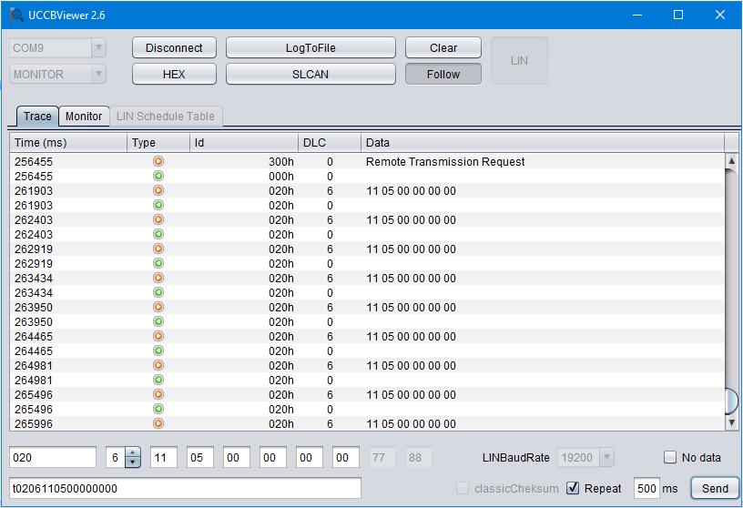

BRalf
Posts: 4
Joined: Wed Dec 17, 2025 6:16 am
Re: VW A/C Compressor
Post by BRalf »

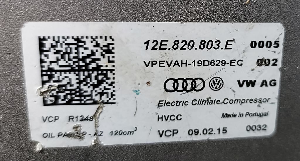

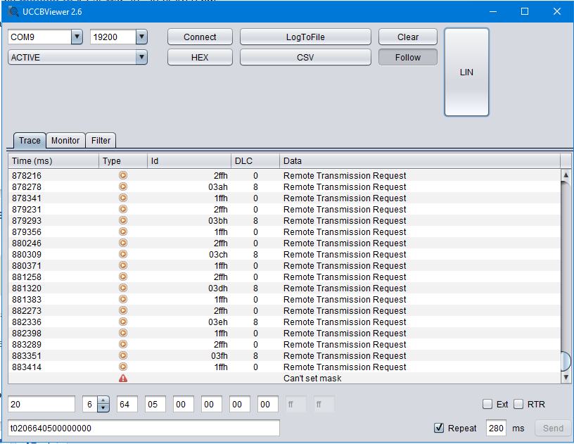

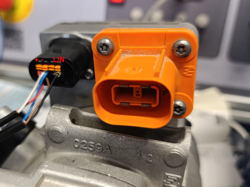

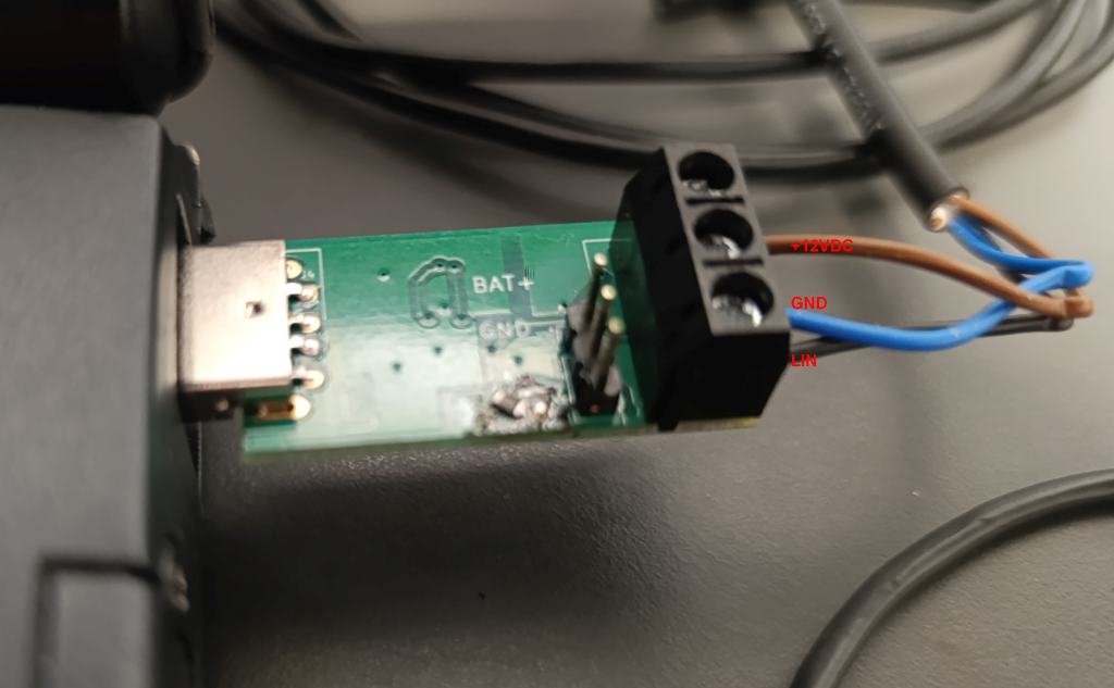

Hello,
I've been trying to establish LIN communication with 12E820803E for several days now, without success.
I see that many people have succeeded.
I showed how I do it in the photos, but I must have missed something. Does anyone know why I'm not getting a response from the compressor?
thank you in advance for your help.
manny
Posts: 196
Location: Netherlands
Has thanked: 58 times
Been thanked: 159 times

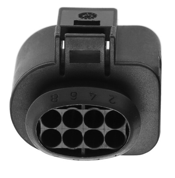

Post by manny »
If I see it correctly you have GND connected to pin 6 and not pin 5 as per the wiki.
https://openinverter.org/wiki/VW_A/C_Co ... ite_note-4
8= +12V , 5= GND, 2= LIN

BRalf
Posts: 4
Post by BRalf »

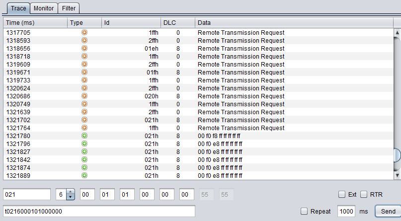

Thank you manny.
Now i have reply from compressor, but from id 0x21.
response follows request for response.
I can't construct a frame to make the compressor respond manually, maybe it needs to be woken up earlier.
I see that my compressor is not a typical model.
Has anyone had experience with this version?
BRalf
Posts: 4
Post by BRalf »
Good morning,
The compressor is already running (I had to enable MONITOR mode in the program).
However, I'm not getting a response from the compressor.
The compressor stops after about 3 seconds. (I have the input port plugged and the output port open, but the compressor doesn't seem to know this).
What could be wrong?
