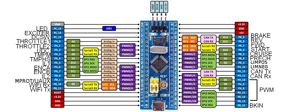

how are PWM outputs used on Gen2. The way it looks from schematic the HIGH side is commanded by active signal to NPN transistors pulling LOW gate signals on Prius driver board. Is that correct?
Now what happens to the LOW side signals? This means that if there is no other signal the LOW side is active all the time? Quite ingenious since that would eliminate shootthrough.
I need that info to prepare my version of Rev2 board...

Yes that's how the GEN2 inverter works, we only need to control the 3 high side switches in the inverter. To turn on the high side switch we pull the input low, when we release the input the high side switch will turn off and the complementary low side switch will turn on automatically. The logic inside the gen2 inverter takes care of the deadband between the high and low side switches etc..
So with the GEN2 the blue pill will only output the 3 high side PWMs.

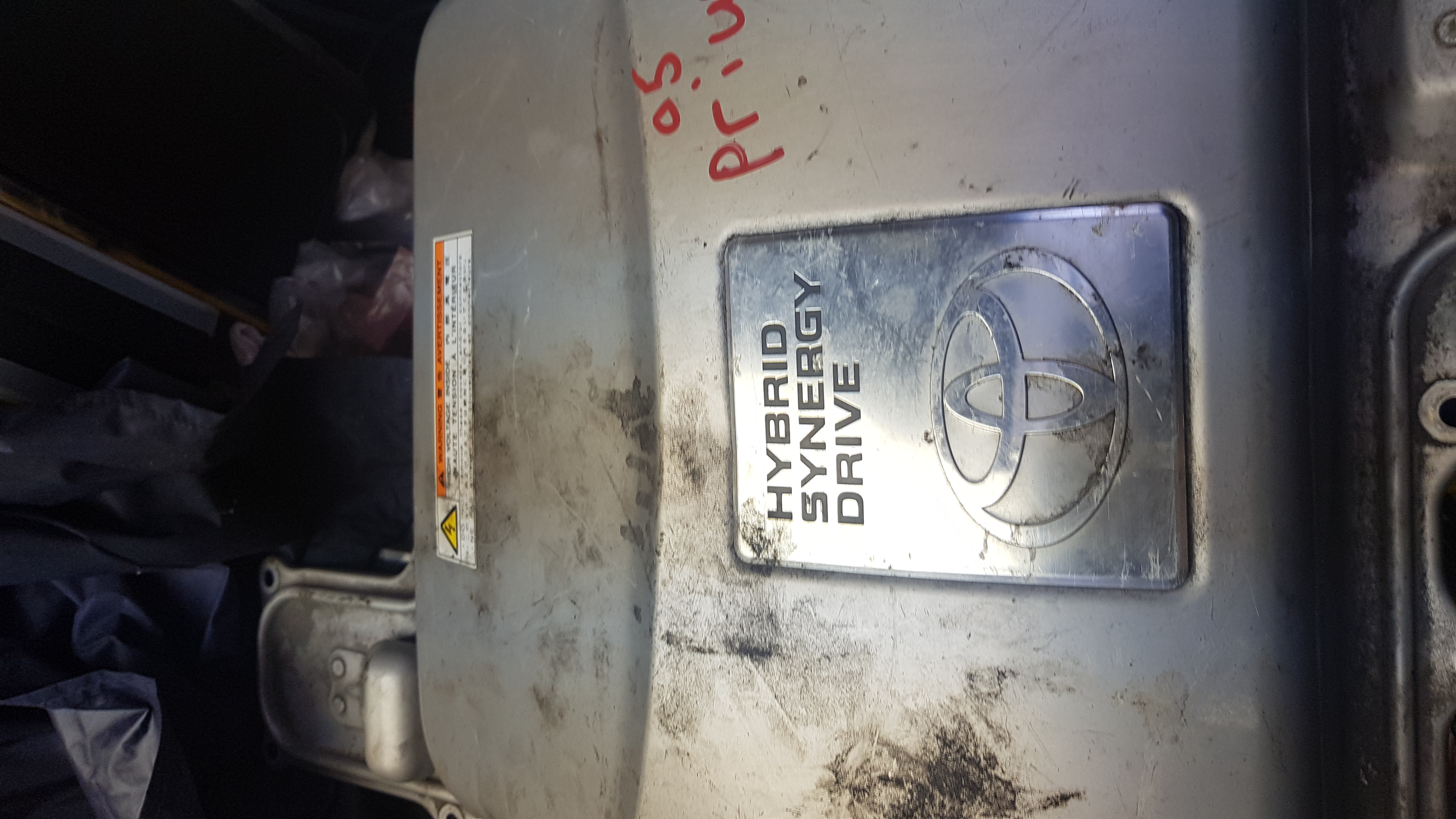

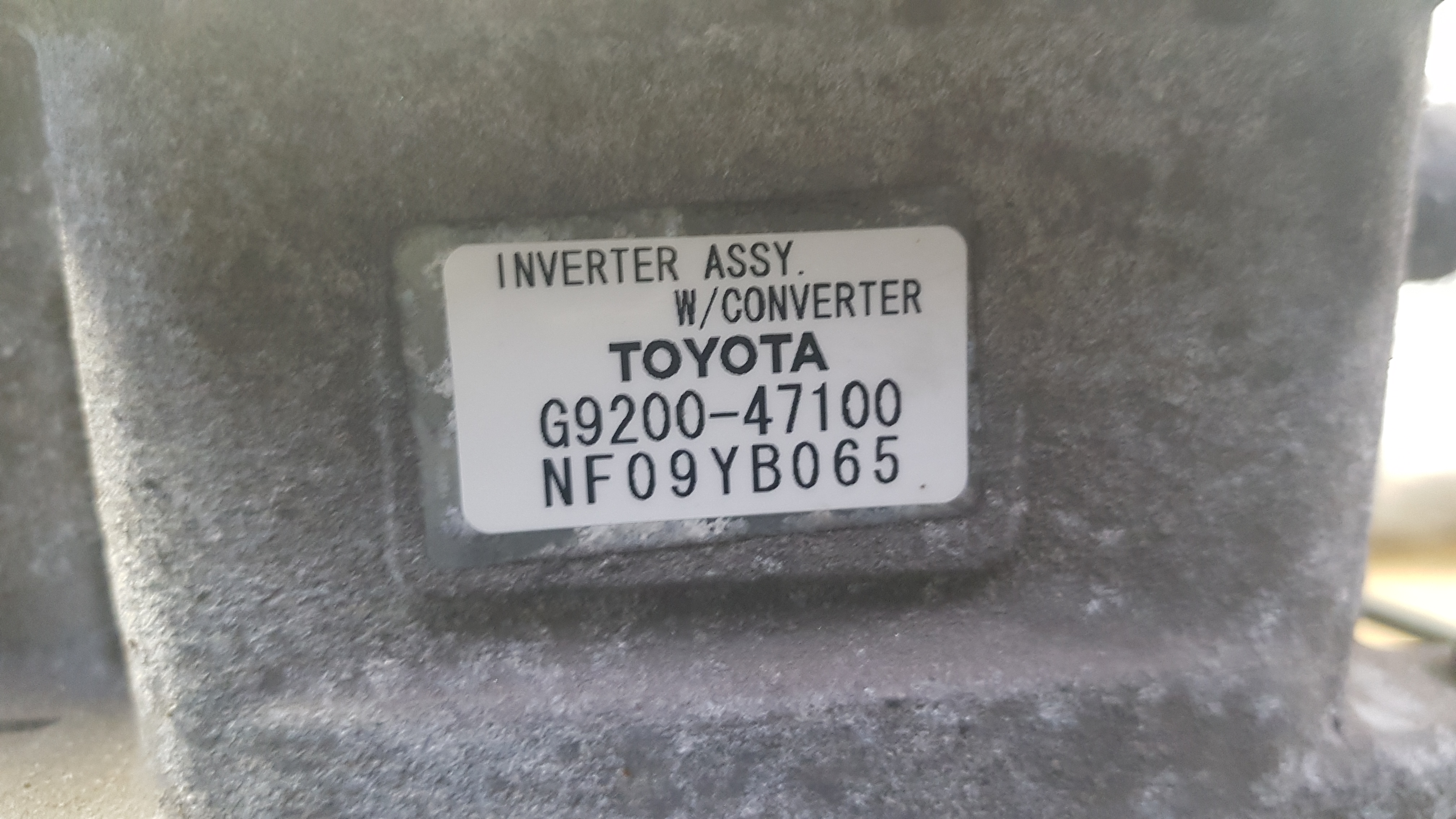

in the picture is 1st generation. Need an inverter 2 generation

I was under the impression that anything bearing the 'Hybrid Synergy Drive' badge was Gen-2.

MattsAwesomeStuff wrote: Sat Jan 25, 2020 11:15 am Other than being powered, I can't tell that the Blue Pill is in any way operational. I do not have a UART-anything other than the D1 which I connect to over wifi.
You mention you connected via serial and it responded to commands. Are there any commands that can indicate to me that it received them?
Thanks for your help.
Glad you got it working.
As you have discovered when the firmware is correctly flashed the onboard led flashes on and off at 100ms intervals. Once you get to that point you can test the serial communications using the "get" and "set" commands as outlined in the "Parameter" section of the main openinverter.org page or https://openinverter.org/wiki/Schematic ... structions using a USB -> TTL adaptor making sure you set the communications parameters correctly to 115200 8N2, note the 2 stop bits. It is possible to use the D1 mini as a serial console via the arduino IDE but I guess if all goes as it should it is an unnecessary step.
