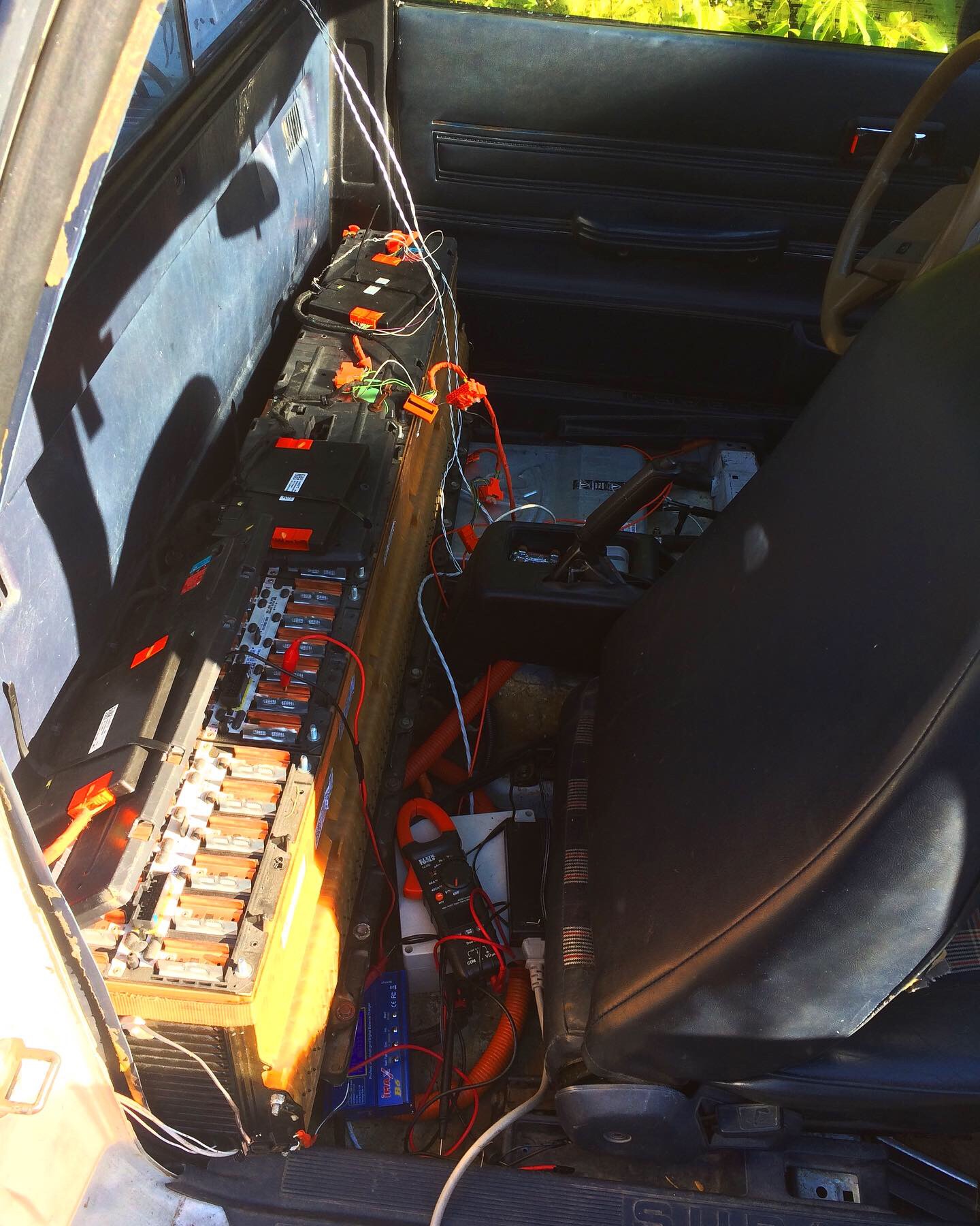

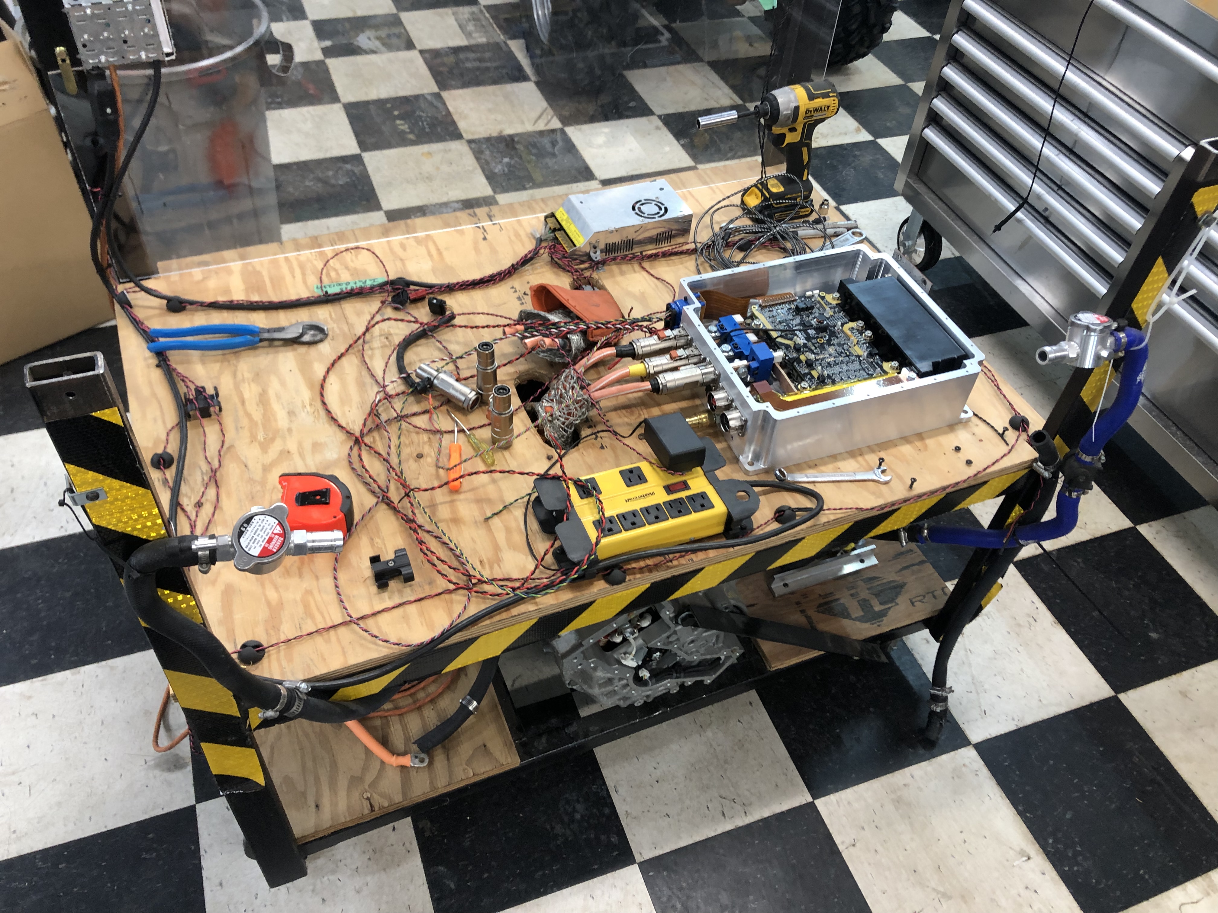

okay spent the last 24H at a budys place bringing up some of the low cells with my sky rc hobbie charger. my delta from highest to lowest cell is now about 140mv, down from about 220mv when at 80% or so.
the hobbie charger only outputs 5amps, so its sloooooow.
im currently charging up to as full as i can (highest cell to 4.2) and this is my road trip for the next 3-4 days as i chase some surf on the cost of Vancouver island. not marked on the map, is a ghost town where ill have access to a 120v outlet overnight. from this point onwards to port renfrew, then lake cowichan, are tight, winedy paved(ish) logging roads.
not sure with my large cell delta ill be able to pull this off safely, shall see how the trip to the ghost town goes.

<20mv id say would be ideal.
anything more, and the divergence in state of charge grows quickly, like what i'm currently experiencing

What I saw on my Gen1 Volt packs was that once I brought the low cells up to the pack, they stayed pretty close. I thought I had killed them again when I got the pack super low and super cold, but was able to recover them. The Volt batteries in general seem rather resilient.

good to hear, iv been slowly pulling the pack back into balance, and yeah they seem to be holding just fine! quite amazed on how strong these packs are.P.S.Mangelsdorf wrote: ↑Tue Oct 25, 2022 4:04 pm What I saw on my Gen1 Volt packs was that once I brought the low cells up to the pack, they stayed pretty close. I thought I had killed them again when I got the pack super low and super cold, but was able to recover them. The Volt batteries in general seem rather resilient.

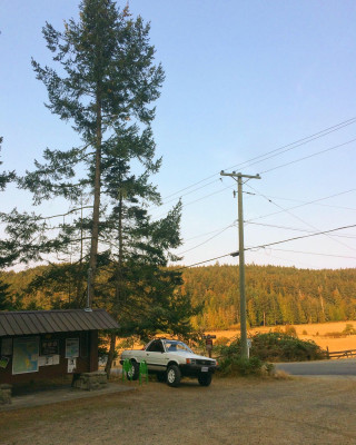

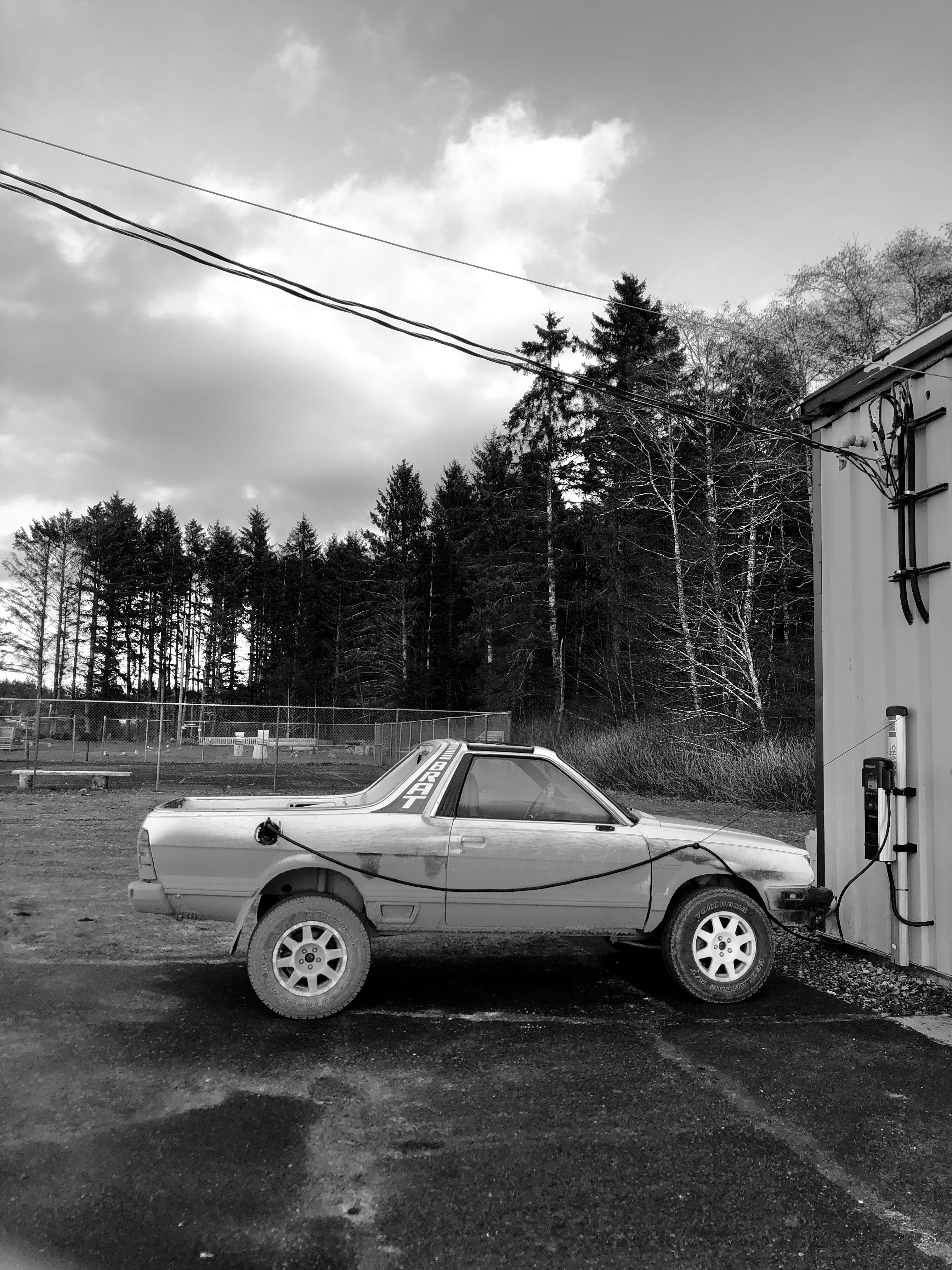

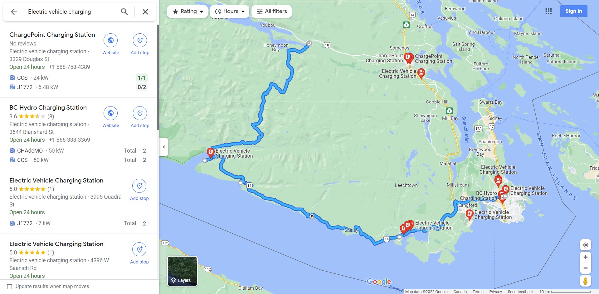

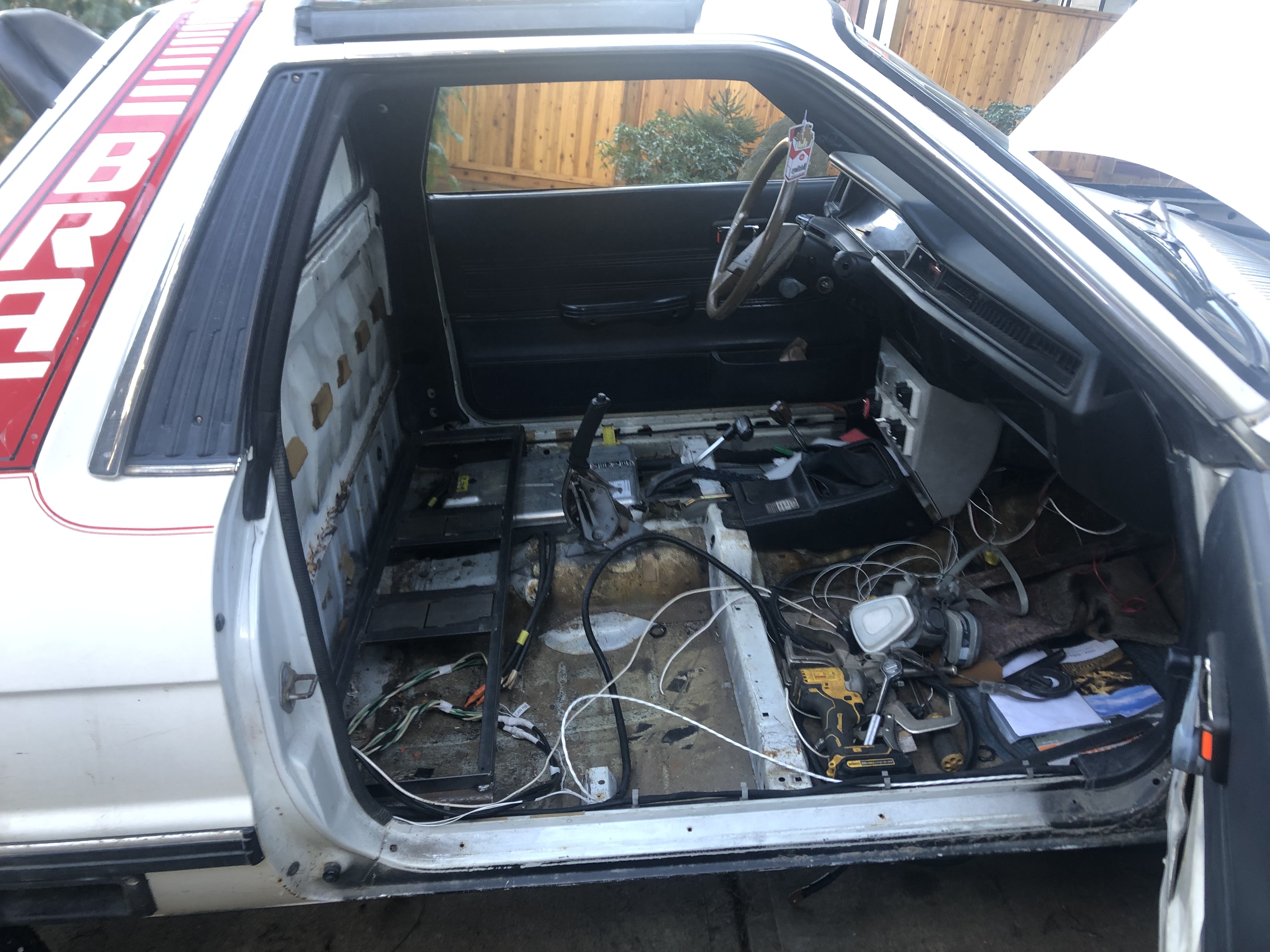

iv been doing a lot of remote driving, so heres some updates:
first trip along the map route went smooth. even with the high cell delta, the brat drove beautifully through the windy back roads. a few thing became very apparent:
-heat for window defog
-water pump controller
-slow charge rates
-some fender trimming
-adjust anti lift geometry(car lifts a lot under acceleration)
-need new axles
water pump gets hot running full blast when stationary, its a Bosch 0392022010.
throttle control via can would be ideal when inverter or charger temps reach a set point.

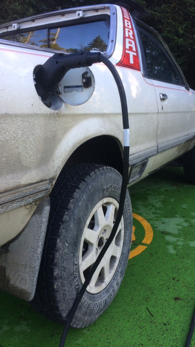

i had aclim set to the default 16 on the tesla charger. changed to 40, much better. my j1772 port has some millspec 50amp pins that match the original j1772 pins. meet some guys whom where happy to lend their drive way for some cell balancing befor departure! my entry for the Darwin award e-bike charger at a park entrance, stayed the night here and topped up!

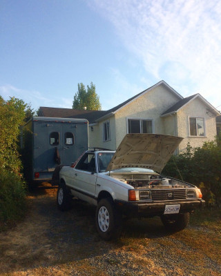

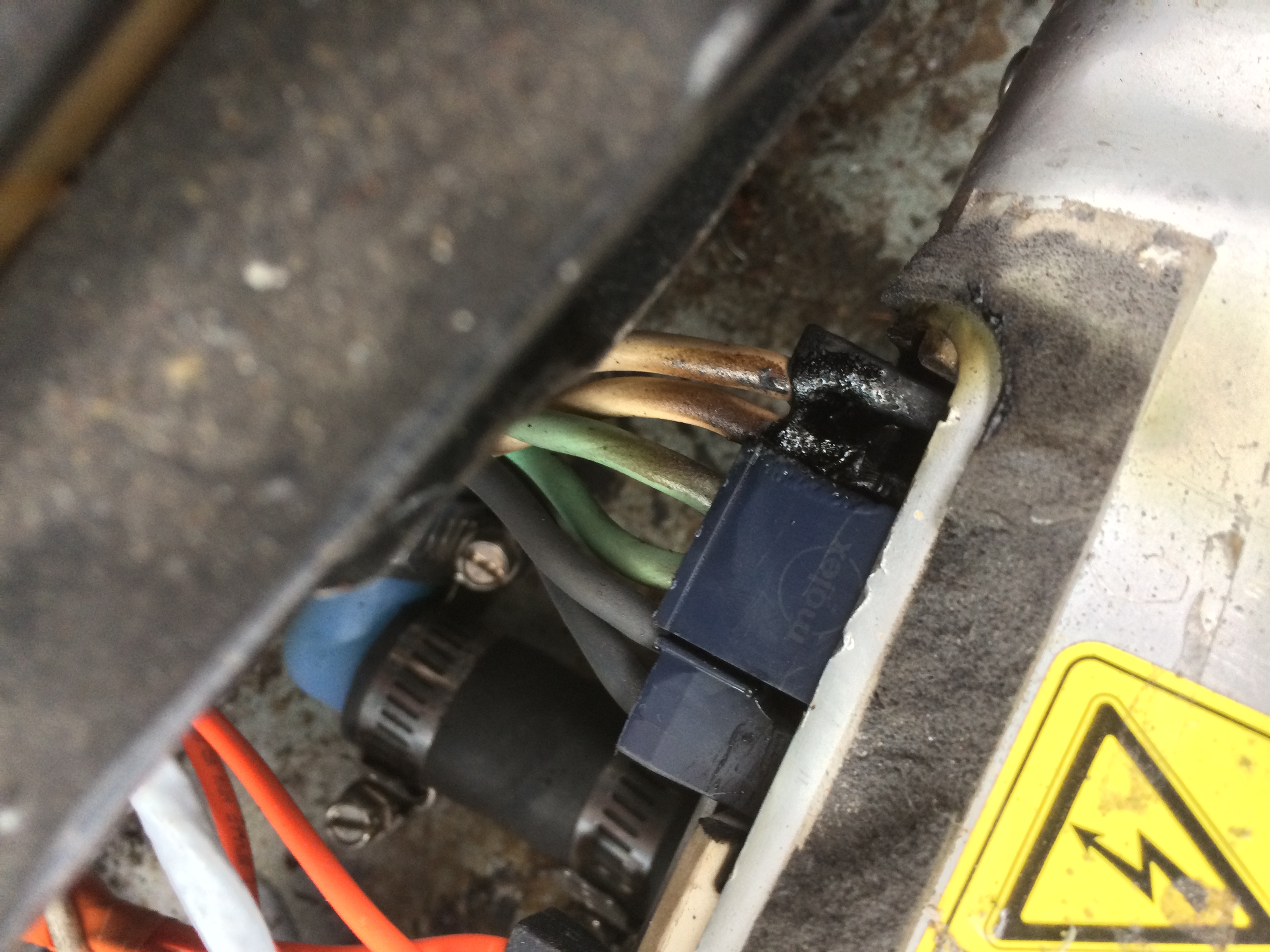

Few updates:
Had a bad crimp on one of the connectors on the ac side of the Tesla charger. Things got a little hot when charging at 40amps
lots of rough off road driving.

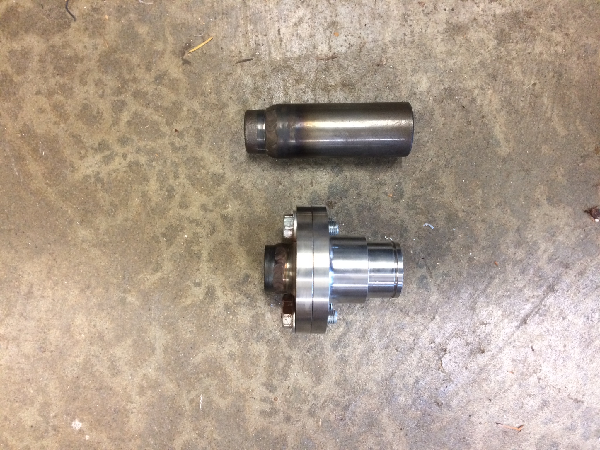

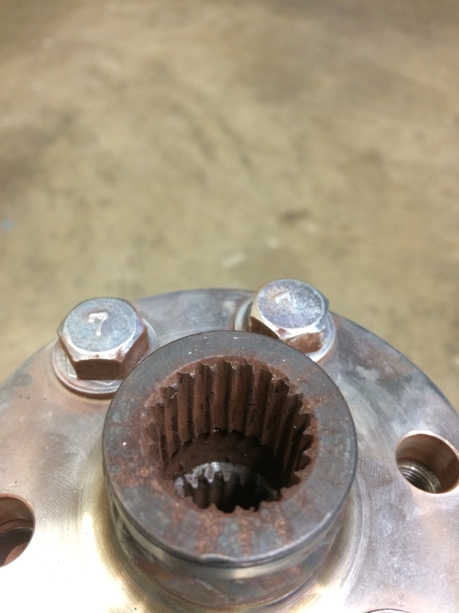

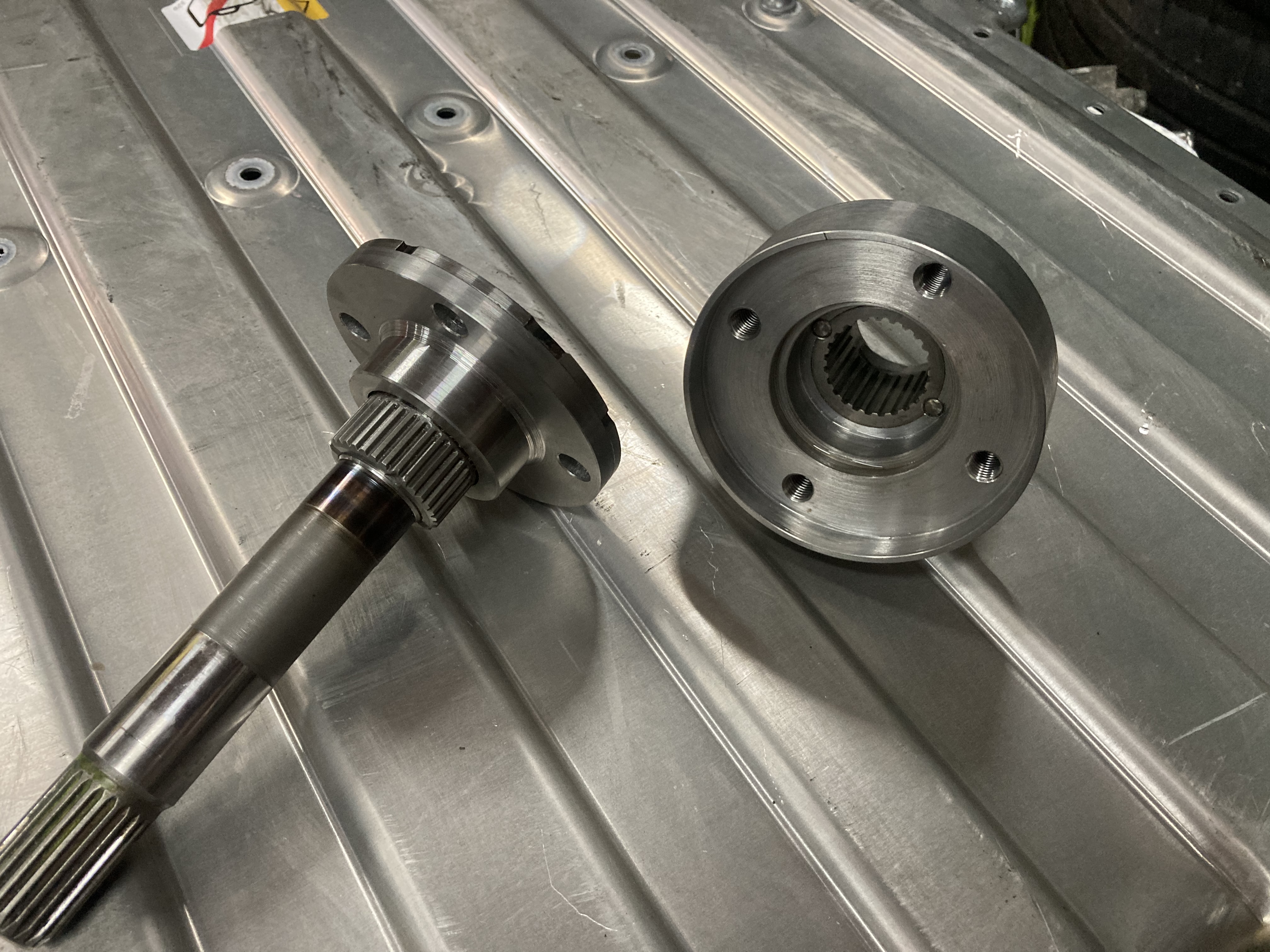

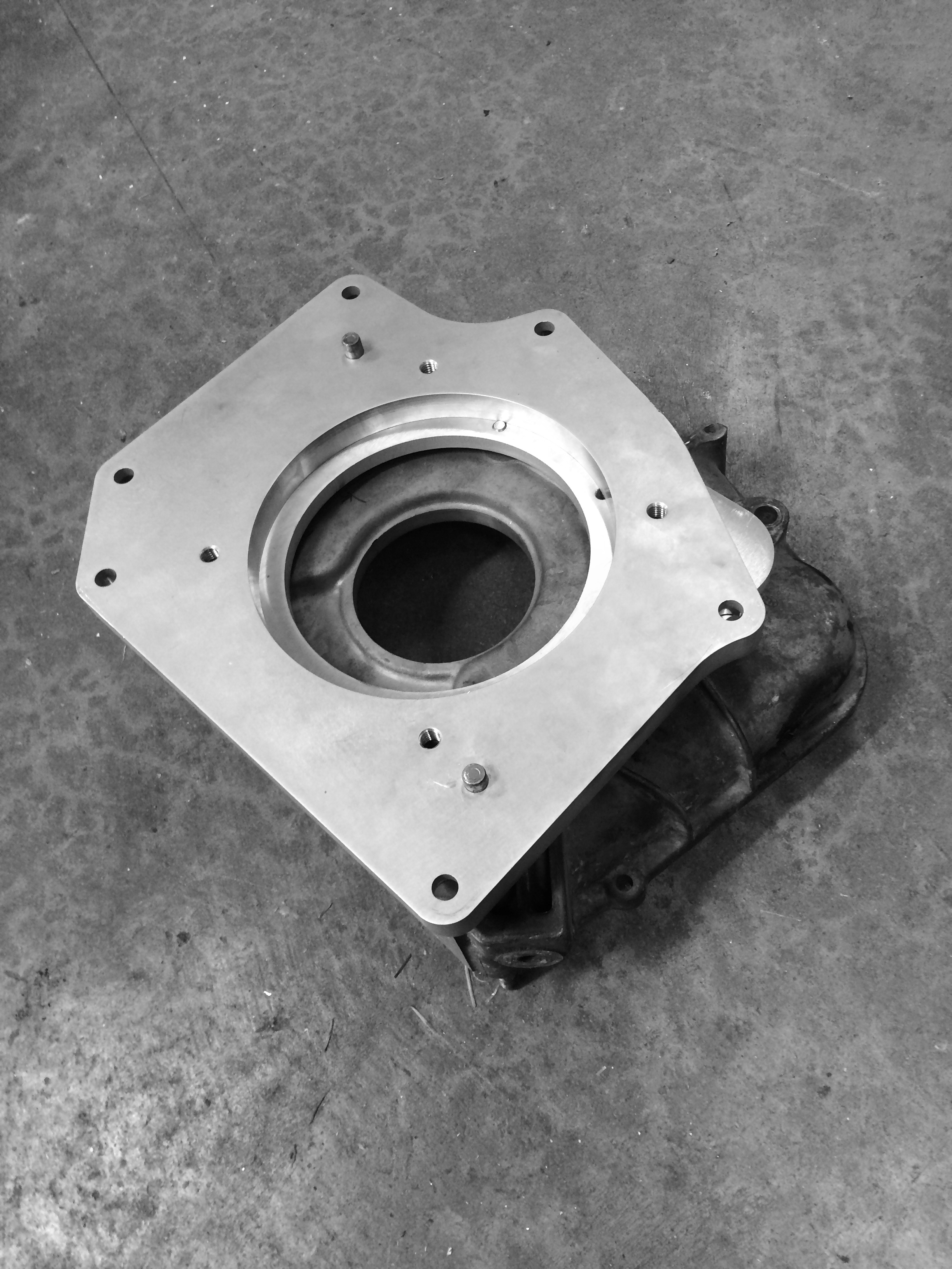

made v2 of coupler and adapter plate, test fit of adapter for a fellow vintage subi getting leaf swapped! v1 coupler clutch splines deformation
this was an aftermarket clutch. v2 coupler has a larger surface area of spline contact, and is a oem clutch center. so hopefully that helps
Leaf side splines look rock soild
looks like my real world range (mix of backroads driving) is about 80km. still don’t know the actual capacity of my 18kwh gen 2 volt pack.

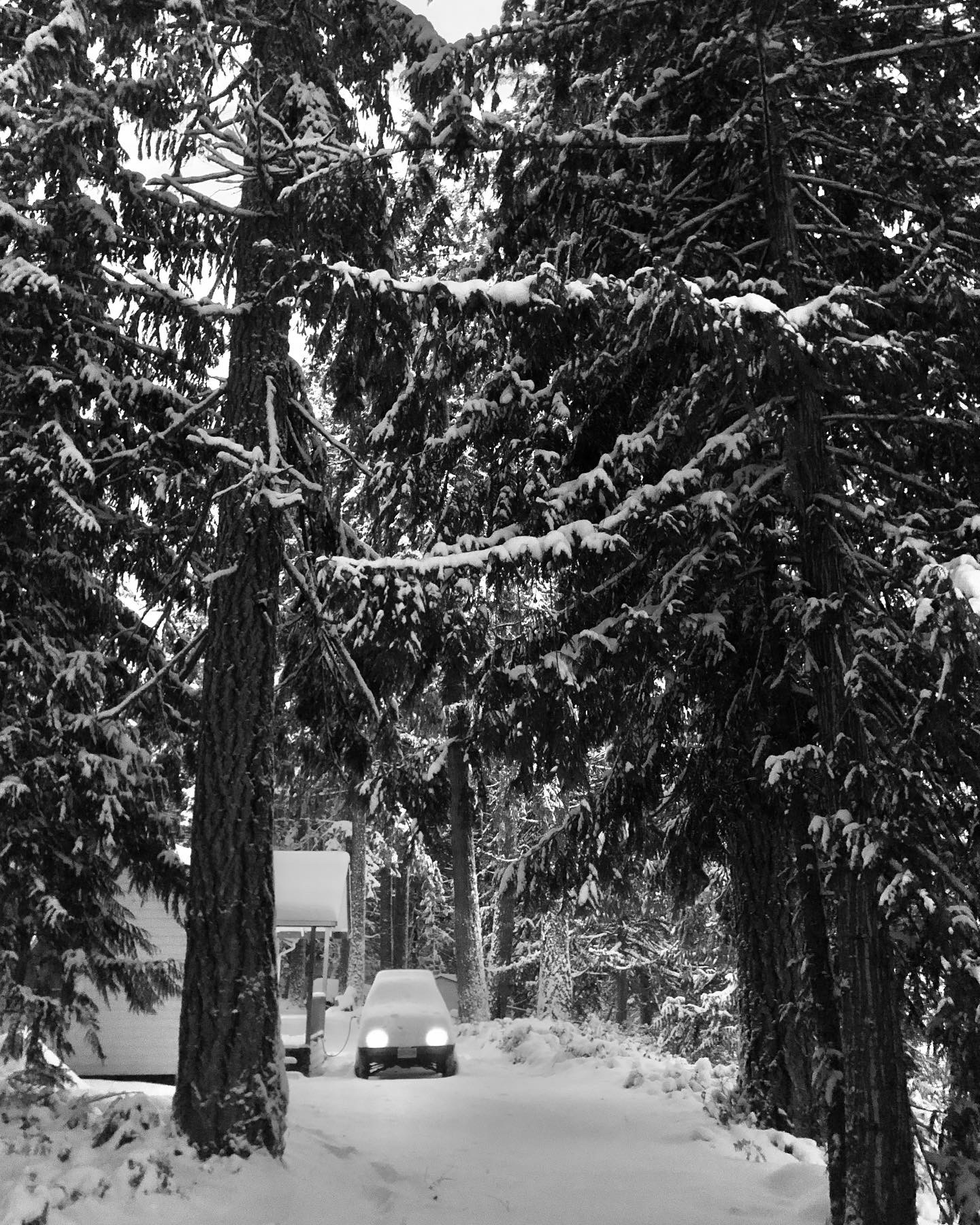

winter weather hit hard this week on Vancouver island. electric 4x4 in the snow is a lot of fun.
battery coolent is currently not connected, so no thermal management for the volt modules. im seeing a 20% reduction in range. this could be both road surface condition, and the fact the battery is just too cold!

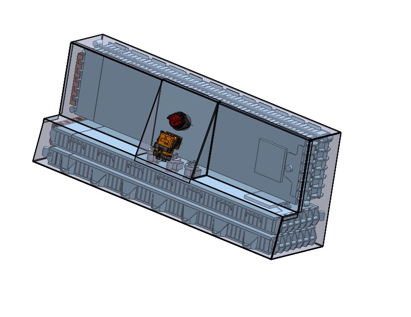

found a 55kw model 3 battery (short modules) for sale, looks like i can fit all 4 behind the seats. no more rear battery box, 2.5x capacity increase and about the same weight. wild!
mocking up a battery box.
but got so cold (-10) that my coolent froze. i could not cool the tesla charger fast enough to fully charge!battery coolent is currently not connected, so no thermal management for the volt modules. im seeing a 20% reduction in range. this could be both road surface condition, and the fact the battery is just too cold!

Are you able to make parts with external splines also? At some point I’d love to replace my home engineered parts with something more professional and less bits fitted together! It may not be cost effective though what do you think?
Definitely not cost effective for one off, your parts looks well done! Cutting splines is not as strong as cold rolled ones, which those most likely are. And for one off that would be the way to do it

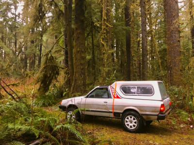

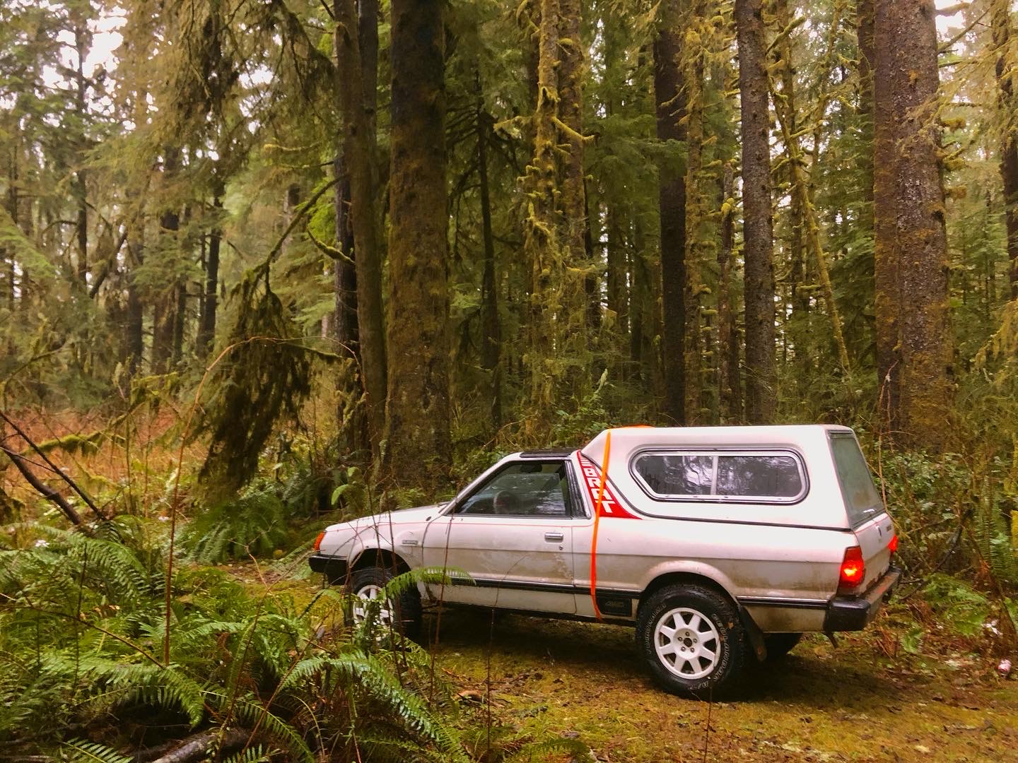

more shenanigans. Installed a rear auto locker, then proceeded to blow a front drive shaft…
Made my aero worse by putting the canopy on. But electric car camping is great. visited with arlin simon

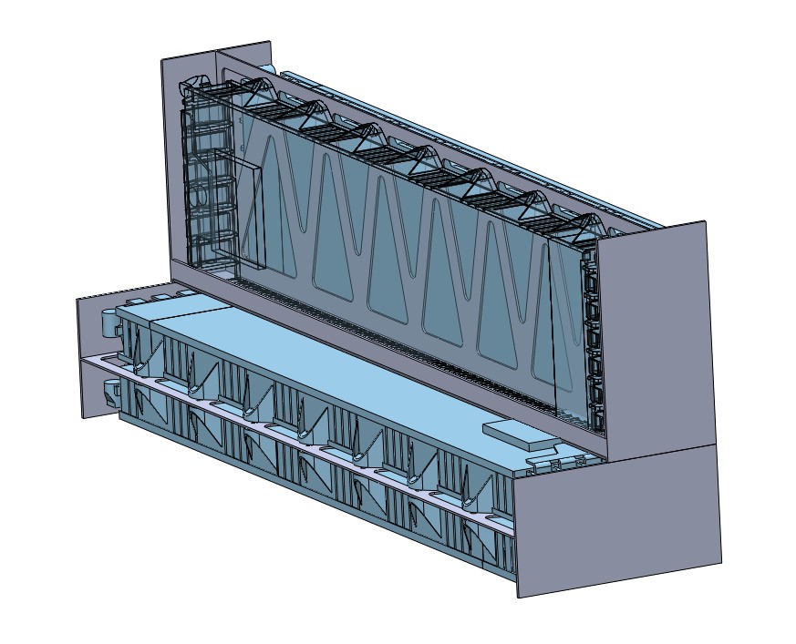

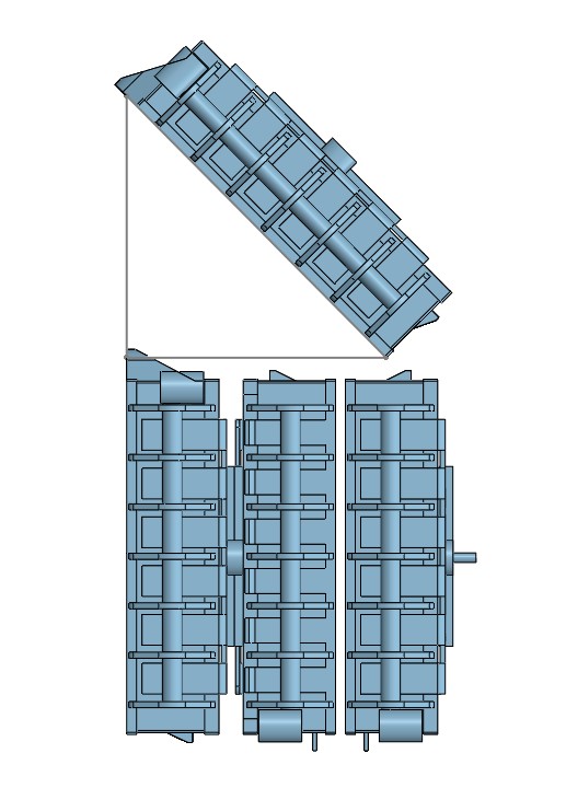

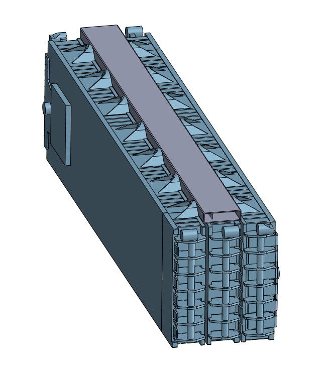

picked up the short M3 modules. got the pan aswell.
missing some coolant hoses sadly.
2 of the isospi connectors where torn off the slaves. but looks like there's pads to tap into on the board. may just repair the traces keep the connection OEM.
1 module weighs aprox 137 lbs. x4 = 548lbs for the 55kwh pack. my gen 2 volt pack is 480ish lbs. so full pack is a 68lbs weight increases. That’s impressive.
packaging and timeline pose a challenge. I have 4 weeks to get the new battery in and working befor i head up north with the brat.
trying to maintain the currently excellent center of gravity, by packaging the models behind the seats. looks very possible to fit all 4. the complexity comes in packaging. so im starting to think that for now, i may just use 3 of the 4. stacked vertically behind the seats. the pack would be 39kwh and 72s. 290v to 216v and weigh 60lb less. wild!
eventually would put the 4th module in. ether mount the 4th under the bed(or 2 under the bed!) or the 4th on top.
space vs weight vs center of gravity trade offs!
any one have any input on the lower pack voltage?

batteries fit nice, quite happy with how clean it is now.
a few cell taps have broken, so fixing those with a combination of magnets, conductive epoxy and silicon. "re potting" the back of the battery with silicon to fully seal it off and prevent any more cell tap breaks when moving the modules in place.

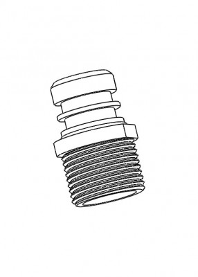

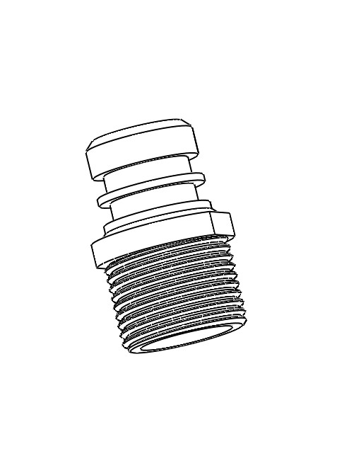

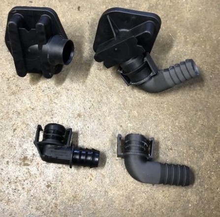

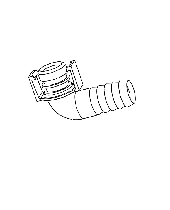

also didnt get all the coolant fittings when i got the modules, so iv started mocking out some replacements to make.
they seem to be a variation of a strange German part that's unobtanium. if theres interest maybe ill make a batch.
started with replacing the original part. with the barb fitting. im going to move to a threaded piece instead, this opens up different orientation options. and simpler to make. mock up prints came out great.
i would not recommend using a fdm for printing coolant fittings.

Do you want to print the final version of the fittings with SLS?
In my experience SLS prints are very porous, so they might start to leak. We had some good results with vacuum impregnation, but it's somewhat of a mess and takes some time and effort.

for a functional part I’d use MFJ potentially. Moving away from the right angle barb to a AN thread in aluminum. as it’s fairly simple on a late, and a better o-ring surface
- crasbe
- Posts: 295
- Location: Germany
- Has thanked: 47 times
- Been thanked: 150 times
Re: 1983 Subaru BRAT
MJF might have the same issue as SLS, it's both powder based. But I'm not sure.

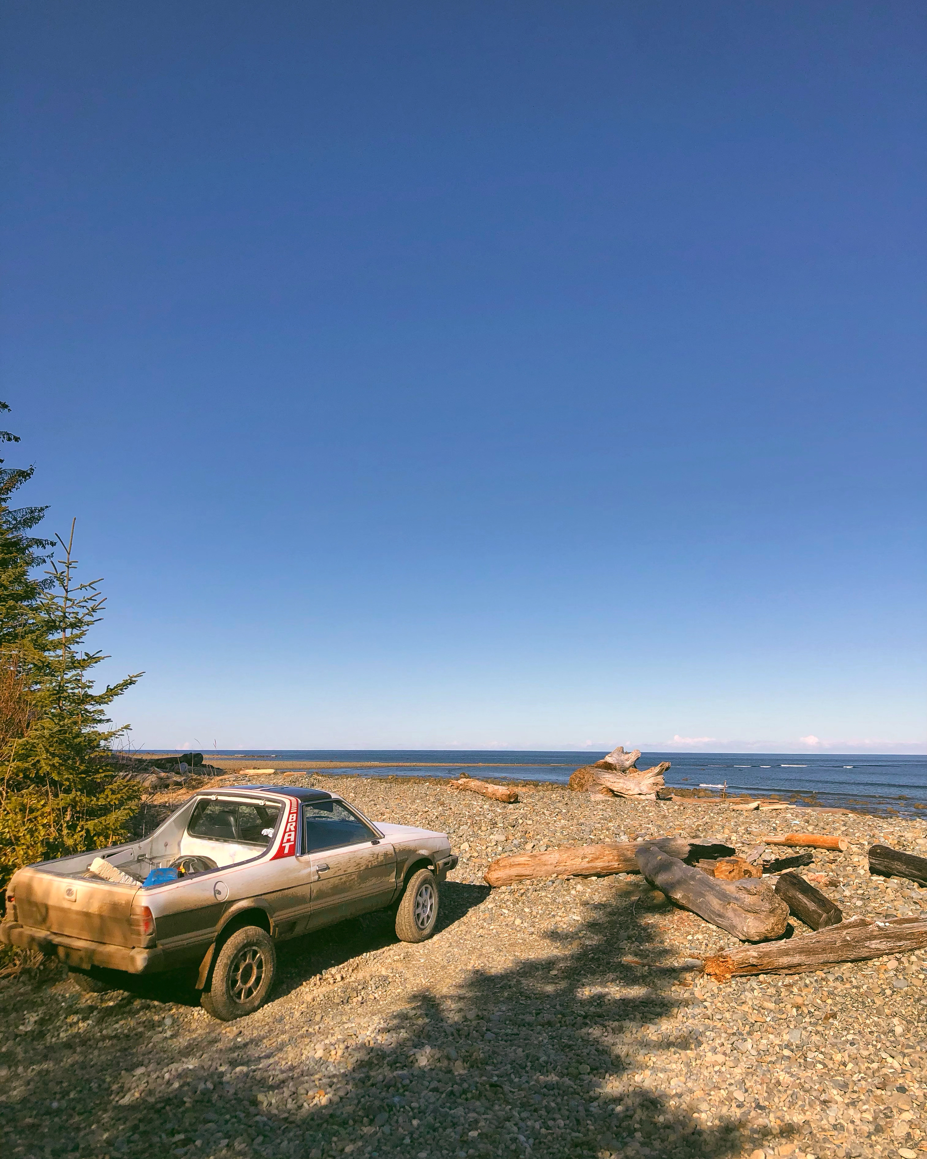

some beach driving!

Long time no updates. I’ve been in northern bc with the brat for the past 4months, no real updates on the ev system, it’s just trucking along…
Range is about 160km have maybe just over 20kwh usable currently.
electric 4x4 is amazing. Very capable. the throttle fidelity is unmatched, very easy to crawl up stuff… or down.
4wd regen is smooth, great rally machine.
I think electric rally is going to be huge. It’s prefect for it. The low end torque and throttle control is simply better.
Mud? No problem cobble stone beach? No problem. it’s impressive… that I’ve have not blown the gearbox yet. did blow a rear axle… but I believe that was from it getting over extended when the brat was getting air born on a hilly gravel road…
Thanks charge north for providing funding for charge station throughout northern bc, its made this much easier!
