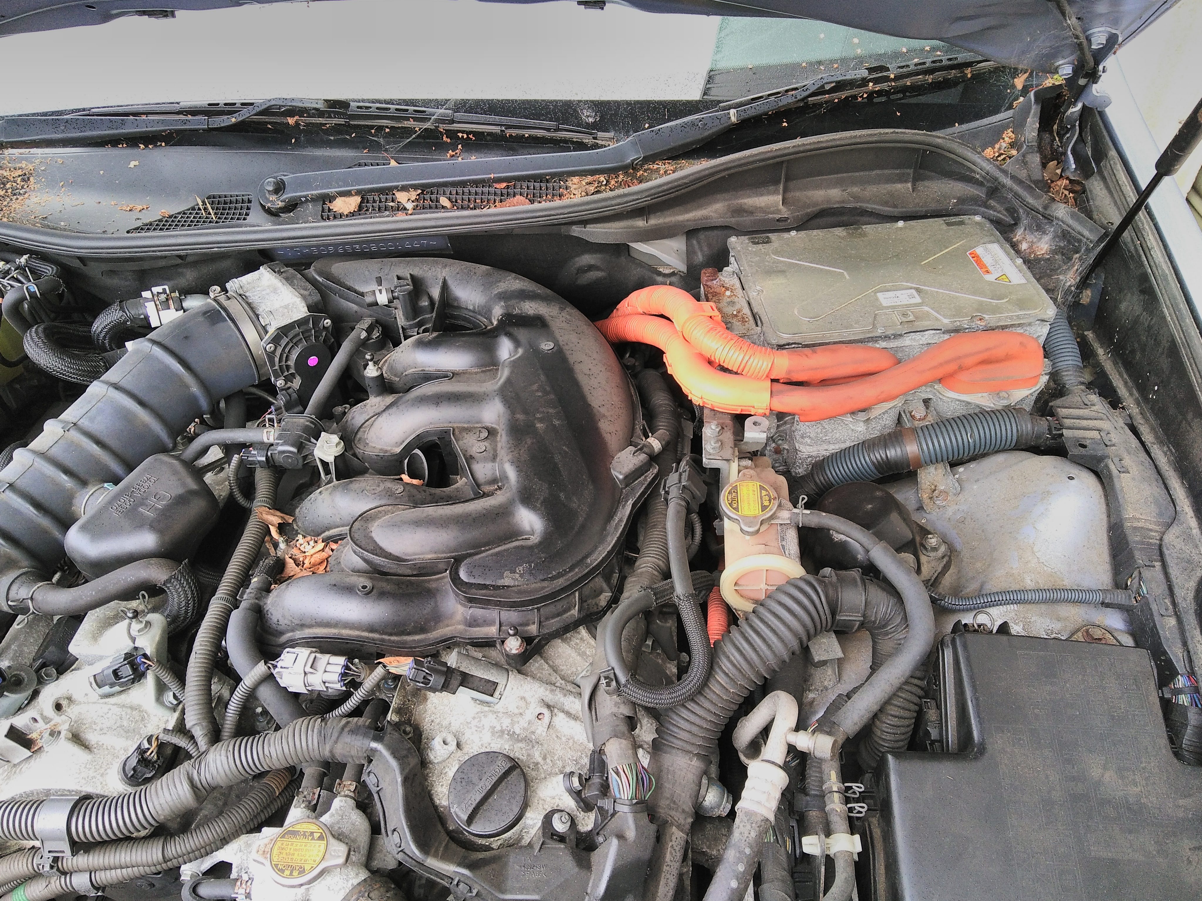

GS450H Discussion
wovenrovings
Posts: 17
Joined: Sun Sep 06, 2020 6:08 am
Location: Bundaberg Australia
Has thanked: 6 times
Re: GS450H Discussion
Post by wovenrovings »
Yes I saw that on the wiki but I don't think a GS350h actually exists.. so it might be a typo.
And I have searched everywhere but all I can see is a mention of Damien saying he will try one, one day. So was just hopeful that there was something I had missed.

Kevin Sharpe wrote: Sun Sep 06, 2020 10:11 am
wovenrovings wrote: Sun Sep 06, 2020 7:19 am There is a 2013 gs450h coming up for salvage auction near me. Has anyone here had a go at hacking the inverters in these?
Please read through the forum, wiki and review the SuperYacht ('BEXUS') project;
viewtopic.php?f=11&t=96
Edit: a search on the wiki says the G92A030020 is from a GS350H not a GS450H
2012+ GS is a different generation, with a different inverter.
No current work done on the control side of this. Likely same hardware as the Gen 1 GSh, but different data packets. Best to buy the whole car and pull the data yourself.

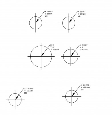

Oil pump flange on the transmission,
