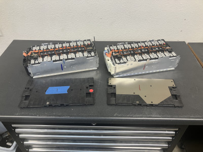

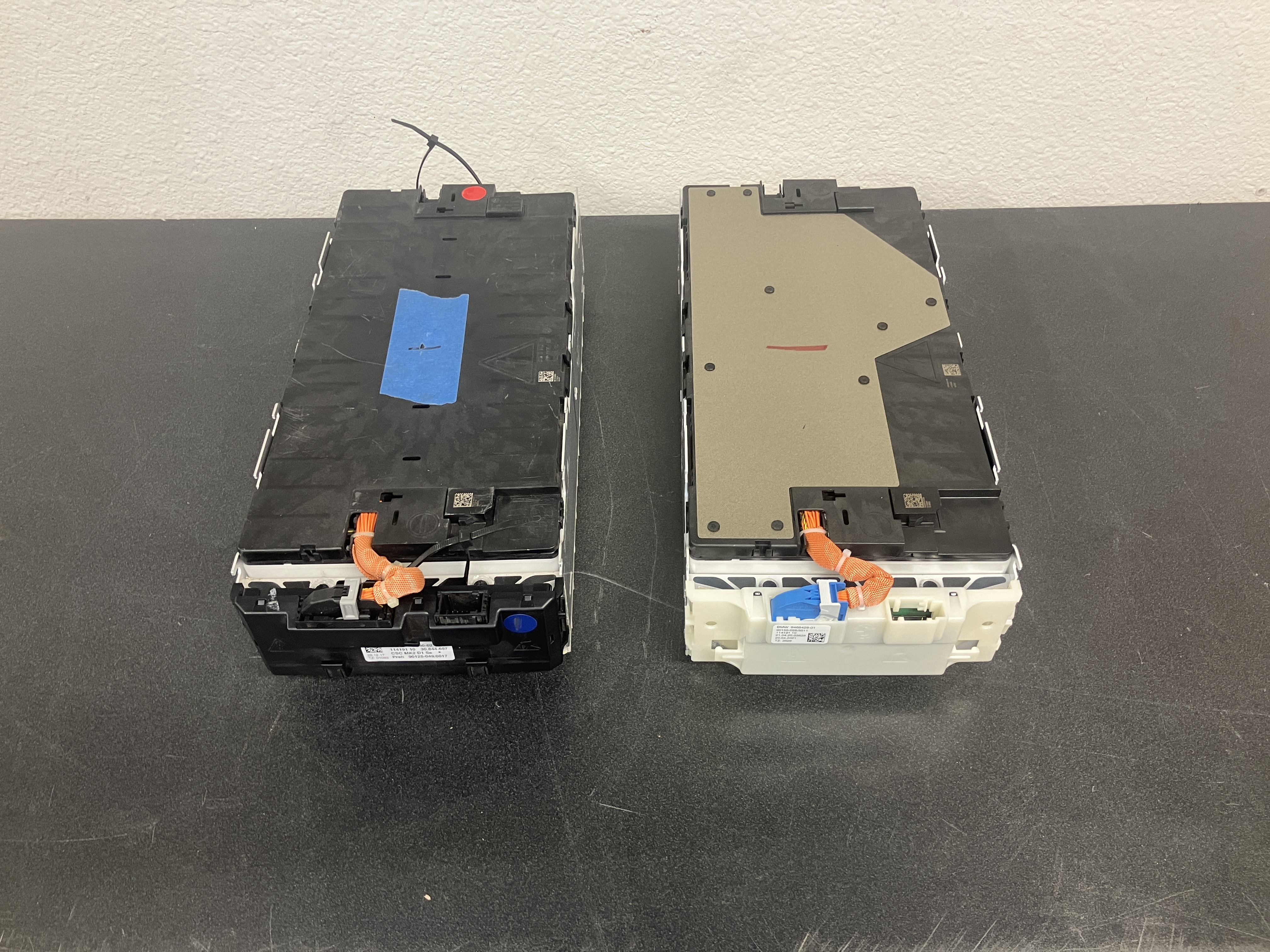

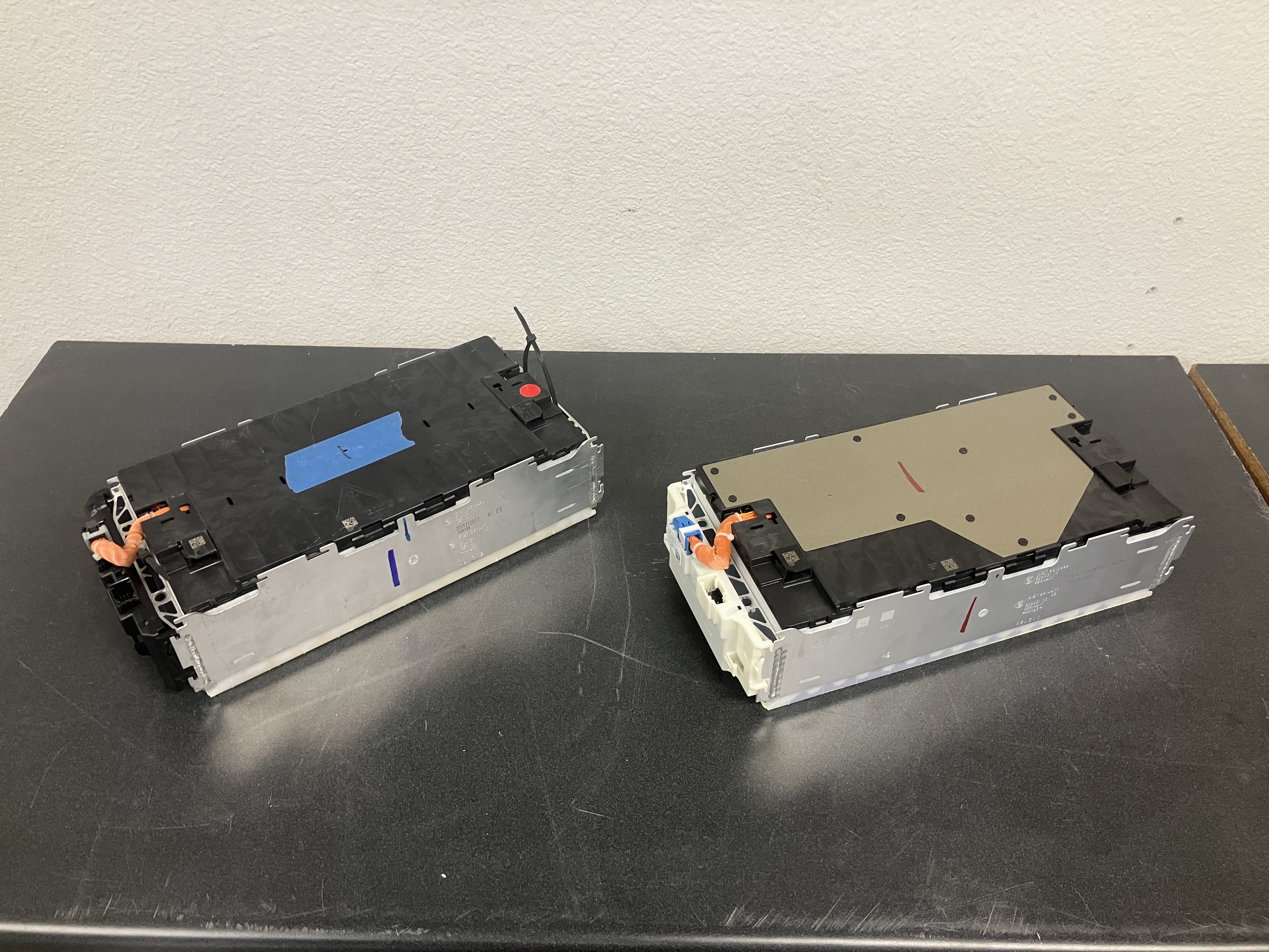

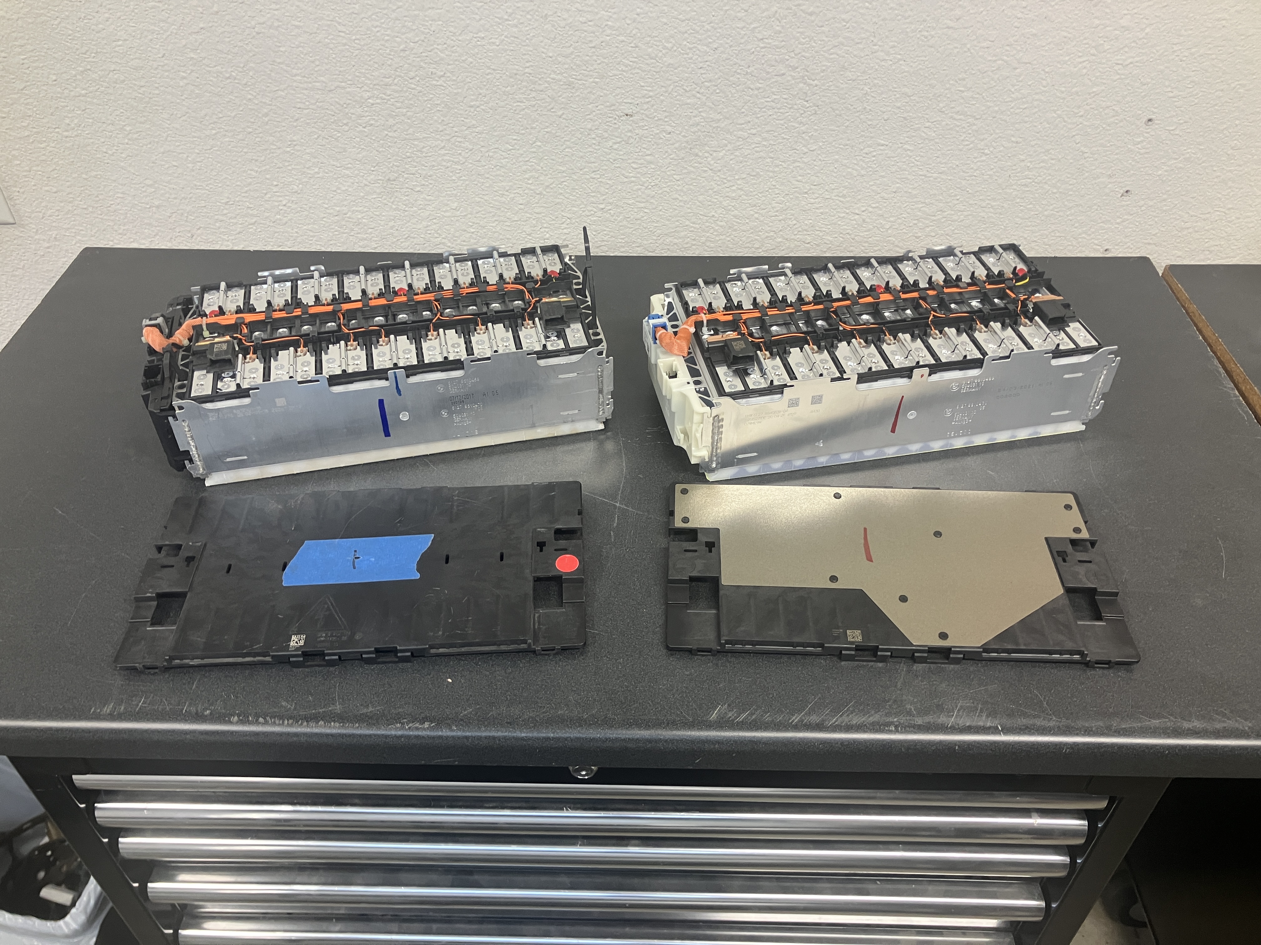

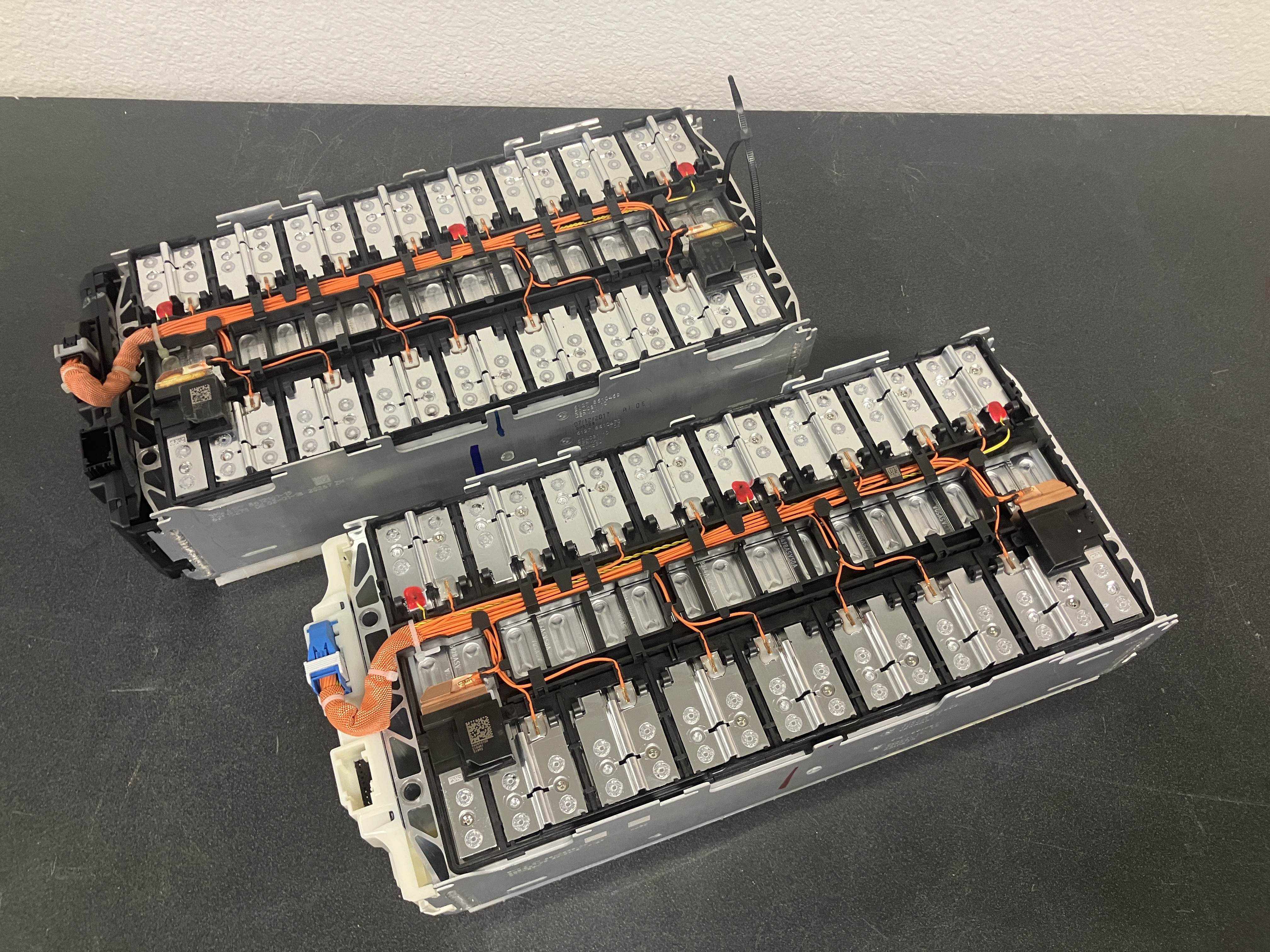

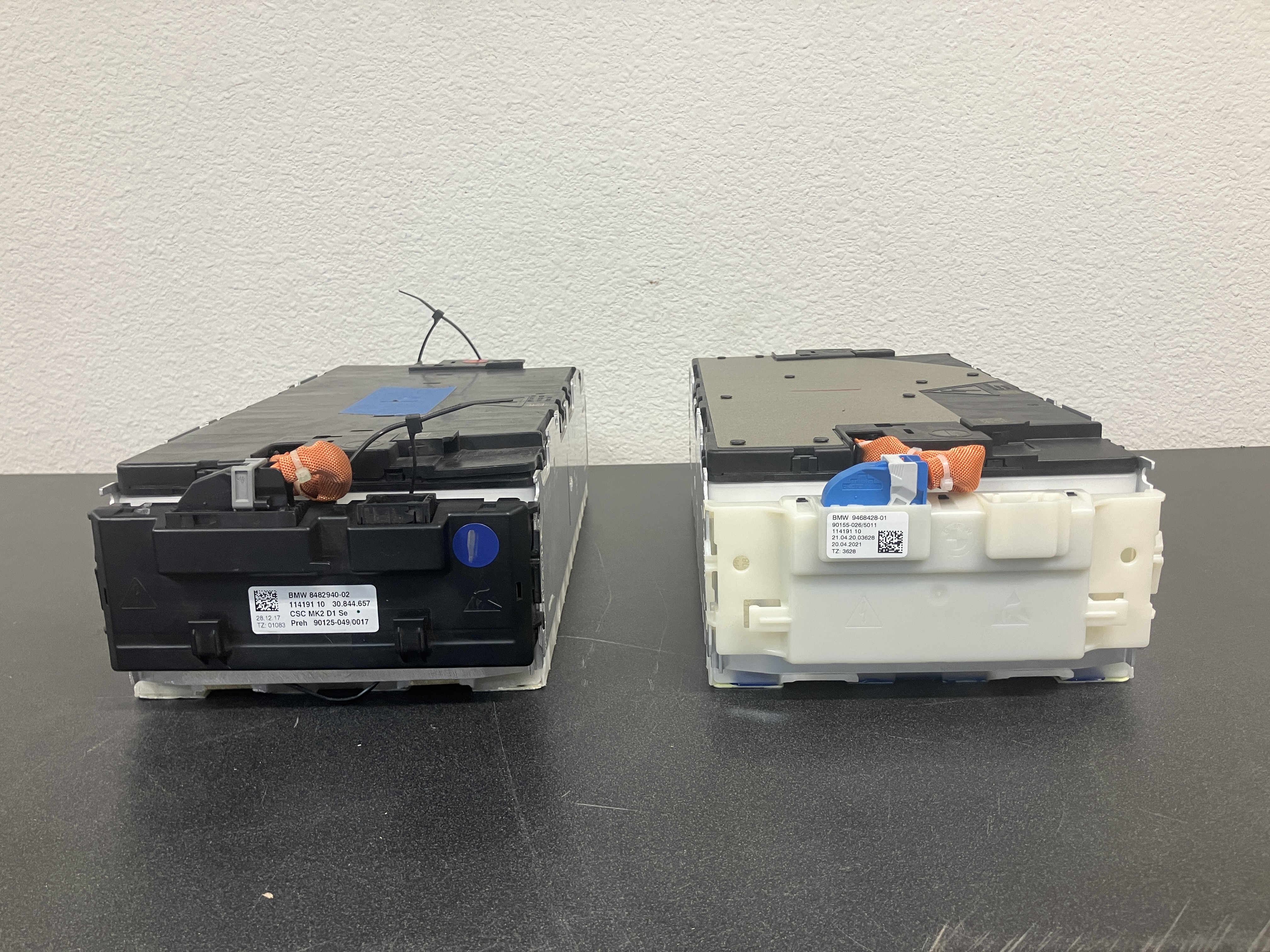

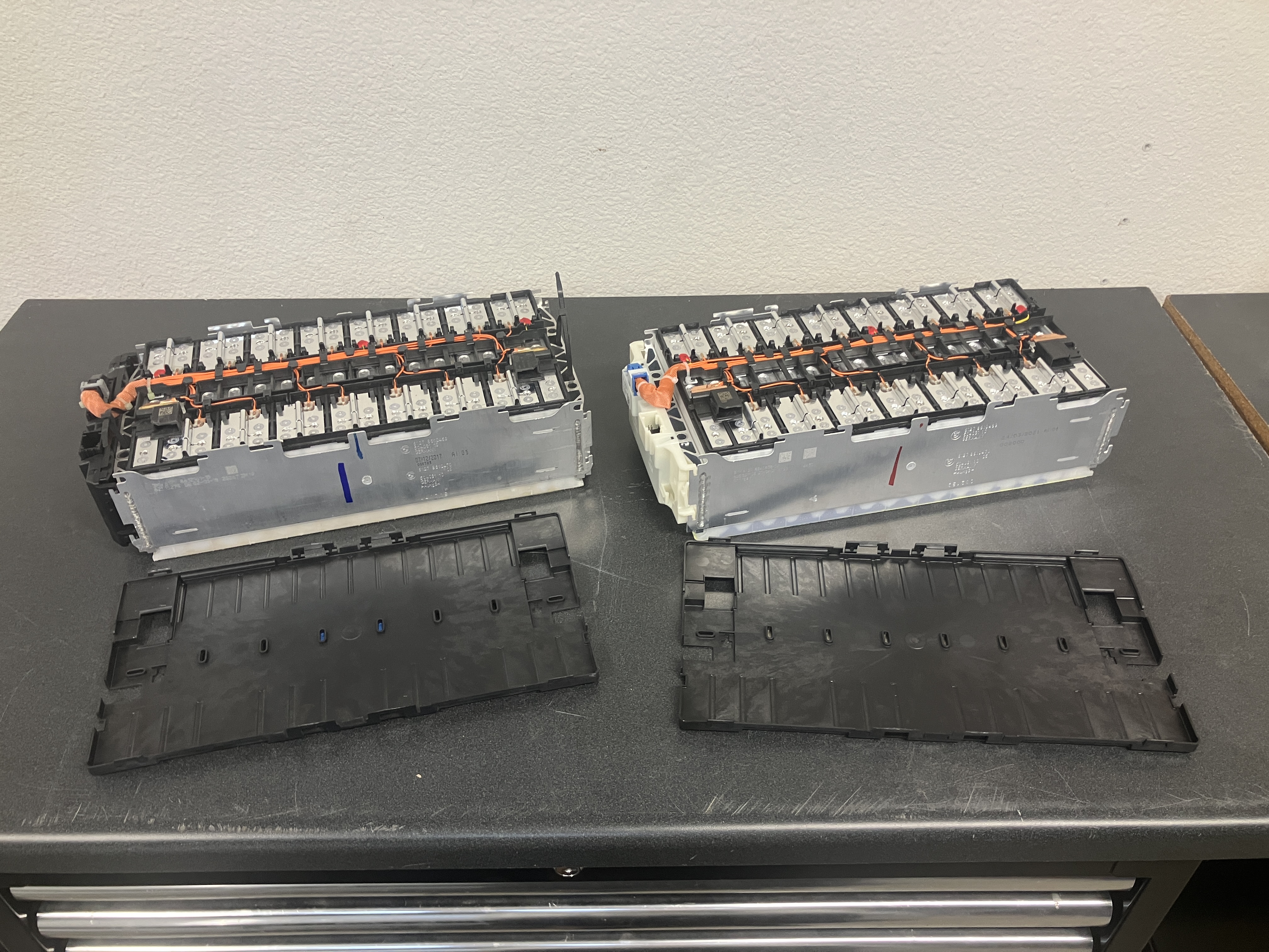

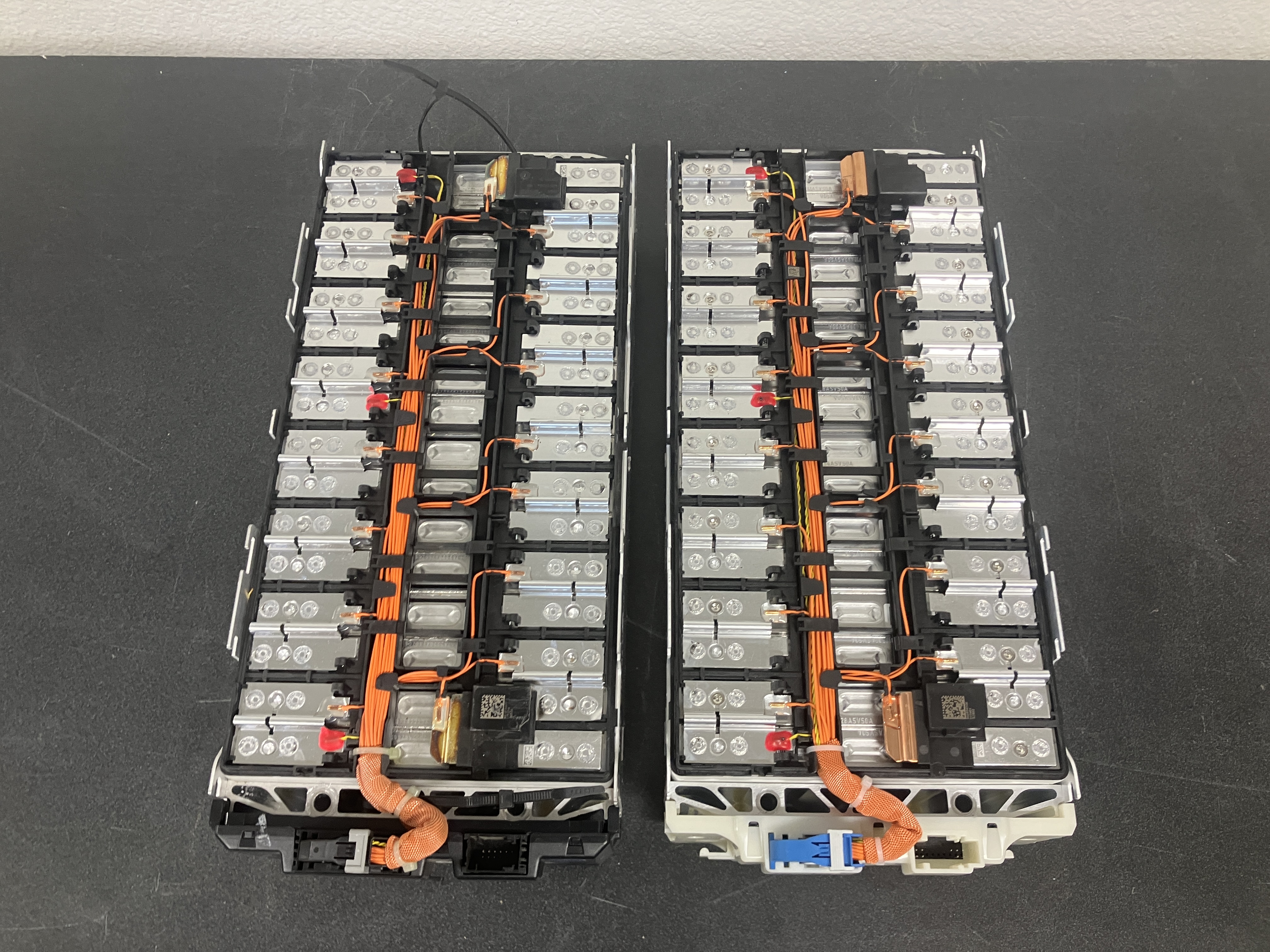

Mandatory Stare 'n' Compare of the BMW hybrid battery pack individual modules (found in the 330e, 530e, 740e, and the X5)
the 9 kWh older SP06 vs the newer 12 kWh SP41

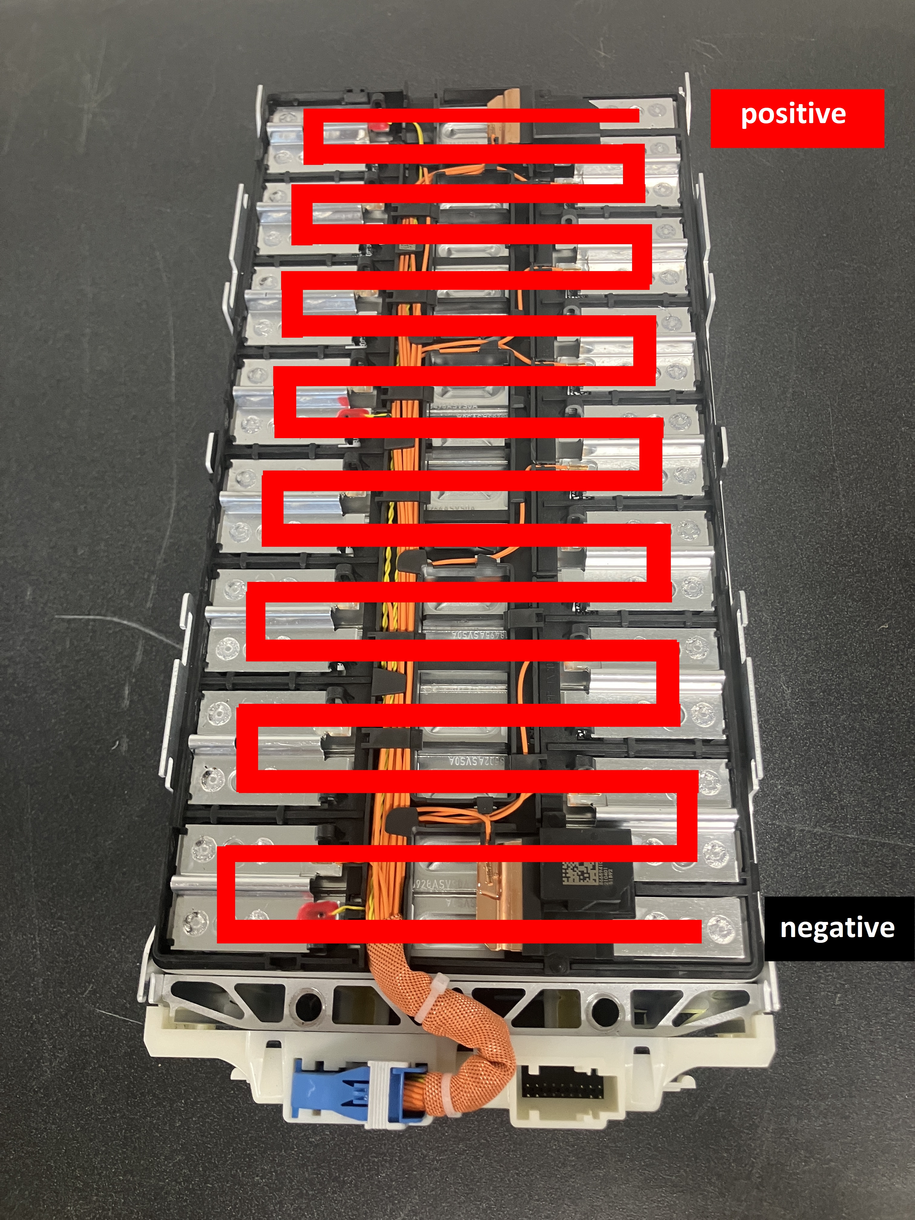

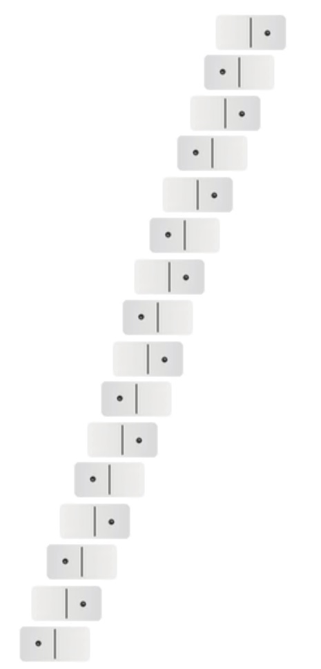

alright time to tell you what you already know, both the older SP06 and the newer SP41 modules are made up of 16 cells, in alternating formation, think of them like domino pieces of 1 and 0 laid down on their sides
type of stuff, this is obviously done for spaceabilty and practicality and storegability otherwise the modules would be an inch thich and a mile long since joining cells in series means linking or connecting them plus to minus, plus to minus, plus to minus, plus to... well you get the idea (by the way solar panels do the same sh!et) this adds up the voltage so 4 volts plus 4 volts plus 4 volts, etc...

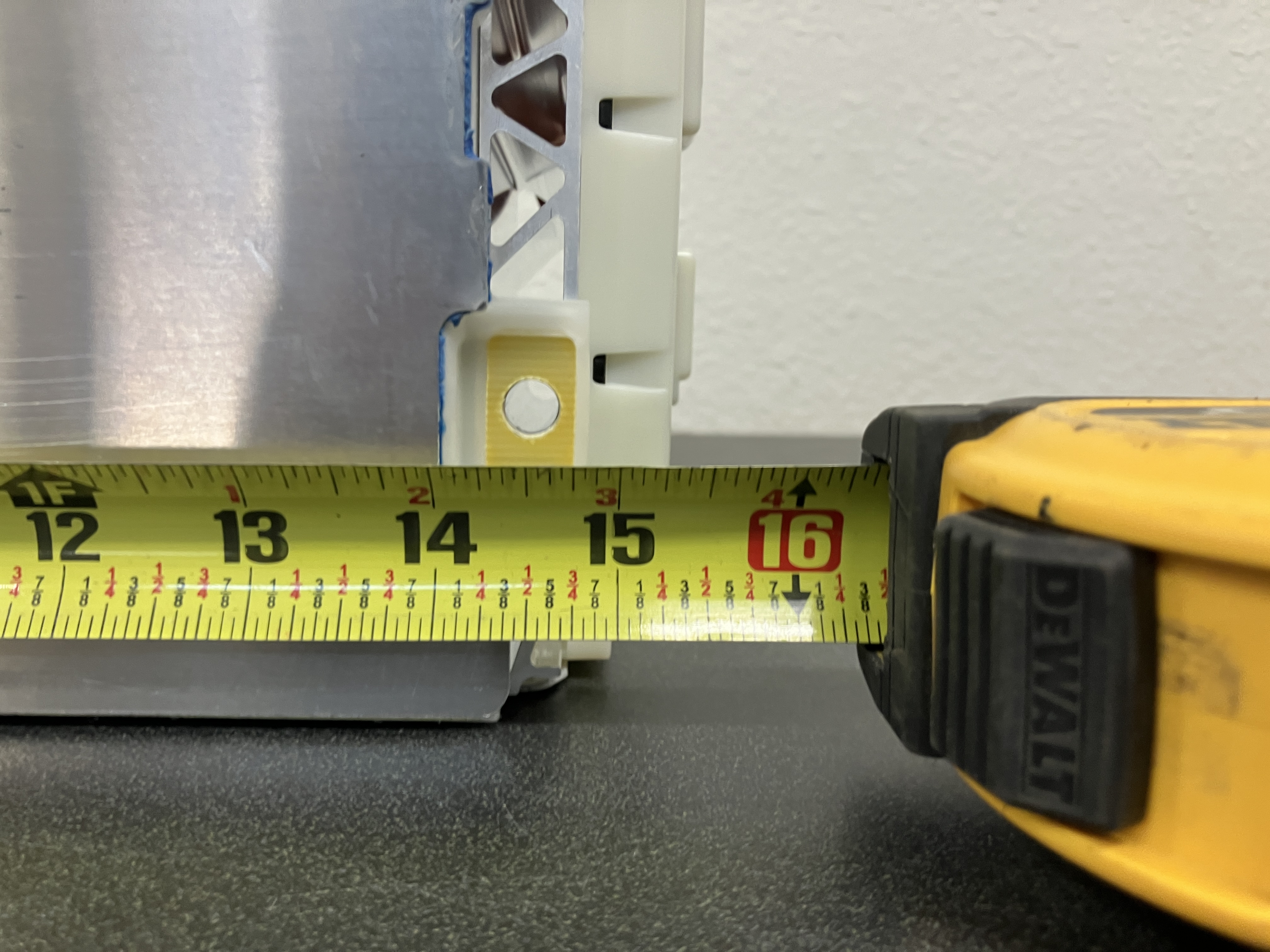

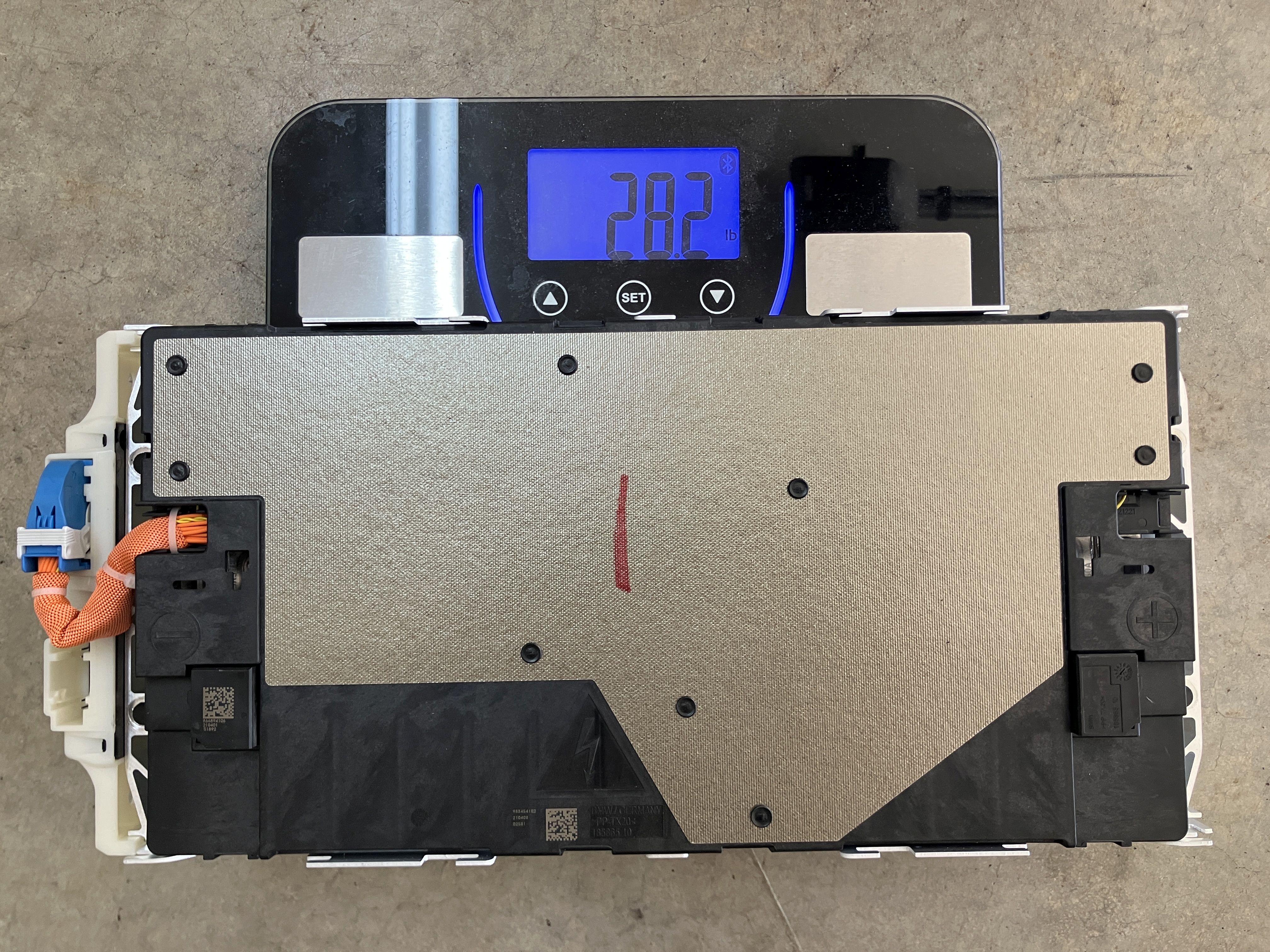

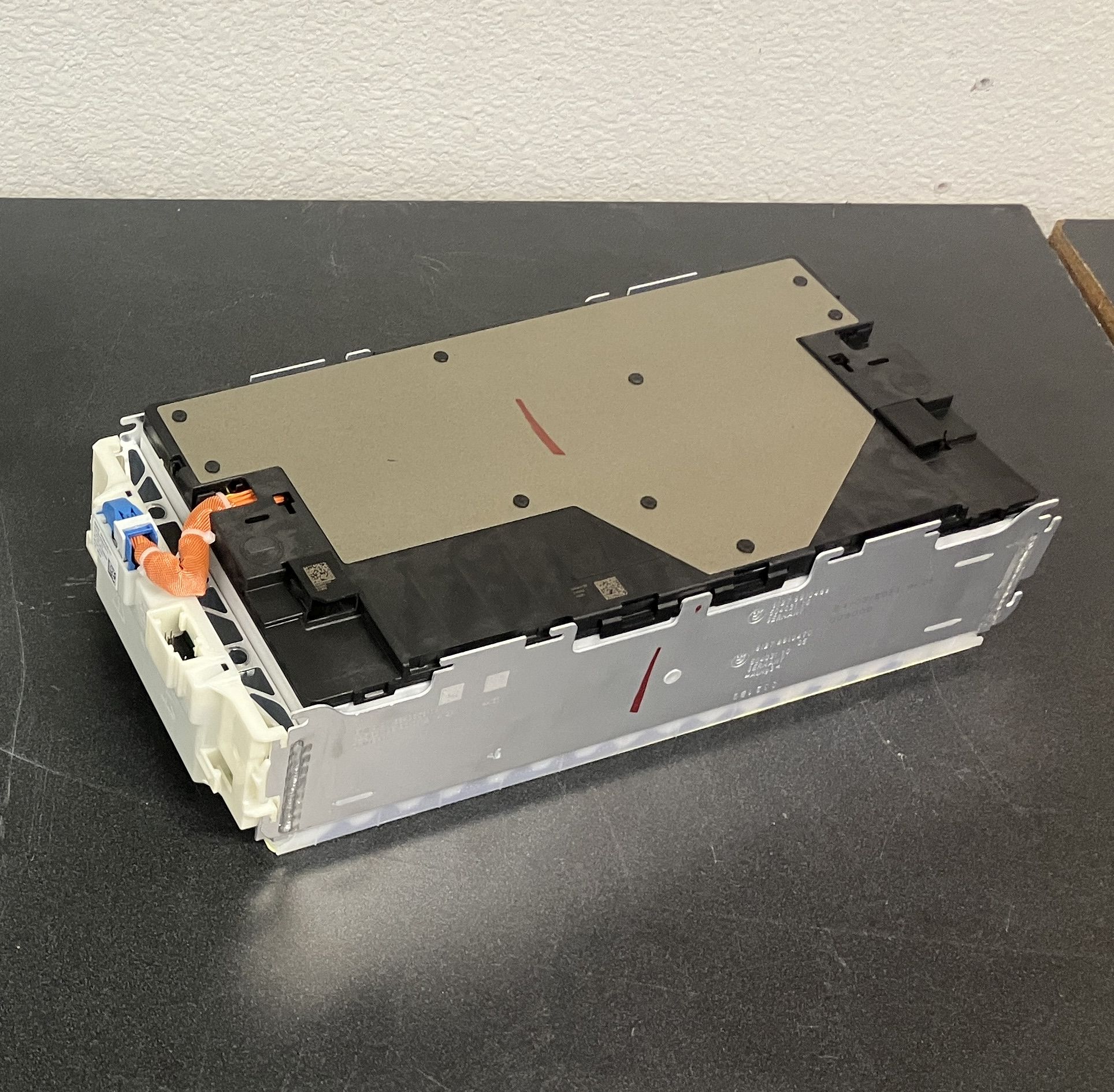

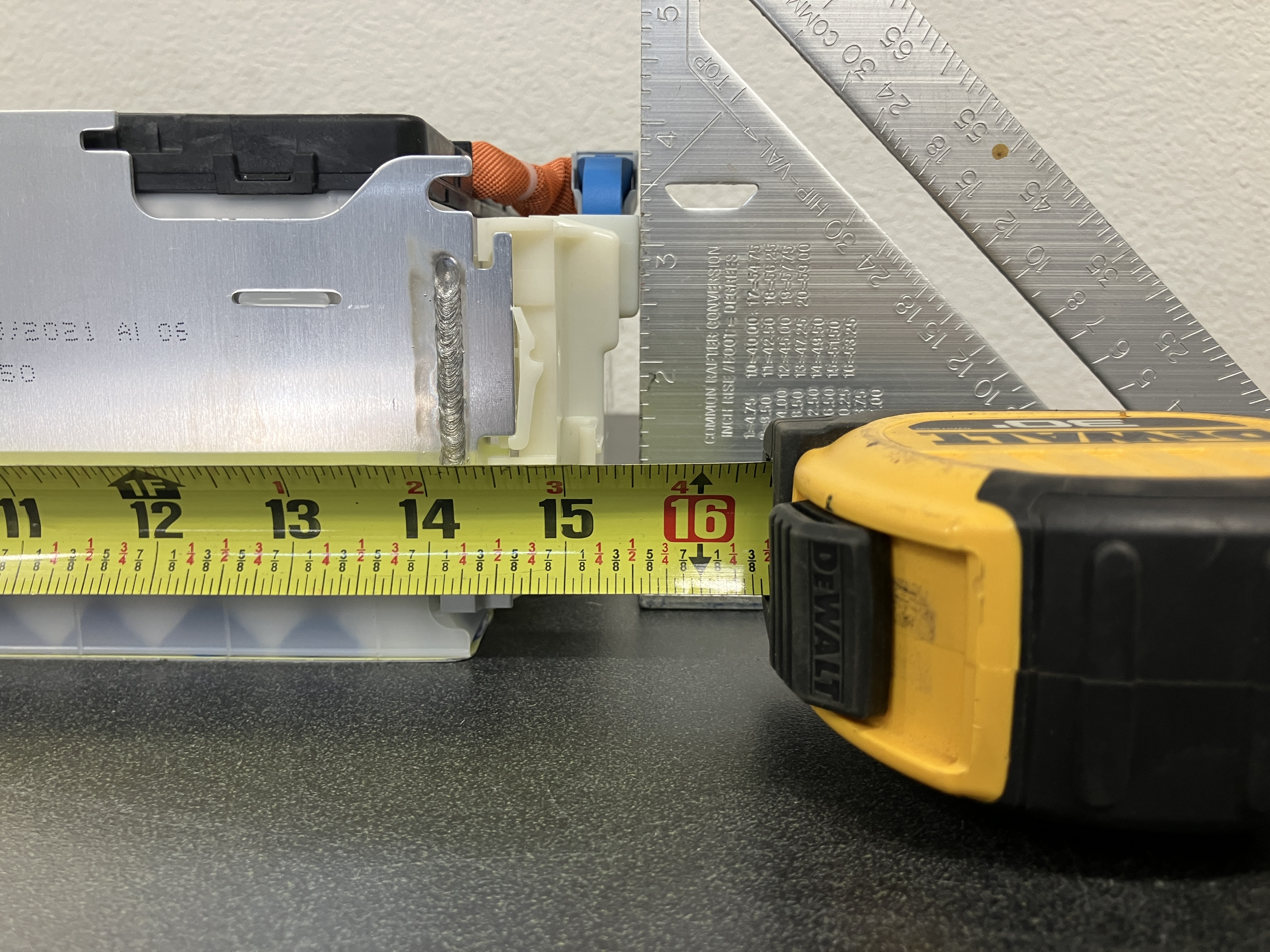

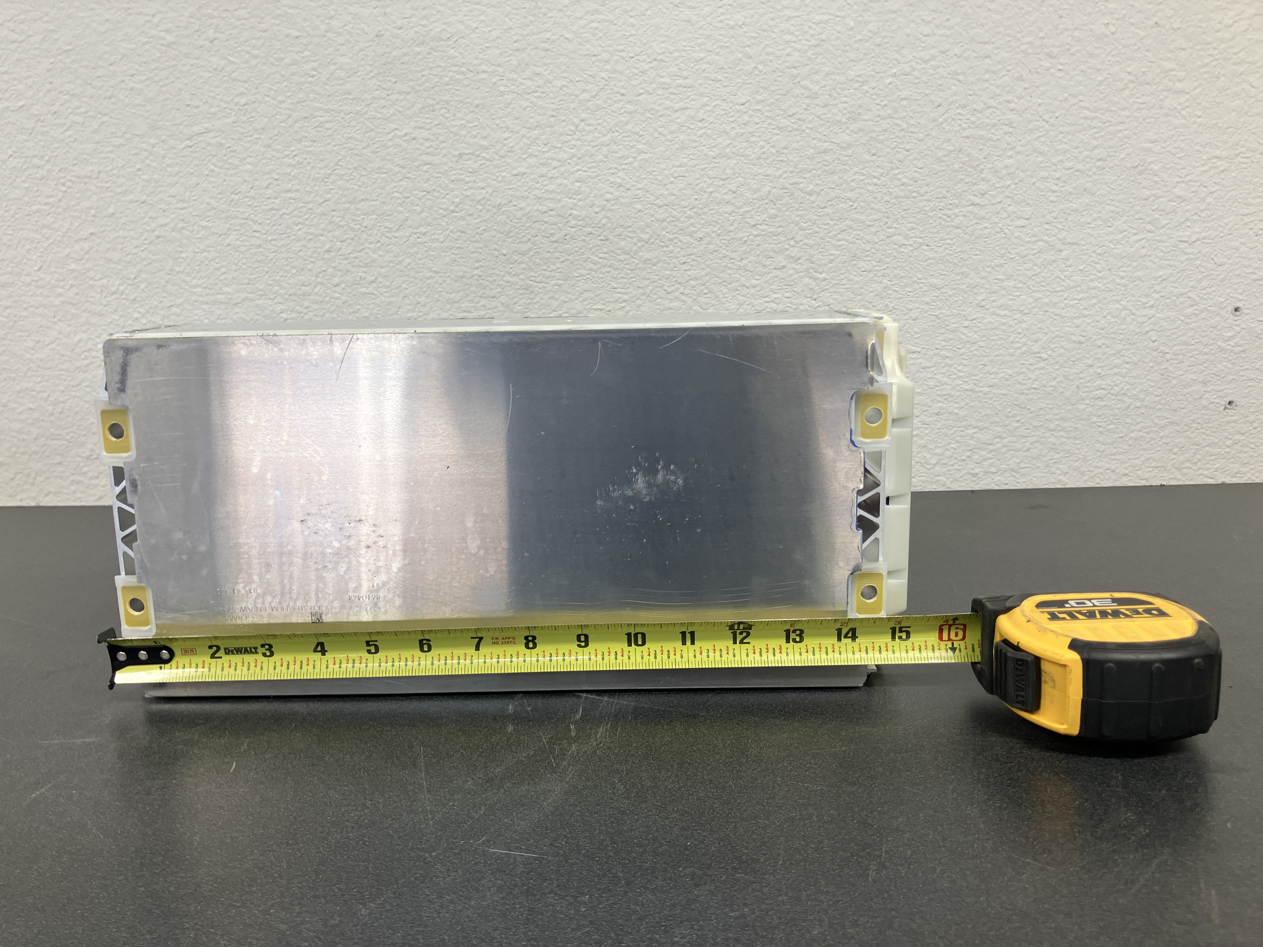

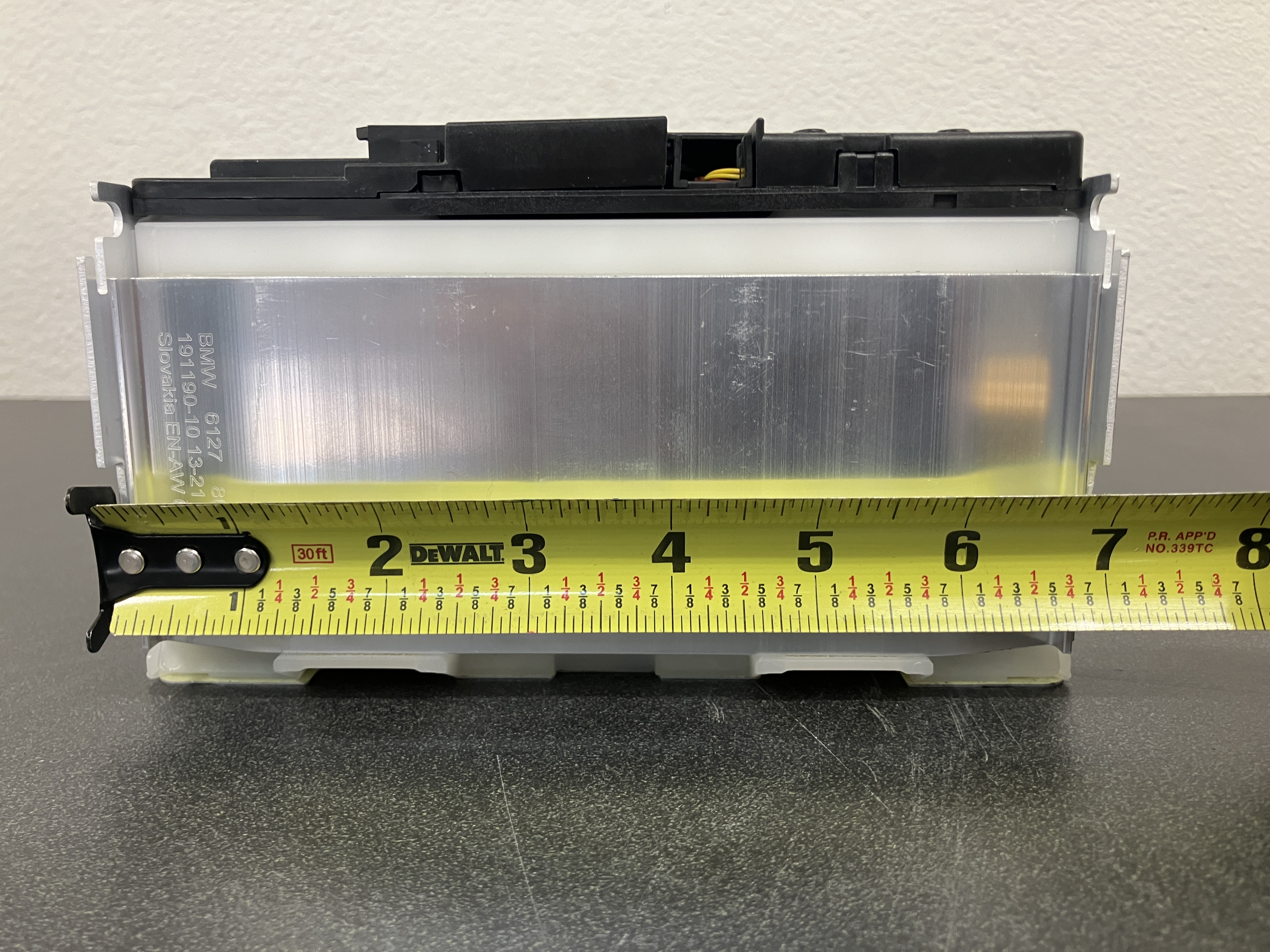

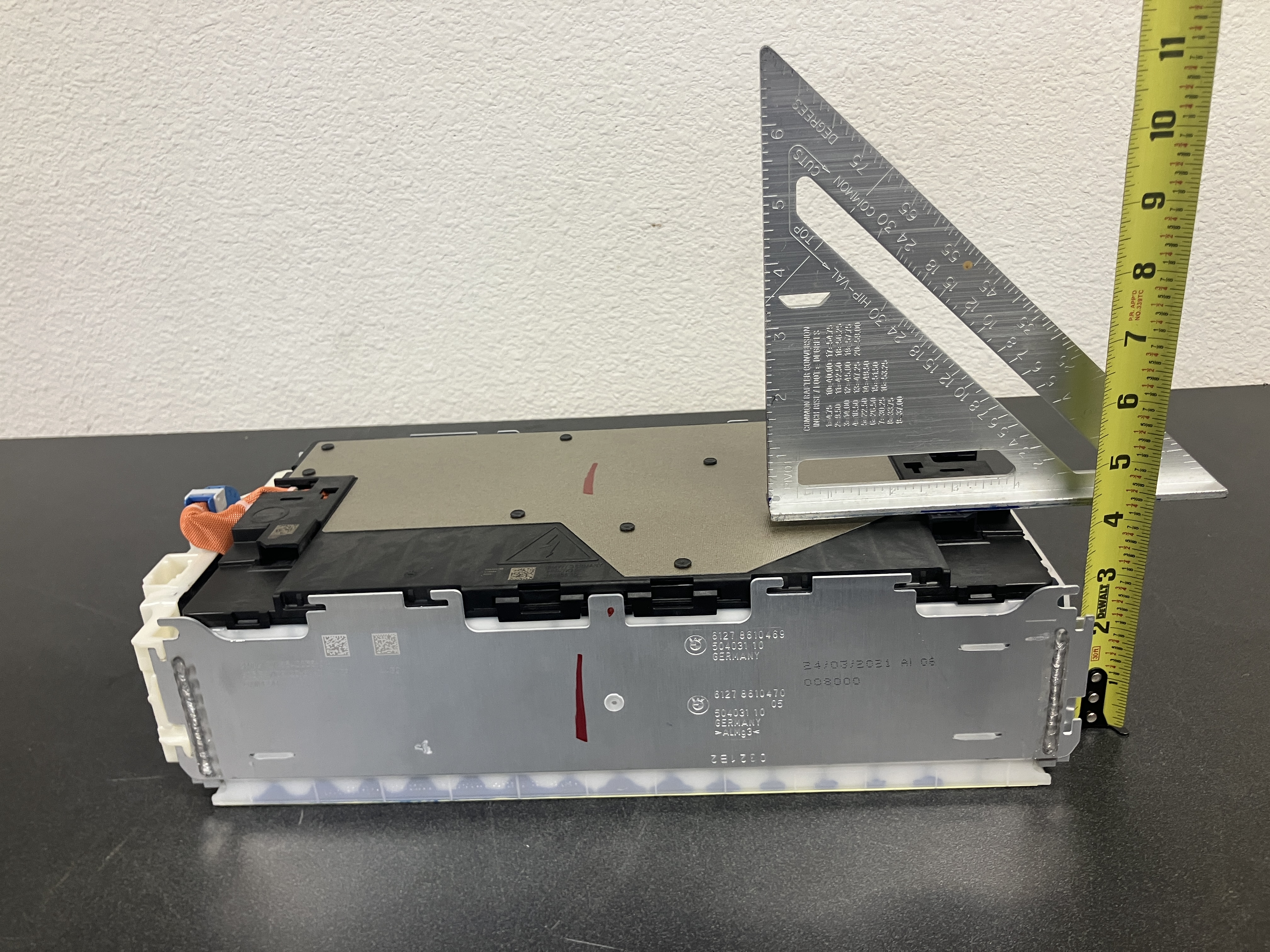

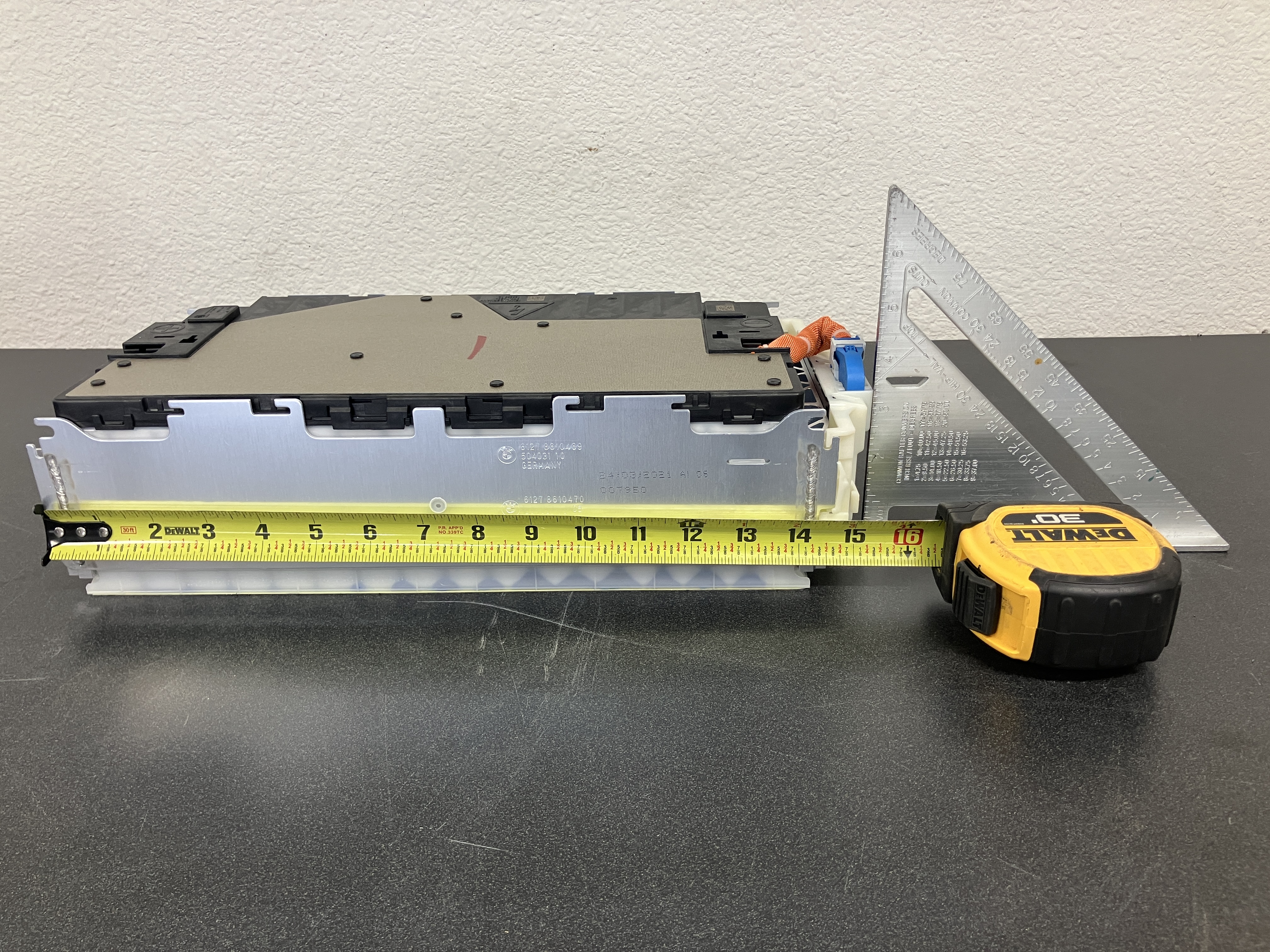

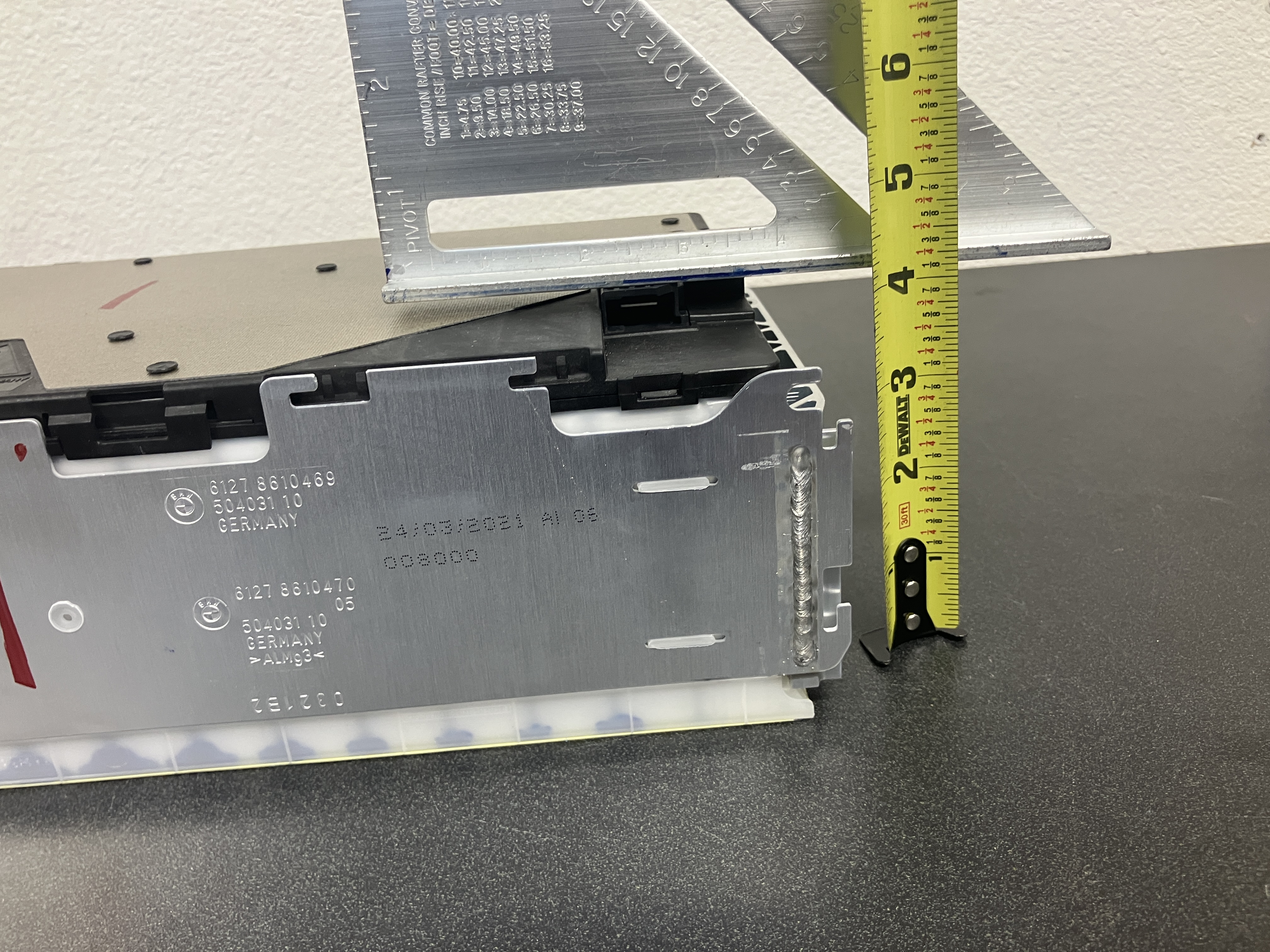

this is the new SP41 module with the BMS slave module attached weighing in at 28.2 freedom pounds, the truck will be equipped with a dozen of these beauties
the module is approximately 7 inches wide
the length is a bit tricky so hear me out, with the slave BMS module it appears to be 15 1/2 inches long
height looks like 4 1/4 inches
Gregski
Posts: 3159
Has thanked: 631 times
Been thanked: 1607 times
Post by Gregski »

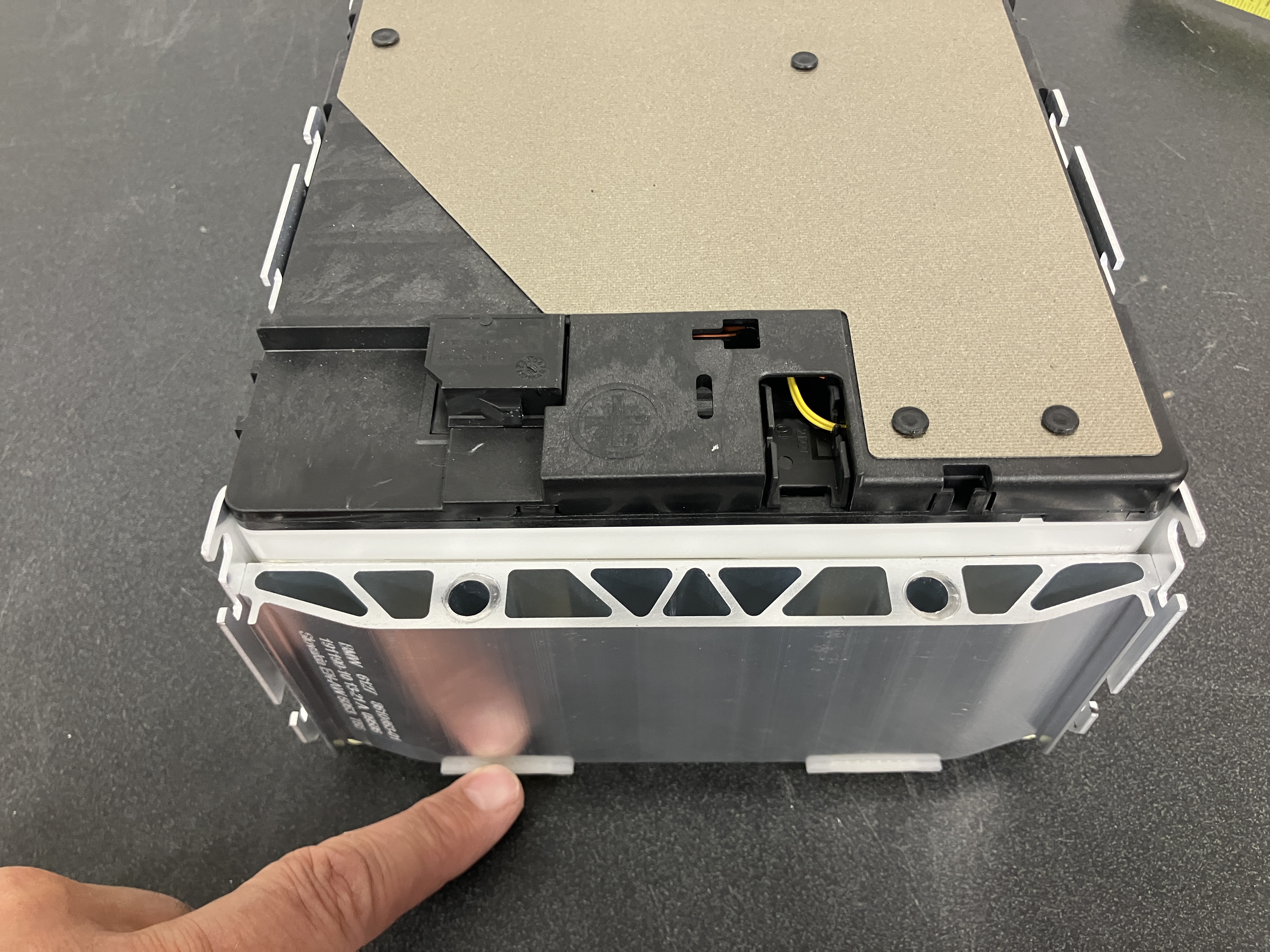

something to look out for or account for are these pesky plastic feets that stick out about 1/8th of an inch on each side, now you can grind these flat, I did that on my first pack cause I did not account for them space wise, so I avoided a close call there

Thank you! Wow, that is pretty good. Guess it works out to 14.1 lb/kwh including BMS.. I like it!

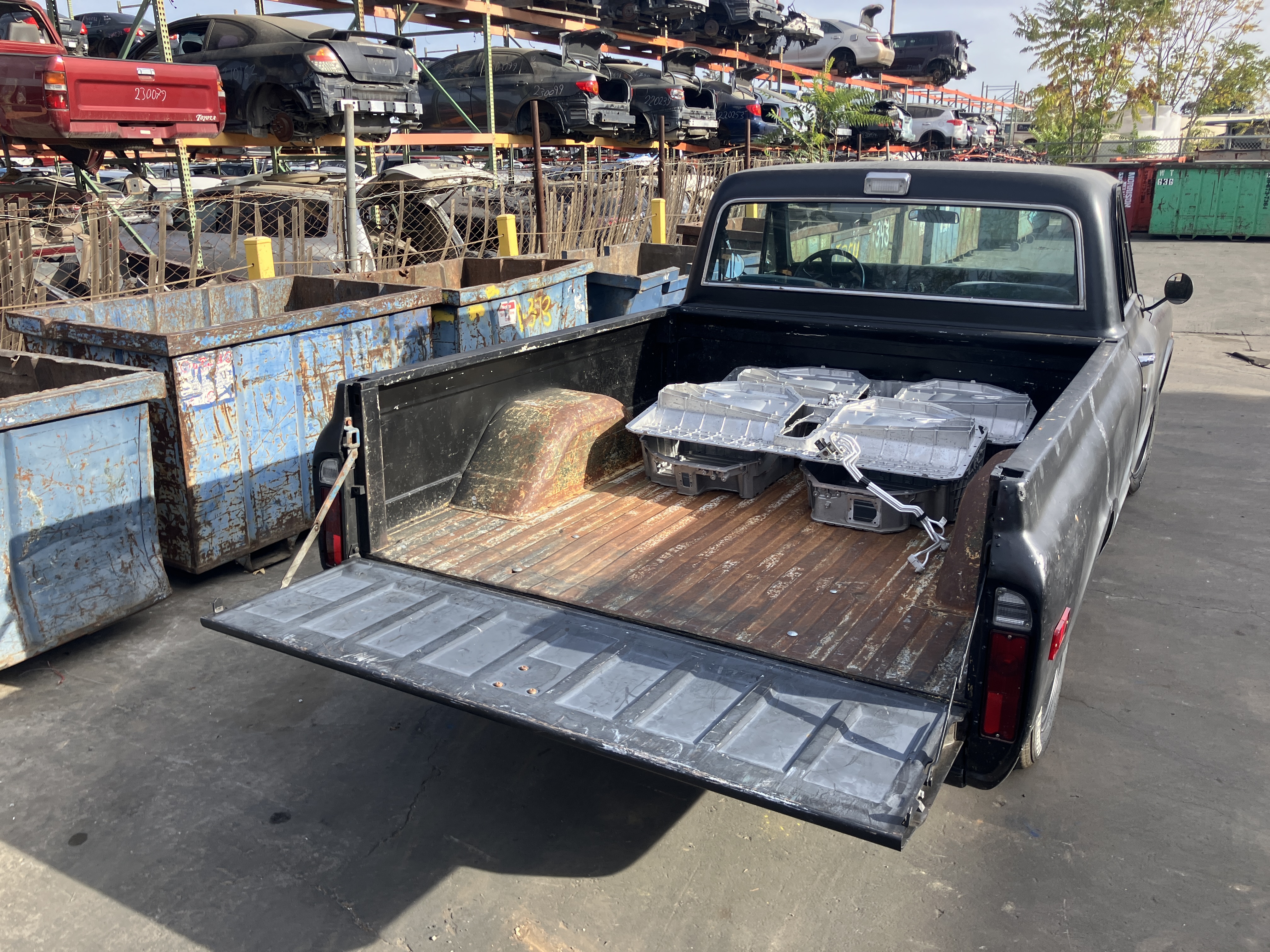

Post by Gregski »

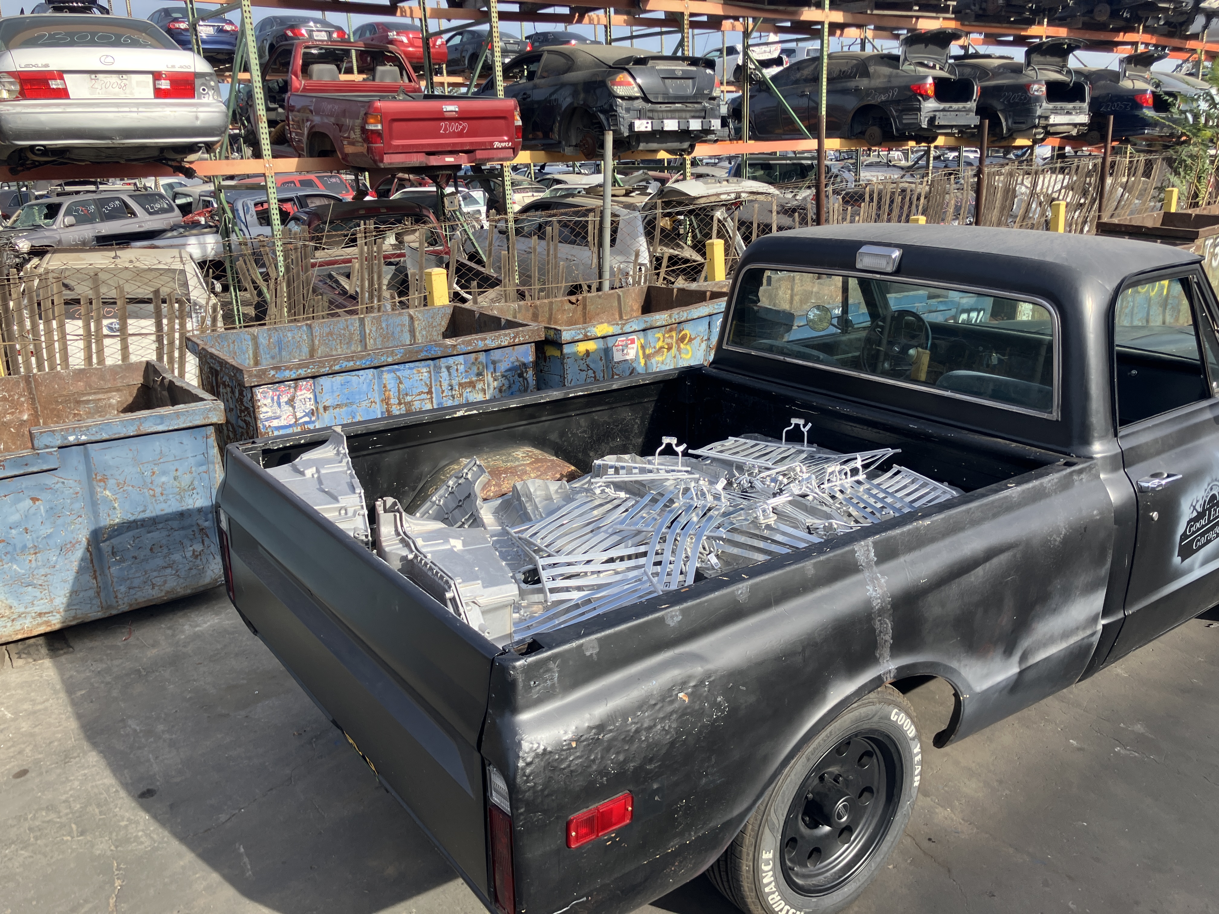

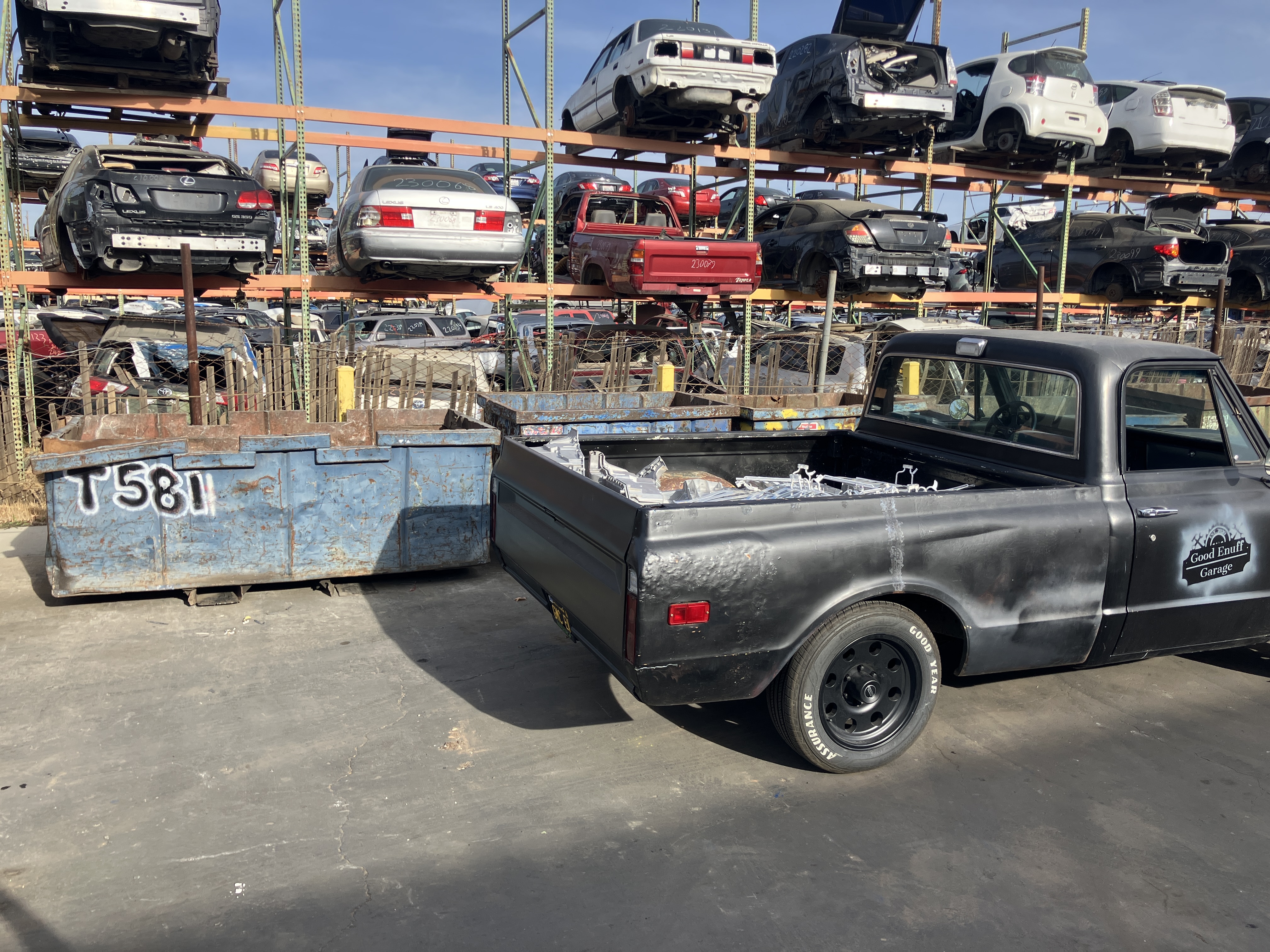

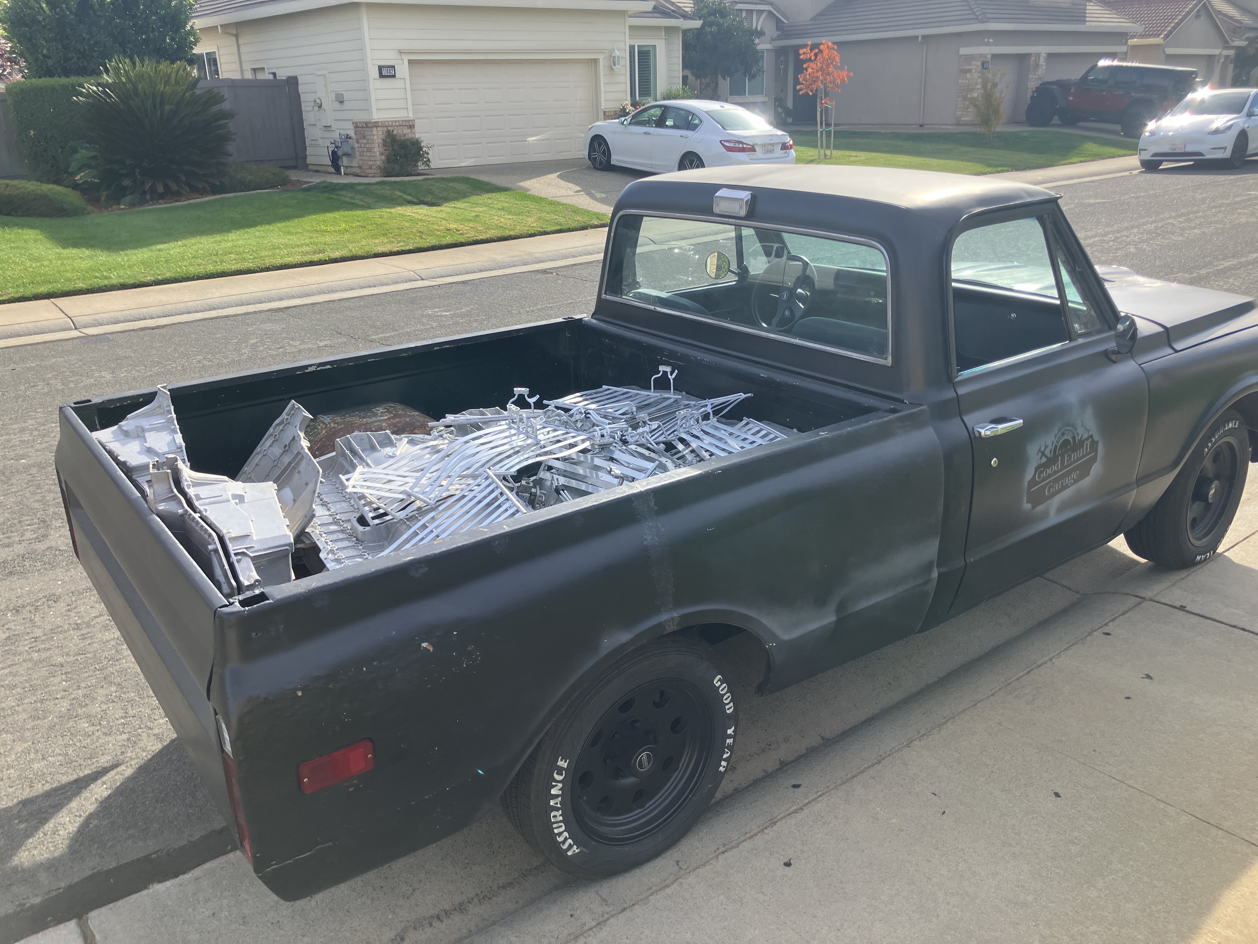

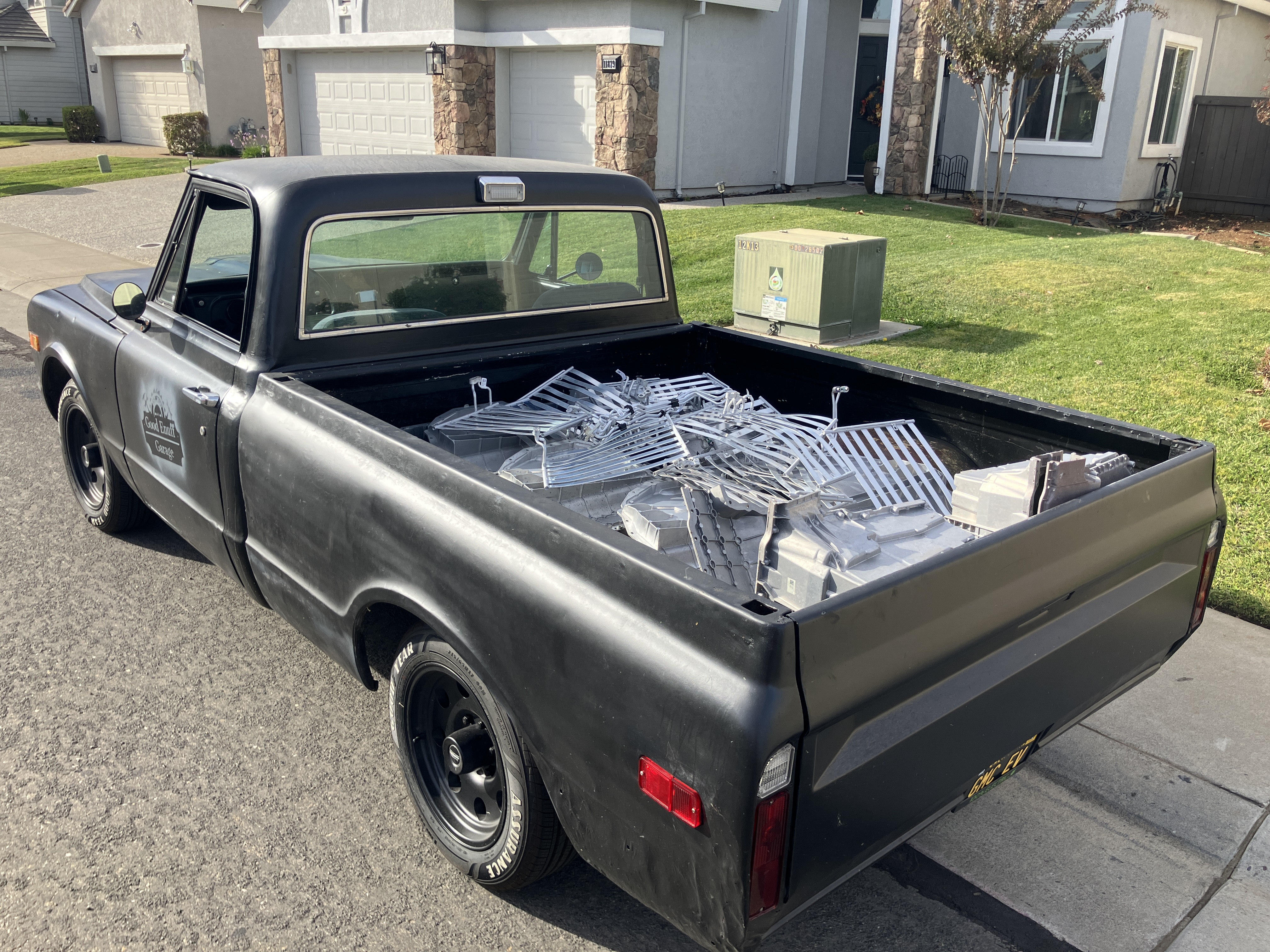

just hammin' it up on my way to the metal recycler with a big smile on my face cause the truck is running great, and check out these street names

marcexec
Posts: 239
Location: Dublin, Ireland
Has thanked: 1041 times
Been thanked: 111 times
Post by marcexec »
Still annoyed you didn't check that bin :D

Hi Greg,
Would you have any dimensions for the cell hold down bolt holes?

Post by Gregski »
Uppertown wrote: Mon Nov 11, 2024 1:40 pm Hi Greg,
Cheers
center of bolt hole to center width wise is 87 mm
center of bolt hole to center length wise is 14 1/8 inches (sorry I did not have a metric measuring tape that long)
the holes appear to be 8 mm in diameter, but the bolts are only 5 mm

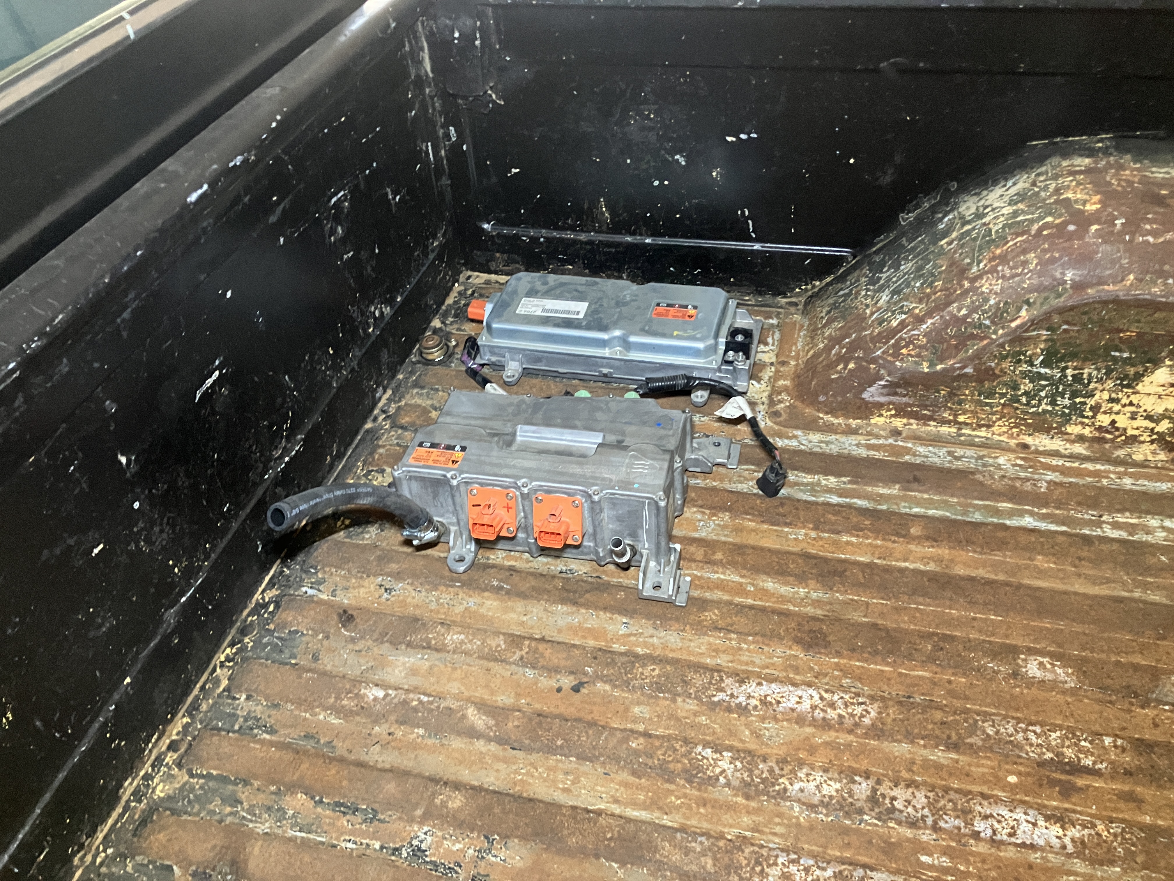

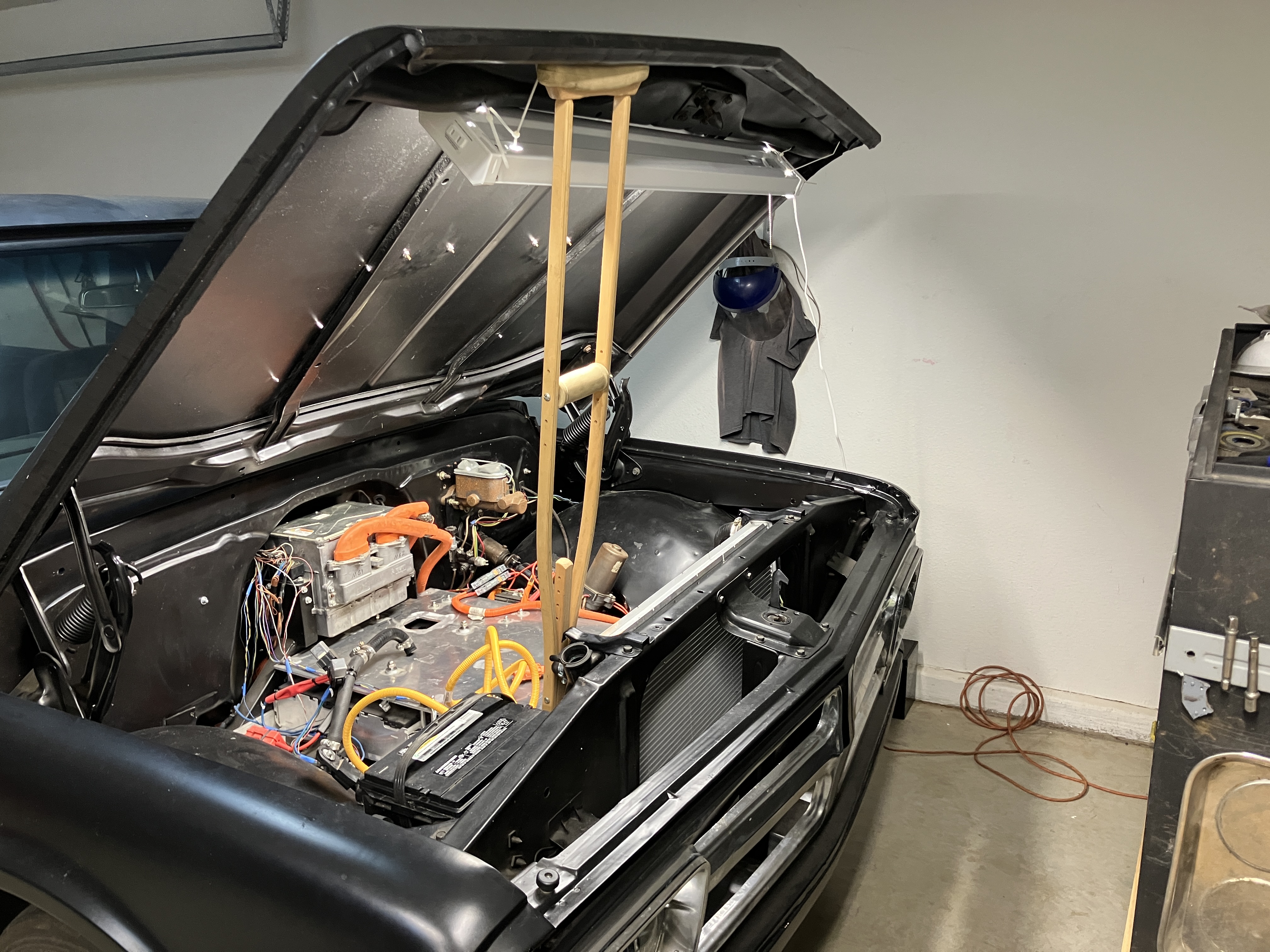

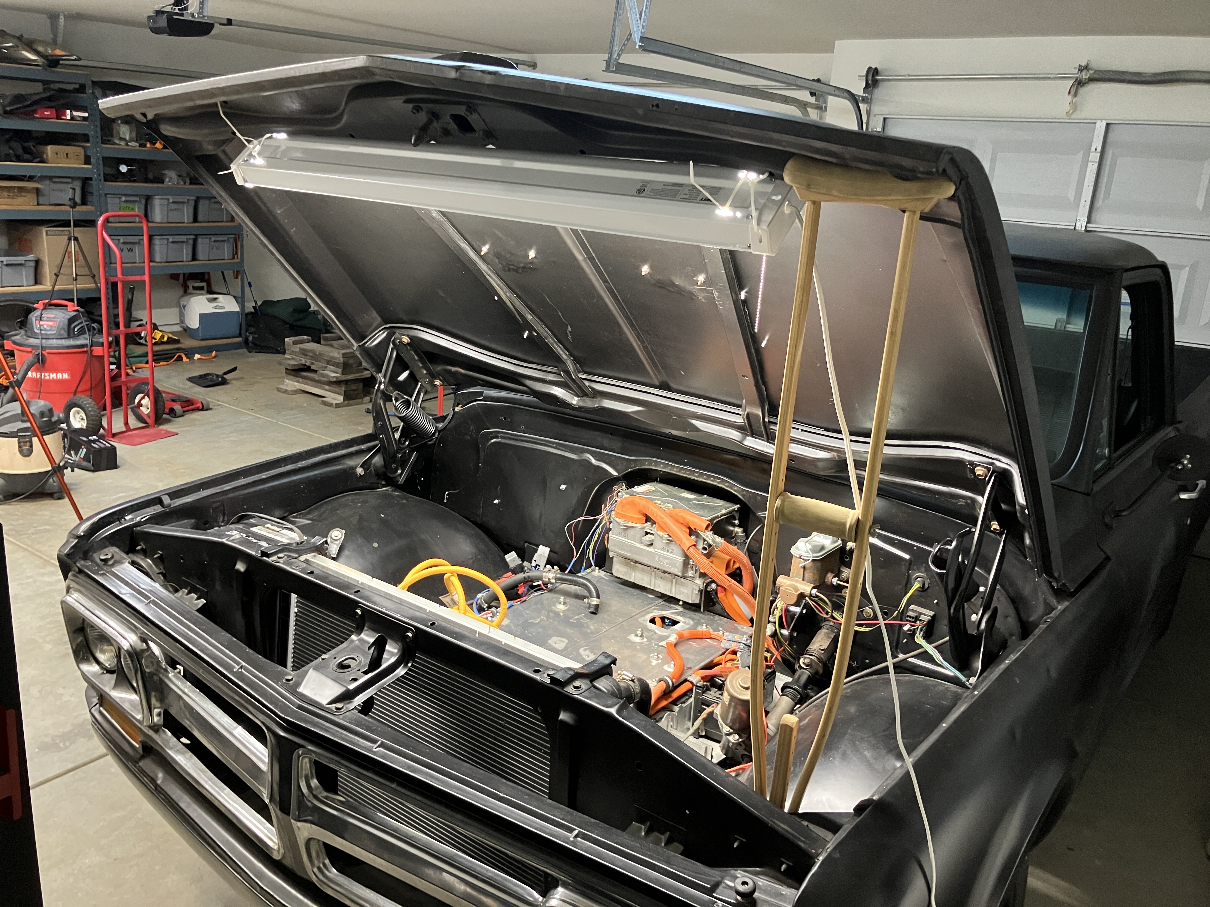

we now join Phase 2 of the truck project already in progress...
Our mission should we choose to accept it, is two fold:
  1. Replace the 9 kWh battery pack with two 12 kWh battery packs
  2. Enable MG1 by locking out the input shaft
below I already removed the first gen Chevy Volt charger and DC-DC converter
nice thing about owning a truck is that it comes with it's own workbench/storage space

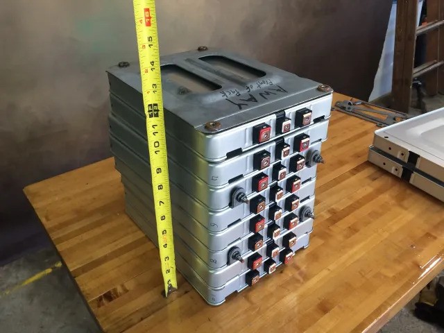

Post by Gregski »

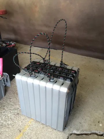

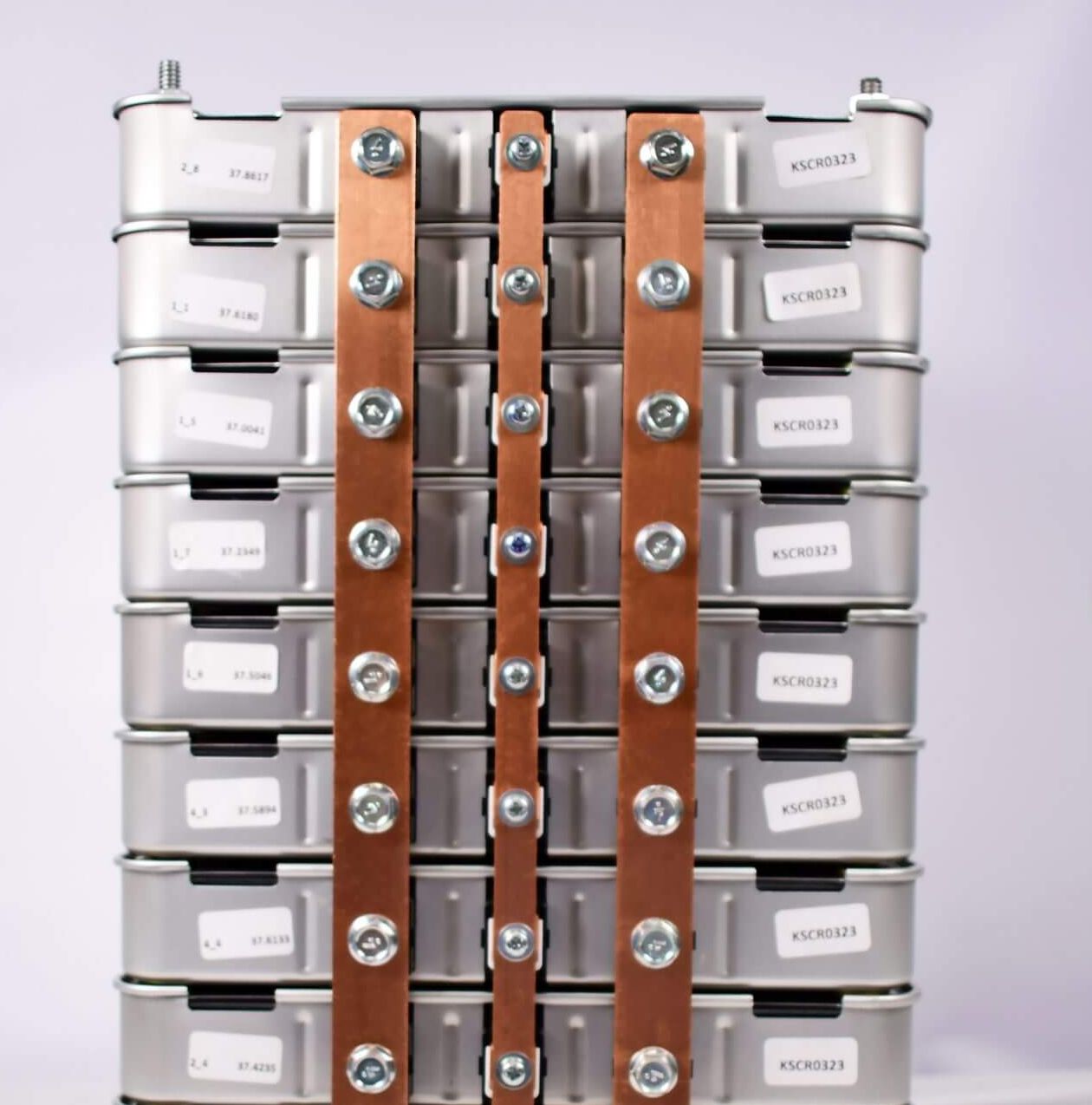

so I just had a random thought I want to share, each one of these BMW 67 volt modules is the equivalent of 8 Nissan Leaf sardine cans, voltage wise (I do realize the Leaf modules hold more energy) and to be fairer I am comparing the 2019 Leaf modules to the 2019 BMW modules, and not the older Leaf packs (despite of what you see in the pics below)
we know that the BMW modules weigh 28 el-bee-esses each and the Leafsters are 8.3 lbs each so an 8-pack would come in at 66 pounds so more than double the weight
again if we continue to ignore the much higher energy capacity of the Leaf pack (Nissan 40 kWh vs the BMW 12 kWh), we can clearly declare ourselves the short sighted winner here!

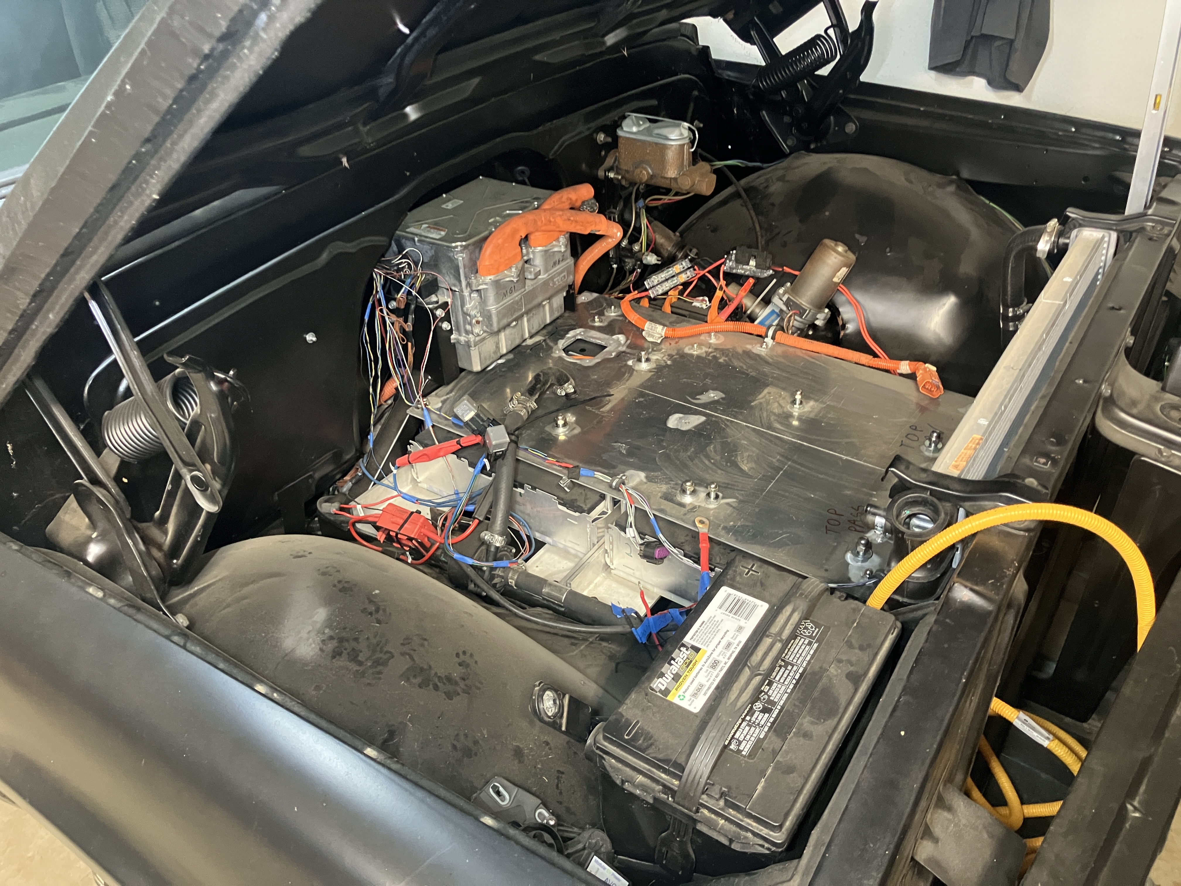

Post by MattsAwesomeStuff »
Do you take off the negative or positive wire first?
Easy.
You want to be like Ghandi. You want to stay positive. You want to spend the least amount of time as you can being negative.
That means the negative terminal is the first to be disconnected, and the last to be reconnected.
I've never heard controversy around this, it's factual.
If you remove the negative lead, and then accidentally touch it to the body of the car, nothing happens. If you remove the positive lead and then accidentally touch it to the body of the car, you've shorted the battery.

marcexec wrote: Mon Nov 11, 2024 10:10 am image.png
Oh there?! I think all those bins were empty and for sure off limits to public access, they were inside the enclosure, sorry.
