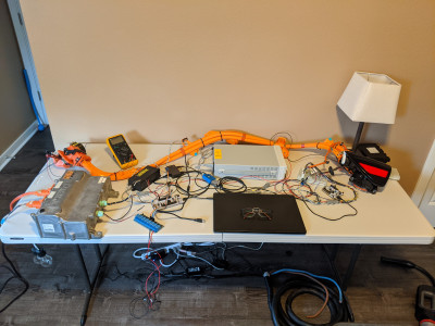

Good news so far today is that I've gotten the charger outputting voltage. I initially wasn't getting the right output, but I set the input current too low :D Annoyingly CAN Low was white, which is pretty much opposite from standard.. (de facto standard, but still...)
I now get 200V with a 1A current limit, looking good so far. I'll test the CHAdeMO out after I eat some dinner. Stay tuned!

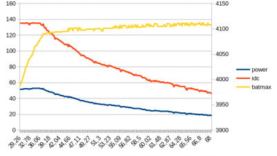

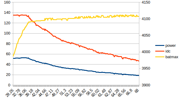

Been thanked: 1918 times
Re: Tesla Model 3 Charge Port Controller Standalone Development
larsrengersen wrote: Thu Dec 17, 2020 9:24 am 0.9, 1.0 and 1.1 are 125A max
Hmm, I've seen 135A on a 60 kW charger. I've implemented 0.9 in Touran.

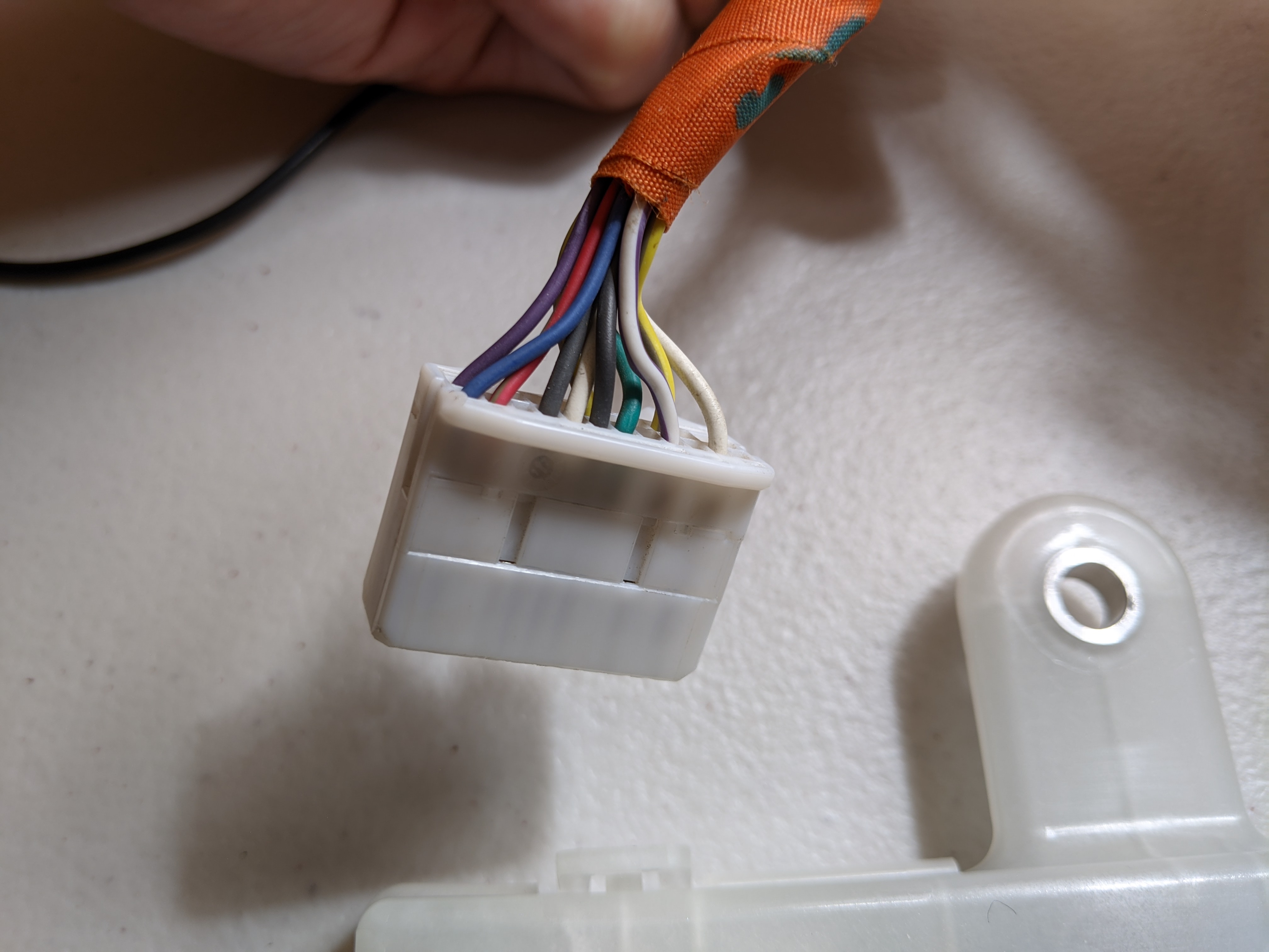

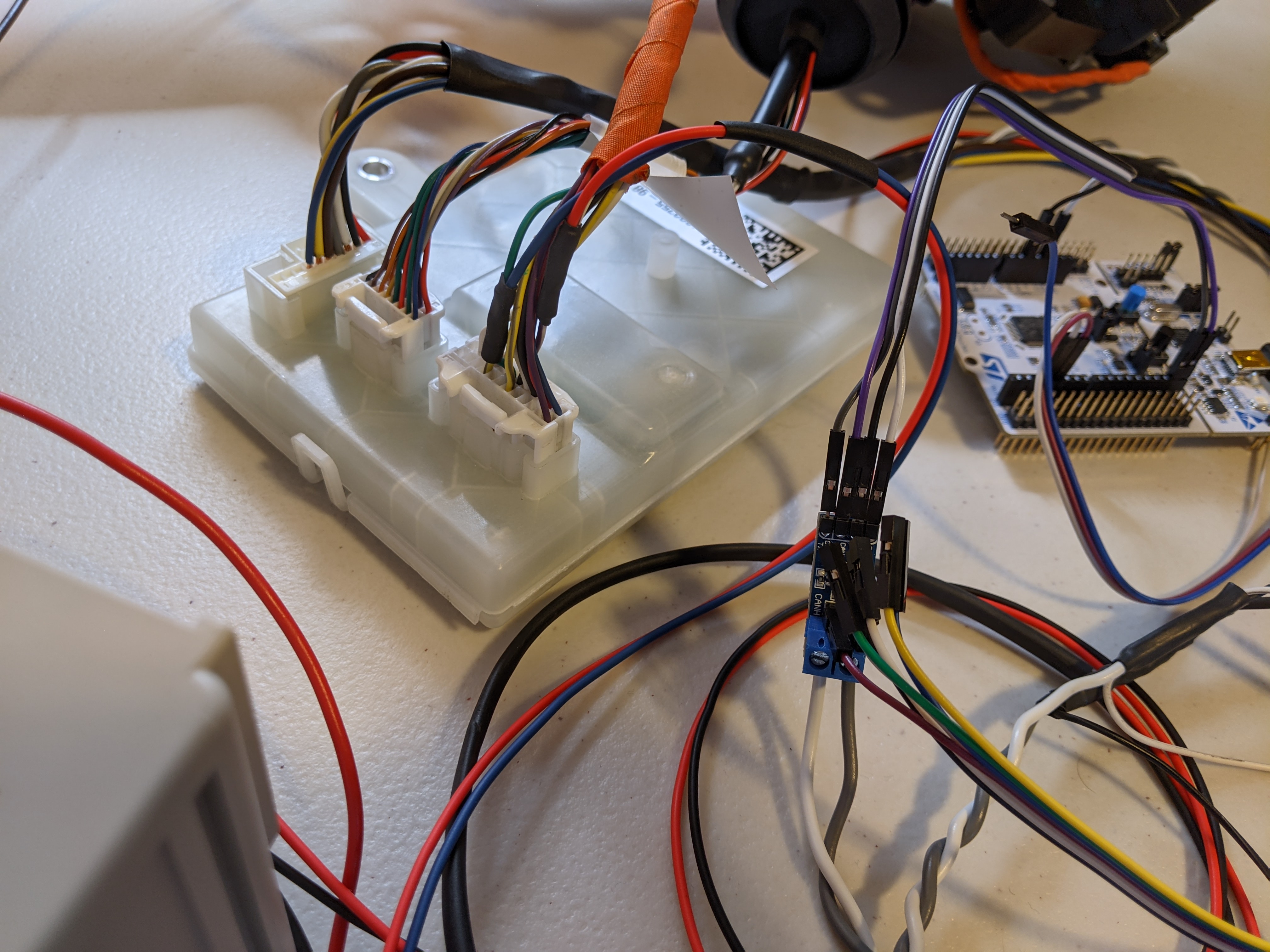

So some clarifications... This connector is the one I unplugged and left the power on with:
The green wire is ground, and the white with purple is pilot. This connects to CAN Low (Ground), and CAN High (Pilot).
This then results in:
And my table still looks reasonable:
