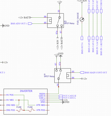

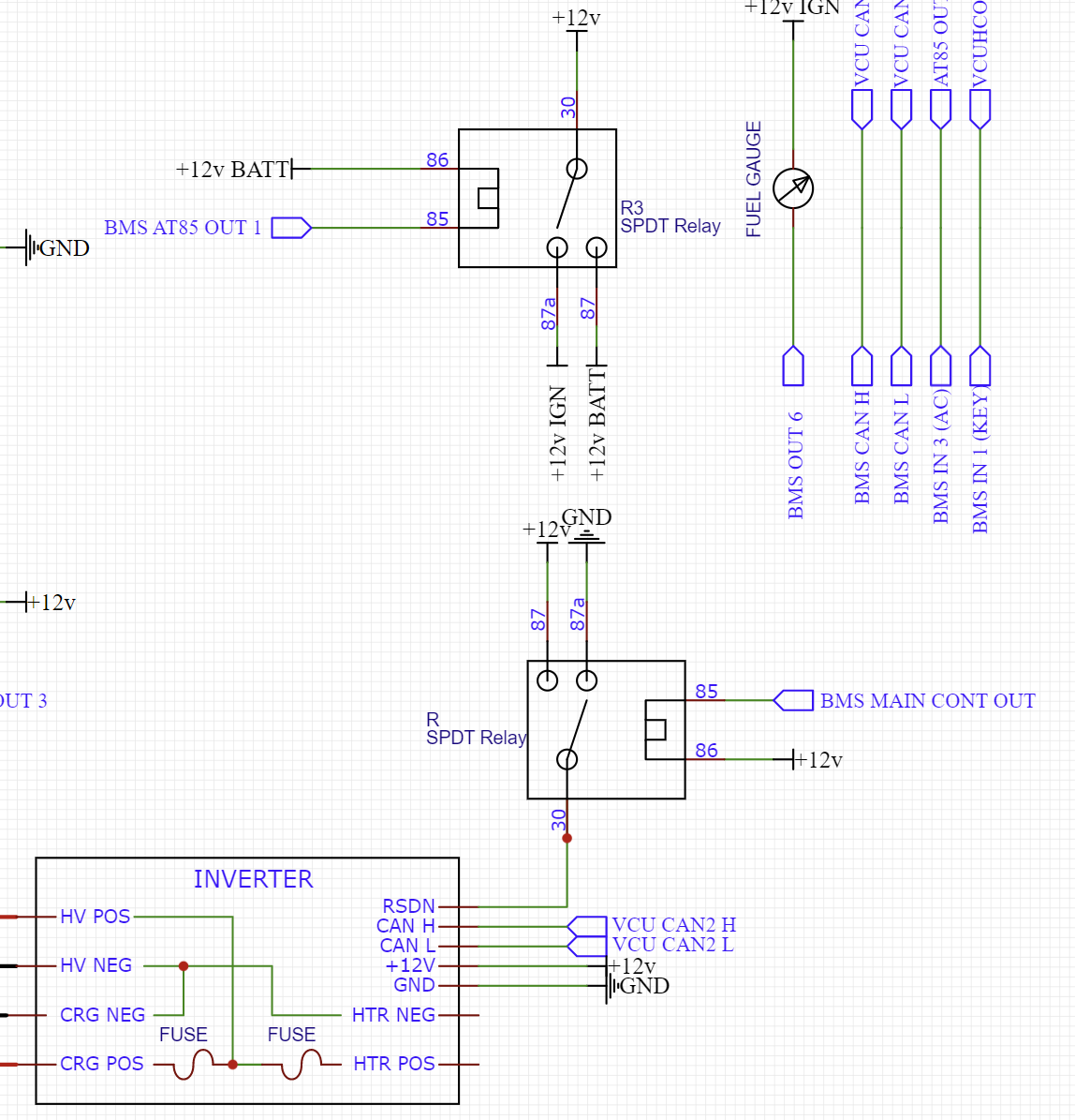

Can you advise how to connect ignition signal for inverter. I see that we need to activate a precharge relay and contactor at some point in start. But would we have to activate the internal inverter logic before or after precharge? Can you confirm my assumptions?
1. We have a permanent 12V/GND connection to inverter.
2. We use IGCT signal to activate inverter on precharge by a latching relay triggered by "start" key position which will keep it alive
3. If we need to use emergency off signal we can wire IGCT through normaly closed NC contacts of notaus. That will disable inverter while rest of the car will still function.
I need to setup the succession logic for my inverter.

Post by aot93 »
arber333 wrote: Tue Feb 28, 2023 6:20 pm I am not sure if this came up before or on different thread...
Here is a wiring diagram of my setup that help:
The logic being the inverter gets +12v via my ignition change over over relay, this relay is NC to the ignition switch and NO to the type 2 socket PP pin.
Inverter RSDN is connected to BMS main contactor out via relay so the BMS can safely shut down the inverter if needed.
The inverter starts up very quickly so there is no need for any delays.

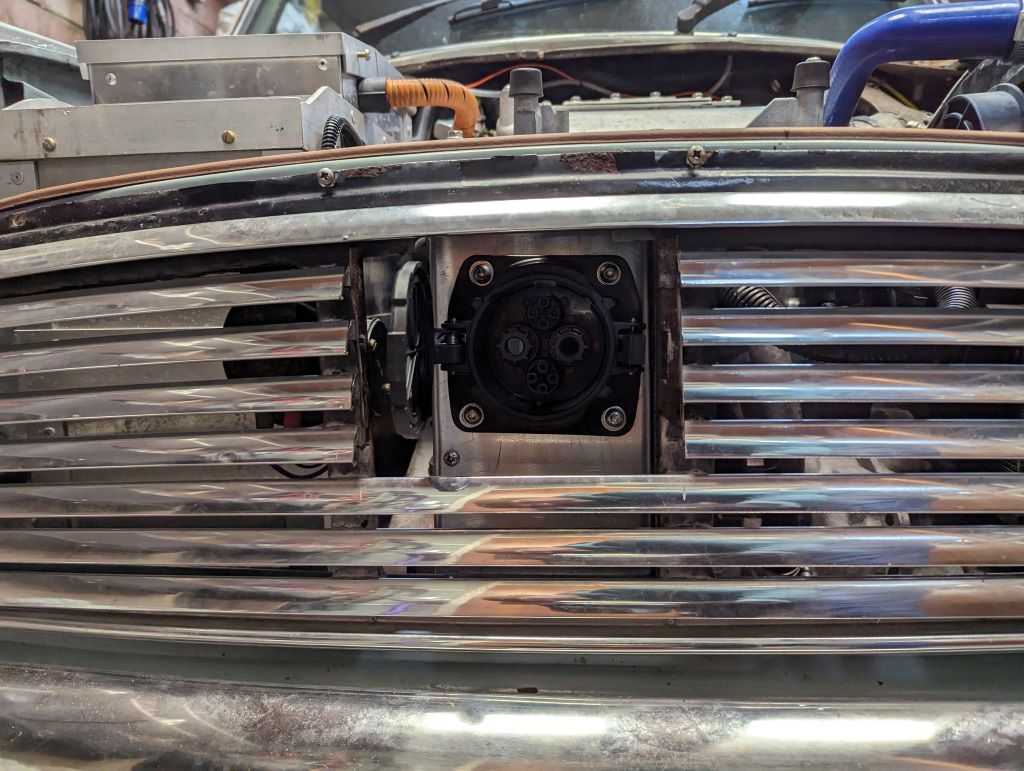

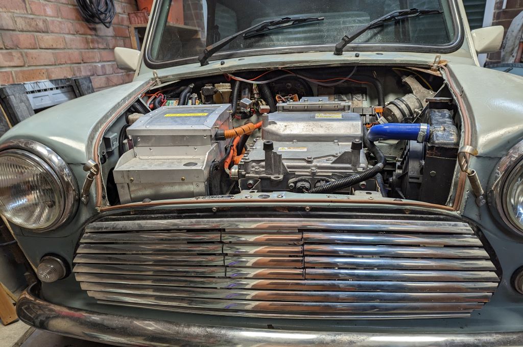

Some progress, new boards built and socket contactors and other bits installed some wiring left and of course a lot of code and de-bugging to done!

aot93 wrote: Wed Mar 01, 2023 7:02 pm Here is a wiring diagram of my setup that help:
Well that was unexpected. I didnt know RSDN pin is effective when connected to 12V. So i tried a simple code from Damien first and it worked. Damn that motor is responsive.
As a fact i tested motor and inverter that were NOT from the same car. And the test was made on 360Vdc battery.

VCU connects to inverter and receives reports about votlage and current, so CAN2 lines are connected to inverter.
Main process streamline is as follows:
1. We provide ignition 12V supply to VCU from the key
2. VCU must be in Drive Neutral or Charging State for contactors to go on
- Negative Contactor OFF
- Negative Contactor goes ON
- 500ms Wait > Precharge and Positive are OFF
- Prechage turns ON
- 1000ms Wait
- Inverter reports Voltage for VCU > BMS_PackVoltage -5v
- Main contactor ON
- Wait 500ms and Check all contactor are ON
- Turn Precharge OFF
4. Provide Forward signal to roll out
To enable neutral mode:
- Start and Brake must be ON
- direction FWD and direction REV must both be OFF
- Start and brake can be relesed as VCU changes to state 3
I might change this so VCU will be allways powered as PP signal will have to be a simple pulldown
DC contactor will be latching so when precharge is done this will be locked and the only way to remove HV will be to turn off 12V from the key.
aot93
Posts: 212
Location: UK, West Sussex
Has thanked: 8 times
Been thanked: 48 times
Post by aot93 »
Thanks all looks good.
I open the pre-charge as I burnt a few resistors and wanted to try and stop it, turns out it was just super poor quality resistors breaking on their own!
